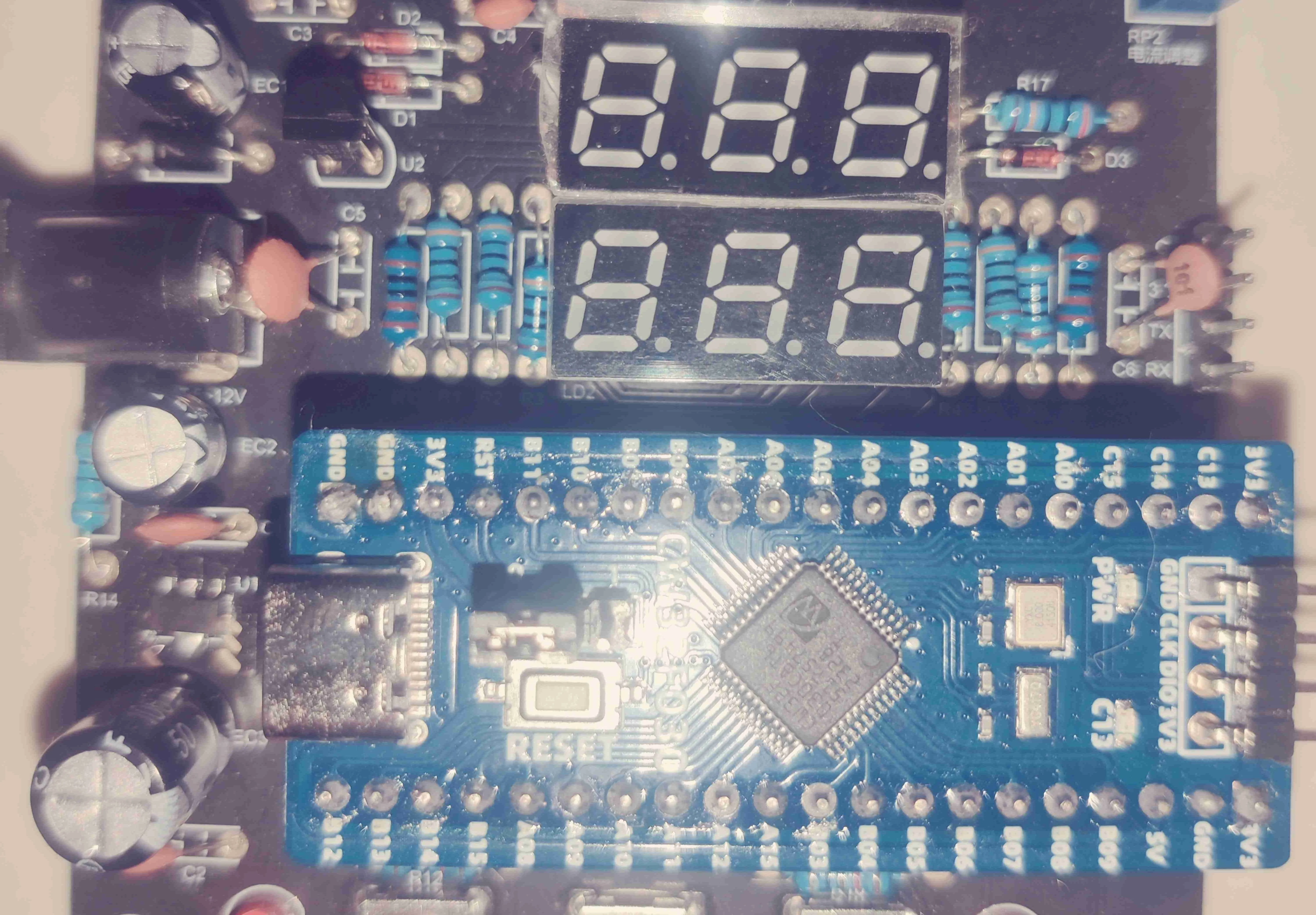

CW32 Ammeter/Voltmeter
Key advantages of CW32 in this project

1. Power Supply Circuit
LDO (Low Dropout Linear Regulator) Selection: This project uses an LDO as the power supply. Considering that most voltage meter products are used in industrial scenarios with 24V or 36V power supplies, the SE8550K2 with a maximum input voltage of up to 40V was selected as the power supply. The main reason for not using a DC-DC step-down circuit to handle large voltage differences in this project is to avoid introducing DC-DC ripple interference during the design process. A secondary reason is to reduce project costs.
2. Voltage Sampling Circuit
: The voltage divider resistors in this project are designed to be 220K+10K, therefore the voltage division ratio is 22:1 (ADC_IN11).

3. Current Sampling Circuit
This project uses a low-side current sampling circuit for current detection. The low-side of the sampling circuit shares a common ground with the development board's meter interface.
The
sampling current designed for this project is 3A, and the selected sampling resistor (R0) is 100mΩ. The selection of the sampling resistor mainly needs to consider the following aspects:

5. Digital Tube Display
This project uses a digital tube as the display unit.
This project uses two 0.28-inch three-digit common-cathode LED displays as the display device. Compared to a display screen, LED displays offer better visibility in complex environments. The brightness of the LED displays can be increased by using smaller current-limiting resistors, depending on the specific needs of the application environment. Furthermore, LED displays have better mechanical properties and are not as easily damaged by external forces as display screens. They are widely used in industrial applications where stability and reliability are crucial. From a development board learning perspective, this makes it easier to learn electronic measurement principles and related development in a targeted manner.
In this project, actual testing showed that the current-limiting resistors (R1~R6) for the LED displays were configured to 300Ω. The corresponding brightness for both red and blue LED displays was good and the brightness was soft and not glaring.

8. TL431 Circuit Design for Voltage Measurement and
Calibration: This project adds an extra TL431 circuit to provide a 2.5V reference voltage. This can be used to provide an external voltage reference for the chip to calibrate the AD converter. From a product design perspective, due to the inherent ADC performance advantages of the CW32, this circuit is not necessary. This circuit is designed on the development board to learn the relevant application principles.

Please calibrate after completion. Please calibrate after completion. Please calibrate after completion. (Important: I'll say it three times!)
The method
defines 5 operating modes. The K1 key is used to switch display modes. The K2 key sets the parameter values ​​for the corresponding mode and saves them to FLASH. Press K3 to return to Mode 0.
Mode 0: Displays normal voltage and current values ​​(the upper digital tube displays the voltage value *.V or .*V automatically, the lower tube displays the current value _.**A).
Mode 1: 5V voltage calibration setting. (JP1 can be shorted to use the built-in voltage source). The upper digital tube displays 5.05. The lower tube displays the current voltage value _.V or ._V. In this mode, the multimeter should be set to 5.00V to measure the measured value. Pressing K2 will calibrate the current value to 5V.
Mode 2: 15V voltage calibration setting. (JP1 cannot be shorted). The upper digital tube displays 5.15. The lower tube displays the current voltage value _.V or ._V. In this mode, the multimeter should be set to 15.0V to measure the measured value. Pressing K2 will calibrate the current value to 15V.
Mode 3: 0.5A current calibration setting. (JP2 can be shorted to use the built-in current source setting) The upper row of the digital tube displays A.0.5. The lower row displays the current value _.**A. After pressing the K2 key, the current value is set to 0.5A.
Mode 4: 1.5A Current Calibration Setting. (JP2 can be shorted to use the built-in current source for setting.) The top row of the digital tube displays A.1.5. The bottom row displays the current value *.**A. Pressing the K2 key calibrates the current value to 1.5A.
This project uses the LCSC-CW32F030C8T6 development board as the main controller, featuring a digital tube display, excellent cost-effectiveness, and a built-in current and voltage calibration circuit. It supports a maximum voltage of approximately 11V and a current of 2.5A (short-circuiting JP1 and JP2) to help you better understand the working principle of the ammeter and voltmeter. The video measures 15V, which can be measured directly without an independent power supply (remove the JP1 shorting cap). When measuring below 5V, please use DC power.
