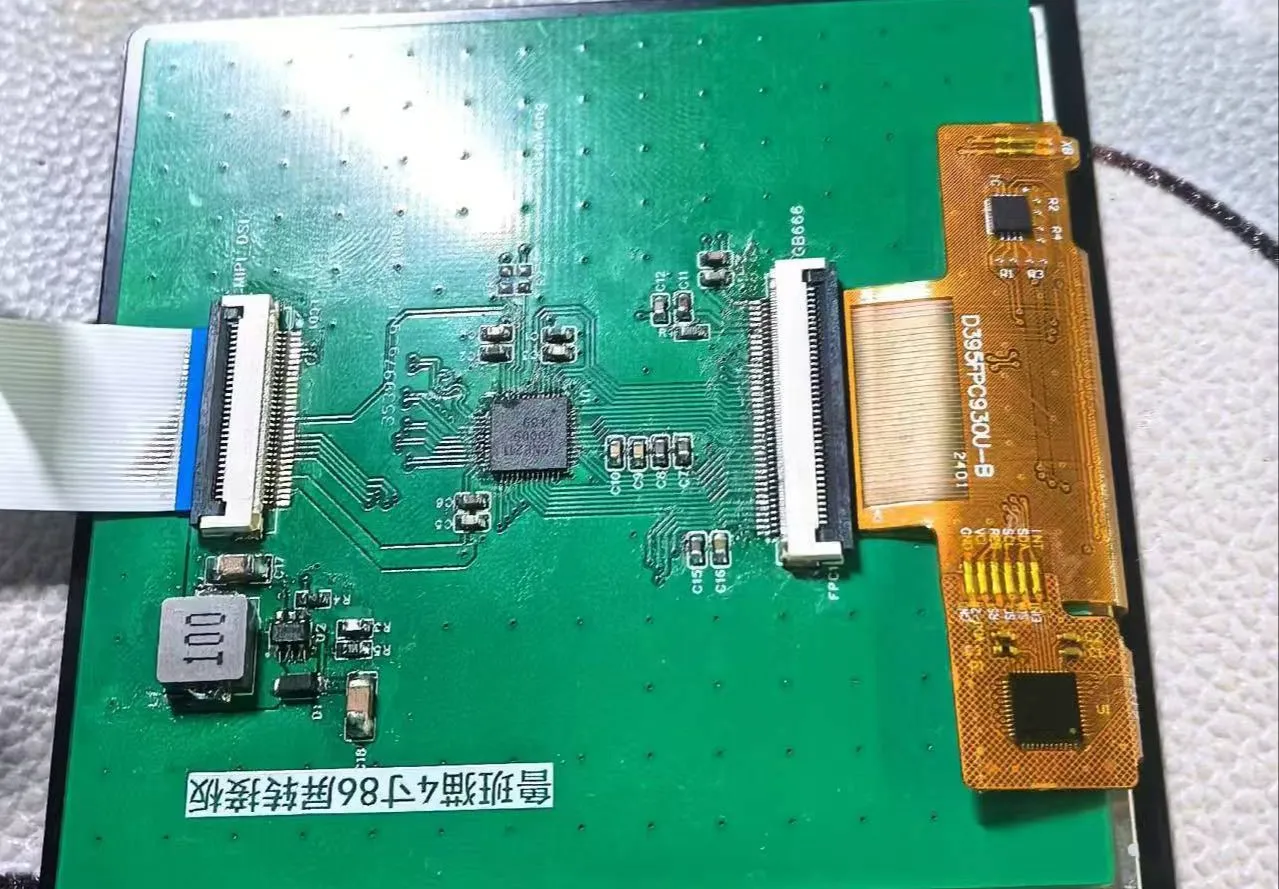

icdbxuxxSD
Wildfire Luban Cat CAT2 MIPI to RGB666 86-inch monitor with power-on driver
Based on the Taishanpai 4-inch 86-inch screen adapter - LCSC open-source hardware platform (oshwhub.com), modified
platform Wildfire Lubancat 2BTB version
MIPI DSI0
chip platform: RK3568
2024/08/19 Touch has been updated.
Different development boards have different DTSI, please pay attention to identification.
Example: I chose rk3568-lubancat-2io-dsi-800p.
Put the following content into the device tree:

}; The device tree node directly calls the edt-ft5x06.c file without needing a patch
. Since it's unknown which makefiles Luban Cat uses  , some defs are loaded for this driver, and other drivers are disabled. It's recommended to disable unnecessary models to improve compilation speed and prevent address errors and driver loading failures. # CONFIG_TOUCHSCREEN_GOODIX=y # CONFIG_TOUCHSCREEN_GSLX6801=y # CONFIG_TOUCHSCREEN_GSLX680_PAD=y # CONFIG_TOUCHSCREEN_GSLX680_VR=y # CONFIG_TOUCHSCREEN_GSL3673=y # CONFIG_TOUCHSCREEN_GSL3673_800X1280=y # CONFIG_TOUCHSCREEN_GSL3676=y # CONFIG_TOUCHSCREEN_HYN_CST2XX=y # CONFIG_TOUCHSCREEN_WACOM_W9013=y# CONFIG_TOUCHSCREEN_GT1X=y#CONFIG_TOUCHSCREEN_FTS=y#CONFIG_TOUCHSCREEN_ROCKPI_FT5406=yCONFIG_TOUCHSCREEN_EDT_FT5X06=y //86 screen driver# CONFIG_TOUCHSCREEN_CYPRESS_CYTTSP5=y# CONFIG_TOUCHSCREEN_CYPRESS_CYTTSP5_DEVICETREE_SUPPORT=y# CONFIG_TOUCHSCREEN_CYPRESS_CYTTSP5_I2C=y# CONFIG_TOUCHSCREEN_CYPRESS_CYTTSP5_DEVICE_ACCESS=y# Adding a # before CONFIG_TOUCHSCREEN_CYPRESS_CYTTSP5_LOADER=y indicates that I mainly modified lubancat2_android11_defconfig //This configuration file is most likely the one I compiled for MIPI800P . I also tested  lubancat2_buildroot_defconfig, lubancat2_defconfig , rockchip_defconfig , and rockchip_linux_defconfig. I haven't done specific testing yet . The file path is in kernel/arch/arm64/configs. The driver file path is in kernel/drivers/input/touchscreen/makefile. bj-$(CONFIG_TOUCHSCREEN_EDT_FT5X06) += edt-ft5x06.o   This driver is loaded by default. If it's not there, add it yourself and then compile. Complete device tree // SPDX-License-Identifier: (GPL-2.0+ OR MIT) /*  * Copyright (c) 2020 Rockchip Electronics Co., Ltd.  *  */ &route_dsi0 { status = "okay"; connect = ; }; &video_phy0 { status = "okay"; }; &dsi0_in_vp0 { status = "okay"; }; &dsi0_in_vp1 { status = "disabled"; }; &dsi0 { status = "okay"; rockchip,lane-rate = ; power-supply = ; dsi0_panel:panel@0 { compatible = "simple-panel-dsi"; reg = ; backlight = ; reset-gpios = ; enable-delay-ms = ; prepare-delay-ms = ; reset-delay-ms = ; init-delay-ms = ; unprepare-delay-ms = ;

视频效果见附件
参考设计图片
