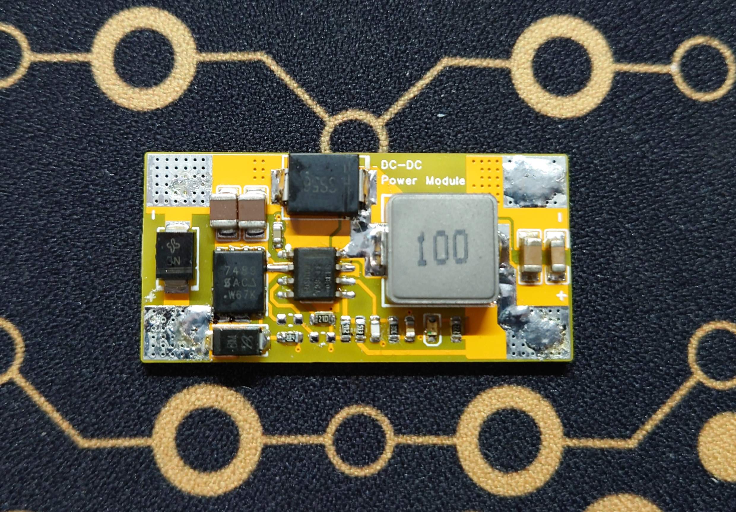

TPS54360 step-down module verification board
1. Features:
4.5V to 60V (65V absolute maximum) input range;
3.5A continuous current, 4.5A minimum peak inductor current limit;
current-mode controlled DC/DC converter;
92mΩ high-side MOSFET;
high efficiency Eco-mode achieved with pulse skipping under light load conditions; low dropout voltage achieved
with integrated BOOT-REC FET under light load conditions;
146μA quiescent operating current;
2μA shutdown current;
fixed switching frequency from 100kHz to 2.5MHz
synchronized to an external clock;
adjustable undervoltage lockout (UVLO) voltage and hysteresis ;
internal soft-start;
precise cycle-by-cycle current limit; over-
temperature, over-voltage, and frequency foldback protection;
0.8V 1% internal voltage reference
; 8-pin HSOIC with PowerPAD™ package;
-40°C to 150°C TJ operating range;

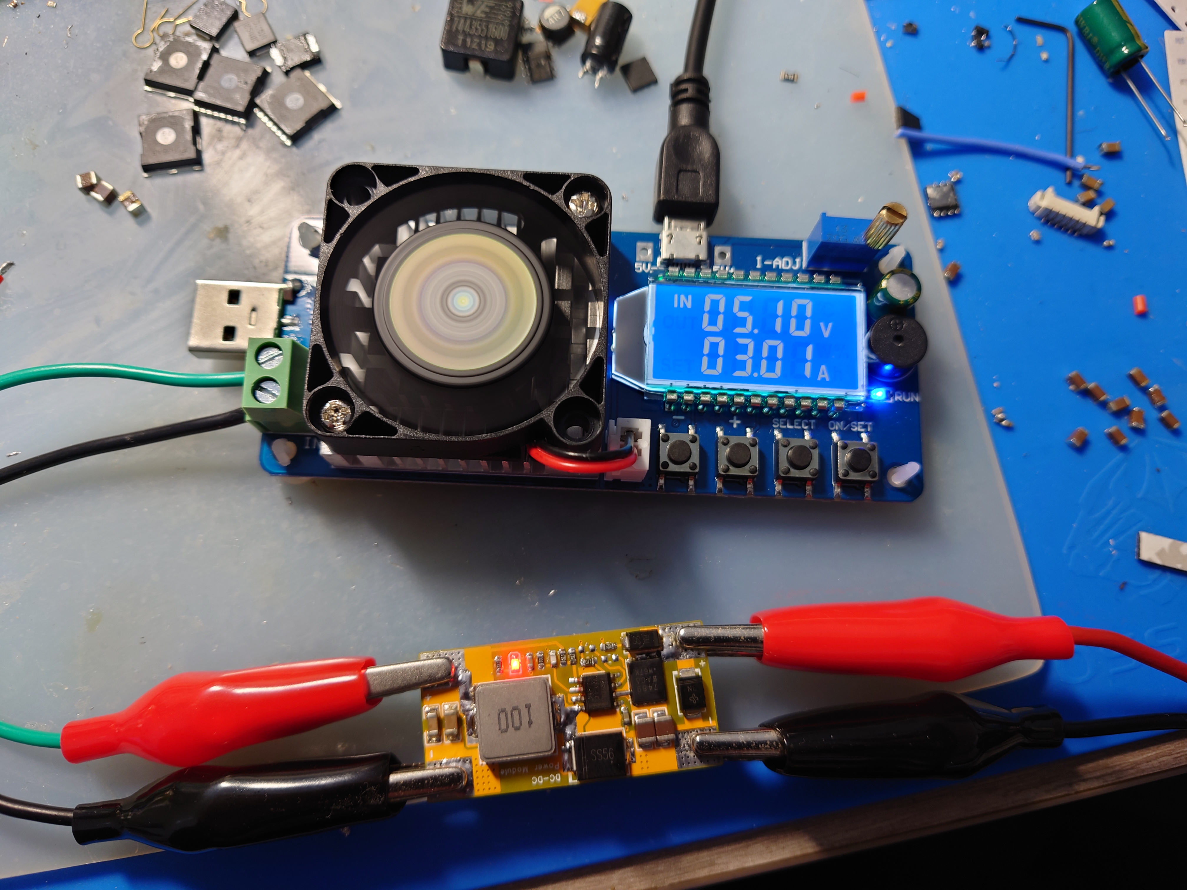

tested with 24V input and 5V 3A load without issues, stable operation without additional cooling.
