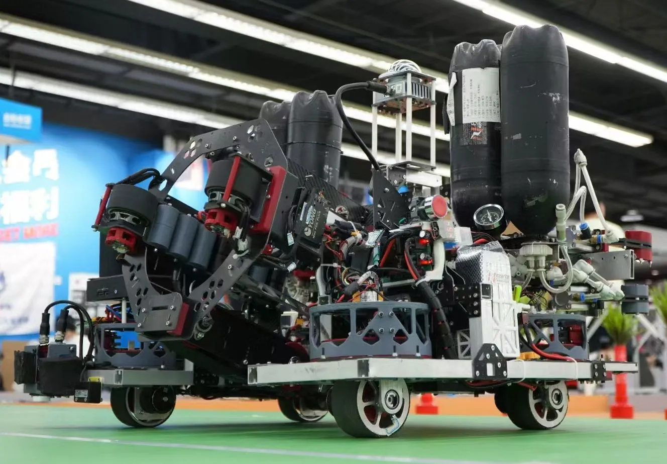

Our R1 vehicle has a total of 16 motors, 2 DT35 controllers, 1 MID-360 controller, 4 solenoid valves, and various PCB modules. To effectively utilize space, we adopted an integrated stack-up design for the main control board, voltage divider, and CAN bus, as shown below:
We divided the control into two main control units based on the upper and lower layers. This improved our code debugging efficiency; in terms of circuit design, we completely separated the circuits for different mechanisms, which helped us with troubleshooting during the competition.
