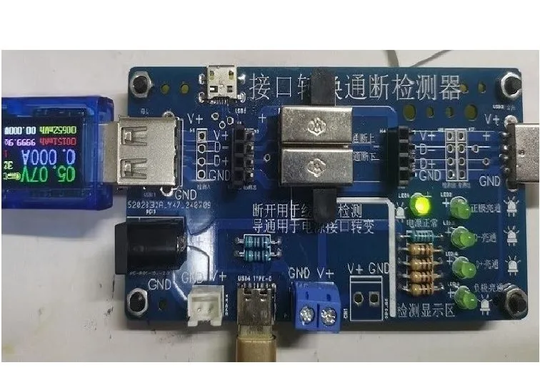

Other functions have been introduced in previous versions. This version only explains the new functions and how to operate them. A new line continuity detection function has been added. Usage: 1. Switch both band switches to the off position (far right); 2. Insert the wire to be tested into the corresponding interface, connecting both ends of the wire to the left and right sides of the solid white line respectively; 3. Use a 3V button battery as a power source to connect V+, D+, D-, and GND on both sides of the switch, one by one; 4. Continuity detection: For example, connecting both sides to the D+ path. If the D+ indicator light is on, this path of the wire is intact; otherwise, the break indicator light will not illuminate.
