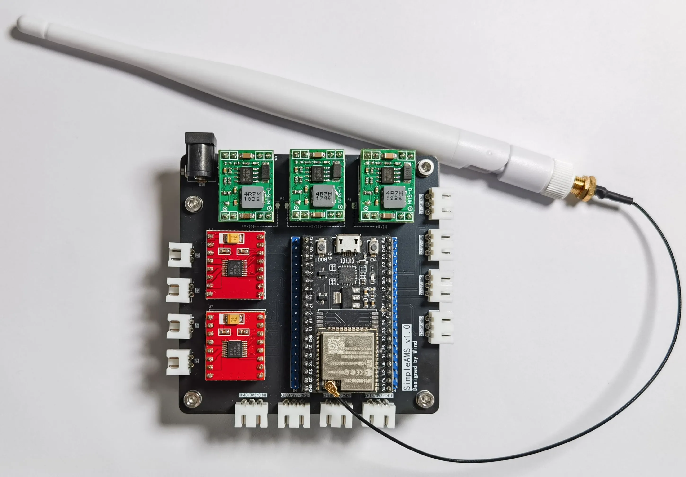

Project Overview:
This project utilizes Topzhu's open MQTT interface, employing an ESP32 microcontroller to communicate with and send commands to the printer. Combined with supporting equipment, it achieves the color-changing effect of AMS.
The project consists of three main parts:
1. Control Board;
2. Supporting Bracket
; 3. Host Computer (Optional).
I. Control Board: The control
board is designed with two layers and extensively uses modules, making it simple to manufacture. Its interface functions are as follows.
