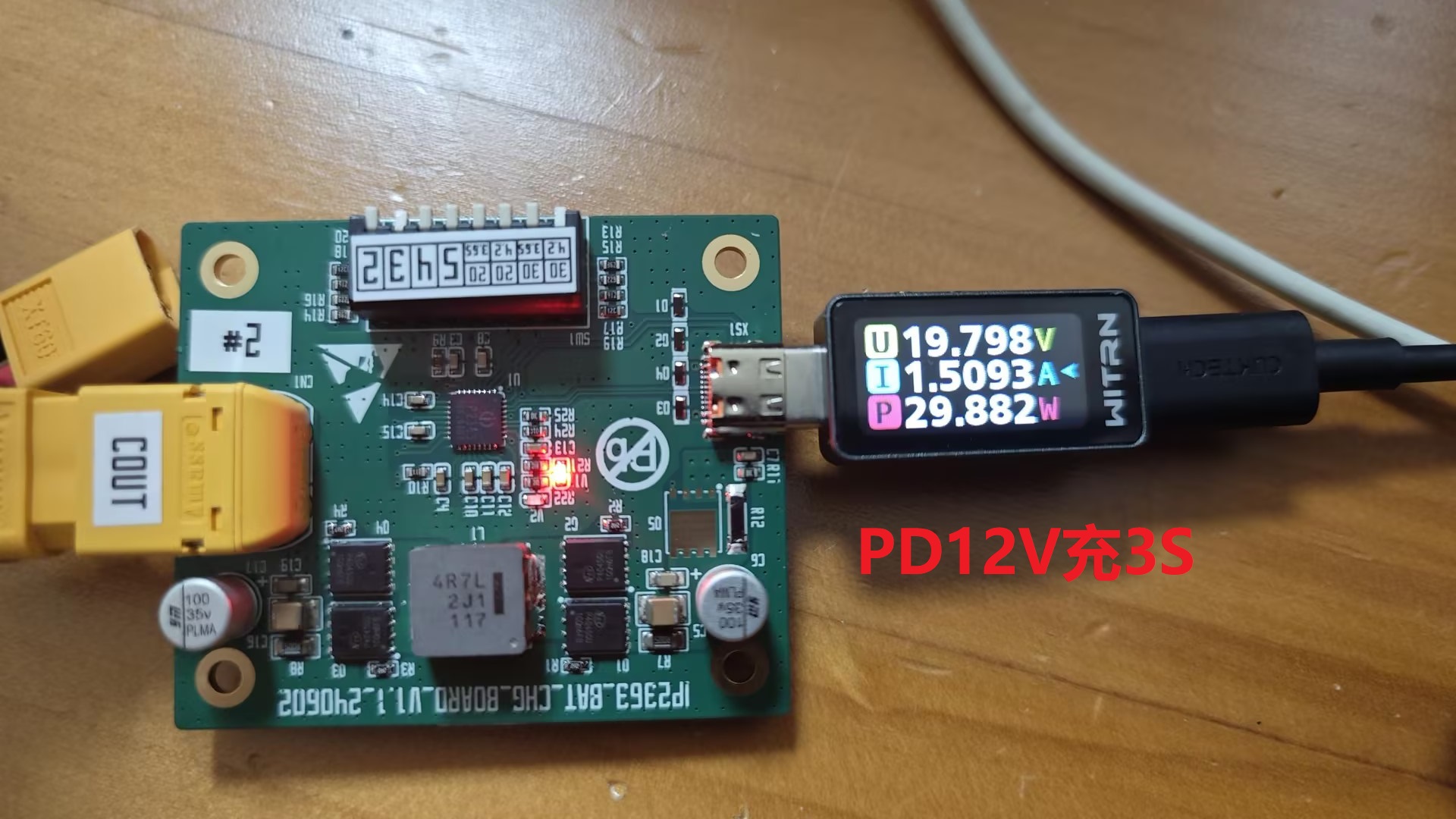

IP2363 Verification Board

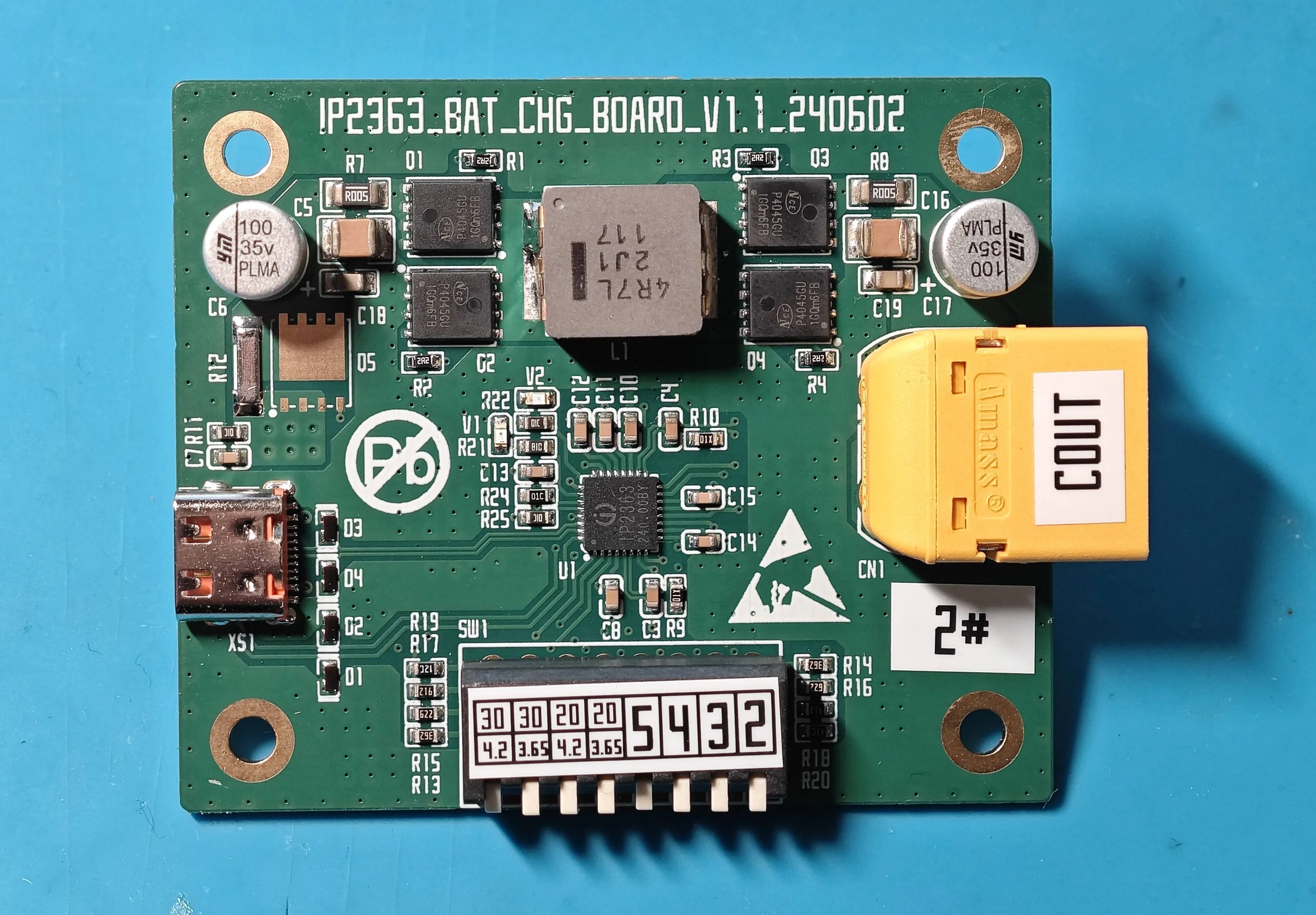

V1.2 Changes: Added a tactile switch. Clicking activates the output. It can output normally when connected to a low-current device (earphone, CC meter). Double-clicking turns off the output.
It has been verified as OK by flying wire. The new PCB board has not been tested.
1. The applicable IC models for this project are: IP2363-BZ and IP2363-Cout;
2. The solution is applicable to: power tools and battery pack charging. It can also temporarily charge mobile phones. It is not suitable for power banks. Remember not to use batteries without protection boards, as this may cause overcharging and over-discharging, which may be dangerous;
3. Currently, only one seller of the Cout version is available on Taobao. If you cannot find it, you can send me a private message. Please refer to the attached BOM for production;
4. Unresolved issues:
(1) The Cout version cannot be directly tricked into output. It may be necessary to consult the FAE of Ingenic Semiconductor for relevant strategies. No abnormalities have been found when connecting to a mobile phone for charging;
(2) Sometimes the light cannot turn on when fully charged. The solution is the same as above.
5. Please modify the resistance value of the sampling resistor with caution.

1. MOSFET Selection:
Select according to priority ①-③: ① Ciss < 1000pF; ② Rds(ON) < 10mΩ; ③ Vdss ≥ 30V.
Explanation: Ciss will affect the switching speed of the MOSFET. It is recommended to select one with less than 1000pF. Secondly, consider the on-resistance. The drain-source voltage should be greater than 30V.
Generally, the four transistors are of the same model. If there is a specific application scenario or the cost is very sensitive, you can refer to the explanation provided in the article in "Hard Ten" for selection. It is roughly as follows:
(1) Low duty cycle design: In this case, the PD20V charging head is used to charge 2S and 3S batteries (IP2363 defaults to the highest voltage). The input voltage is high.
       The high-side MOSFET is off most of the time. The DC loss is low and the AC loss is high. Select a MOSFET with low gate charge, even if Rds(on) is large. The low-side MOSFET is on most of the time. The AC loss is low and the DC loss is high. Select a MOSFET with low on-resistance, even if the gate charge is high.
(2) High Duty Cycle Design: In such cases, a PD20V charger is typically used to charge 4S or 5S batteries, or a PD12V charger is used to charge 3S batteries. The input voltage is close to the battery voltage.
       The high-side MOSFET is on most of the time, resulting in higher DC losses and requiring low on-resistance. Depending on the input voltage, AC losses may not be as significant as with the low-side MOSFET, but they are still not as low, requiring low gate charge. A balance needs to be struck between low gate charge and low on-resistance. The low-side MOSFET has the shortest conduction time and lower AC losses, so the correct MOSFET can be selected based on price or size rather than on-resistance and gate charge.
It is recommended to use the same type of MOSFET for all four MOSFETs, which can save a lot of trouble.
Recommended MOSFET models:
① NCEP4045GU, Wuxi Xinjieneng;
② WSD4076DN56, Weishuo;
③ BSC059N04LS6, Infineon;
④ TMG60N04NF, Taimao; ⑤
CMSA012N06, Guangdong Field Effect Semiconductor;
⑥ SIR8360DP-T1-GE3, Vishay
; ⑦ NTTFS5C466NL-HXY, Huaxuanyang.
①-③ verified, ④-⑦ unverified, ⑦ model is a 3x3 package (if there is a need for further size reduction).
2. Inductor selection:
4.7uH, 8A (the smaller of temperature rise current and saturation current) or higher, DCR < 10mΩ;
3. MLCC Selection:
On the high-voltage path, X5R and X6R/S capacitors should be dated by ≤60%, i.e., withstand voltage ≥35V. X7R and X7S capacitors should be dated by ≤85% (ambient temperature <85℃), i.e., withstand voltage ≥25V.
4. Sampling Resistor:
Select one with 1% accuracy and low temperature drift. Modifying the sampling resistor value will affect the peak power and may burn out the circuit. Do not modify it unless you are certain.
5. Other

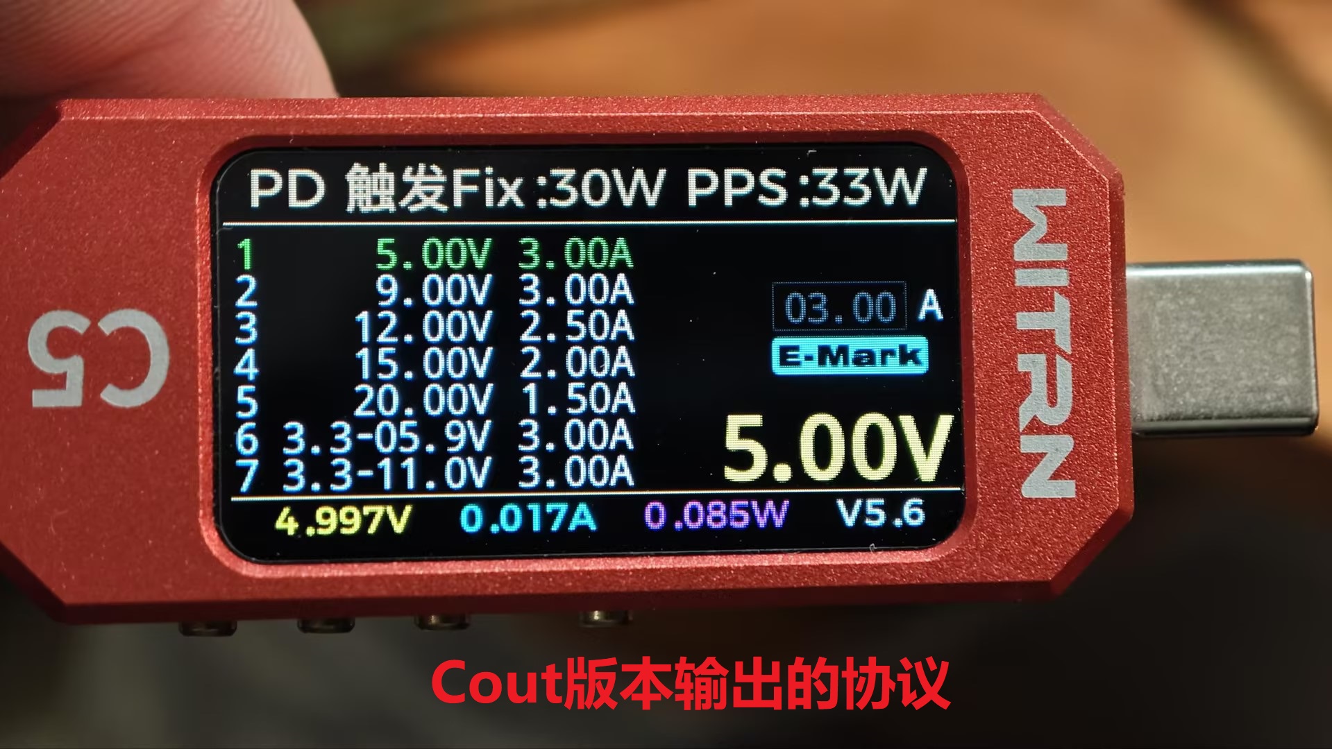

Indicator Lights: A dual-light design is recommended because the COUT version requires dual lights to indicate the status. It is best to reserve space in the circuit.
The input and output ranges of the COUT version are bound, meaning that if you set the maximum input to 20W, the output will also be 20W.
The NTC function does not have a reserved interface; it only has a 10K pull-down resistor, which can be brought out externally if needed.
II. Layout and routing
should refer to the requirements in the IP6557 manual attached. Additionally, the following requirements apply:
1. ICs and MOSFETs should have ventilation windows on the BOT side for heat dissipation. The IC hot air pads should have vias. 2. Trace traces
should be routed to both sides of the VBUS pads on the USB-C port.
3. The copper trace at the bottom of the shielded inductor can be retained, but the copper trace at the bottom of the unshielded inductor must be removed. Also, ensure that traces do not run under the inductor.
4. All AGND networks should be connected together for single-point grounding. It is recommended to use a 0R resistor, as this makes it easier to handle on the PCB.
5. Routing priority: USB-C port → sampling line → other lines.

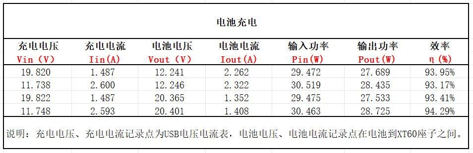

III. Test Data

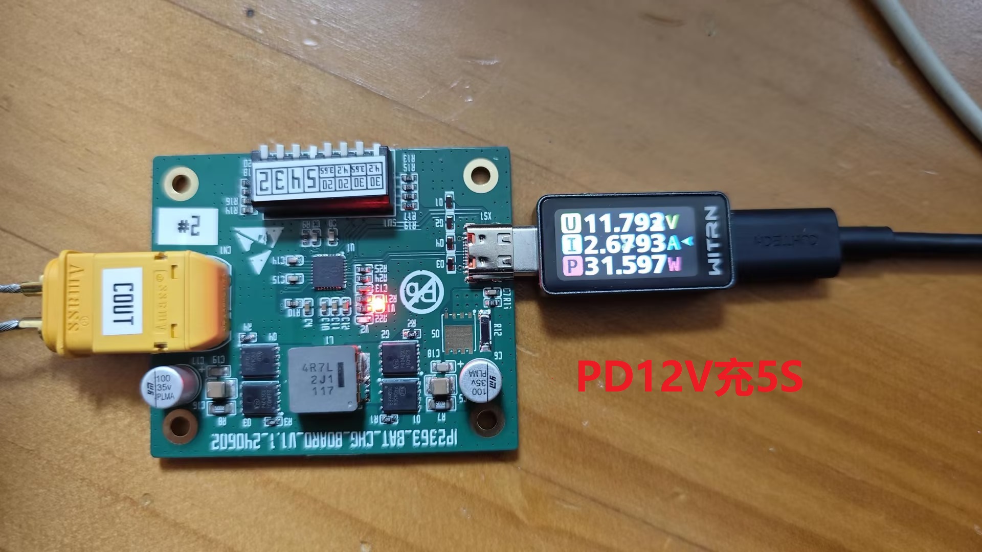

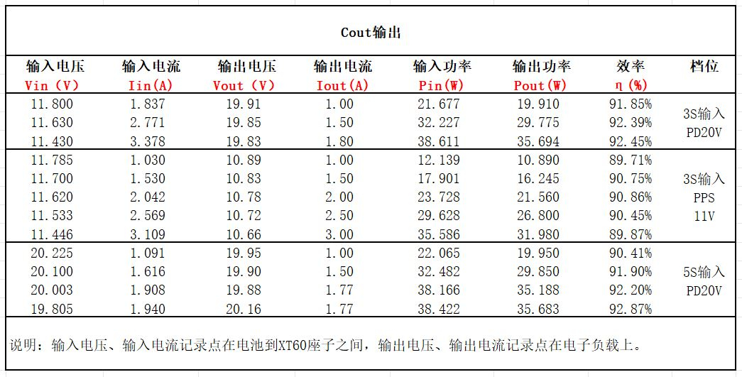

1. IP2363_Cout Output Efficiency: Efficiency at various current levels and under extreme current at 20V and 11V.
2. Charging Efficiency: Charging efficiency of 3S and 5S batteries at PD20V and PD12V.

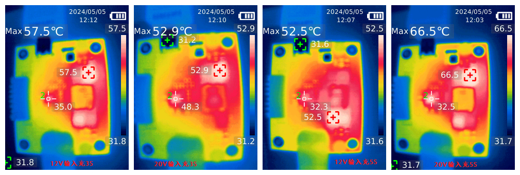

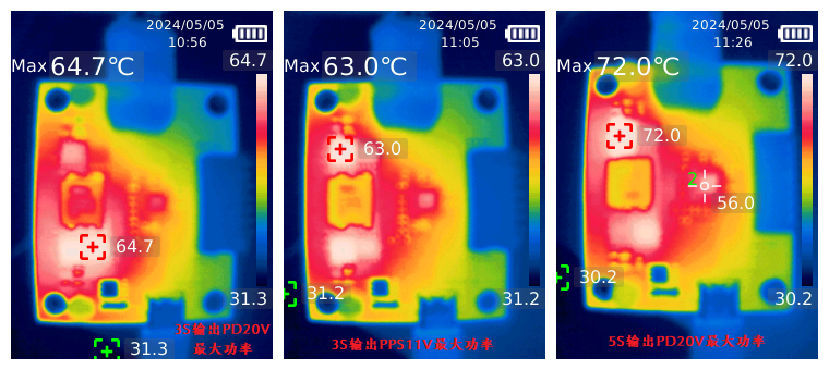

3. Temperature Performance: Output and input at room temperature of 26℃ (corresponding to the table above).

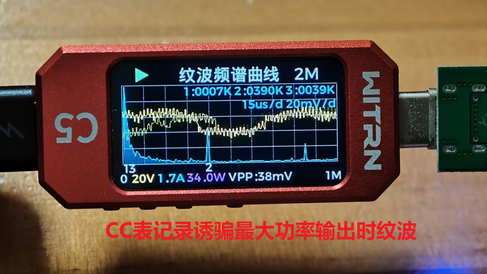

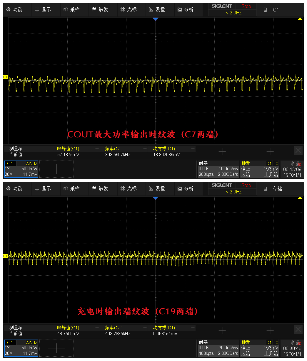

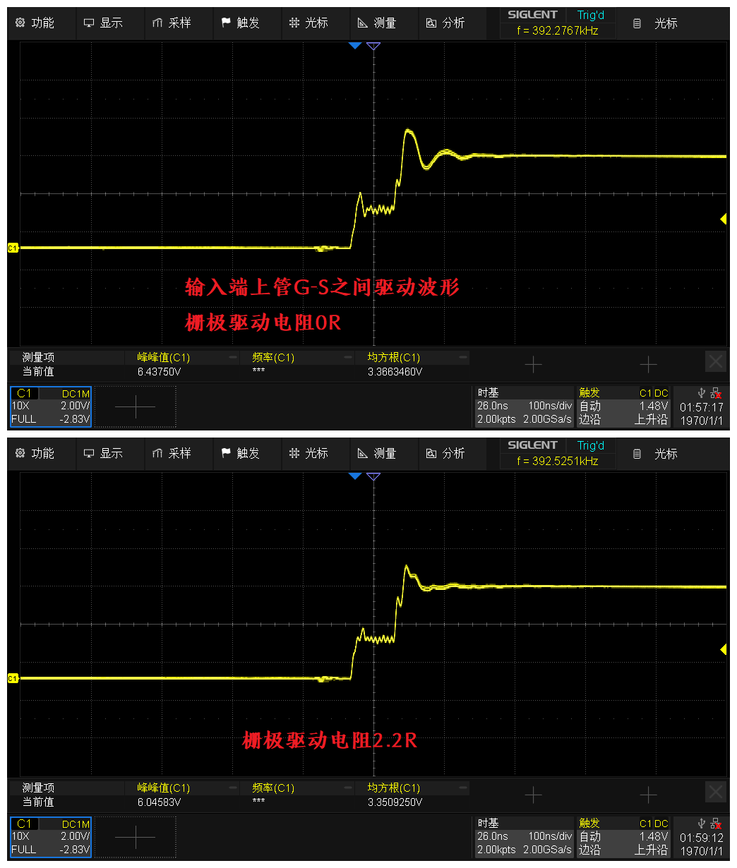

4. Ripple and Drive Waveform
IV. Summary + Others
1. Output efficiency, averaging over 90%. It should be noted that when Cout has no output, the decoy device cannot induce a voltage. A voltage and current meter needs to be connected to a mobile phone to activate Cout's output before the protocol can be induced. This strategy is suspected to be related to the IC's firmware.
2. Charging efficiency is above 93% on average.
3. Temperature performance: without passive or active cooling, the highest temperature at the 35W output limit is 72℃, and the highest input temperature is 66.5℃.
It should be noted that the chip's internal digital and analog power supplies are converted from the input voltage. The larger the LDO voltage difference, the greater the IC heat generation.
The temperature graph shows that PD20V charging is hotter than PD12V charging. Cooling measures (active or passive) should be strengthened to ensure the IC and MOS operate at lower temperatures to improve stability.
4. Ripple is good. A clear Miller plateau is visible in the gate drive waveform, and ringing is very small at 0R. When using different MOS, the resistor in series with the gate drive needs to be adjusted according to the waveform. If possible, a fast recovery diode (e.g., 1N4148) can be connected in parallel across this resistor to accelerate the MOS turn-off time.
5. Since the external power supply pin of the IC is input from VIO, is it possible to pass through an LDO first and then enter VIO to share the power consumption of the IC? This idea has not been verified.

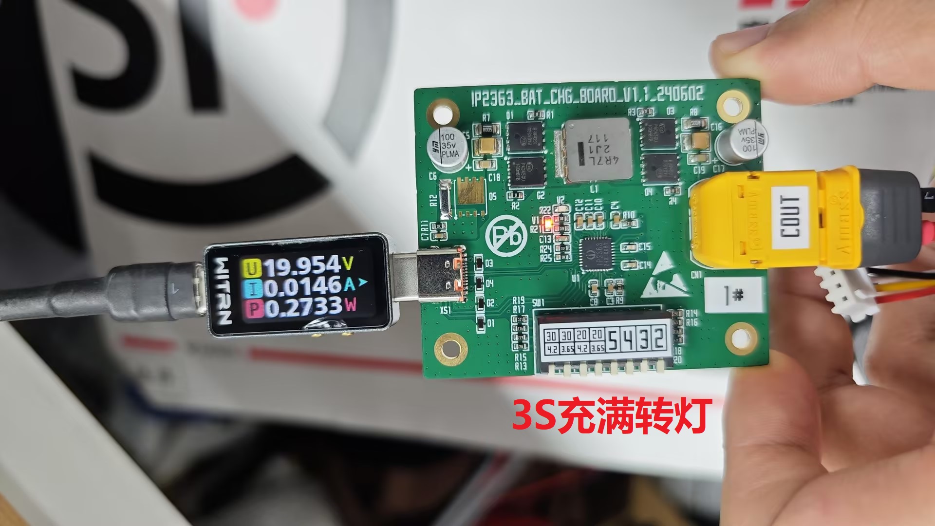

6. Occasionally, when fully charged, the light will not turn on. The phenomenon is that the light turns on and stays on for 2 seconds and then continues to flash. It can be distinguished by careful visual inspection. This may be related to the firmware. The recharging threshold may have been changed.
7. The NTC function has been verified.

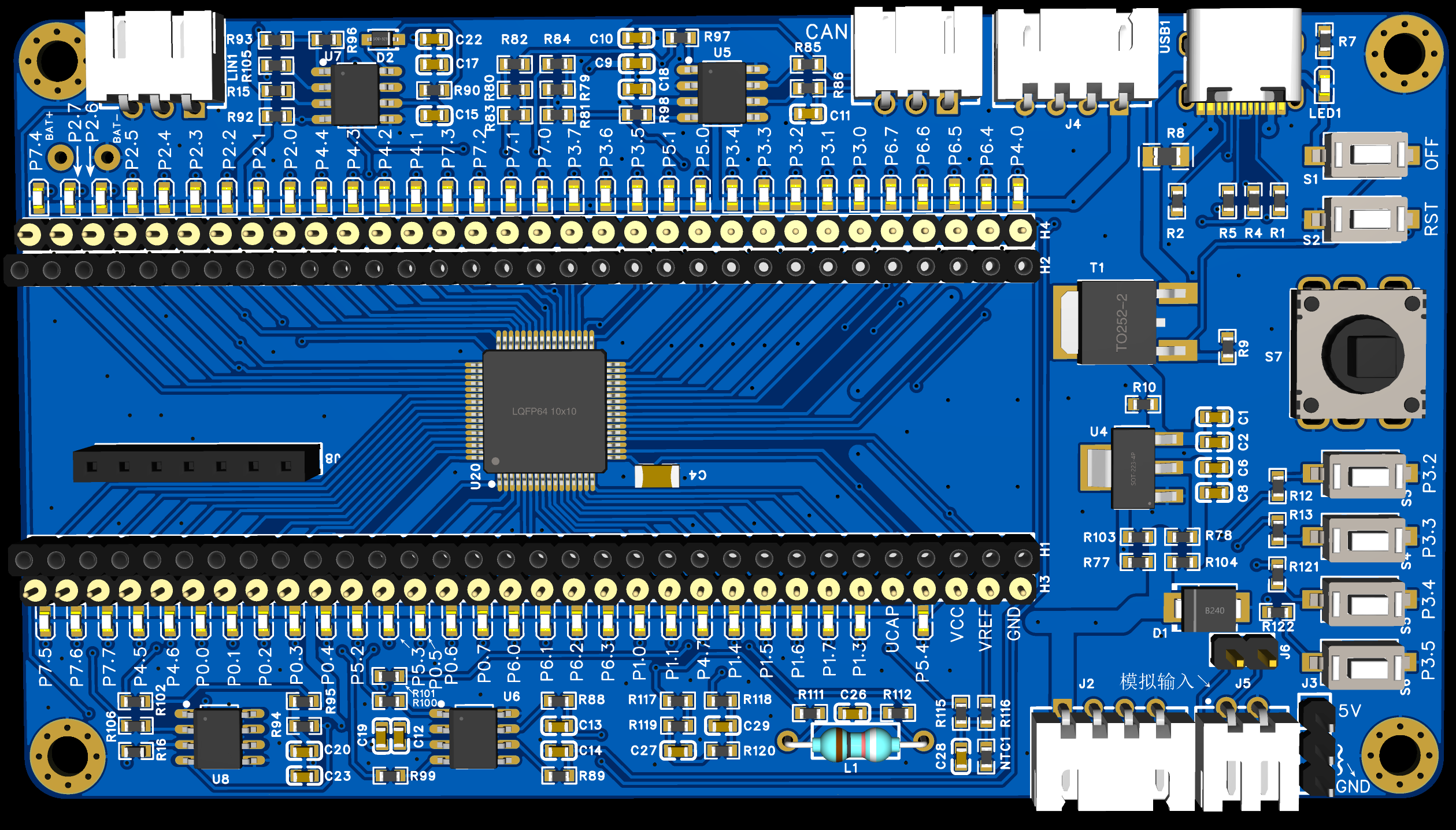

Multi-type Motor Drive Algorithm Learning Board V1.0
A motor drive algorithm learning board designed to meet learning needs, supporting the learning and development of various motor drive algorithms. Code development is underway...
This is a motor drive algorithm learning board designed to meet learning needs. It supports open-loop DC brushed motors, closed-loop DC brushed motor speed (Hall encoder), open-loop DC brushless motors (back EMF, SVPWM), closed-loop DC brushless motor speed (Hall encoder), closed-loop DC brushless motor position (IIC magnetic encoder), open-loop stepper motors, and closed-loop stepper motors (IIC magnetic encoder). It features
12-24V voltage input, reverse polarity protection, an STM32G431C8T6 main controller, four reserved input capture interfaces (TIM3), and reserved communication interfaces: SPI and IIC.

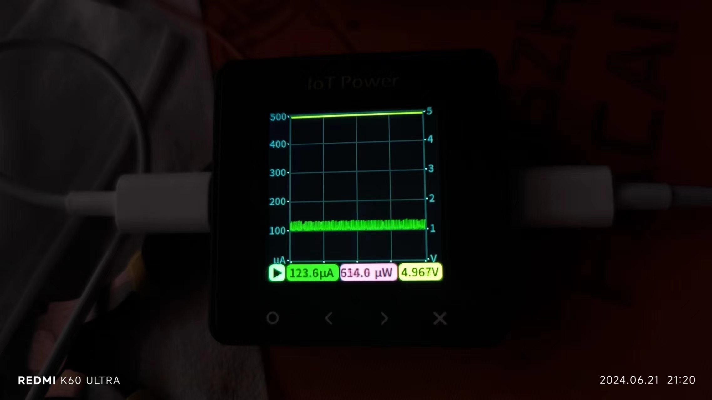

. 6. Low standby current, only 130ua/5v

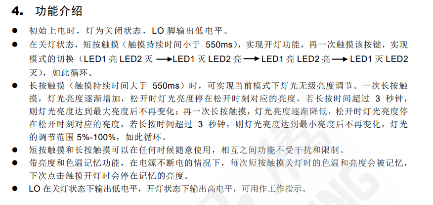

1. Low-cost fan/power supply IC, using IP6351, only 0.76r, adjustable battery type voltage and charging current.
2. Uses touch buttons to control the fan switch, with 4 speed settings (5V, 7V, 9V) and 3 wind speeds. Also includes a 4-speed natural wind function.
3. Can be used with an external magnetic light, using the same light board as the plug-in model, with a housing and magnetic power supply magnet that can be attached to the front of the fan. The round power supply magnet supports 360° rotation.
4. Low standby current, only 130ua/5V.

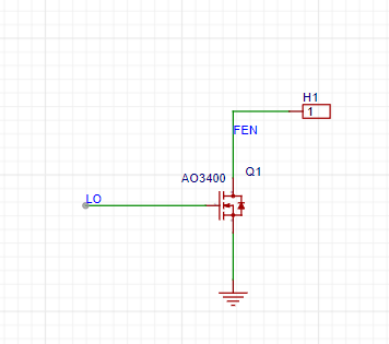

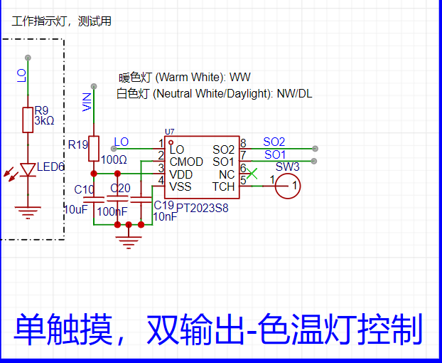

II. Schematic diagram explanation:
Uses PT2023S8 touch dimming IC, low power consumption, standby current only 6ua
, multifunctional, simple peripheral circuit.

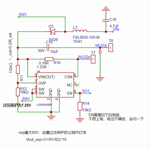

LED driver
uses LGS63042EP, input 3-60V, output 3-60V, very cost-effective, only 1.3r, still works normally at 87 degrees Celsius, wide operating temperature range -40℃ to... The 125℃
cooling fan circuit
is controlled by the touch-sensitive LO pin output.

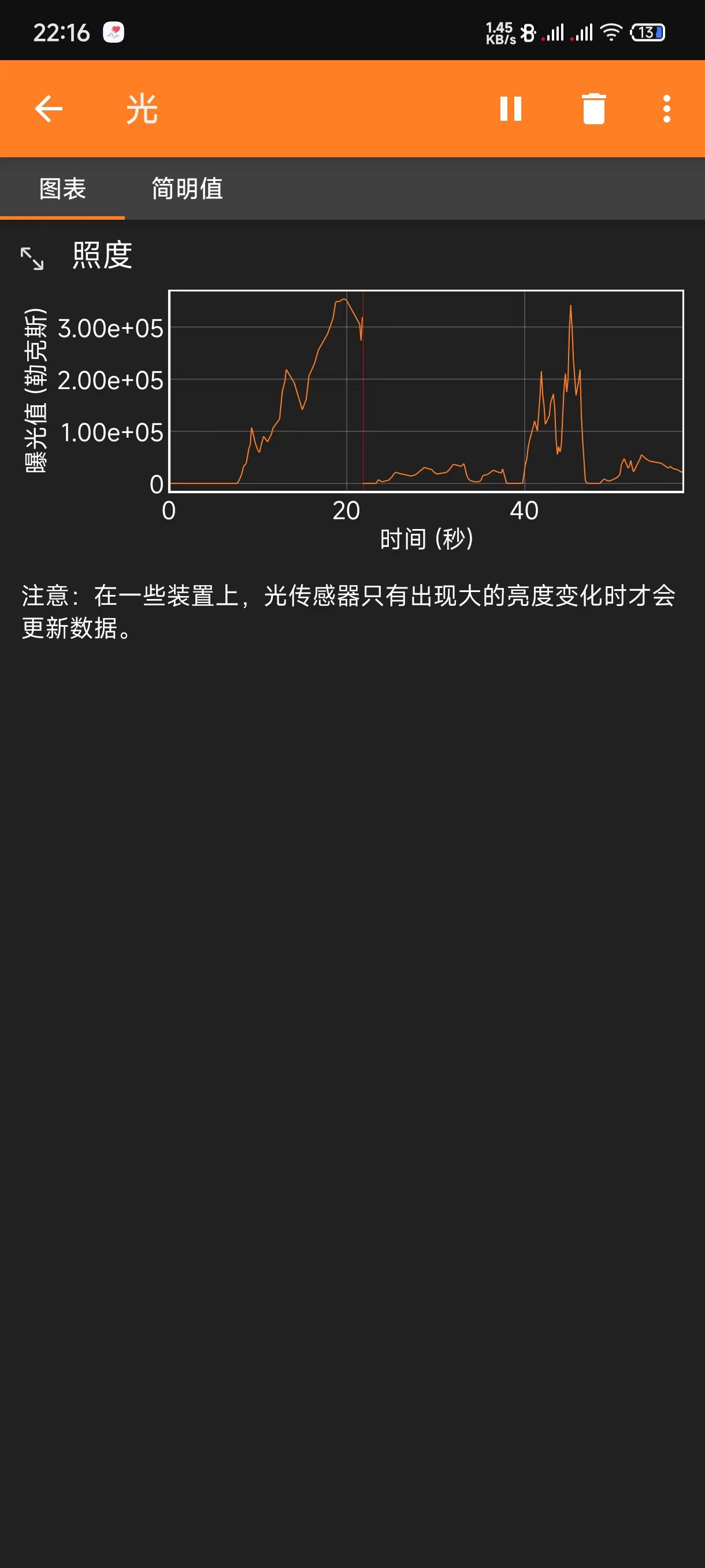

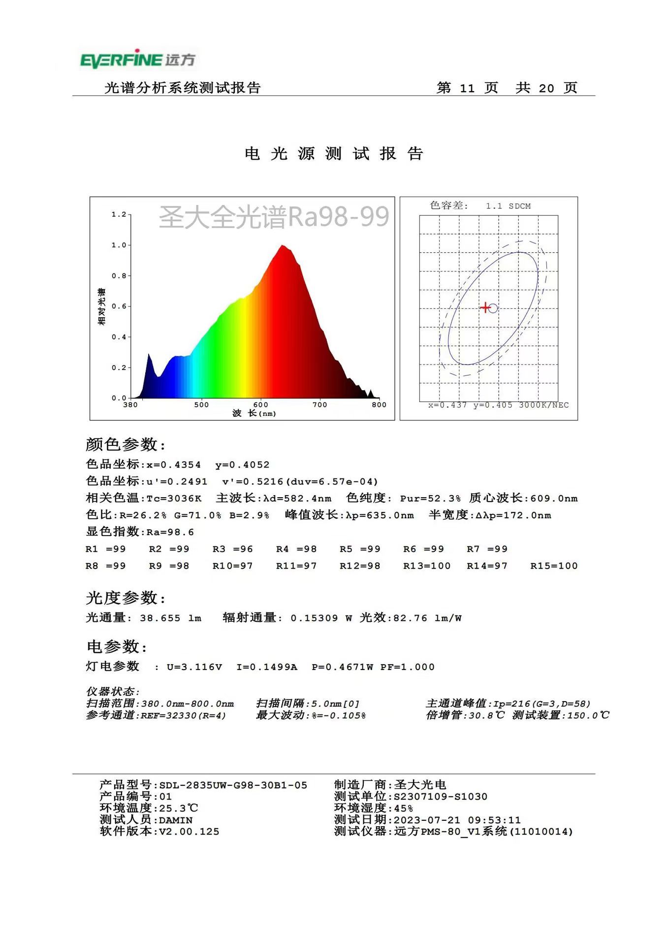

III. Physical/Test Images

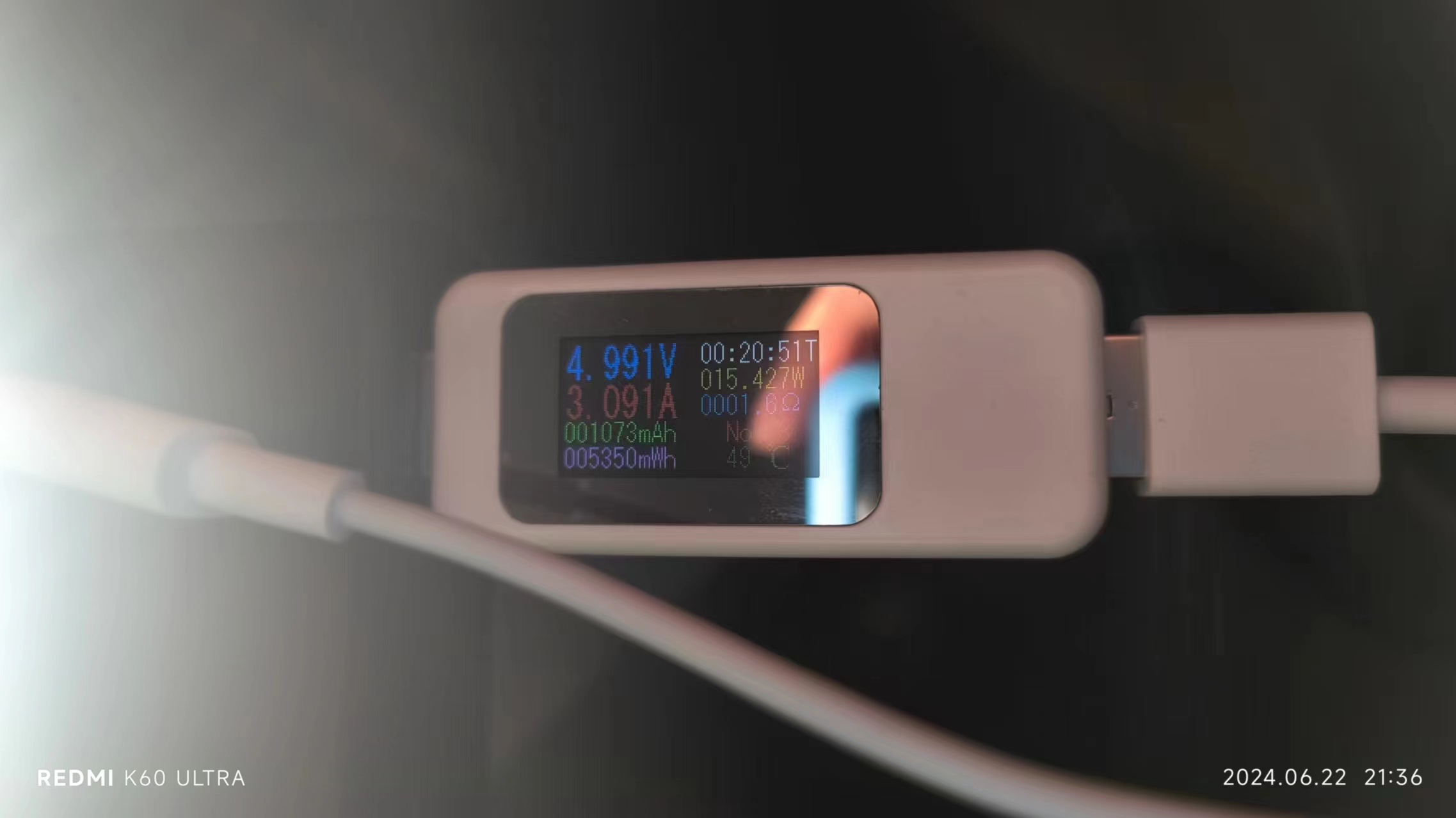

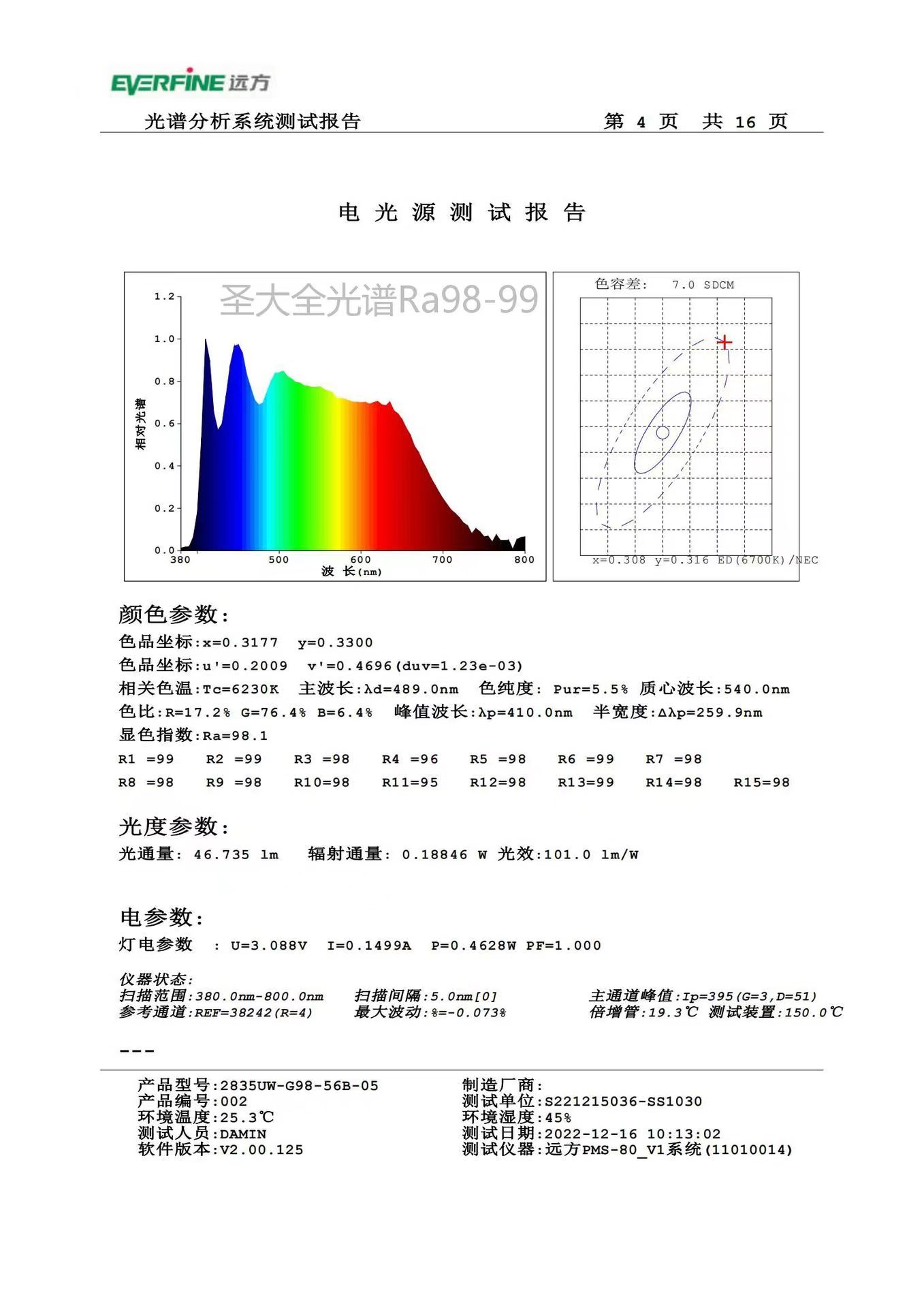

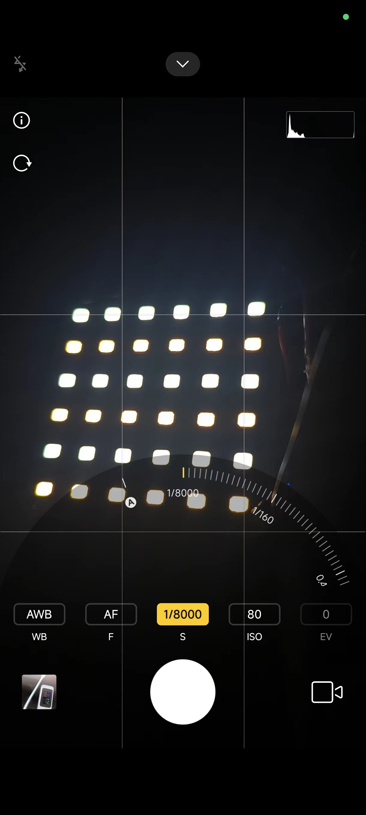

: Brightness photos taken using parameters set in professional mode on a mobile phone camera.
Running at full power for 20 minutes without abnormalities, consuming approximately 5.3Wh. It functions well as a plant light. It uses full-spectrum LEDs. With 8 hours of illumination per day, the monthly electricity cost is approximately 4 RMB. The lamp
board temperature is normal (20 minutes of operation, room temperature 29°C). The inductor temperature is the highest, but overall it functions normally.
The LEDs used are full-spectrum LEDs; violet light excites the phosphor to emit light. White light is used during operation to be invigorating, while warm light is used at night to induce drowsiness. Reference source: Zhihu. Brightness values ​​measured by mobile phone software ( standby power consumption measured by a CC meter
near the LED with the front camera of the mobile phone).

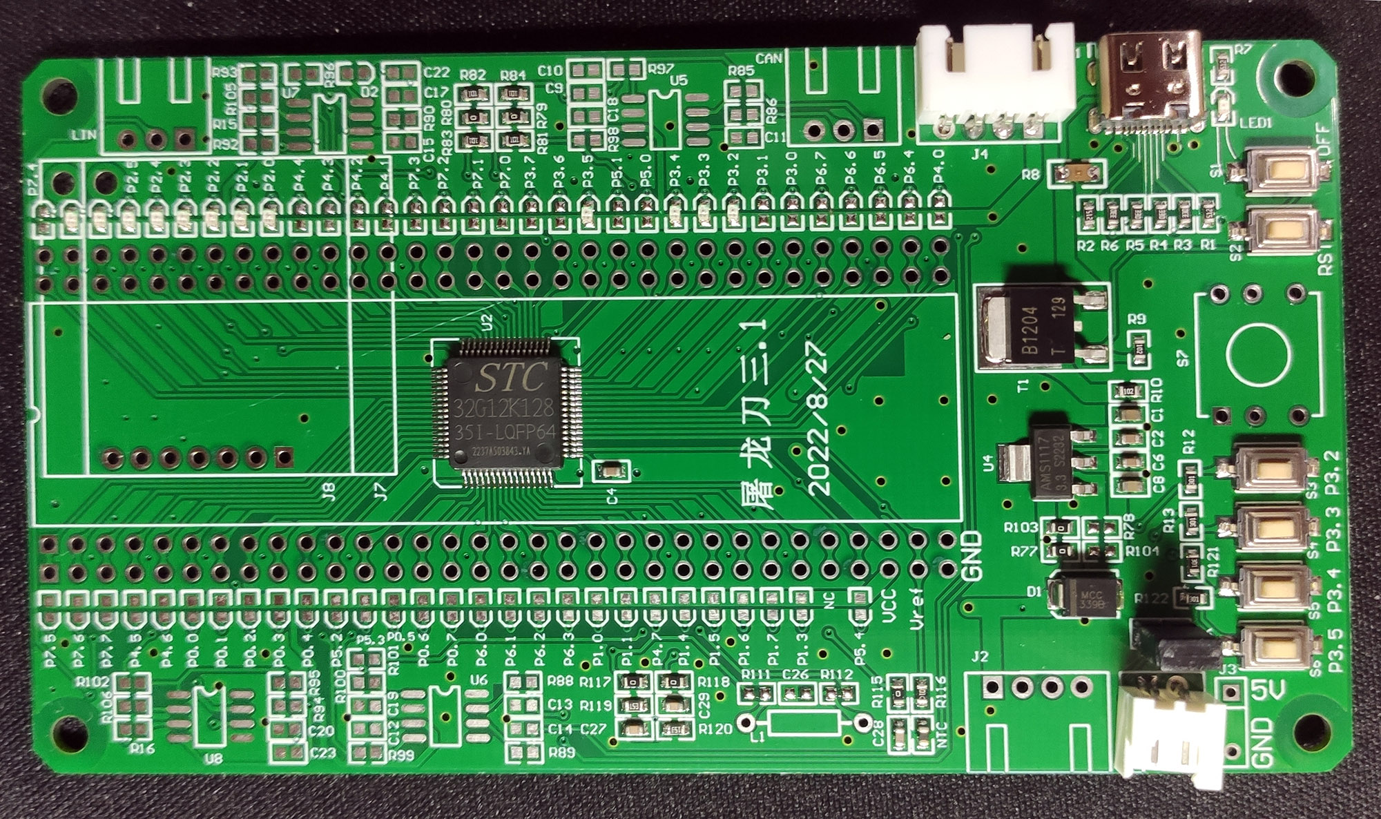

This is a replica of the STC official development board, the third generation "Dragon Slayer," with optional chips: STC32G12K128-LQFP64 or STC8H8K64U-45MHz-LQFP64.
This project is a replica of the STC official Dragon Slayer 3rd Generation development board. The chip options are STC32G12K128-LQFP64 or STC8H8K64U-45MHz-LQFP64.
I. Images of the Dragon Slayer 3rd Generation board
; II. 3D demonstration of the development board;
III. Onboard functions:
All chip pins are brought out (H3 and H4 are soldered to header pins).
The onboard LQFP64 chip is converted to DIP64 for outgoing pins (H1 and H2 are soldered to header pins).
All I/O ports have LED indicators (common anode, with current-limiting resistors).
When the LQFP64 chip is not soldered and H1 and H2 are soldered to header pins, a DIP64 interface can be used. The core board
has an anti-static USB Type-C interface that supports downloading and a download button (OFF and S3 buttons) that allows data cable unplugging.
It supports STC USB-Link1 (J4) and STC USB-Link1D (J2+J4). The emulation tool
chip can be selected as 5V or 3.3V, and a 3.3V emulation tool is also available onboard. LDO voltage regulator chip
with 5V power output; when using 3.3V, the 5V power
supply can be used simultaneously. Onboard reset button.
