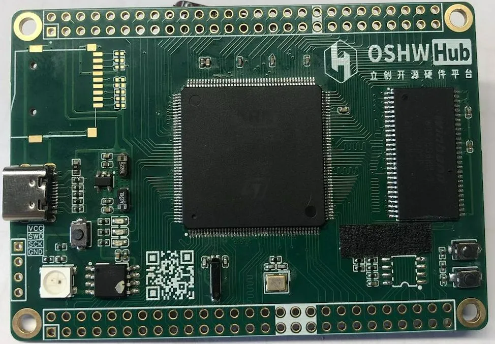

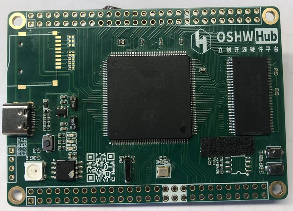

STM32H743IIT6 Core Board
The STM32H743IIT6 core board
features Winbond's SDRAM and NOR flash memory.
The 3.3V power supply uses a 1A LDO, which is just sufficient for normal testing; it would be better to replace it with a DC-DC power supply.
