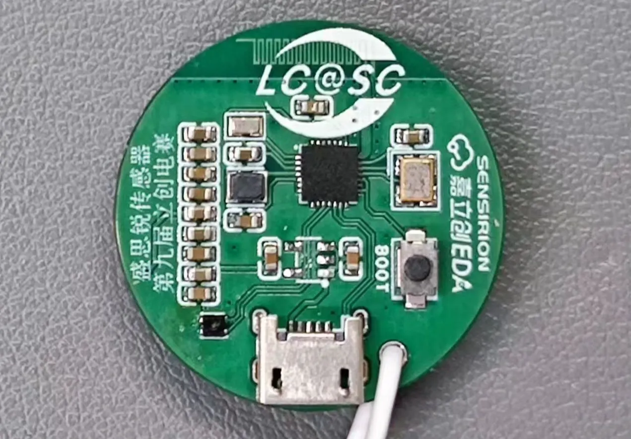

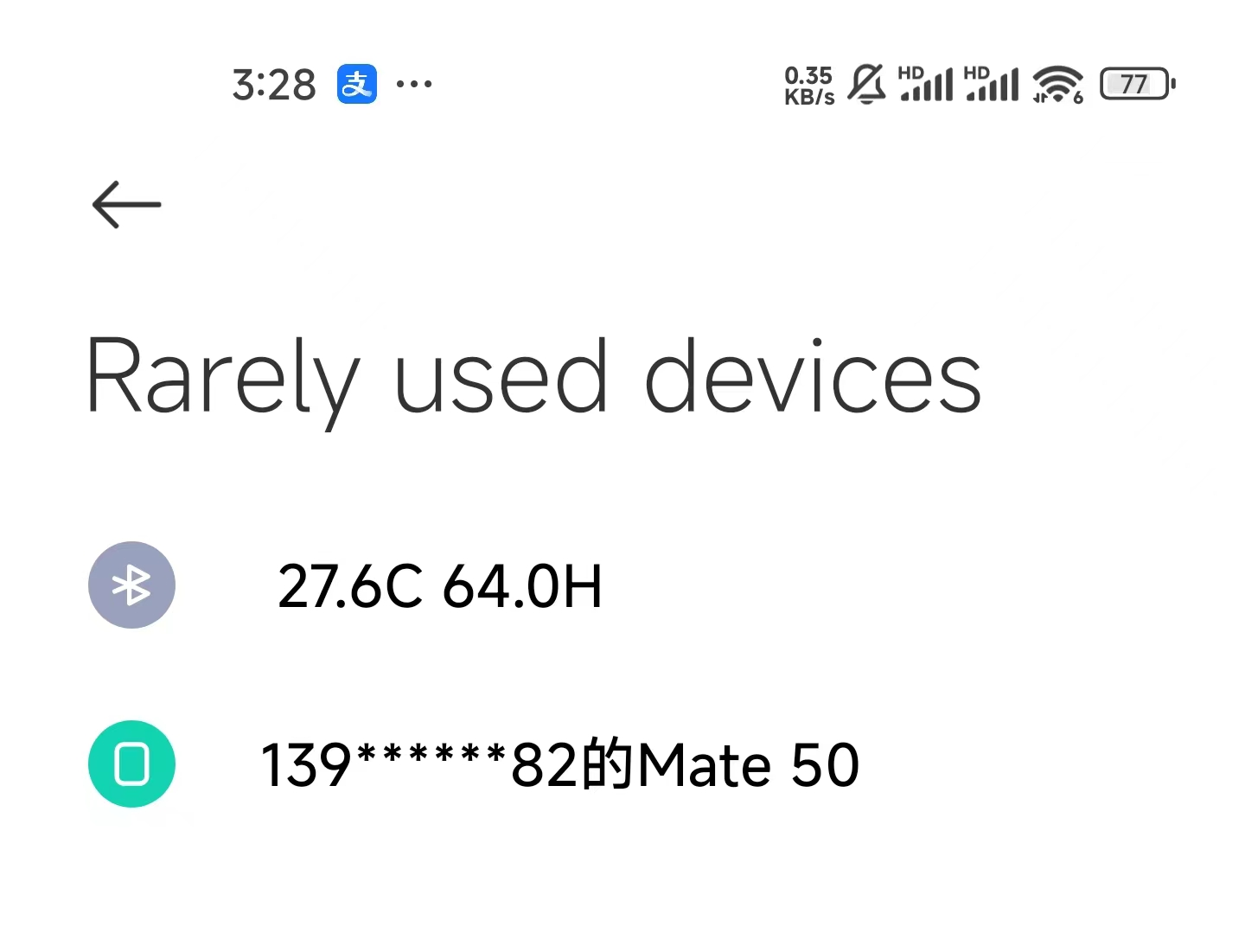

* 1. Project Function Introduction:
A wireless temperature and humidity sensor that can detect the current ambient temperature and humidity data in real time and broadcast it via Bluetooth. Users can then search for nearby Bluetooth devices to view the data using their mobile phones. Supports Android and Apple phones, but not computers.
* 2. Project Attributes:
Version 1: Uses CH571R main controller, easy to solder, but with higher power consumption (60% higher than Version 2).
Version 2: Uses CH582F main controller, adds external DC-DC circuitry, reduces power consumption, and improves Bluetooth performance.

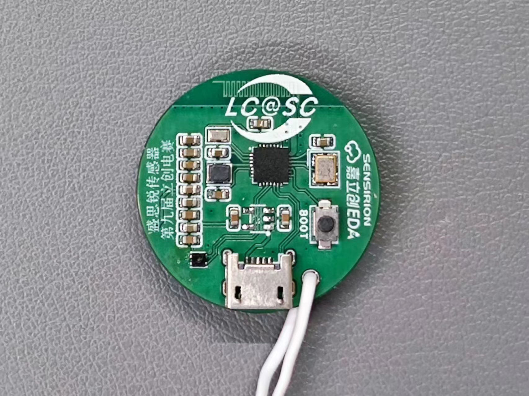

* 4. Hardware
: Main Microcontroller: CH571R/CH582F
; Sensor: SHT40;
PCB Prototype: 1.2mm thick

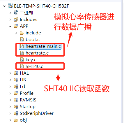

* 5. Software:
The project is as follows, mainly consisting of two parts.
* Mount River Studio: You can open the attached project and modify it yourself.
*WCHISPTOOL software: Used for firmware flashing. The firmware is located in the obj directory.
