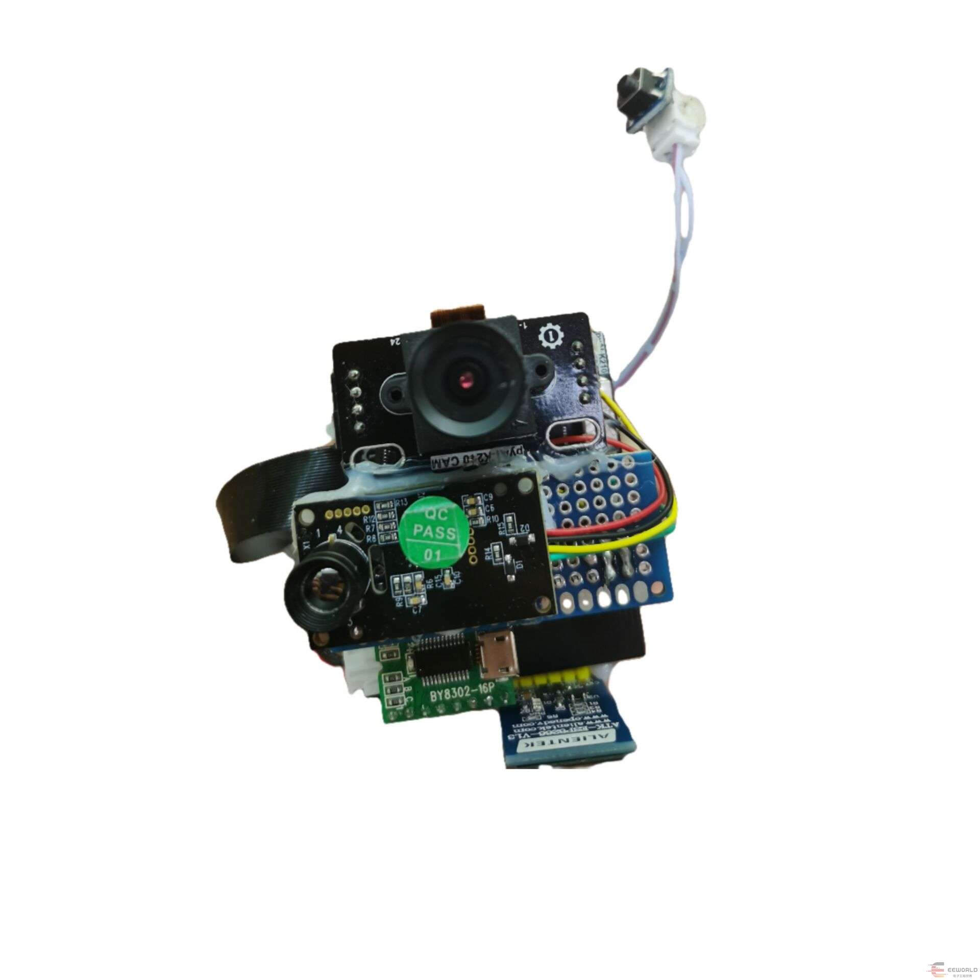

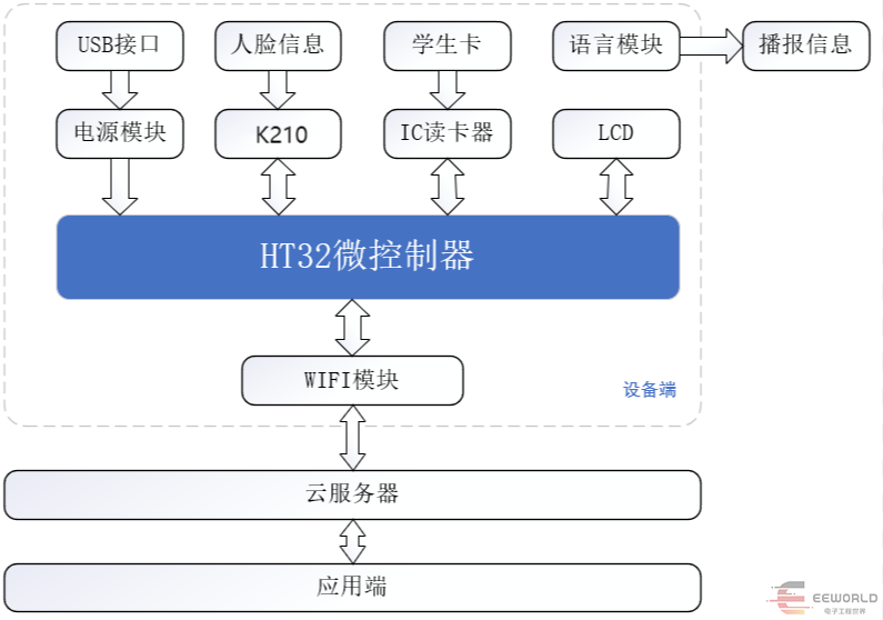

This work is a thermometer based on face recognition. The appearance of the work is a temperature measuring gun. The work is mainly composed of the K210 kit provided by Sipeed, Hetai HT32F52352 chip, WIFI communication module, cloud server, IC card reader module and LDO power module. etc., the K210 is controlled by the HT32 chip to collect images in real time, and the collected images are processed locally. If there is facial information in the collected images, the facial features are extracted based on the face model, and then compared with the person in the image library. Compare the feature values ​​of the face, and return the recognition results to the HT32 chip and the host computer for us to view the temperature measurement results. The following is a physical picture of the overall work and an introduction to its functions. Communicate directly with the author: http://bbs.eeworld.com.cn/thread-1221383-1-1.html
