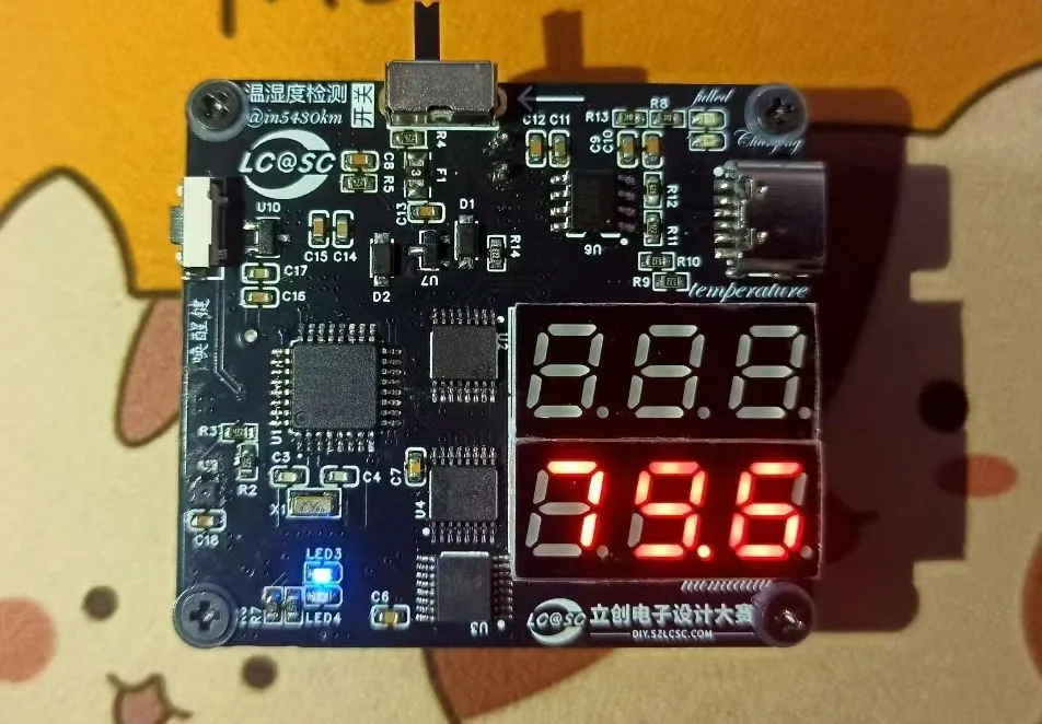

* 1. Project Function Introduction:
The temperature and humidity measuring instrument project uses the STM32G030K6T6 chip as the main control chip, with an Arm Cortex-M0+ core, a maximum clock frequency of 64MHz, 32KB of Flash, 8K of SRAM, and a power supply voltage of 2.0V~3.6V.
It uses IIC communication to collect temperature and humidity data from the SHT40 sensor and displays the data through a digital tube.
During idle time, it enters a low-power sleep mode; pressing a button enters normal operation mode, and after operation, it automatically enters low-power sleep mode, waiting to be woken up by pressing a button.
It is powered by a lithium battery, with an onboard dual power supply automatic switching circuit: lithium battery (3.0-4.2V) and Type-C power supply (5V).
The Type-C interface is used to charge the lithium battery and power the operating circuit.

The digital tube driver circuit
consists of three 74HC595 chips to display two three-digit digital tubes.
One 74HC595 chip is used to control the common cathode port of the digital tube LED, and the other two 74HC595 chips are used to control the positive port of the digital tube.
When LEDx_n (x: 1-2, n: AH) outputs a high level and LEDx_DIGn (x: 1-2, n: 1-3) is controlled to a low level, the corresponding LED inside the digital tube is turned on, i.e., lit.
