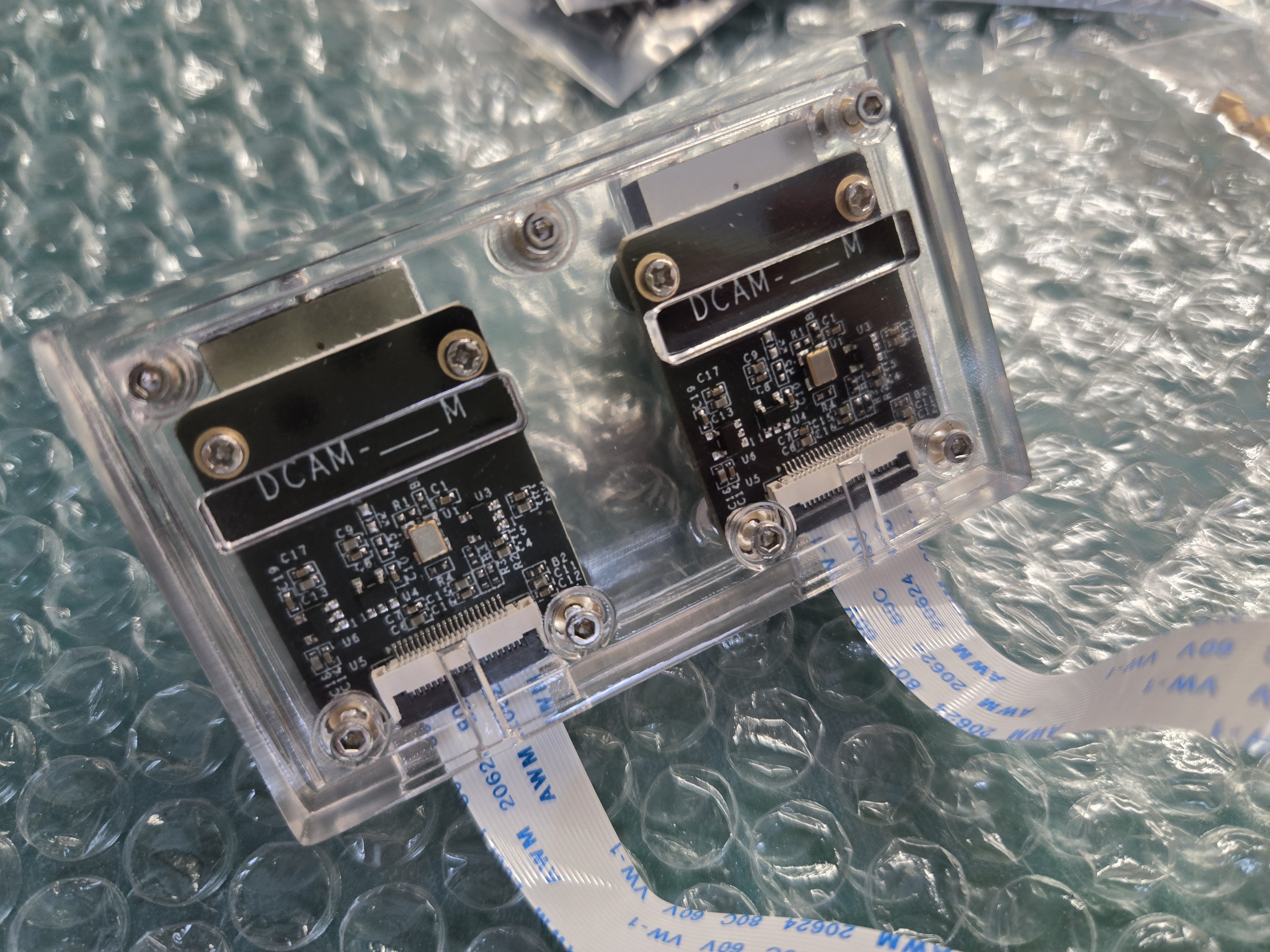

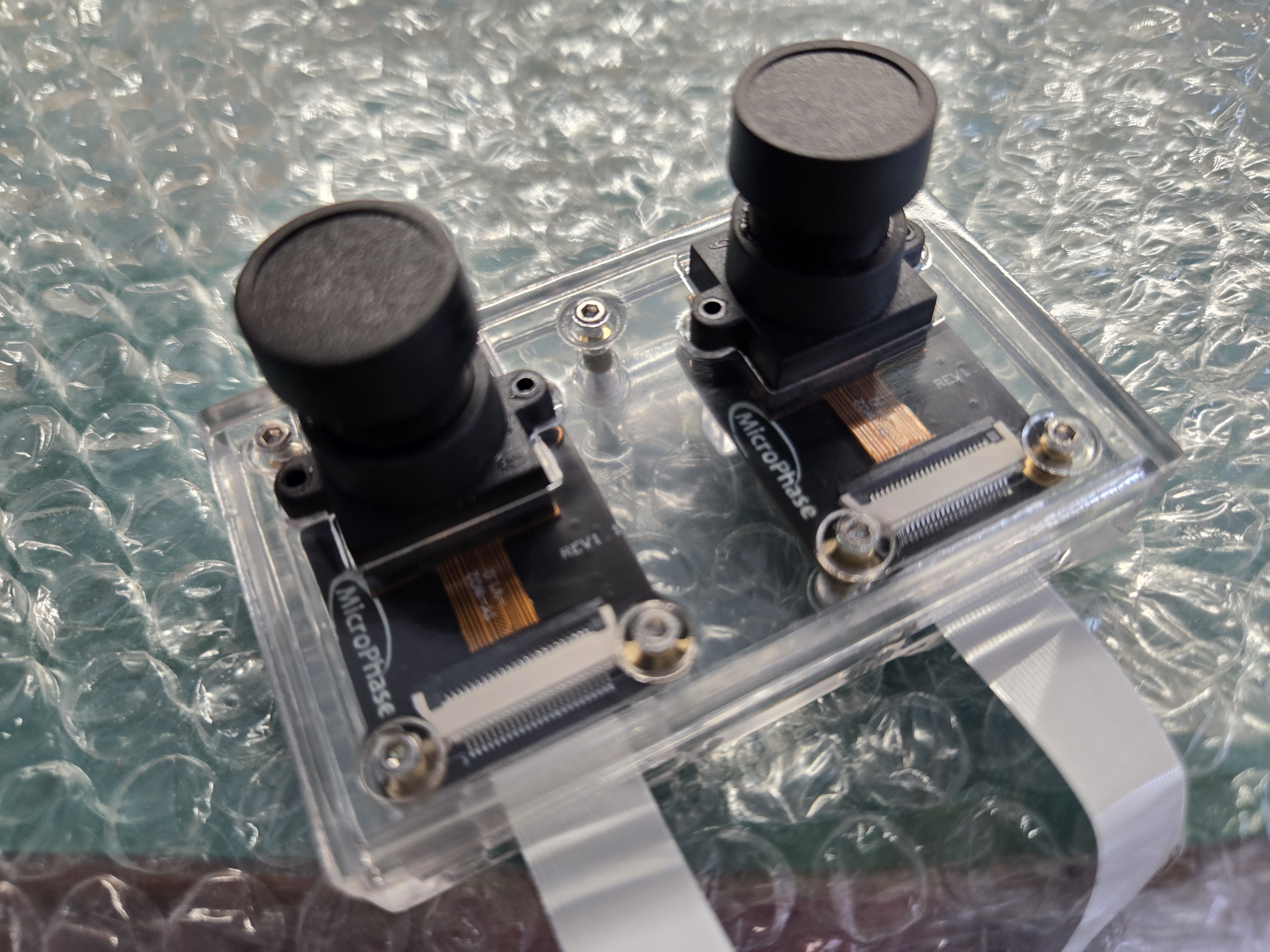

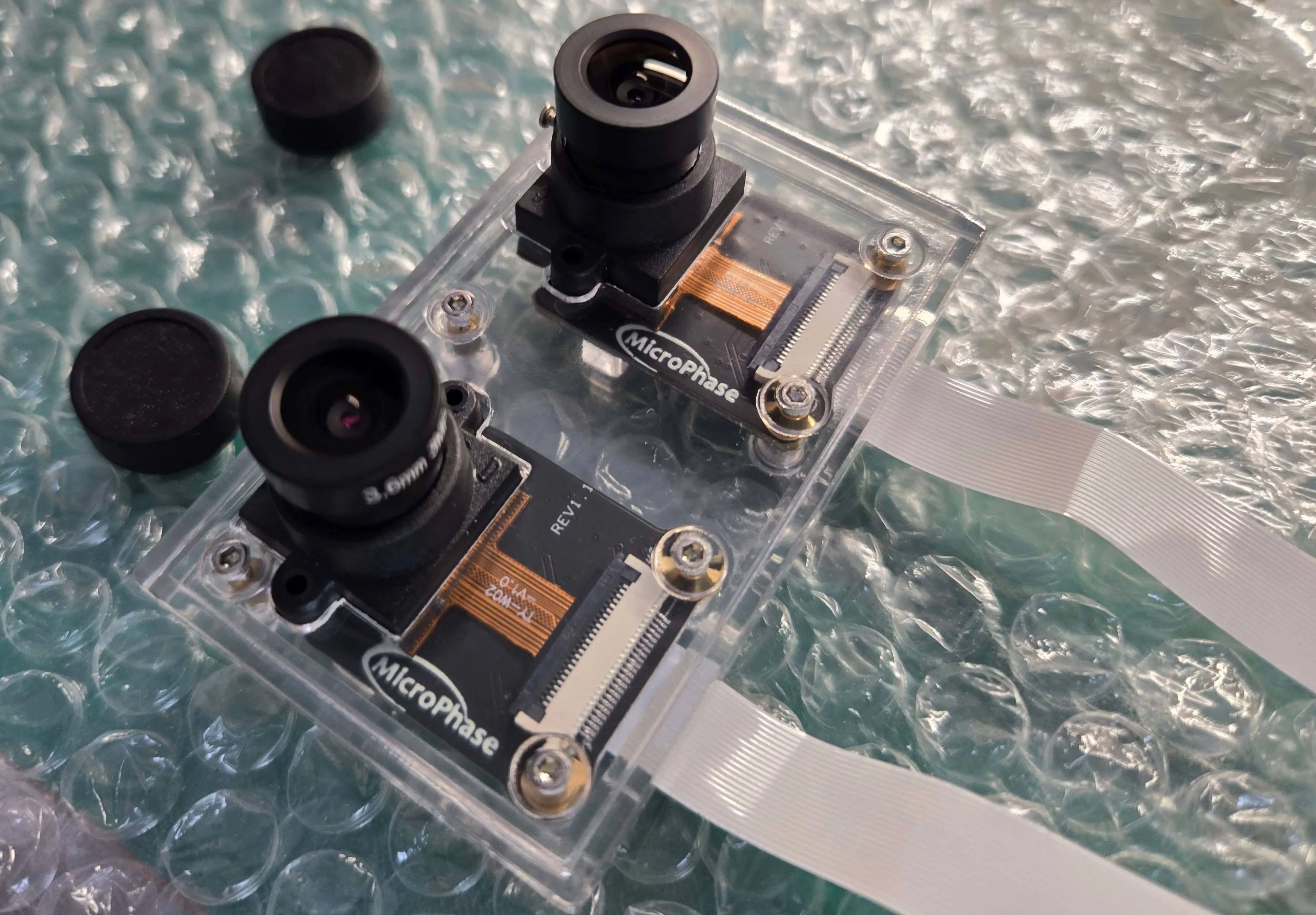

3D rendering of the casing for the Microphase OV5640 camera
The Microphase OV5640 camera module casing does not include the circuitry (the camera is shown in the demonstration); only a 3D rendering of the casing is shown below:

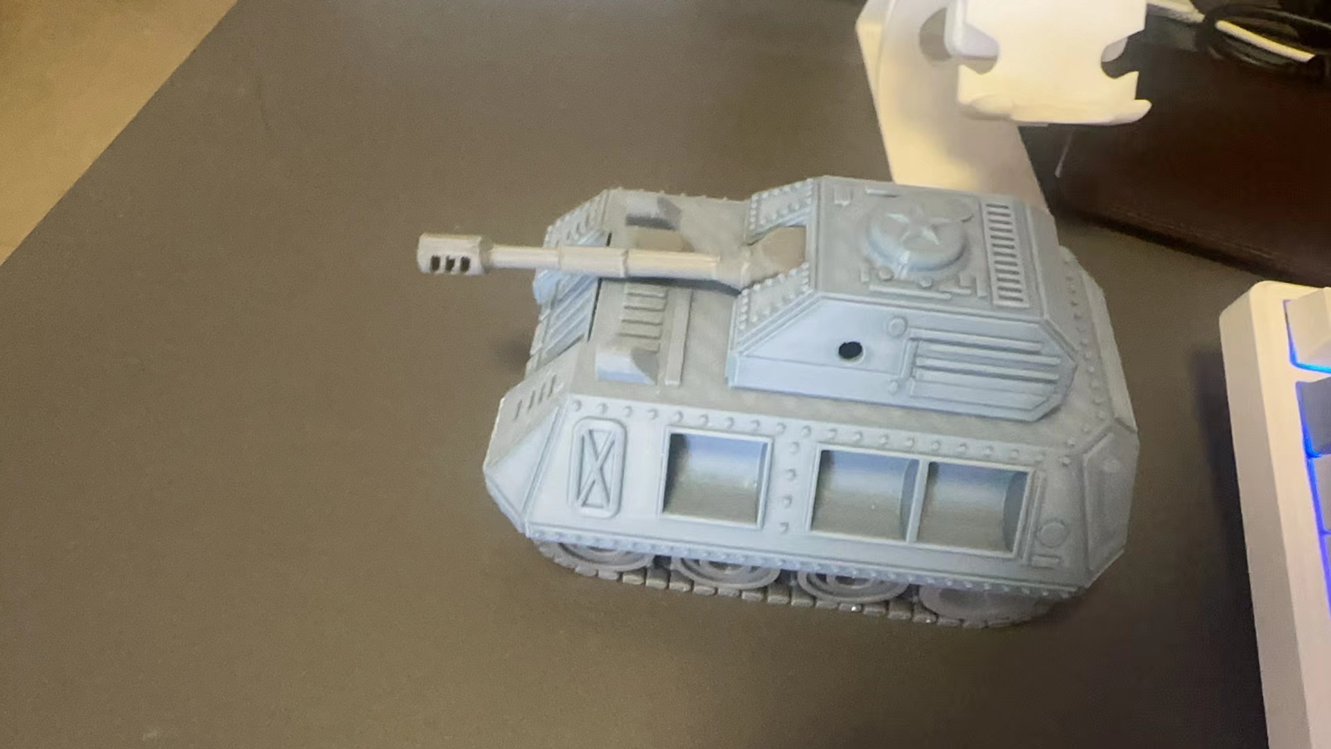

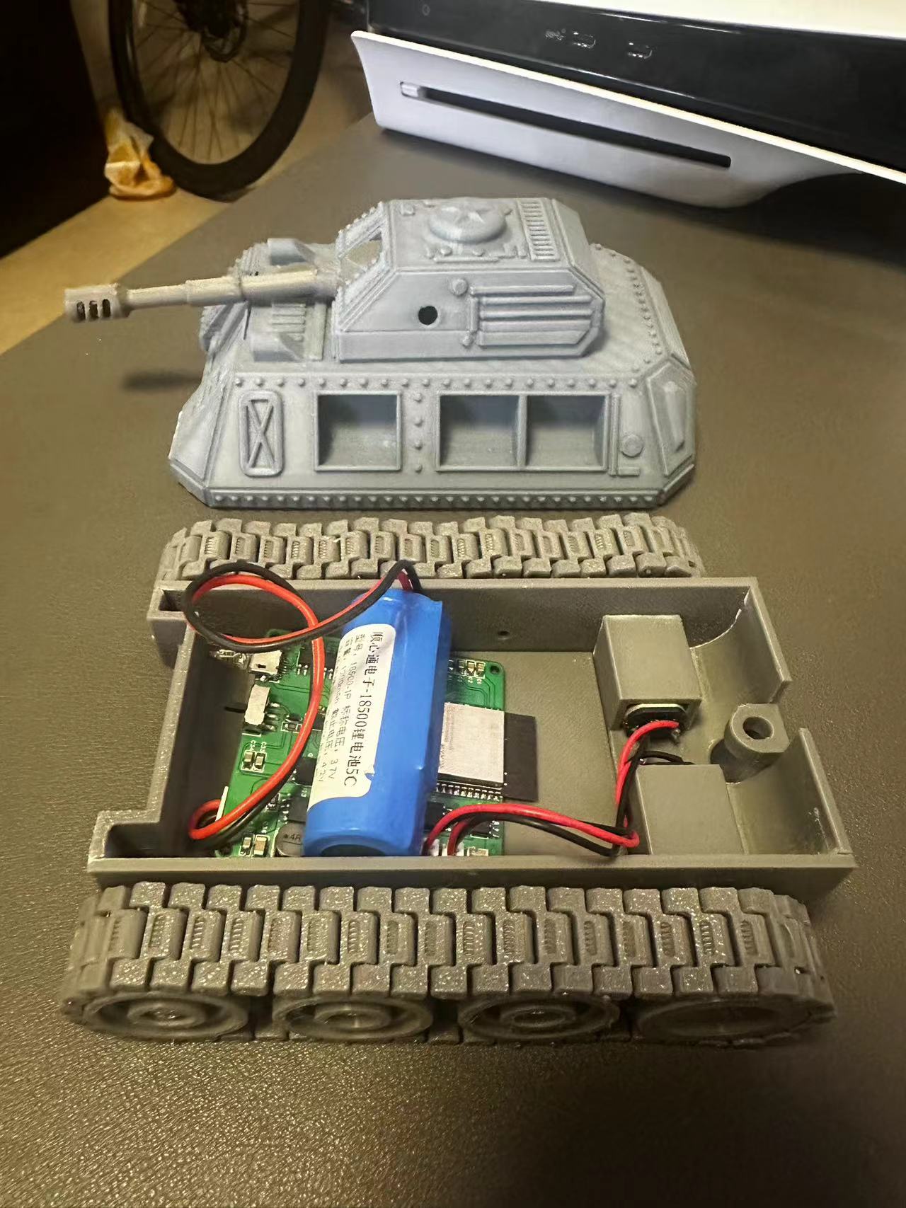

Static modification drive plate for Tiger tank model
I saw a tank
model drawn by a Bilibili user and printed one out myself. It's quite small and uses an N20 geared motor. The turret's rotation is controlled by the geared motor.
The motor drive uses an L9110s motor driver chip, and it's powered by a single 18500 lithium battery. A boost circuit converts the voltage to around 7.4V to power the motor. The main controller is an ESP32, and development using Arduion is simple and easy to learn. Currently, the code has only been tested with Bluetooth sending '1234' to control the motor's left and right rotation.

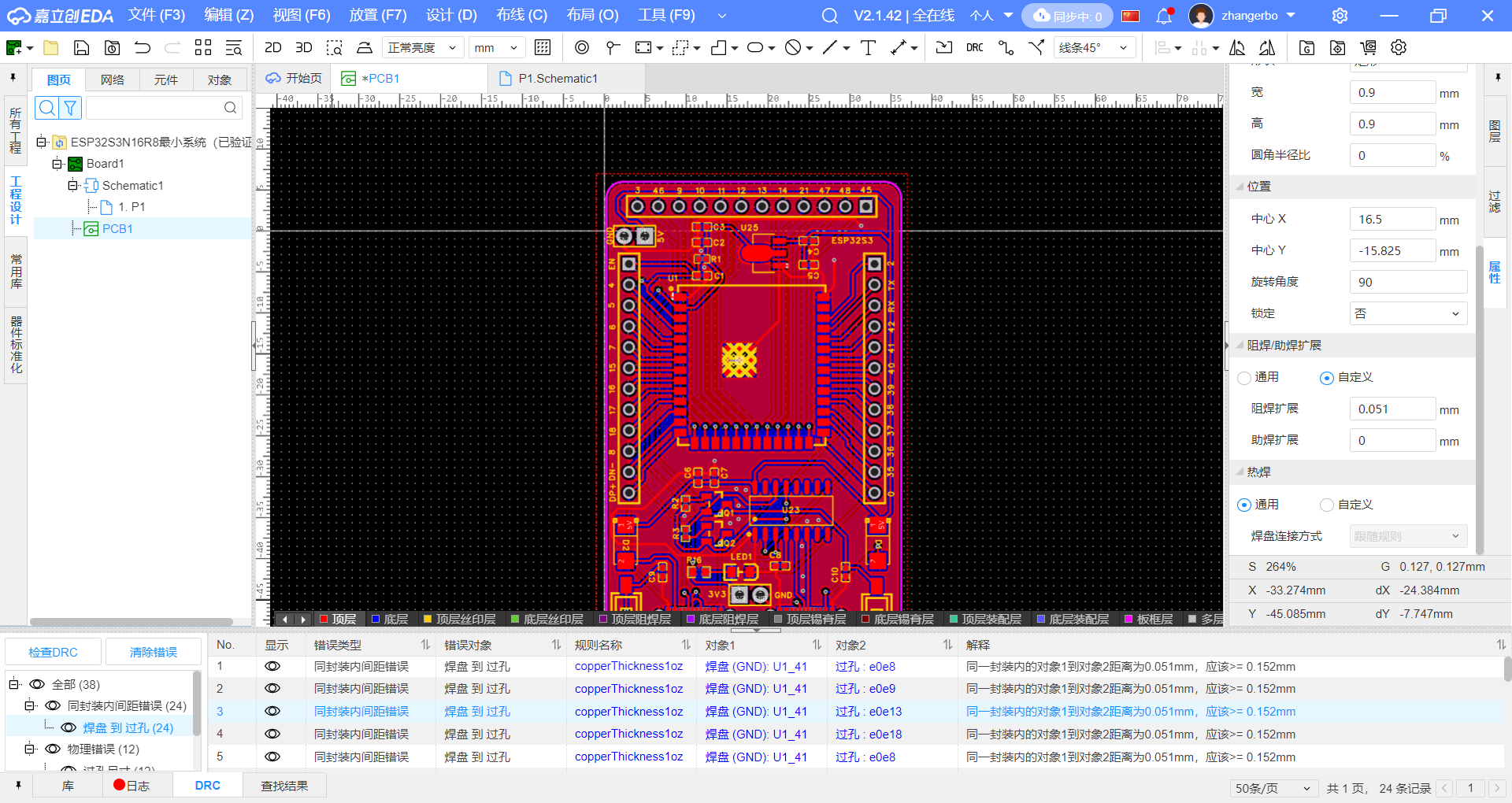

All pins of the ESP32-S3-N16R8 minimum system are exposed (verified).
The ESP32-S3-N16R8 minimum system board has been soldered and the program uploaded for verification.
This is an ESP32S3 N16R8 minimum system board. The soldered code and uploaded program verification are complete
. I initially just uploaded it casually for sharing, but I didn't expect so many people to see it. The first version had some minor omissions
. The new version adds a pair of 5V pins and a pair of 3V3 pins, and also adds the corresponding silkscreen information for the pins.
Regarding PCB design DRC errors, errors related to the pins in the center of the ESP32 chip can be ignored: as shown in the image below.
