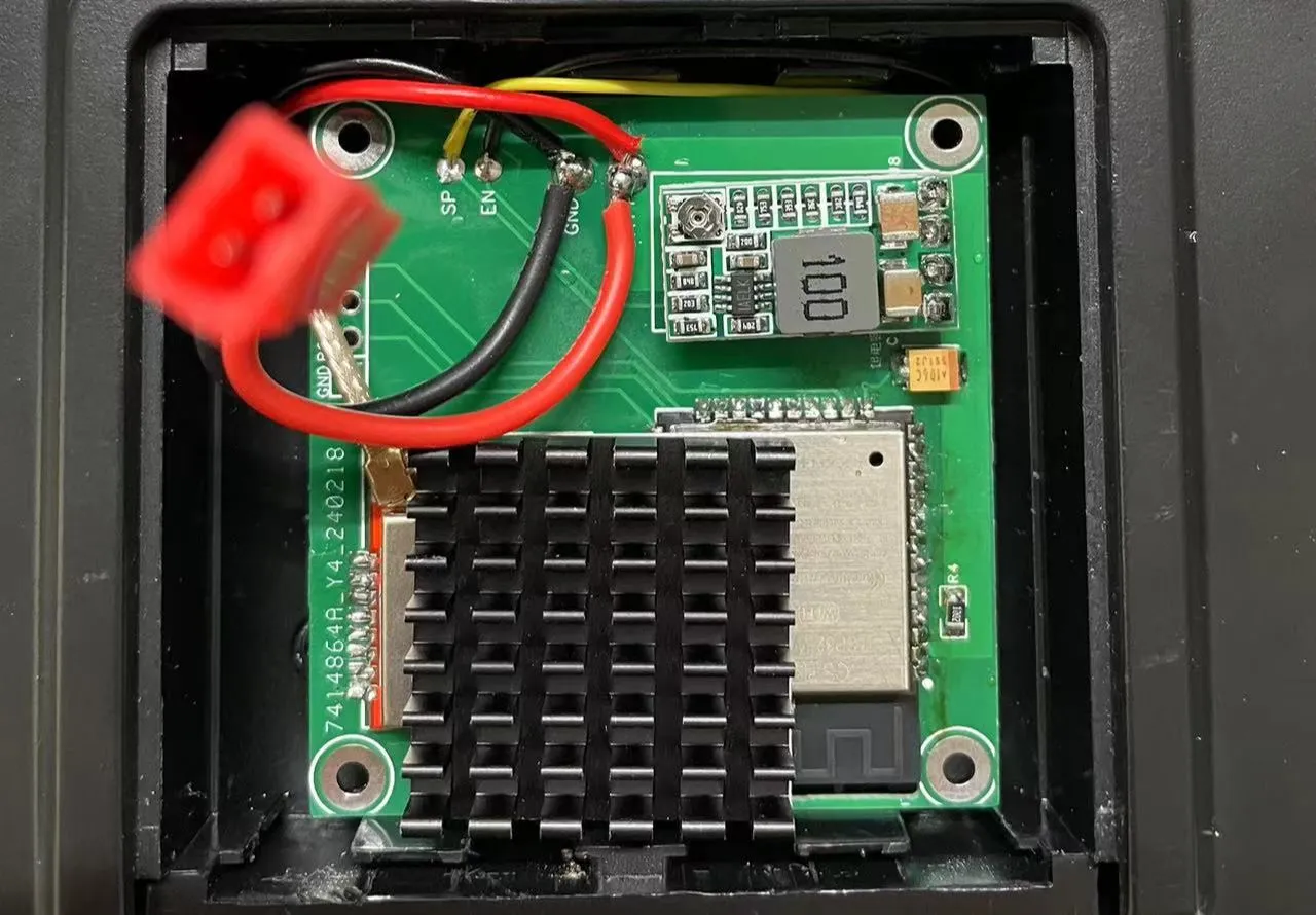

The Fuji i6x has a built-in ELRS high-frequency head.
The solution is adapted from https://oshwhub.com/vinvaa/elrs-e28m30s-esp32wroom. The size is just right to fit into the battery compartment. With the heat sink attached, it can run at 200mw without any problems.
