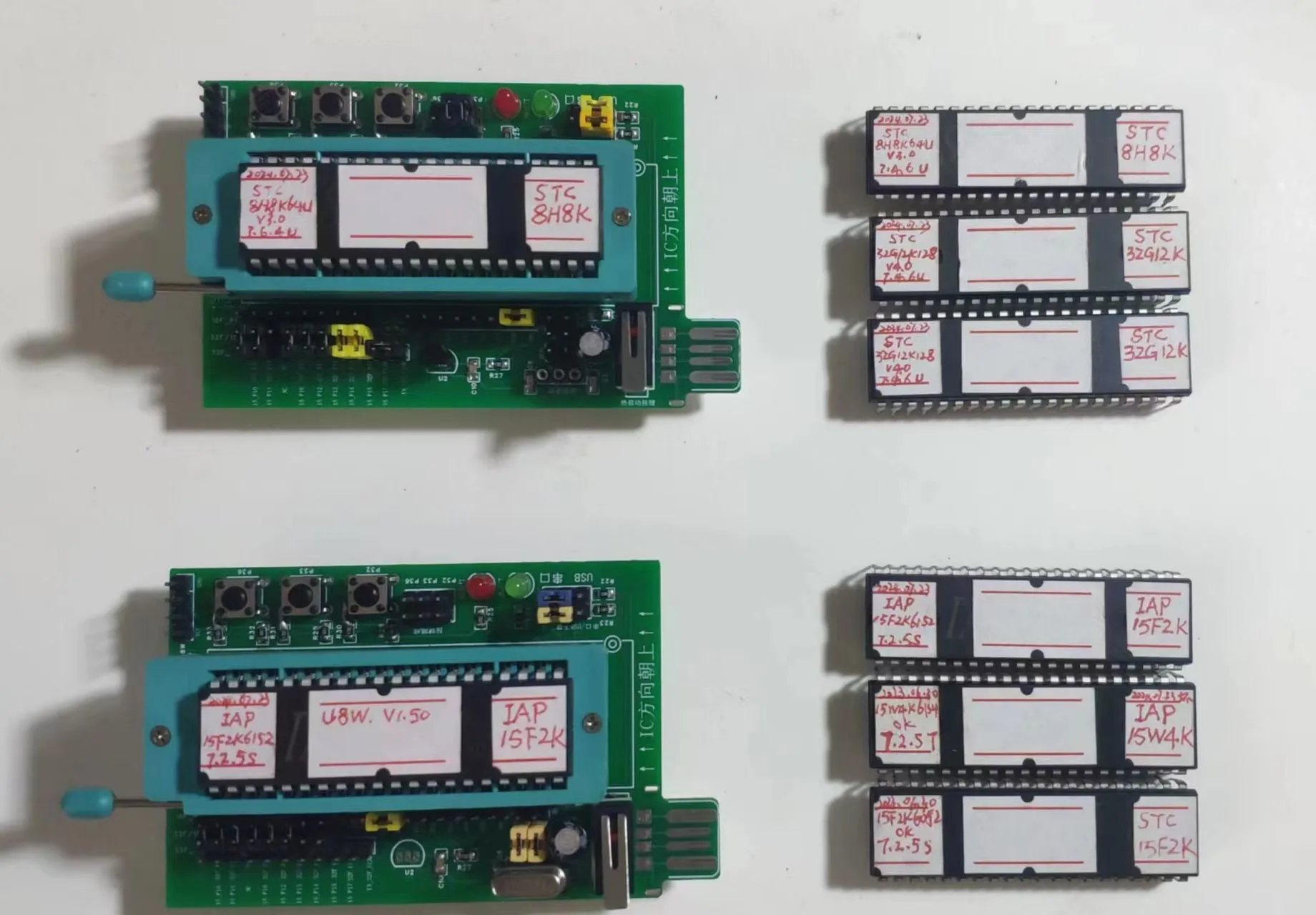

Therefore, the goal is to use a single adapter board for the STC 32F/32G/8H 15F/15W series DIP40 packages, enabling them to be used on traditional 8051 DIP40 development boards, allowing older development boards to use the latest microcontroller series.

Since I'm just starting to learn PCB design, the project involves four boards. I found a problem with V3 after creating the board, but it worked after manually modifying the jumpers.
V4 fixed the errors in V3 and optimized the circuitry, but I didn't create another board for it.
All the design functions have passed testing. The test video is too large to upload; please click the links to watch it on
