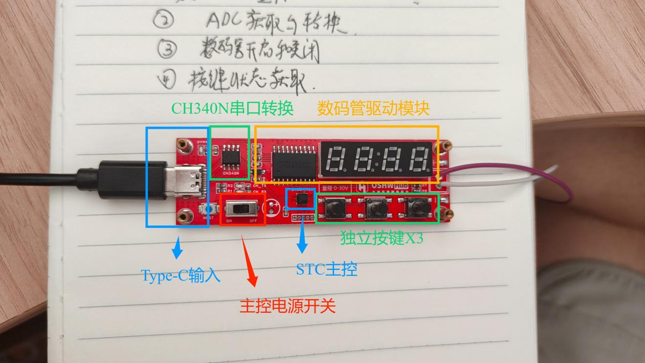

Button Description:
There are three buttons on the PCB, defined from left to right:
Button 1:
Turn the digital tube on/off. Clicking this button turns the digital tube on or off; the digital tube status does not affect voltage acquisition.

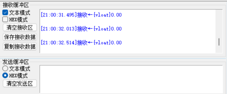

Button 2:
Enable serial port output. The device outputs real-time voltage acquisition data to the serial port via Type-C. Voltage changes can be viewed using a serial port plotter on the host computer.
Button 3:
Disable serial port output. The device will not send data to the serial port.
Power Switch :
The two-pin toggle switch on the PCB only controls the power supply to the main control chip STC8H1K08. The power supply for modules such as the digital tube and serial port converter is directly drawn from the Type-C port and is not controlled by this switch.

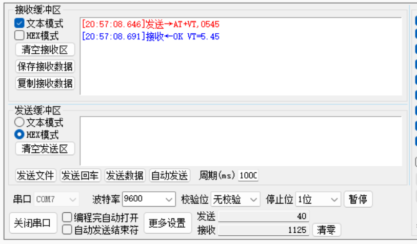

Serial Port Configuration Reference Voltage:
The device's voltage measurement is accomplished through the ADC pin of the 51 microcontroller and a voltage divider circuit. The ADC reference voltage is affected by the power supply voltage. Due to fluctuations in the power supply voltage (5.0±0.5), the measurement voltage error will increase. Therefore, the device can calibrate the reference voltage via the serial port.
Insert the device into the USB port, open the COM port, and use a serial port tool to send the command
"AT+VT,0545". The device will reply: "OK VT=5.45"
. The device has adjusted the reference voltage and saves the settings after power-down.
Note: The voltage is amplified 100 times from the reference voltage source and set using four digits. If the voltage source is 5.28V, the command is "AT+VT,0528".

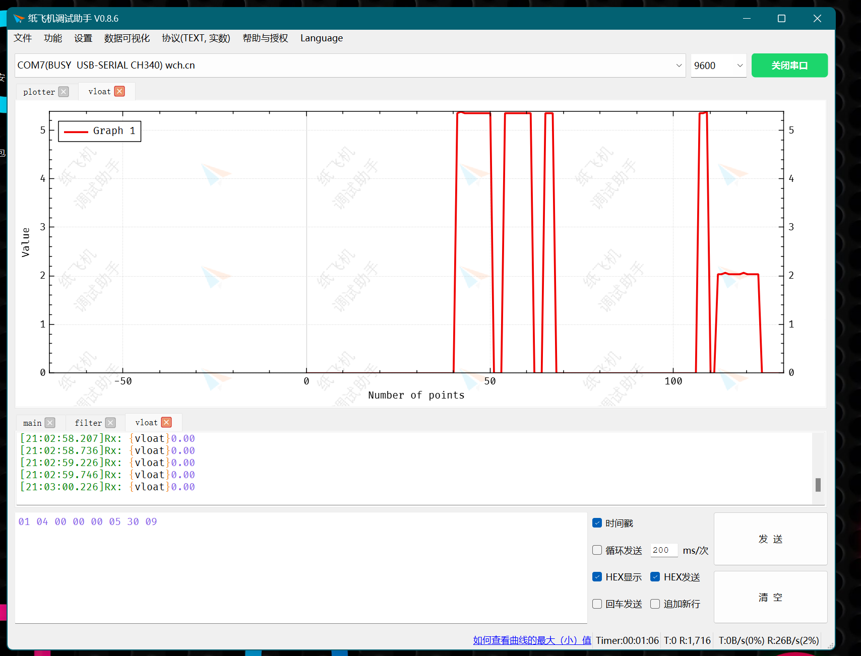

Use a serial port tool to plot voltage changes.
The device is connected to the ComAssistant serial port plotter; the output data has a fixed format that can be recognized and automatically plotted by the software.
Download address: Paper Airplane Debugging Assistant – Official Website (comassistant.cn)
Software tutorial: https://www.bilibili.com/video/BV1E3411E7vu

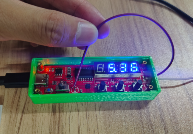

For the shell file:
The attached model source file is developed using SketchUp. Please enlarge by 102% when slicing and printing.
######### Burning frequency 12MHz ############
