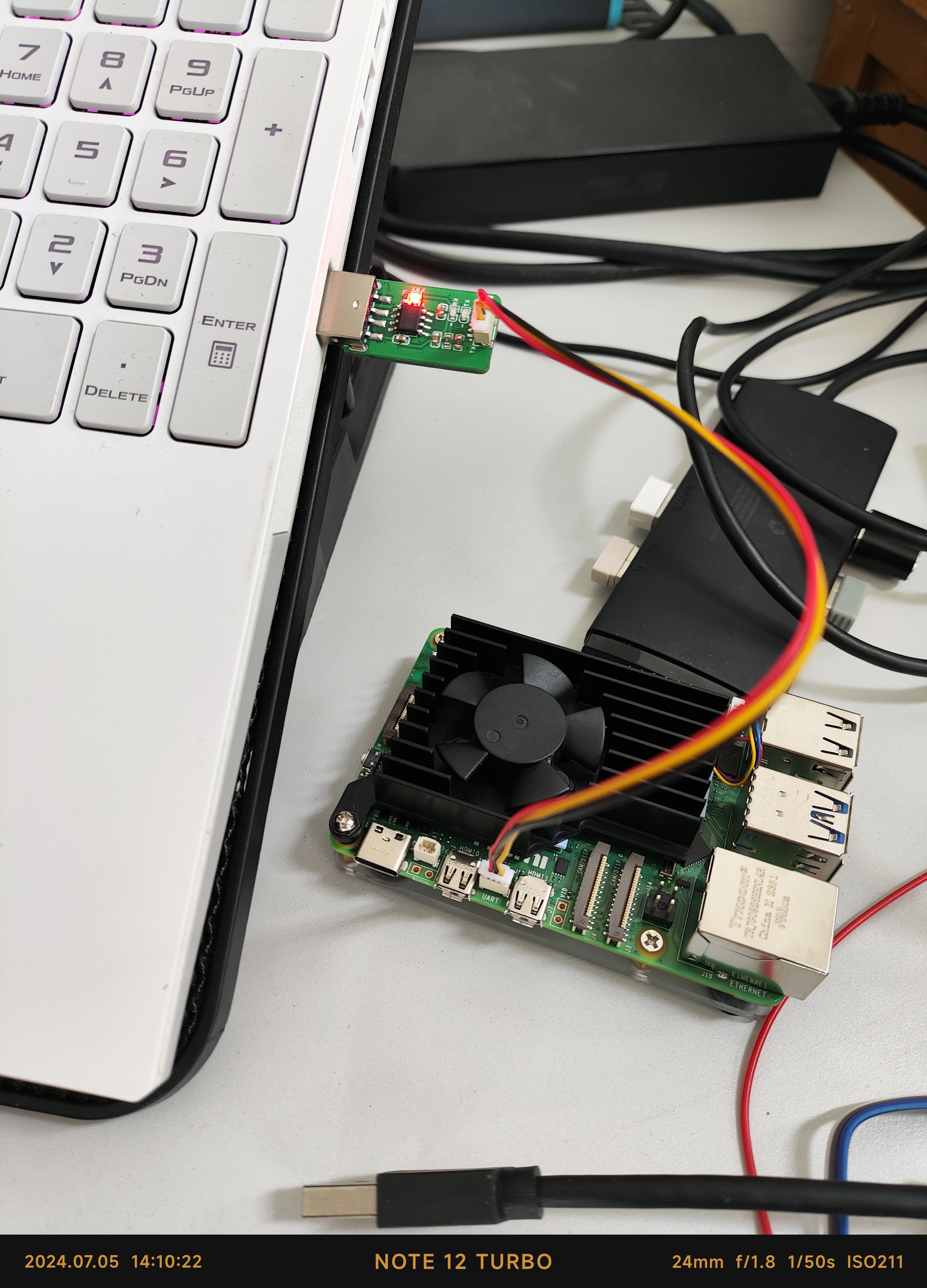

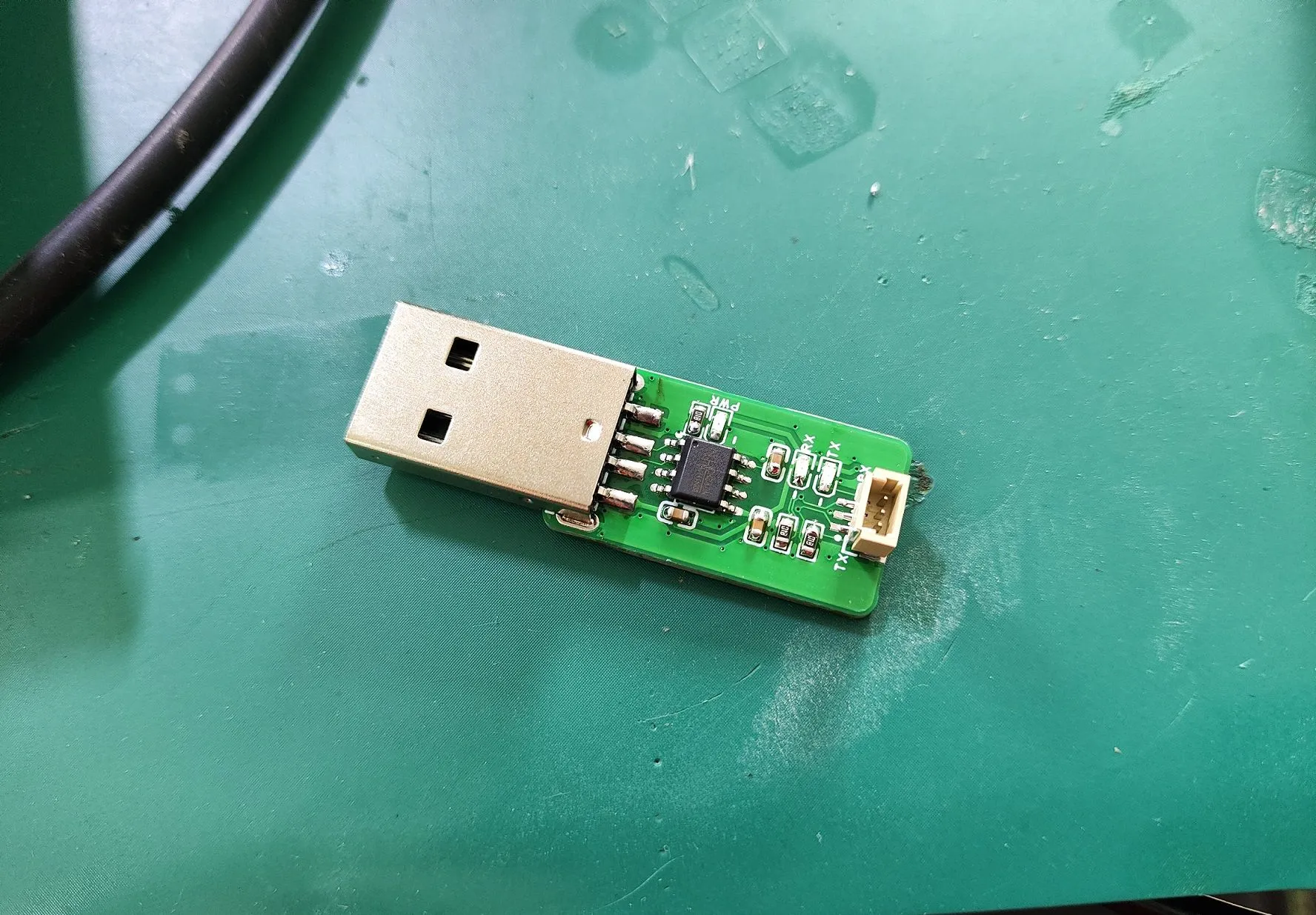

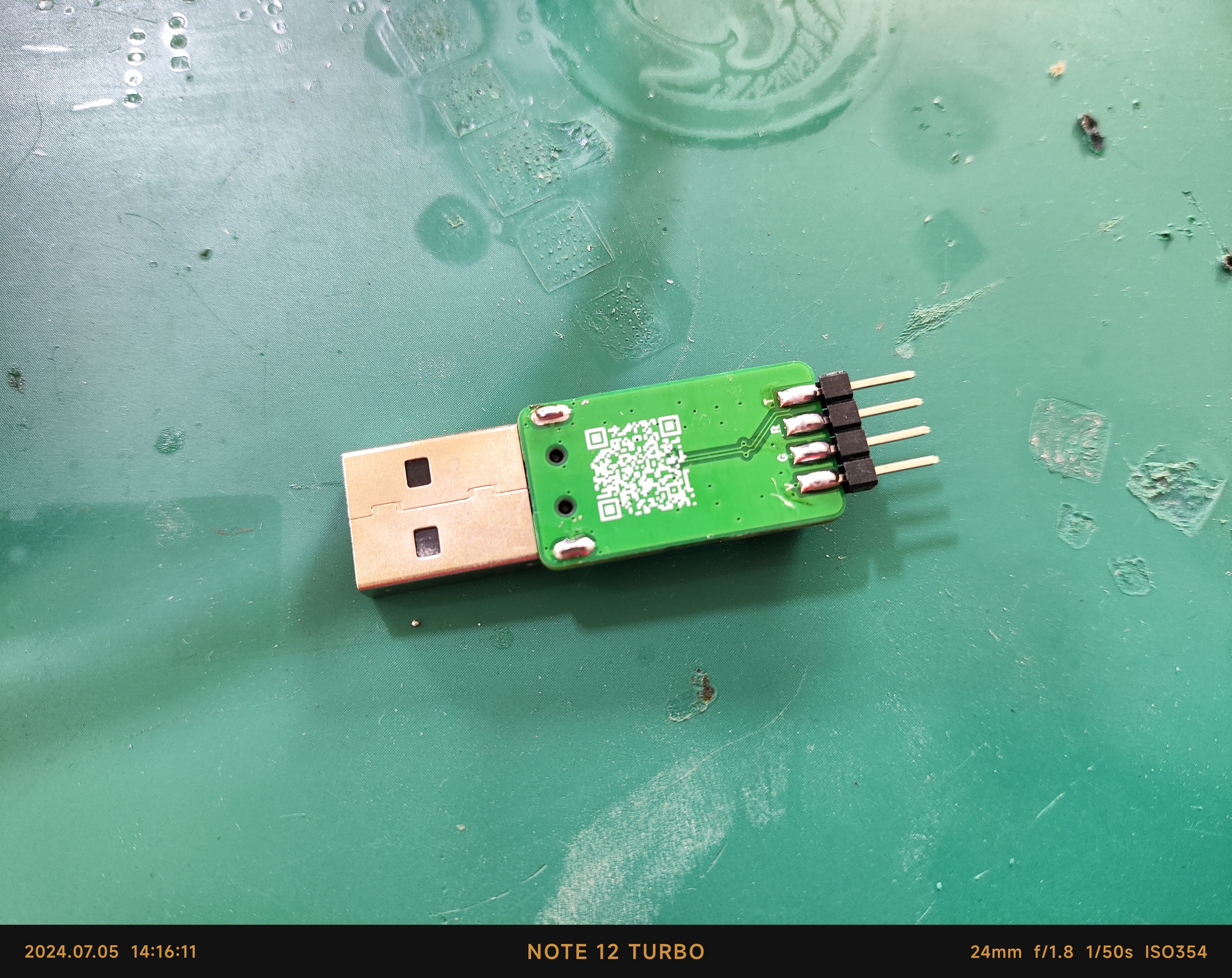

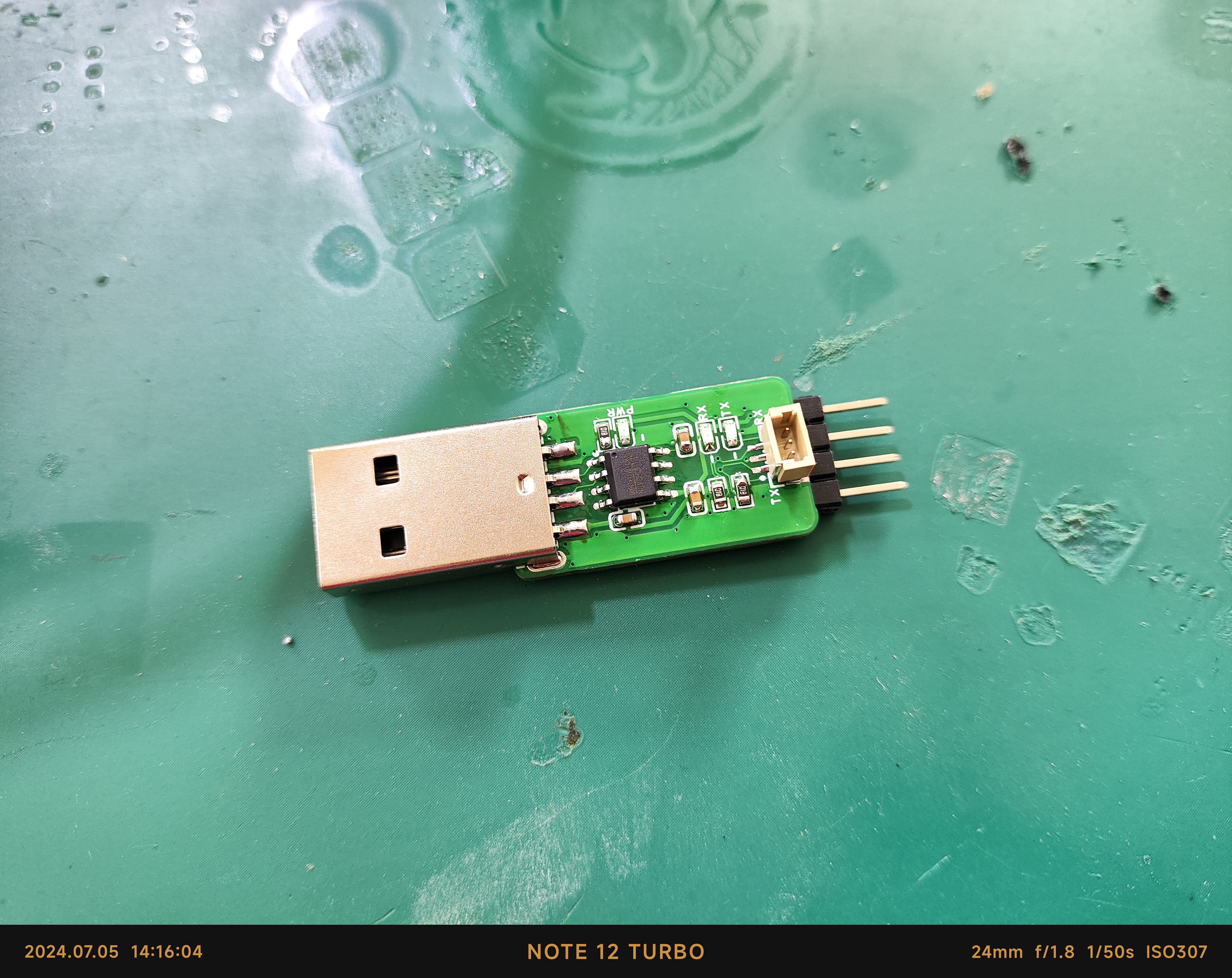

Based on the CH340N's debug serial port, an SH1.0 3P connector and a 2.54 4P header are provided. An SH1.0 3P dual-ended co-directional cable can be used to directly connect to the debug serial port of a Raspberry Pi 5.

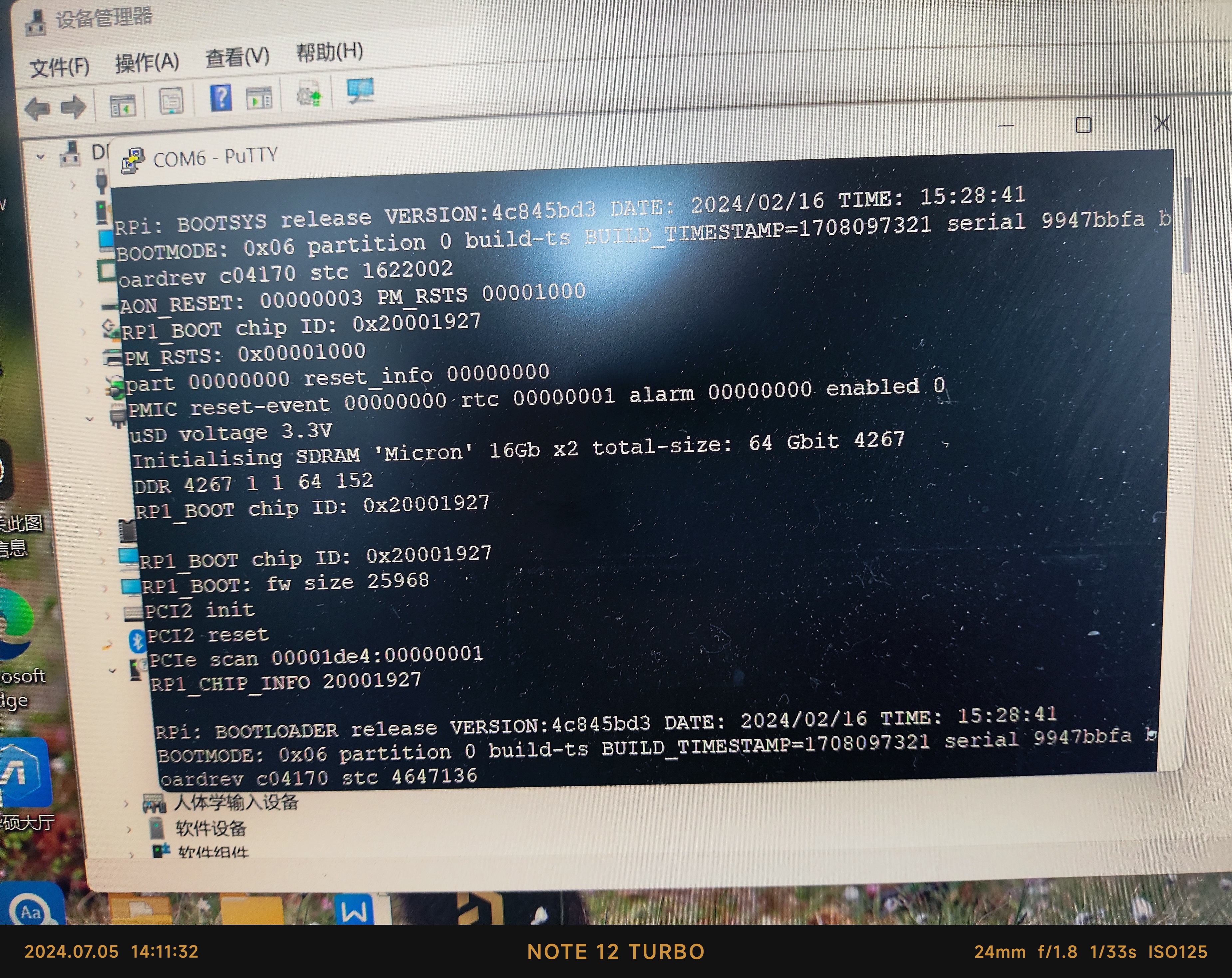

[Image 1720170189455.jpg] [Image 1720170189349.jpg] [Image 1720170189332.jpg] Verified to work on a Raspberry Pi 5.

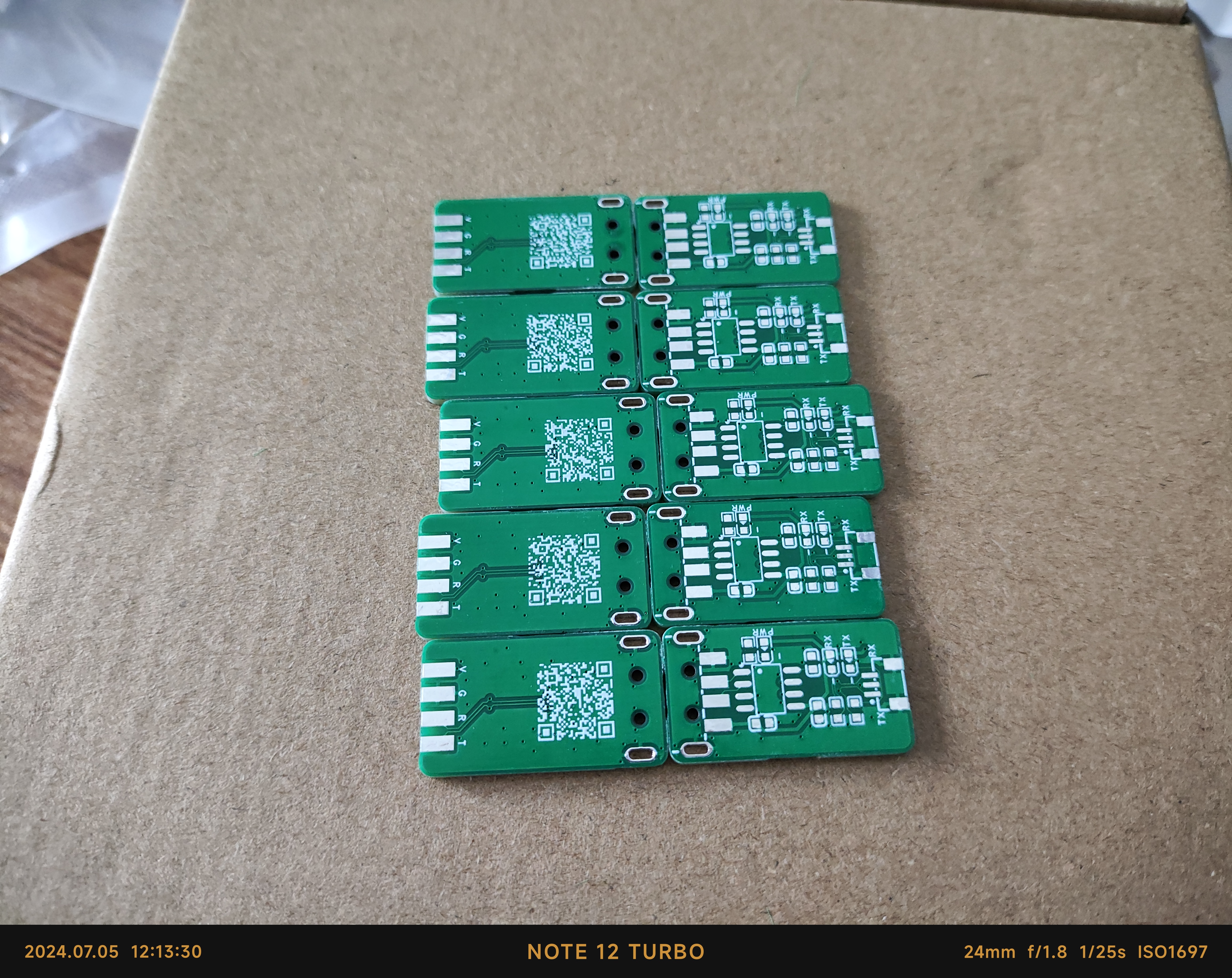

[Image 1720170189393.jpg] [Image 1720170189372.jpg] Note: The SH1.0 cable must be co-directional! Co-directional! Co-directional! Reverse-directional cables will not work!
