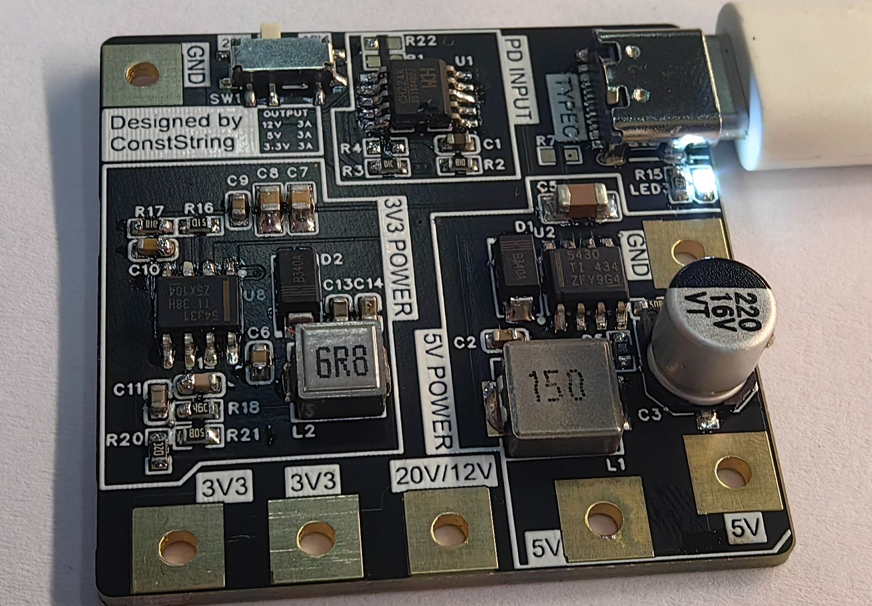

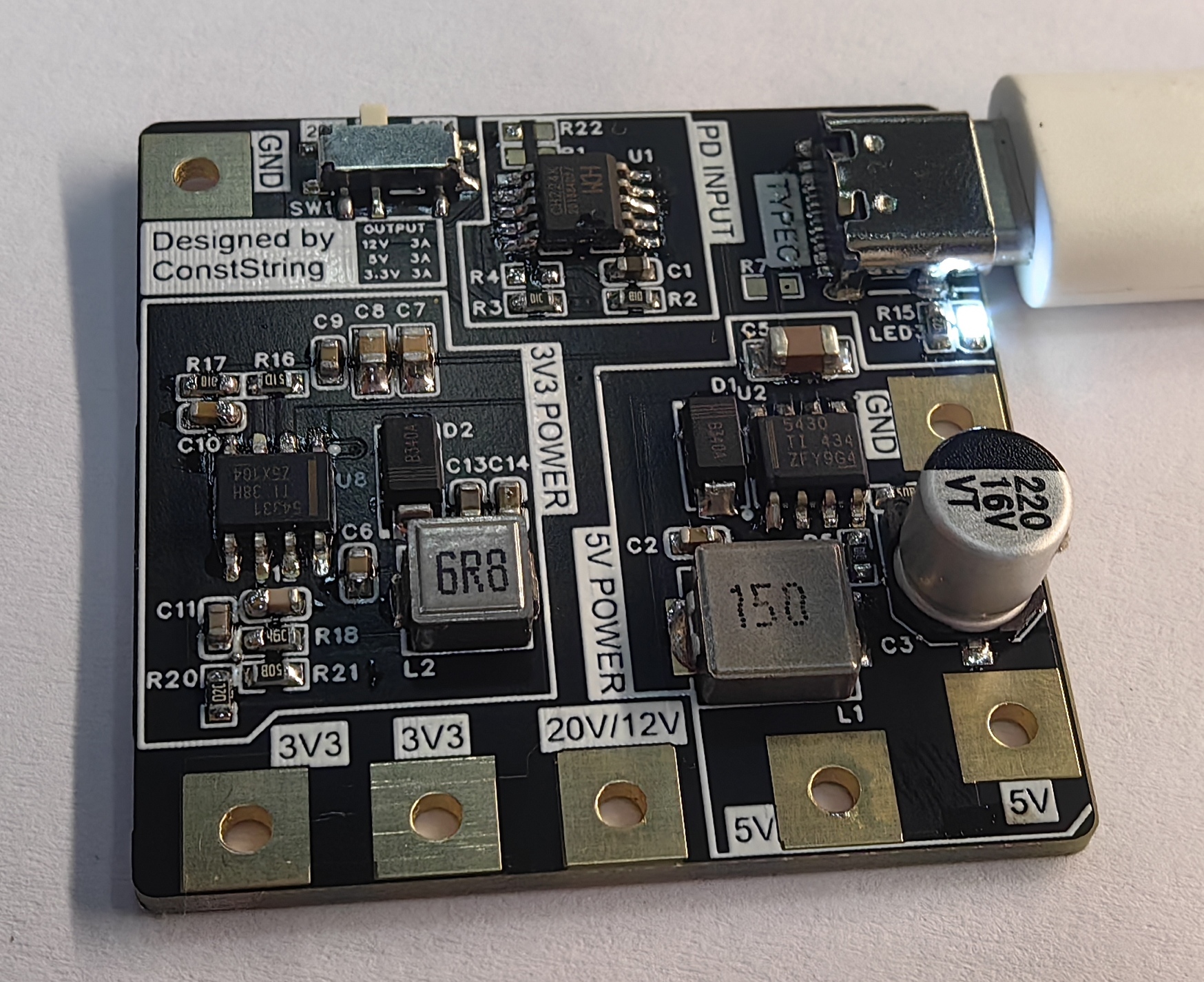

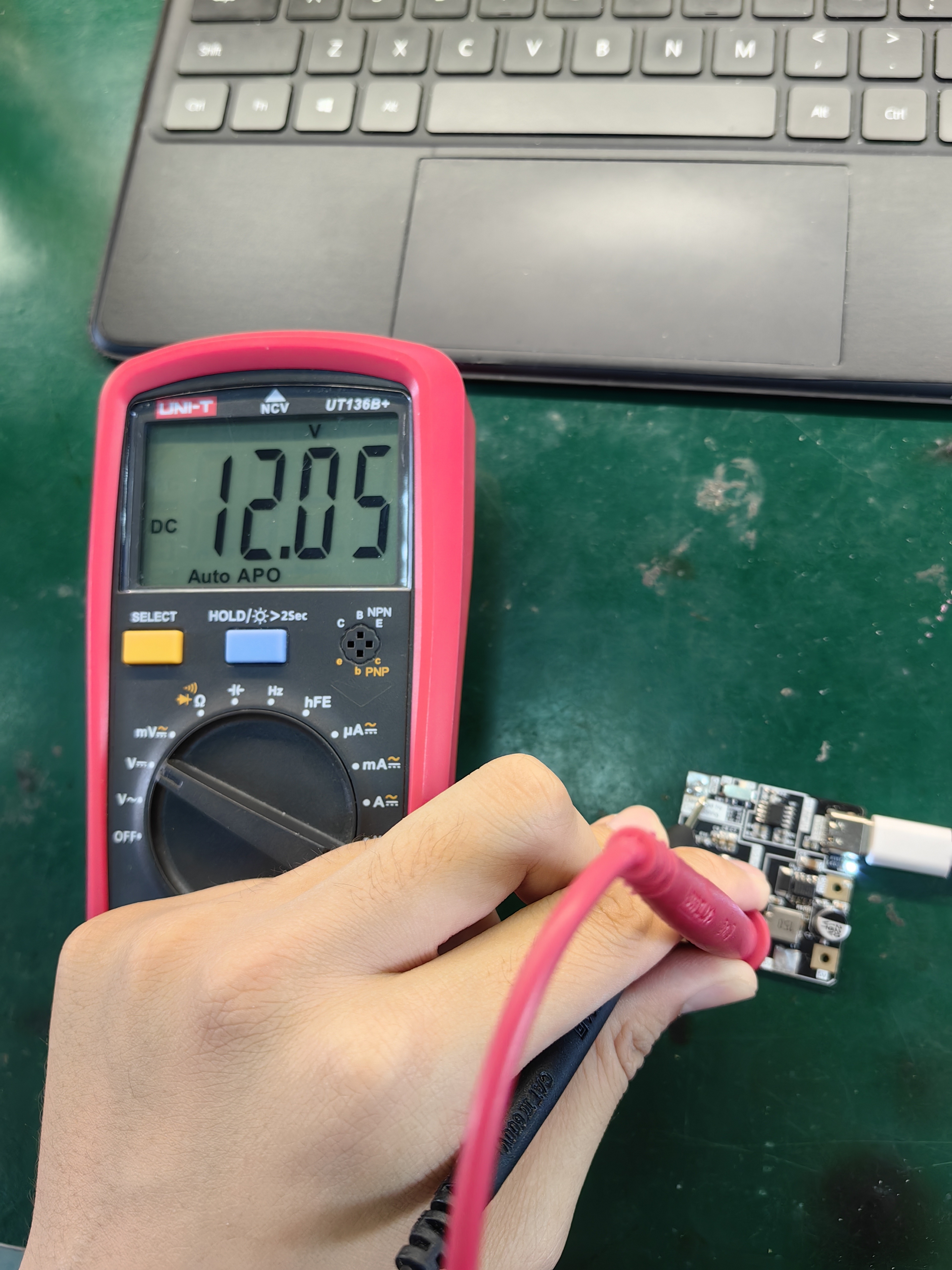

Utilizing the CH224K decoy PD input, it supports 12V/20V input and can simultaneously output 20V/12V, 5V, and 3.3V, with a maximum output current of 3A for each. It can be used for centralized power supply of power devices (such as rotary motors), microcontrollers, sensors, and other equipment. Only a single Type-C data cable is needed for all power supply, reducing wiring complexity and improving design aesthetics.
Material selection and layout are based on the datasheet.
Charger requirements:
The charger must have at least 20V 3.25A output (generally a 65W PD charger). It does not currently support proprietary protocols such as Huawei's.
Usage:
Select 12V or 20V trigger voltage using a toggle switch. Whether using 12V or 20V, the 5V and 3.3V outputs will not be affected.

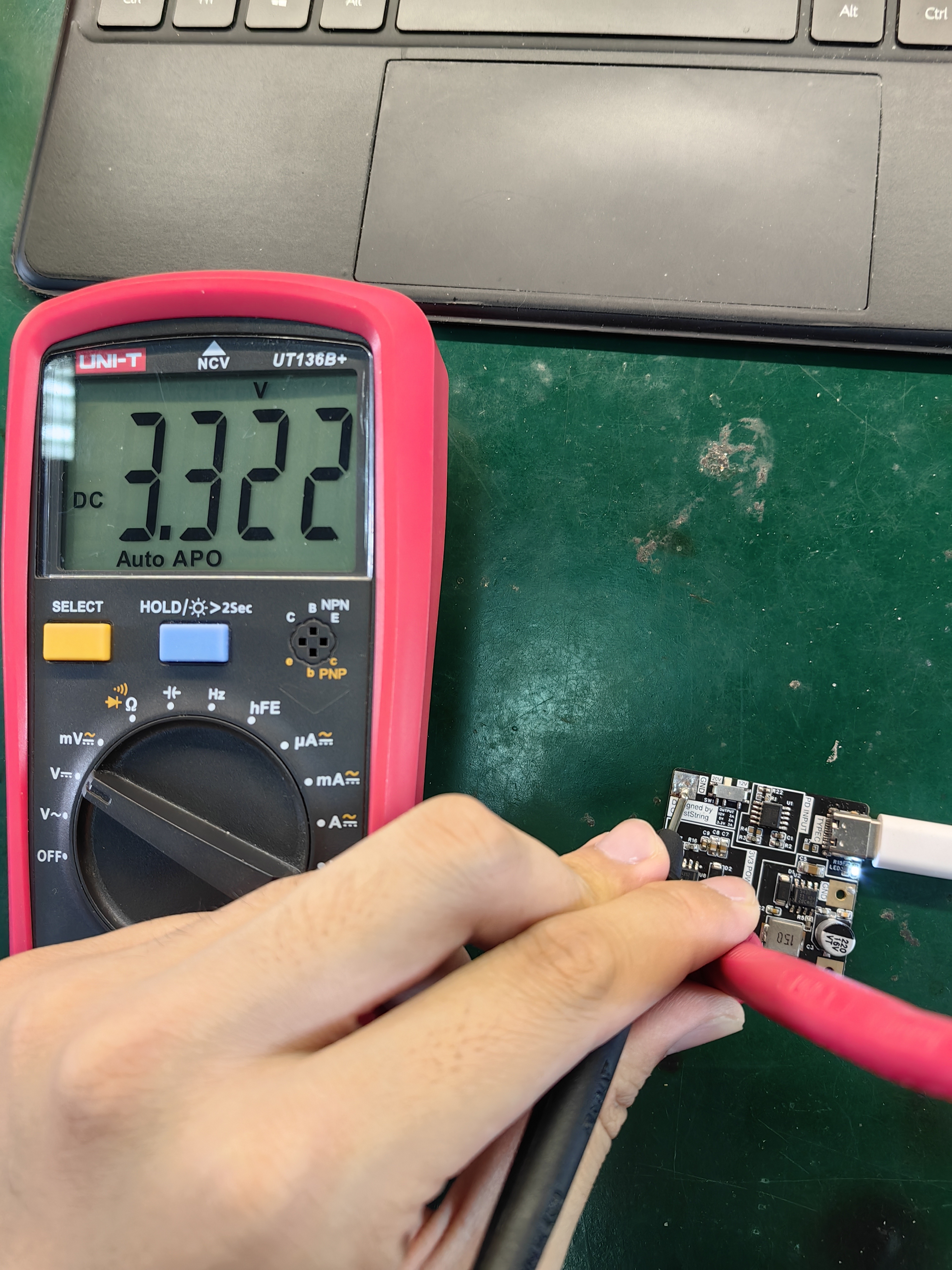

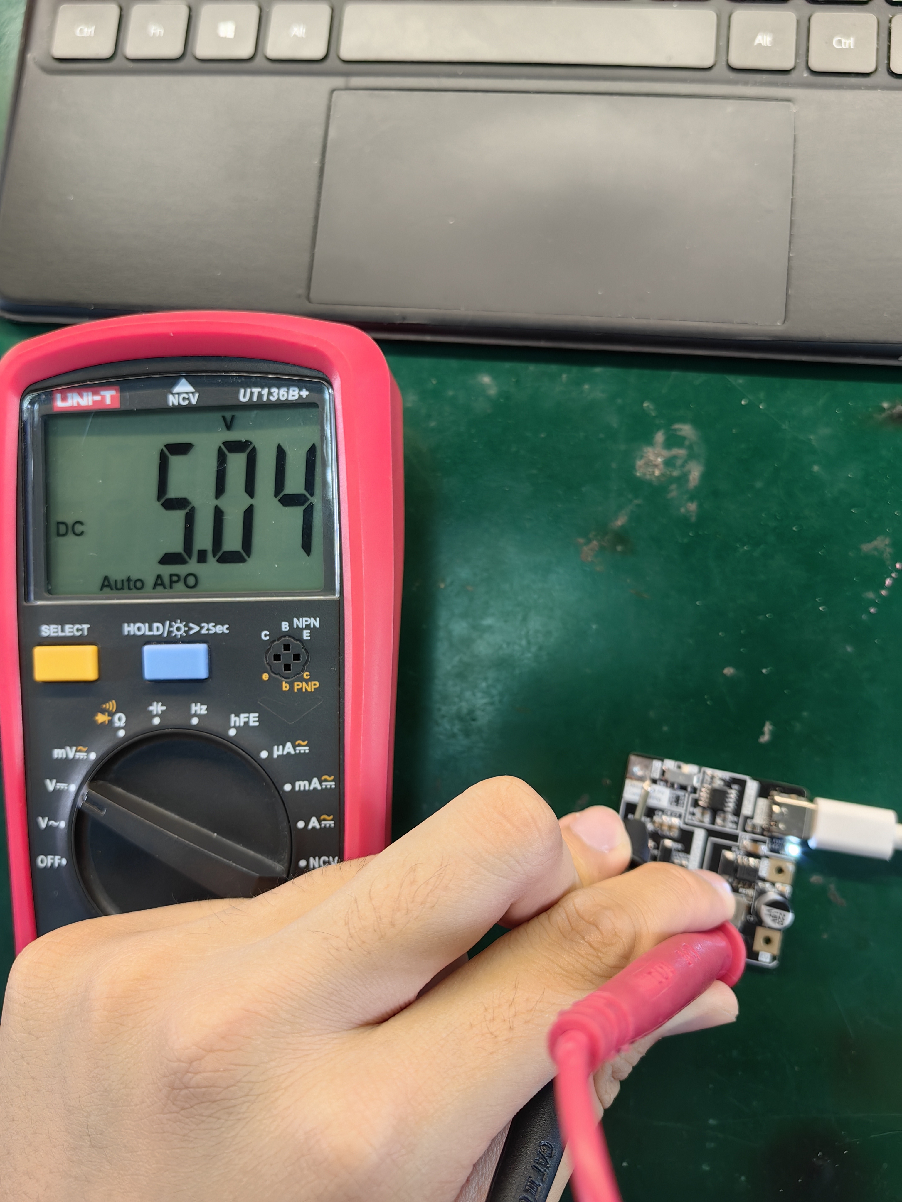

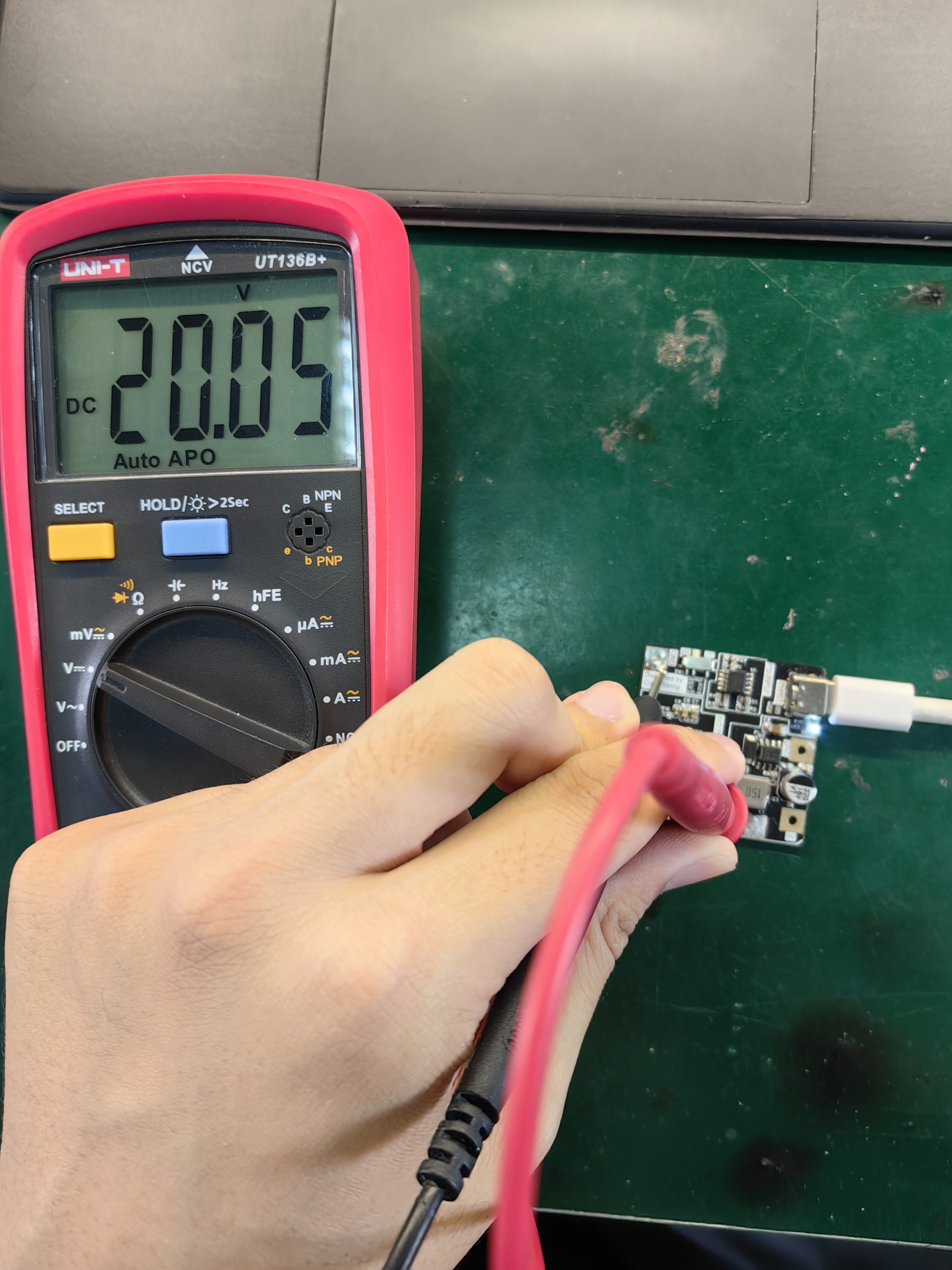

Tests : 5V
output
, 12V output,
20V output,
3.3V output.
=========== I am a beginner; please correct any errors. Suggestions from experienced users are welcome. ===========
