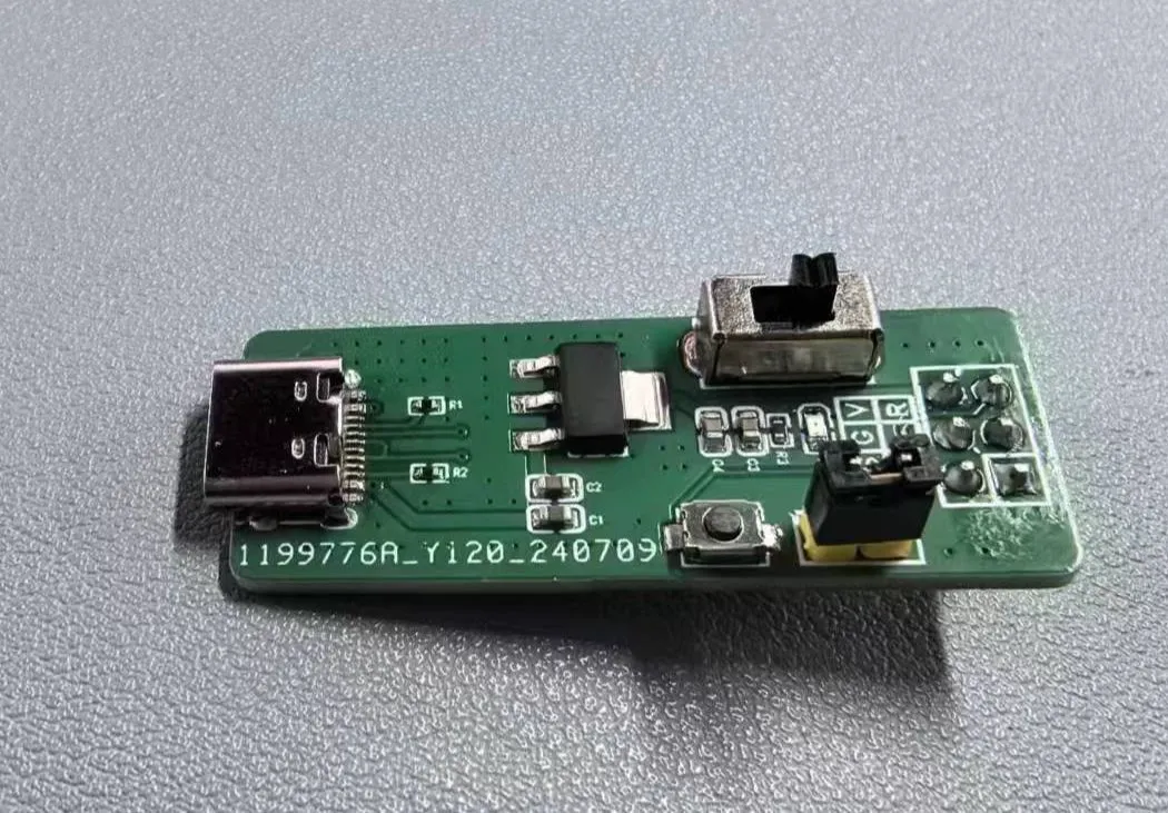

CH582M_CH583M Programmer
I made a simple Bluetooth e-ink keychain. Some people commented that the information on the programmer was incomplete. Actually, making the programmer is very simple; this is just a reference.

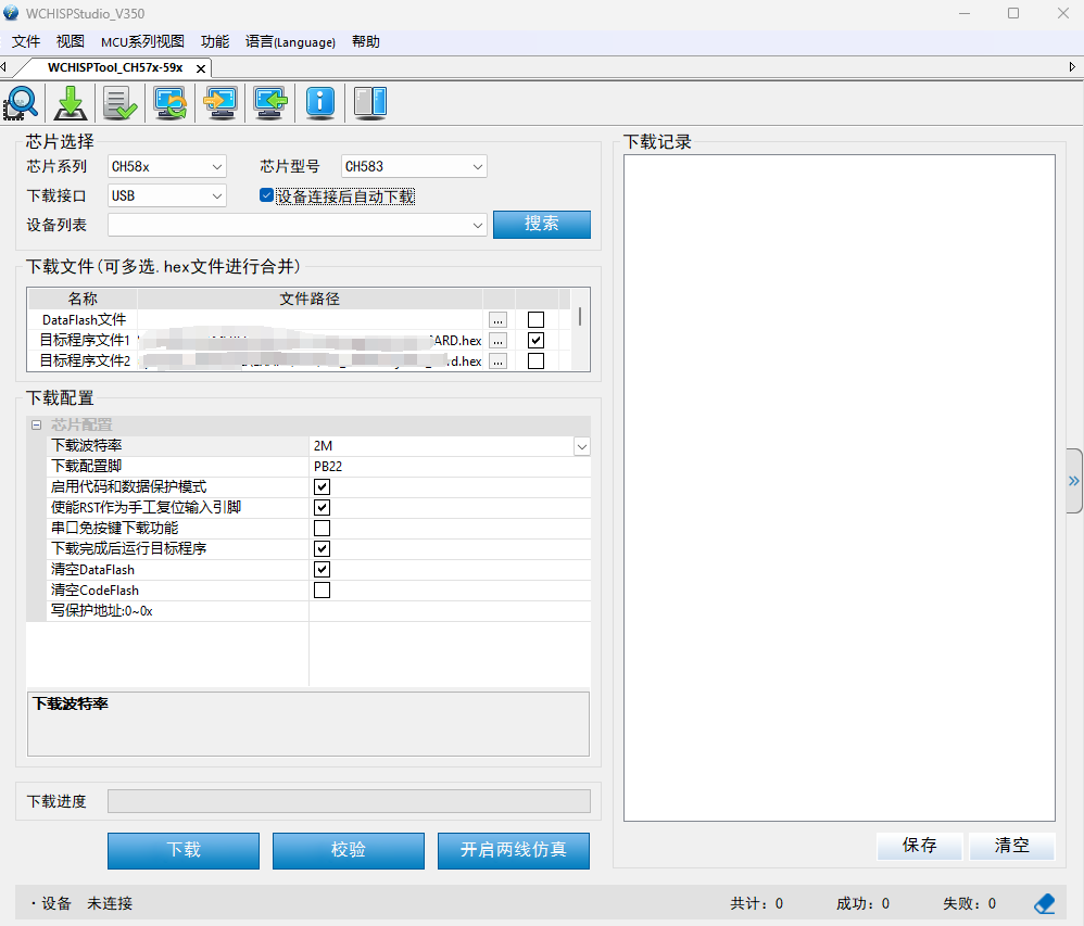

Open the Qinheng official programming tool WCHISPStudio (official download address: WCHISPTool_Setup.exe - Nanjing Qinheng Microelectronics Co., Ltd.)
Configure it according to the following image:

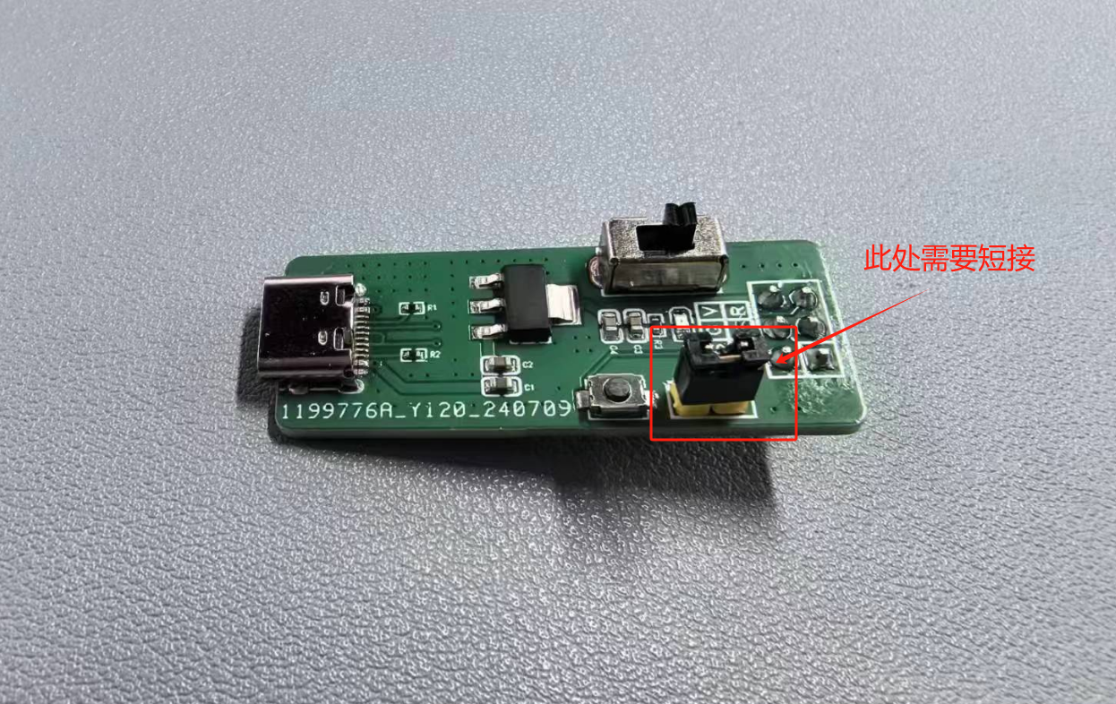

Before using the programmer, you need to short PB22 and GND with a jumper cap, as shown in the image below:

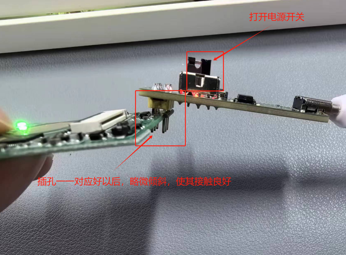

The programmer usage is as follows:

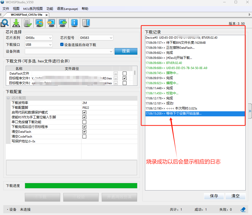

The programmer's interface order corresponds one-to-one with the PCB. If the programming software selects automatic download after device connection, a download log should appear, as shown below:
If automatic download is not selected, you need to manually click the download button.
After successful download, disconnect the connection.
