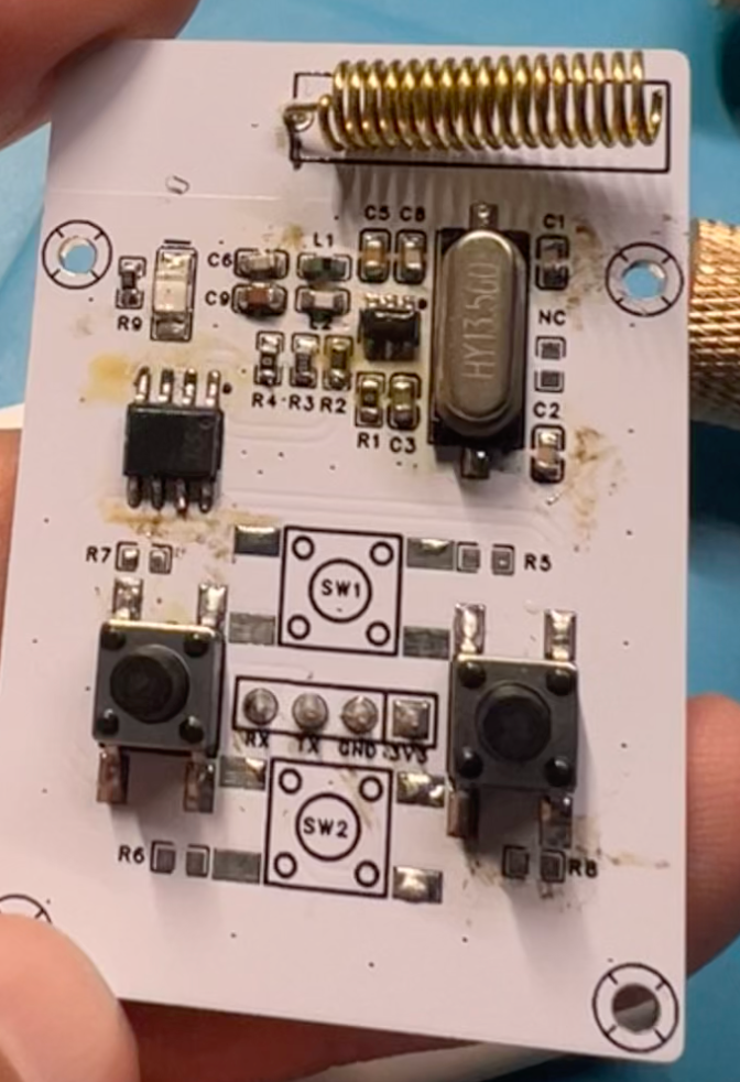

) ![2024-07-12_13-13-28.png](https://2024-07-12_13-13-28.png) This is the remote control, with four reserved buttons; currently only P3.0 and P3.3 are used. The pull-up resistors next to the buttons do not need to be soldered; the internal pull-up resistors of the MCU can be used directly. **

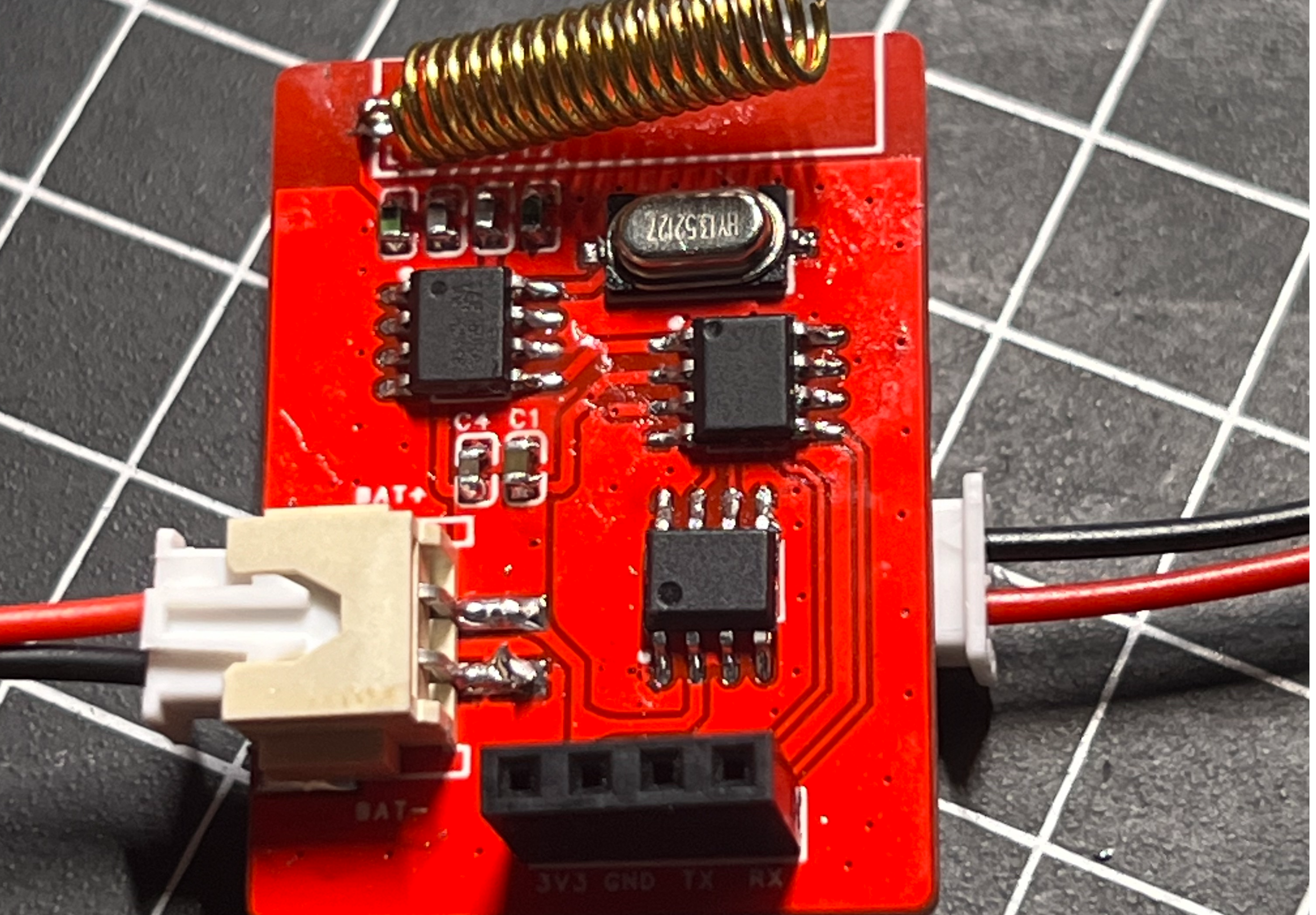

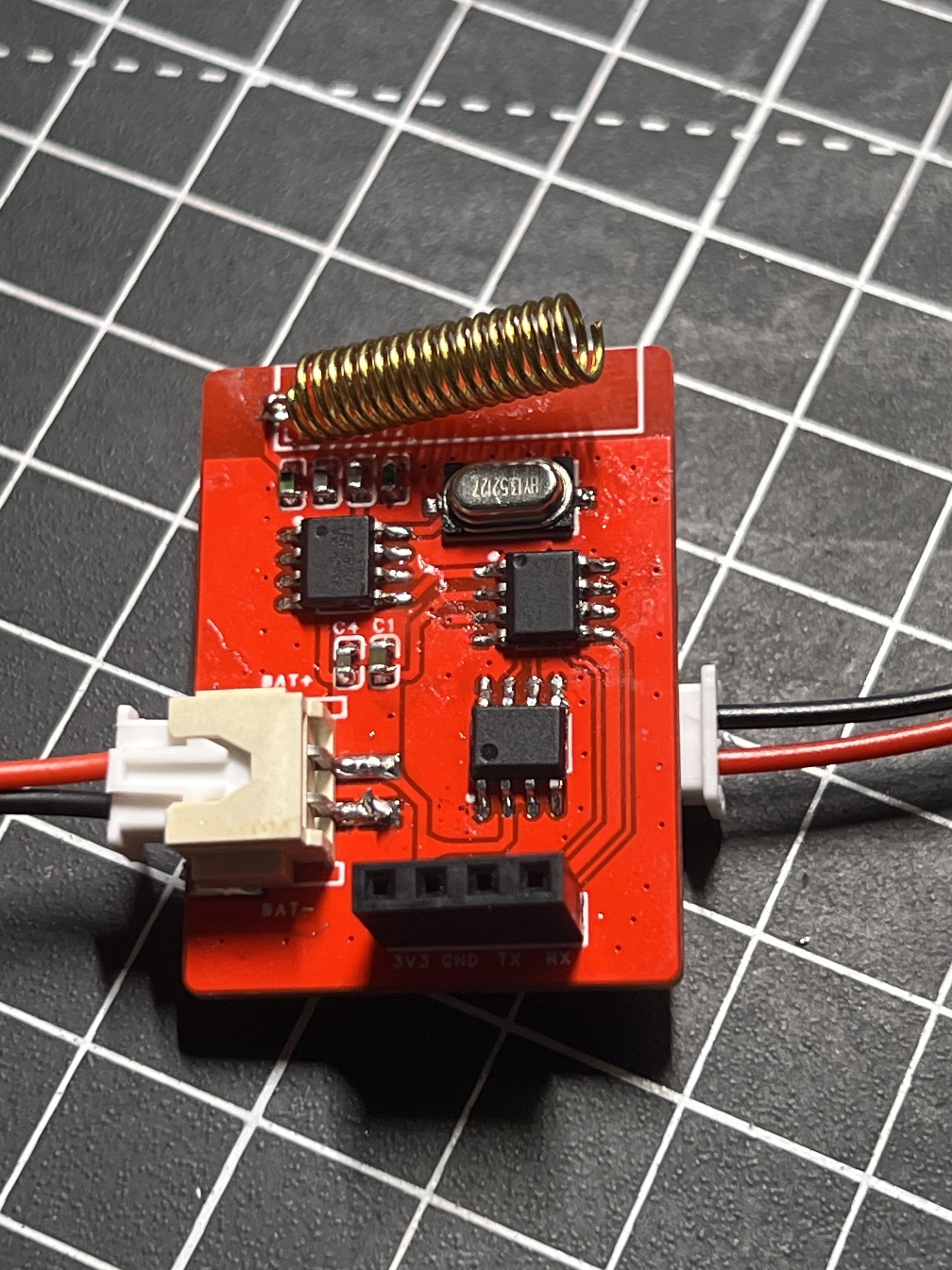

This is the receiver. MotorA/B connects to the external motors, BAT+/- connects to the external battery, and a button is reserved on the back for extended functions, such as learning pairing.

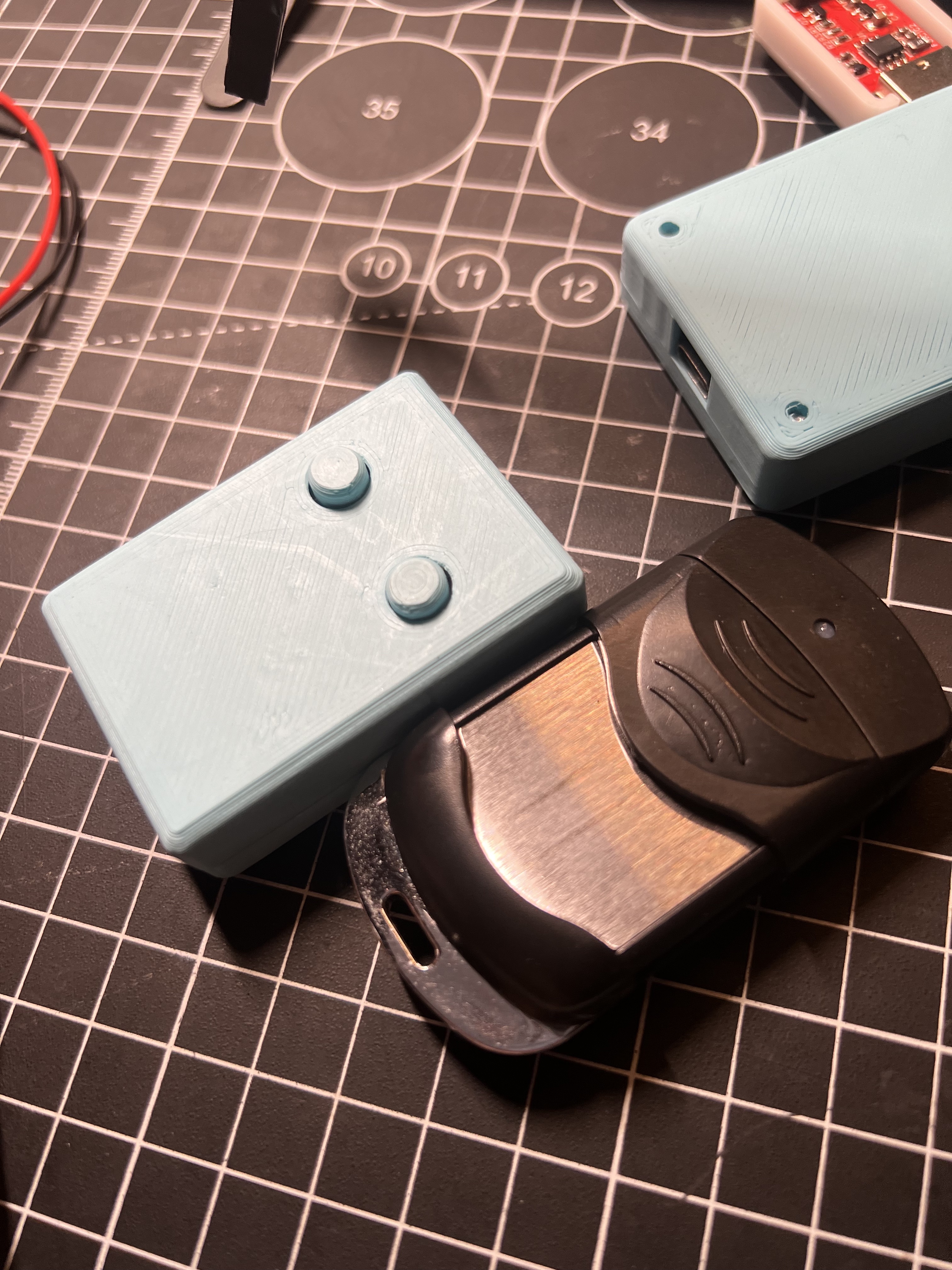

A casing was also designed for the remote control.

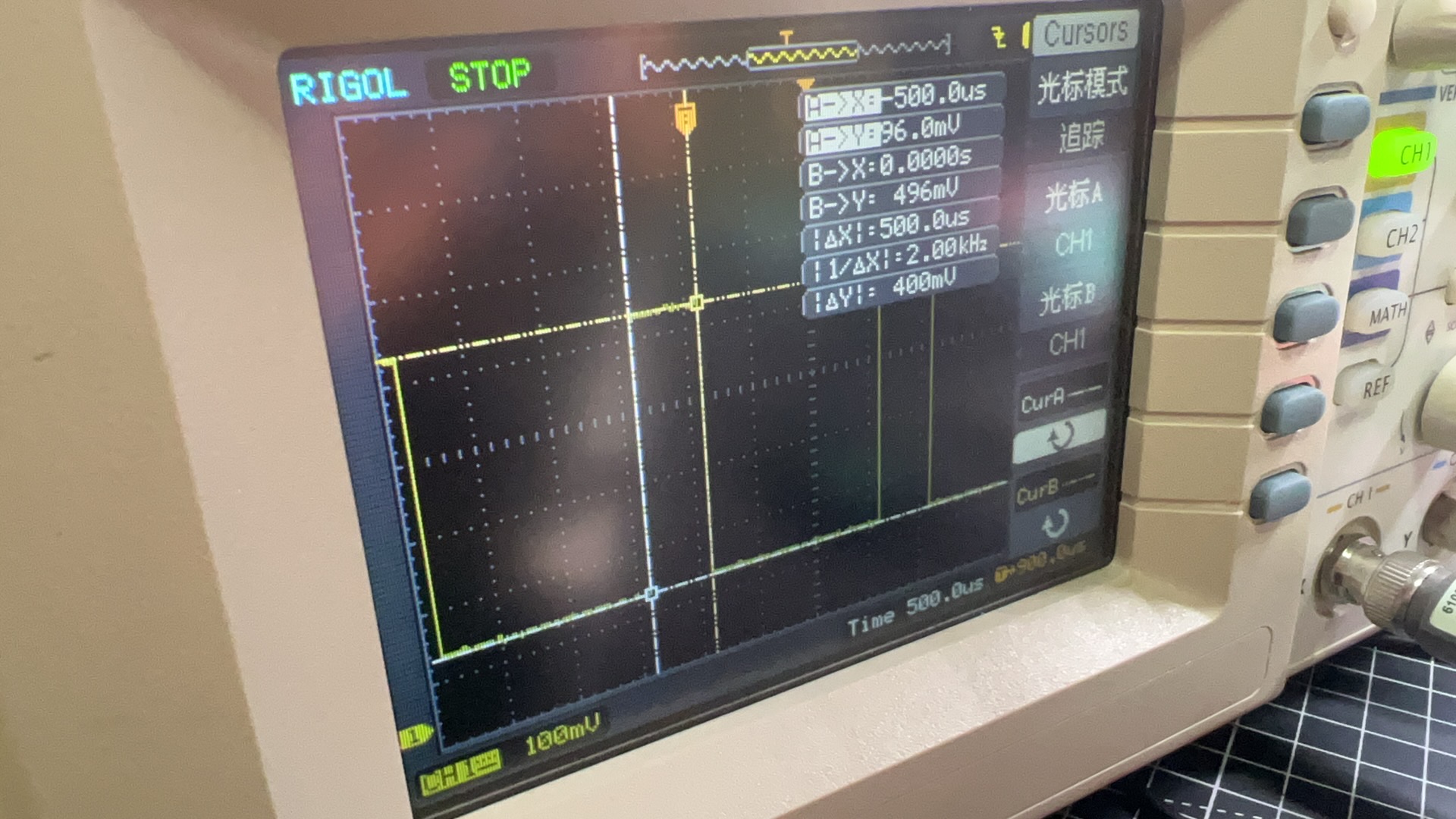

I relearned STC's interrupt mechanism. For time interrupts, I first needed to determine the crystal oscillator frequency. Using an oscilloscope, I captured the signal waveform to verify my code. Even though the remote control's signal waveform was fine, I couldn't parse it. I was desperately suspecting a problem with the algorithm when, while fiddling with the oscilloscope, I remembered to measure the time difference between two waveforms. I discovered the time interval wasn't the expected 400µs, but 500µs. So I readjusted the delay interval, and the problem was solved!
![IMG_6970 2.JPG]
Without the oscilloscope, this project might have failed.
