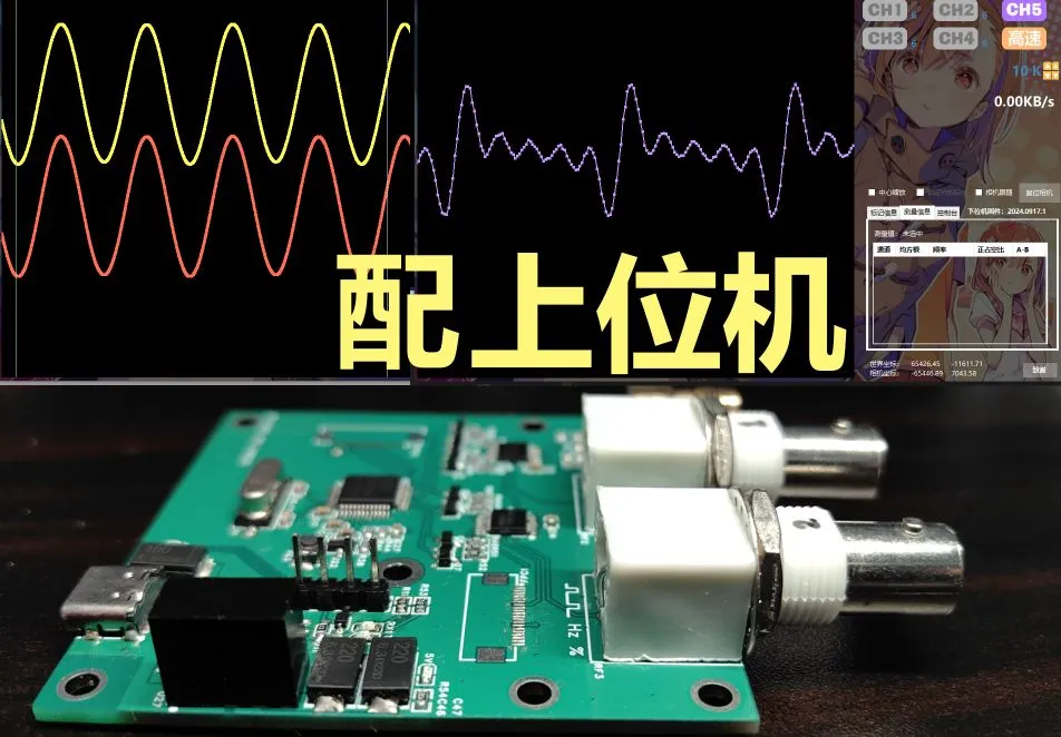

Hardware Introduction:

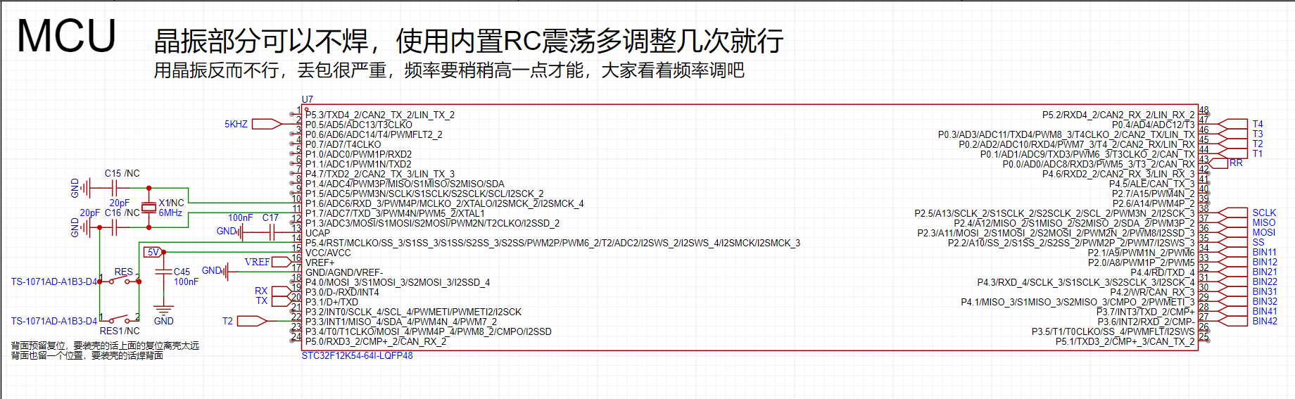

 MCU: STC32F12K54; Internal IRC oscillator frequency: 48.036MHz (using a crystal oscillator actually makes communication less effective); Serial port baud rate: 6MHz.

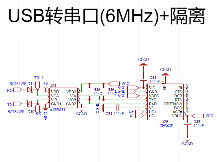

USB to serial port chip: CH343P;

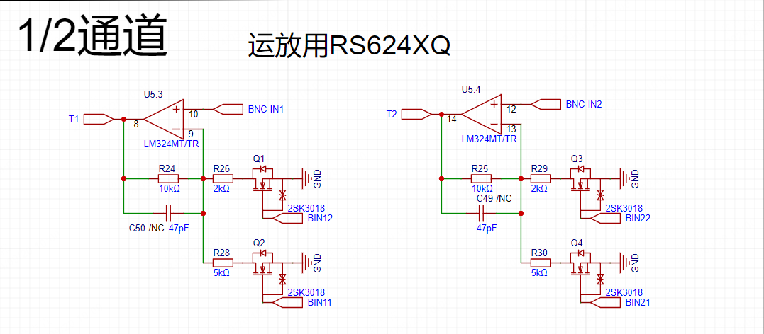

Op-amp: RS624XQ (simple amplification);

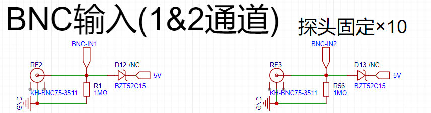

Input attenuation of channels 1-4 is fixed at 10 (channels 1 and 2 are only on the board, channels 3 and 4 are reserved for external expansion); Amplification levels include 1 (0~40.96V, 10mV resolution), 3 (0~13.65V, 3.3mV resolution), 6 (0~6.82V, 1.6mV resolution), and 8 (0~5.12V, 1.25mV resolution); Only positive voltage input is allowed;

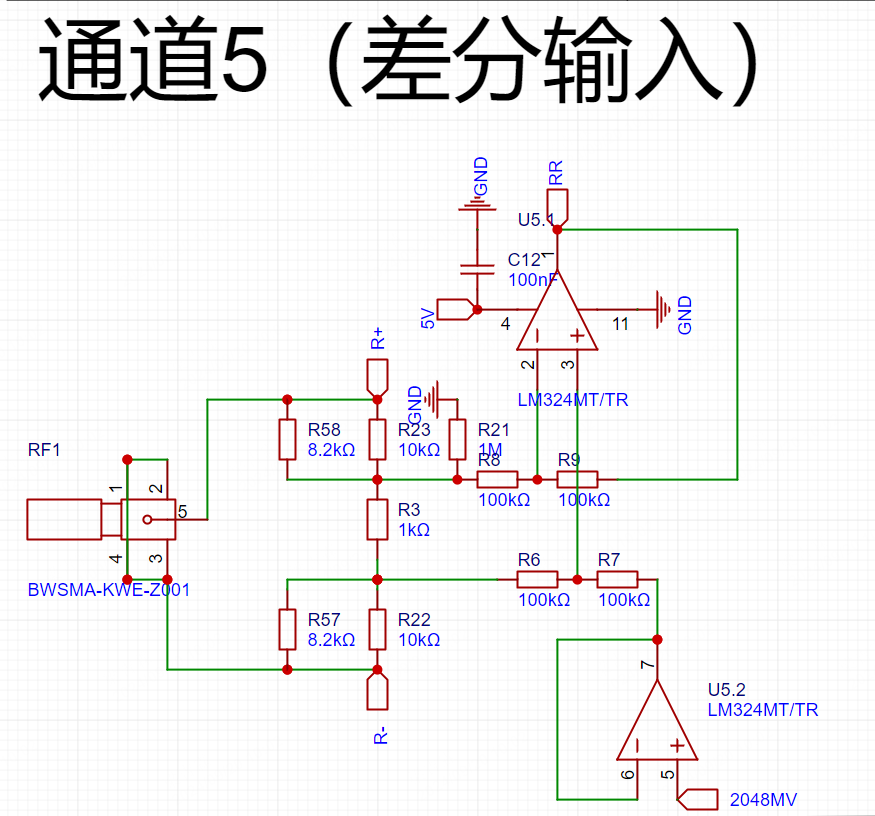

Channel 5 is a differential input, ranging from -20V to +20V, with a resolution of 10mV.

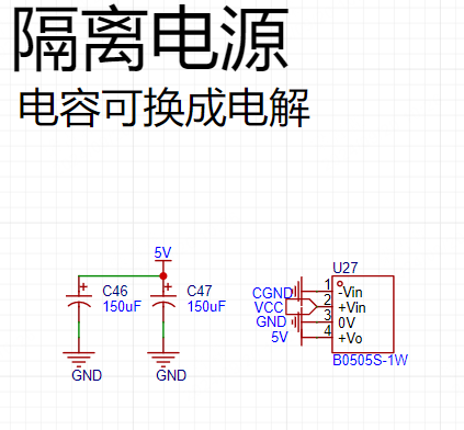

Isolated power supply and data isolation chips are used to protect the computer from explosion.

      MCU: STC32F12K54, using the internal IRC oscillator frequency: Around 48MHz, after repeated downloads and adjustments, the packet loss rate was very low when the main frequency was finally around 48.036MHz. Using a crystal oscillator to multiply it to exactly 48MHz was very accurate, but it was actually easier to receive packets that weren't being received. The main issue was packet loss during microcontroller reception, but never during transmission, which was somewhat surprising. The waveform looked fine. There are two reset buttons, one on the front and one on the back.
      For those with a housing, it's recommended to solder the back button; for bare circuits, solder the front button. Channels 1-4 amplification: A simple amplification was implemented using an RS624XQ, without much consideration for detail. The range can be selected via the microcontroller. Channels 3 and 4 don't need to be soldered if not needed. Channels 3 and 4 were designed to be paired with a housing, BNC-machined onto the housing, and then the fuse connected to
      channel 5 on the board. Differential amplification: A simple differential amplification was implemented using an RS624XQ, with a fixed attenuation of 1/10. It was designed to measure relatively large AC signals, with a range of -20V to +20V. The SMA connector was for convenience. For external expansion, you can replace it with other
      USB to serial adapters if needed: The STC32F itself supports USB communication, but in my previous tests using HID, the fastest speed was only around 200K or 300K, I forgot. One point is two bytes, so the fastest speed is probably around 100~150KSa/s. Therefore, I used a CH343 as a relay, with a maximum speed of 6M (CH340 is 2M). A 6M baud rate can meet a transmission speed of 500K, so currently continuous sampling can only achieve 250KSa/s.
      Isolation: Use an isolated power supply to avoid accidental contact with high voltage at the measurement end. Randomly take away your or your computer's
      BNC input: Overvoltage protection has been added to the input. The clamping diode uses a Zener diode because I installed all the tubes I had on hand and tested them. This tube had the least leakage current. If you have other good tubes, you can replace them. If the voltage you are measuring is not too high, you can omit this diode.
                       The probe input is fixed at x10 with a 9MΩ resistor, which forms a 1/10 voltage divider with the 1MΩ resistor on the board. Do not adjust the thousands digit to x1. The resistance at x1 is only about 120Ω. If you accidentally measure 18V and there is no clamping diode, then you will really be sending

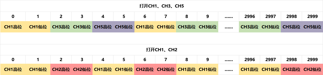

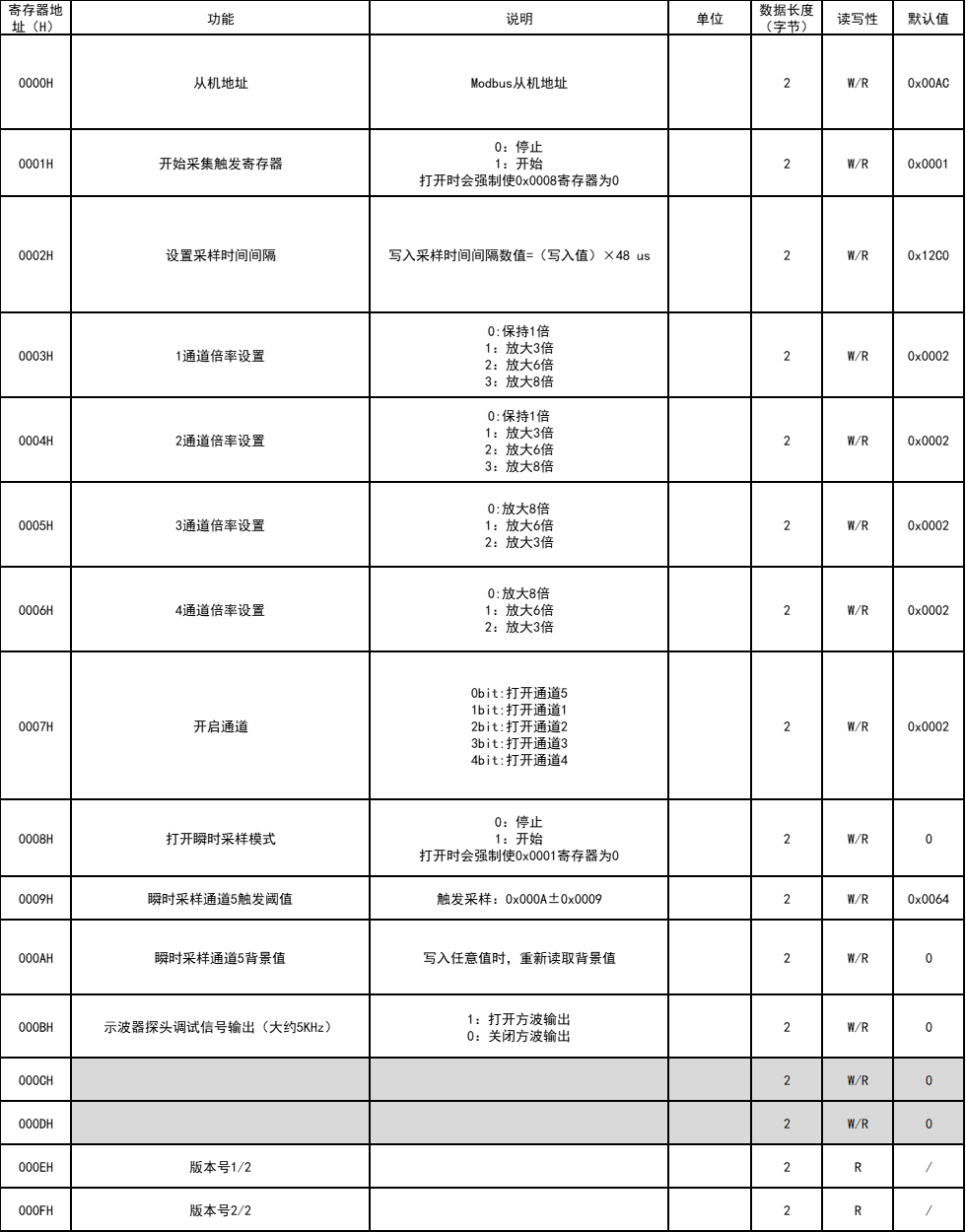

      This communication protocol follows a portion of the Modbus-RTU protocol. The slave address defaults to 0XAC upon power-on, supporting continuous read and write operations, but no reply is given when writing to registers (to avoid disrupting sampling).
      Sampled data is transmitted in 3000-byte packets (16-bit data, 1500 points). Opened channels will sequentially fill the packets with data at specified sampling intervals, sending the data once 3000 bytes are filled.

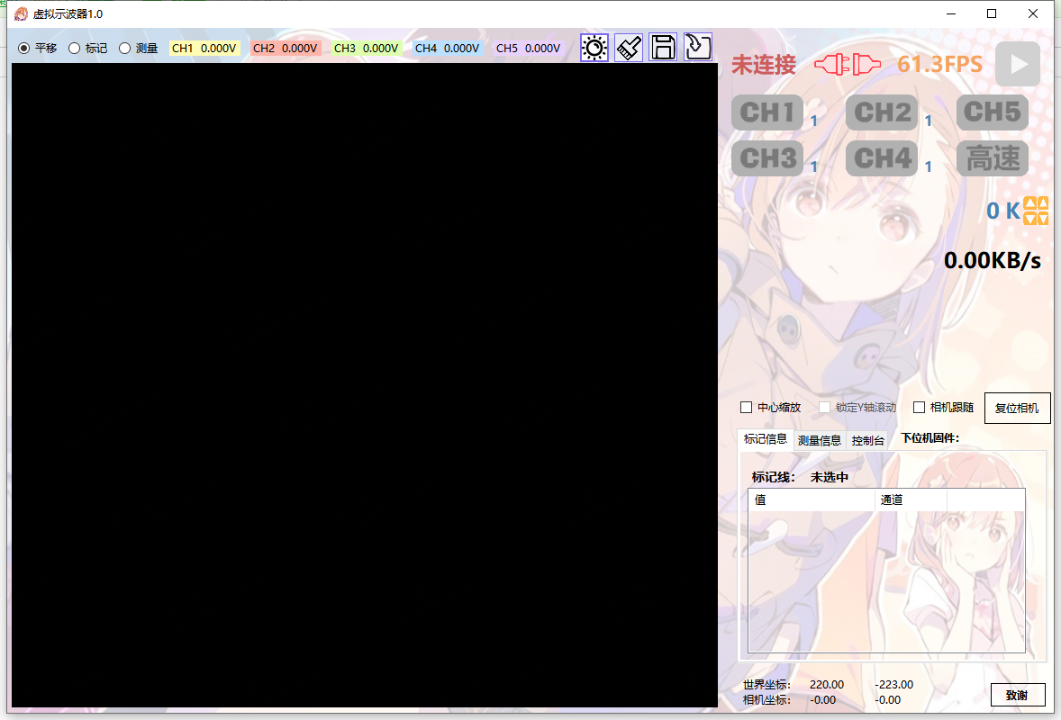

      The biggest advantage of using the host computer is that waveform data can be saved! The bad news is that it consumes some memory. High-speed mode requires 100MB of memory for 11 seconds.

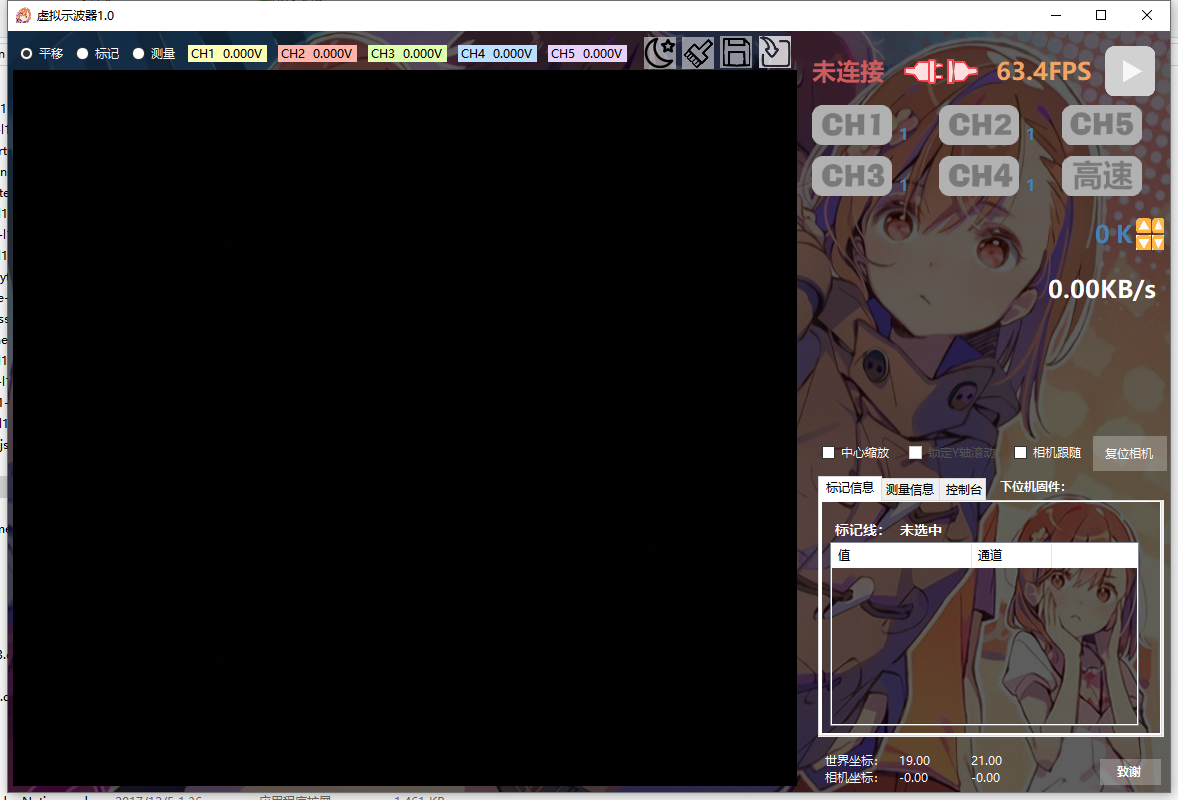

      The host computer uses an old-school anime-themed background, with switchable dark and light themes.
      It automatically identifies and connects to the slave device. Once connected, the slave device configuration can be obtained, and channels can be selected to be enabled or their multipliers adjusted via the interface. When high-speed mode is enabled, only the enabled channel with the smallest data value can be acquired.

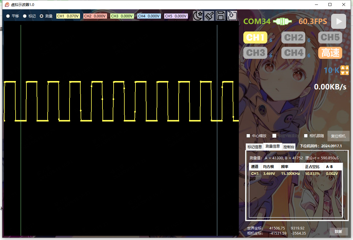

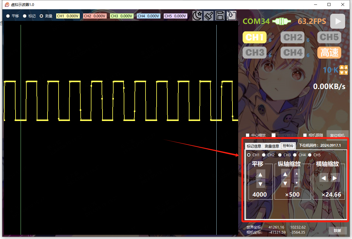

      In non-high-speed mode, data is continuously acquired according to the sampling rate. When high-speed mode is enabled, channels 1-4 will only start acquiring a data packet when the voltage is above 1/8 of the range. Channel 5 will start acquiring a data packet when the voltage is greater than or less than 1V (adjustable). Inputting a

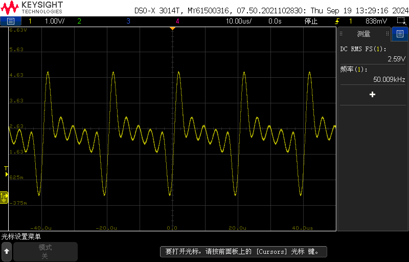

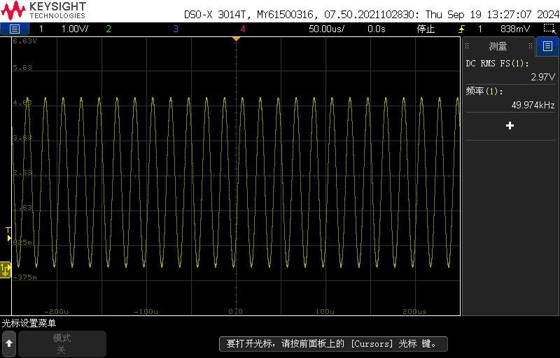

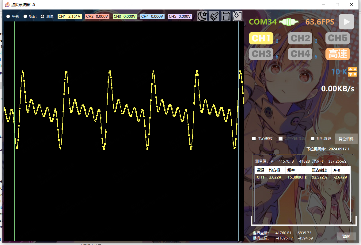

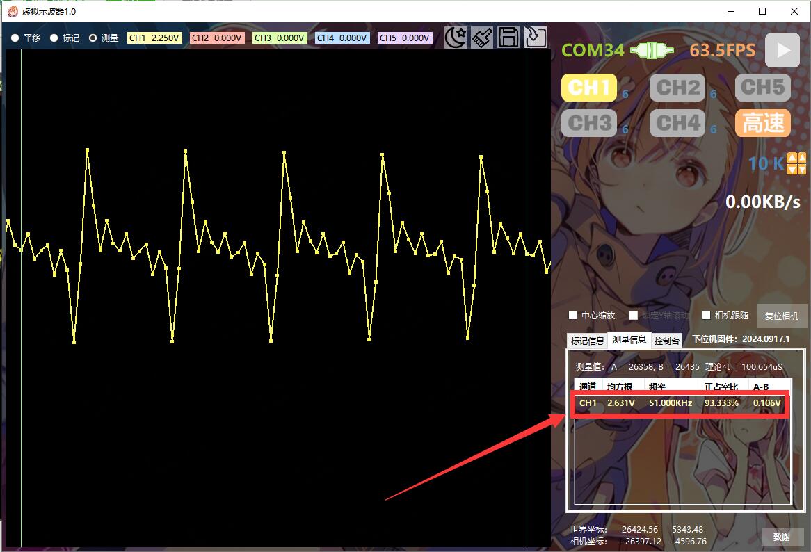

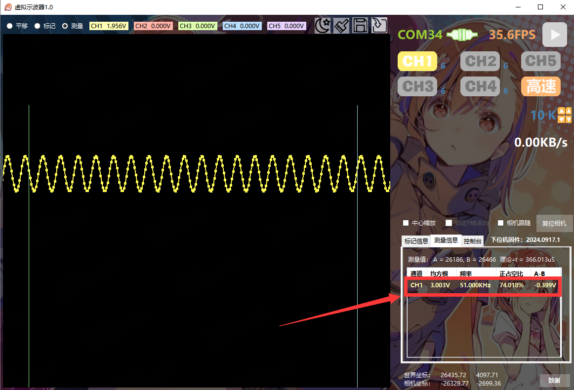

      50kHz 0-5V sine wave and using high-speed measurement, compared to oscilloscope measurements, the frequency response is slightly off, but the period root mean square (RMS) results are acceptable.      Inputting a 15kHz 0-5V multi-tone signal and using high-speed measurement yields better results.
     Therefore, for detailed measurements, it's basically only possible below 15kHz; above 15kHz, it's mostly just a noise.
     Inputting 15kHz 0-5V... 50% Square Wave:

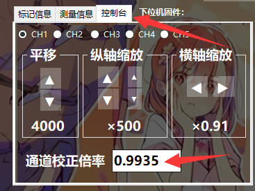

     The console allows adjustment of channel scaling and vertical position;
     waveforms can be exported or imported for viewing;

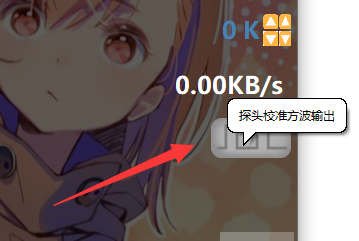

     a 5kHz square wave test signal can be enabled for probe auxiliary calibration;
     channel gain can be fine-tuned; using the 4096mV reference source on the probe measurement board, the root mean square (RMS) over a period of time can be measured and compared with the theoretical value to calculate the compensation coefficient;
     the interface can be zoomed using the mouse wheel, and panned while holding down the mouse wheel. The waveform refresh direction is from left to right, but when using the camera follow function, after the waveform reaches the right side of the screen, it will automatically move to the left to keep the latest waveform on the far right, similar to the oscilloscope's scrolling function.

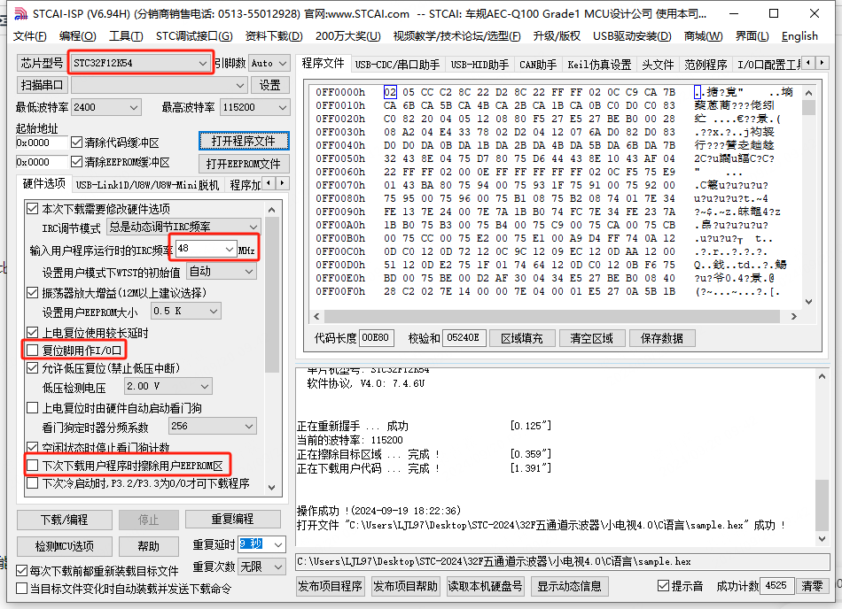

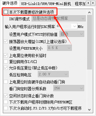

first
      solder the main chip area, do not solder anything else. Set the programmer according to the diagram below, and then program the program through the reserved programming port. Once inside, you can use the C port to download.
      Input 48 for the IRC frequency using the keyboard. After downloading, try using the host computer for control. If packet loss is severe, download a few more times; the main frequency will be automatically fine-tuned each time until the packet loss is low.
      After adjusting the main frequency and confirming the effect is satisfactory, when modifying the program later, you need to uncheck the "This download requires hardware option modification" option and avoid adjusting the previously tested main frequency. The attached instructions state that
