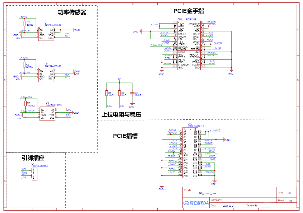

Schematic Design Description:
The energy consumption analysis module in this system uses an STM32F103ZET6, directly adopting the Zhengdian Atom's Warship development board, thus eliminating the need for PCB design. The energy consumption sampling module requires the integration of INA219 sensors and PCIe Ex1 gold fingers and slots, therefore requiring the design of an adapter card schematic and PCB.
The most important components of the adapter card are the three INA219 sensors, which measure the power of +12V, +3.3V, and +3.3Vaux respectively. Since the PCIe power supply protocol includes five +12V channels, totaling a maximum current of 5.5A, I calculated using formulas that a 50mΩ shunt resistor should be configured for the INA219 measuring the +12V circuit, and 100mΩ shunt resistors should be configured for the other two INA219 sensors. In addition, by obtaining the PCIe x1 gold finger package from the open-source platform, and combining it with the PCIe slot and pin socket packages provided internally by EDA, the schematic diagram of the adapter card can be created.

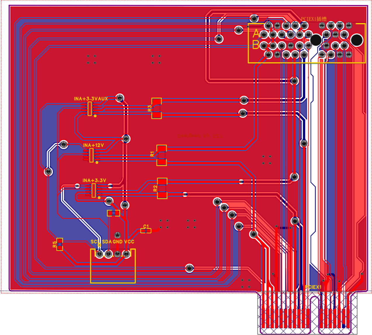

PCB Design Instructions :
After completing the schematic design, directly generate the PCB file in LCSC EDA after DRC check, and then perform layout and routing according to the rules. Pay attention to the principle of similarity and proximity during layout, and pay particular attention to the differential pair design rules (there are multiple differential pairs in the PCIe protocol), including the length difference of differential pairs, line width, etc. After layout, routing, and copper pouring, perform DRC check again. Once it is correct, place an order for prototyping. LCSC EDA projects can be prototyped free of charge by LCSC!

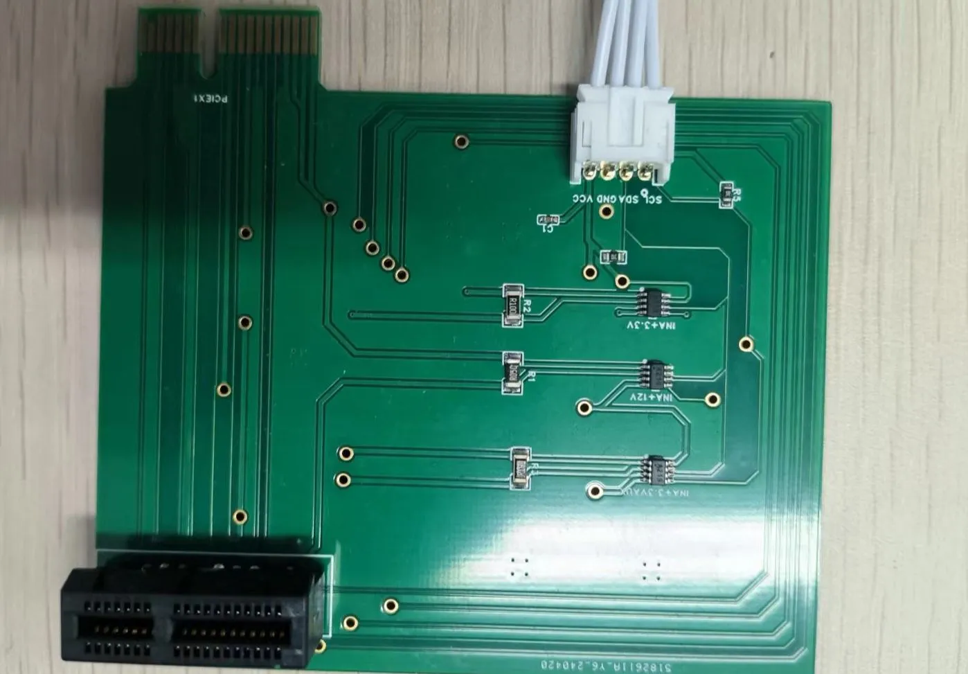

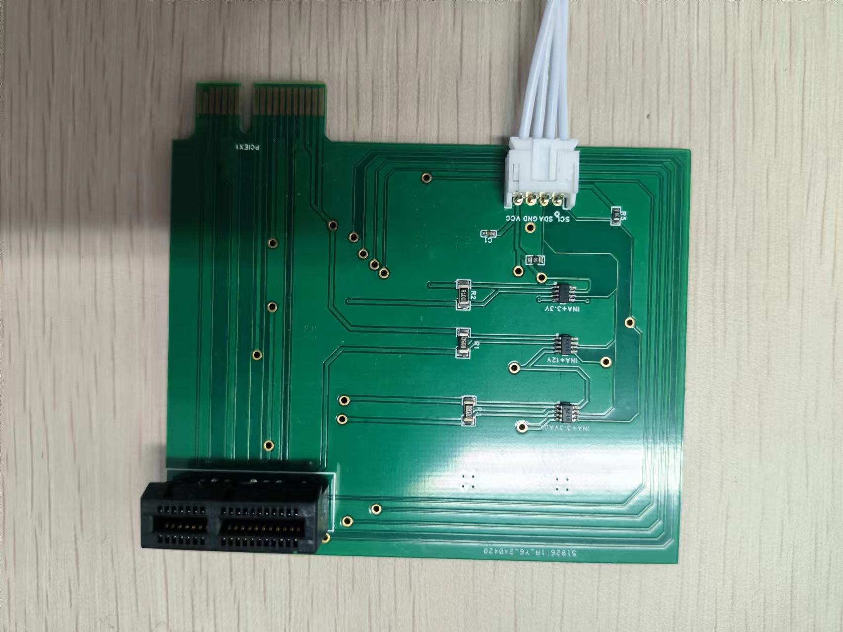

A physical demonstration
is attached with a picture of the completed board:

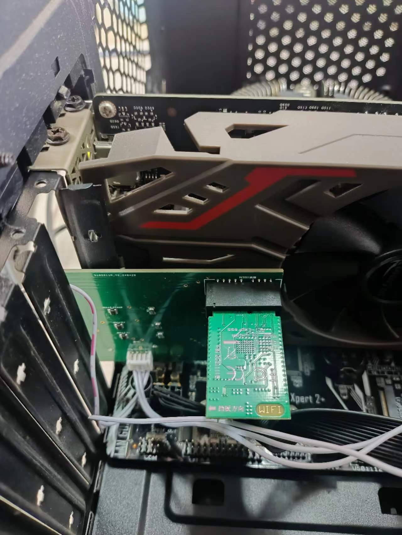

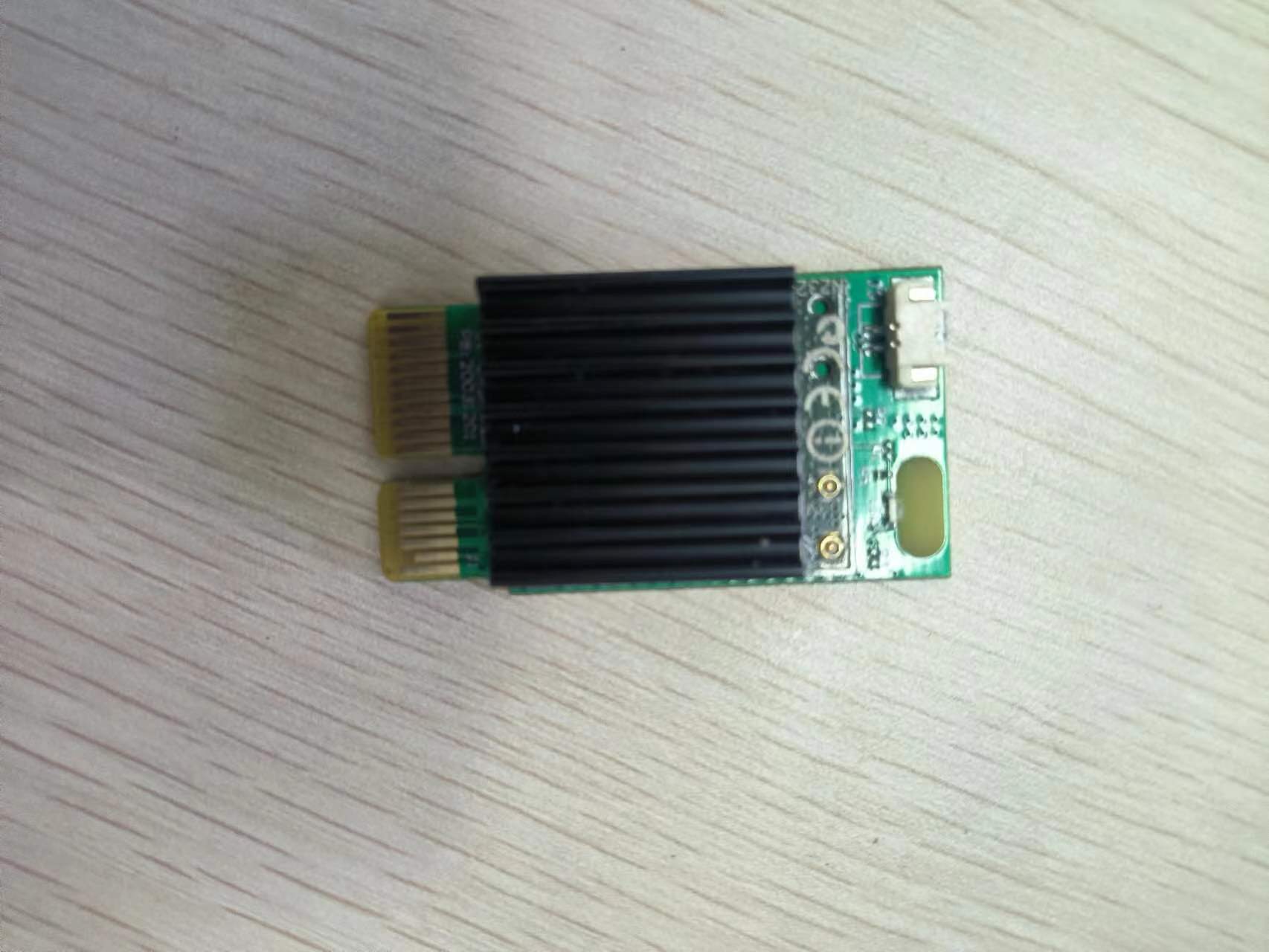

In actual operation, a PCIe x1 load needs to be inserted into the adapter card (this graduation project uses a wireless network card). The PCIe gold fingers of the adapter card are inserted into the slot in the chassis. After powering on, the network card can start normally and collect power consumption data.
Then, connect the four pins (VCC, GND, SDA, SCL) on the adapter card to the +5V, GND, and I2C protocol SDA and SCL pins defined on the STM32 microcontroller development board (using software-simulated I2C, therefore, pins GPIOA5 and 6 of the microcontroller need to be connected). Burn the project code into the microcontroller, and you will see the three interfaces displayed on the development board's LCD screen. Below are images showing the adapter card in operation:
