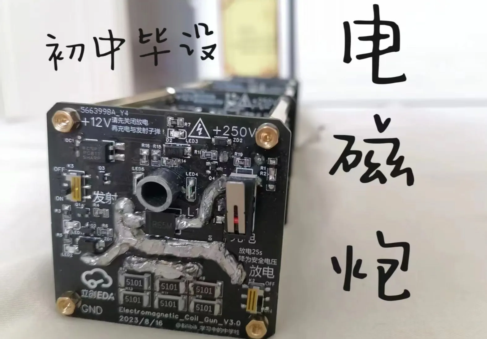

I solved a small problem with Electromagnetic Cannon V3.0. There was a problem with the original circuit diagram. Although I explained it to every student who asked me via private message, I hadn't changed the circuit diagram in the article.
The Q6_Control network needs to be connected to a 10k resistor to GND
, otherwise the IGBT may easily burn out.
I sincerely apologize for any inconvenience caused. Please feel free to send me a private message if you find any other problems during the production process.
