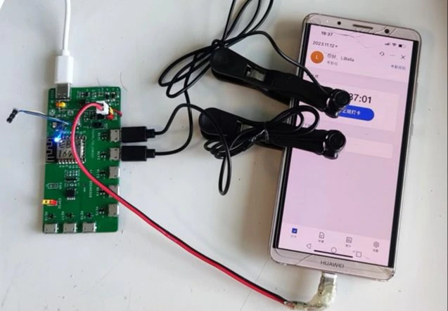

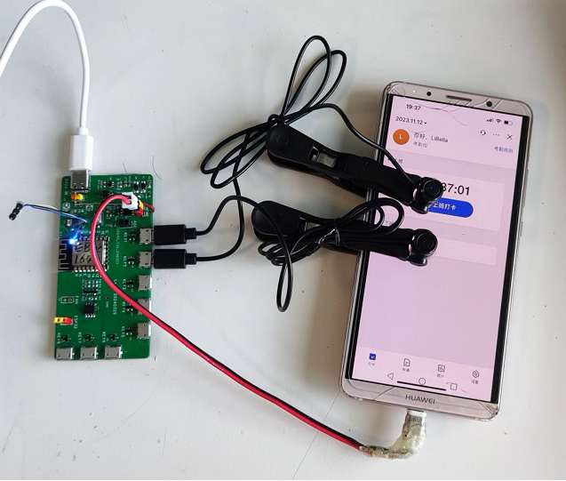

Project Introduction (Physical Image ): Main
Control Chip: ESP12F;
Main Application Scenarios: Remote Check-in
Function Introduction:
The ESP12F connects to the Tencent Cloud IoT platform via Wi-Fi and can be remotely controlled via the Tencent Lianlian WeChat mini-program.
The control board can individually control up to 8 click heads, which can be controlled by eight buttons on the mini-program to click the screen once.
It features screen brightness detection using a photoresistor attached to the phone screen.
It also has a timed phone charging function. Soldering Notes:
The control board was provided free of charge by JLCPCB.
The BOM (Bill of Materials) is provided in the attached table.
The 16-pin Type-C female connector does not need to be soldered. When using a 5V2A charger via a Type-C cable, I found the phone charging speed to be particularly slow; when using a 5V2A DC power supply via H1, the charging speed was not as slow.
The three 4148 diodes on the back do not need to be soldered .
The AO4805 and related circuit components do not need to be soldered.
The H4 connector is the phone's charging interface and is also used to power on and off the phone to turn on the screen.

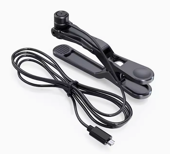

The click heads

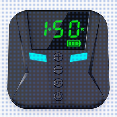

were purchased as finished products from Taobao. Searching for "clicker" will lead you to a purchase package with the main unit shown in the image below.
You buy a package containing as many click heads as you need to click on the screen. All click heads share a single click signal.
For details on the click heads, please search for the patent "CN216772390U - An Electronic Slider and System," which contains detailed circuit diagrams and instructions.
The click head looks like the image below, with a Micro USB plug and a clip to attach to the screen.

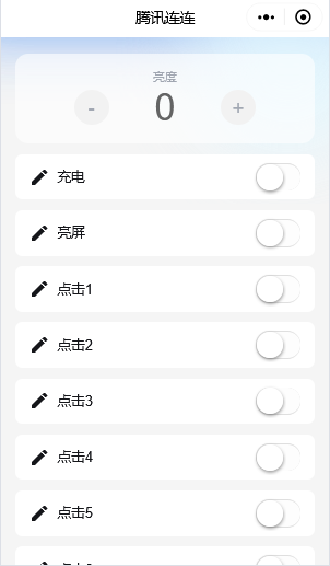

Tencent Lianlian Mini Program Interface:
