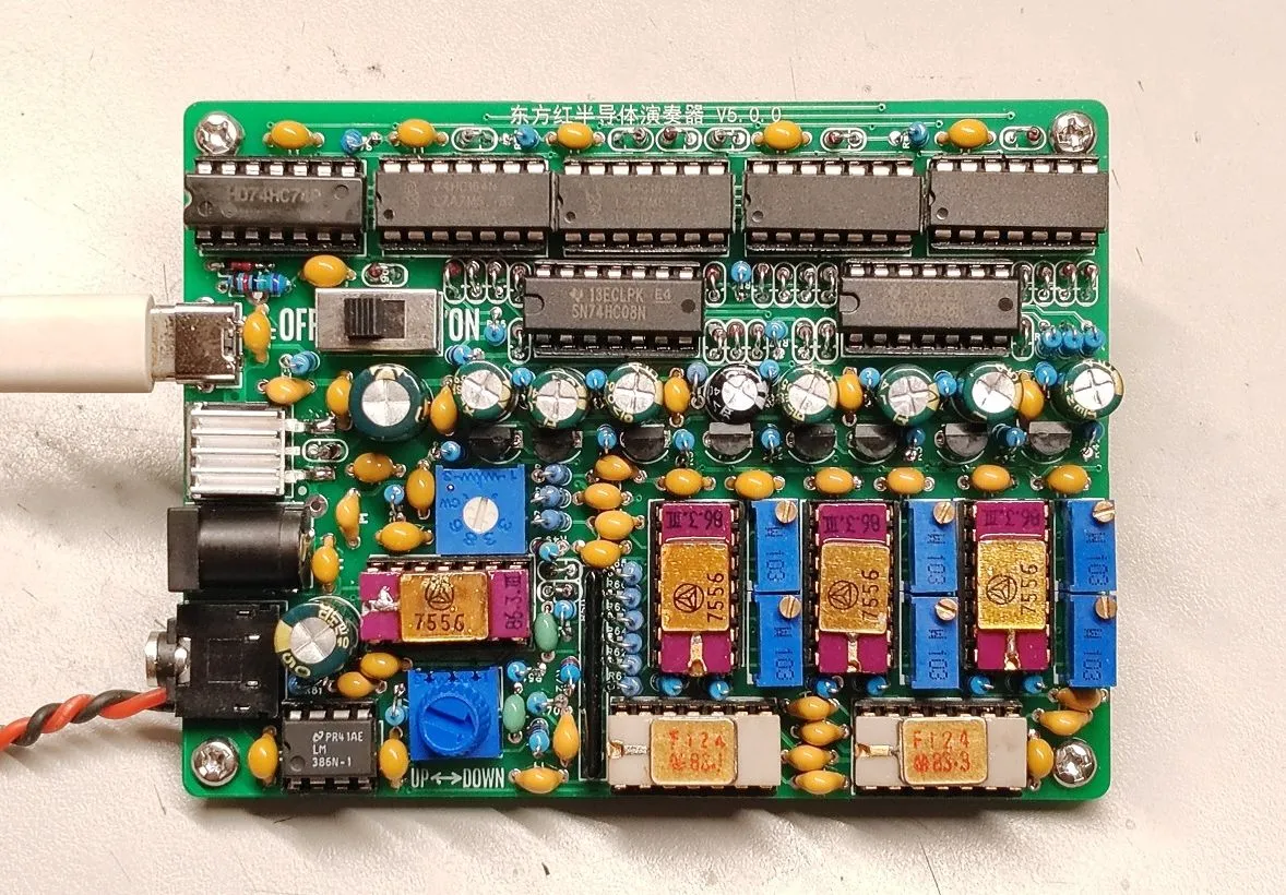

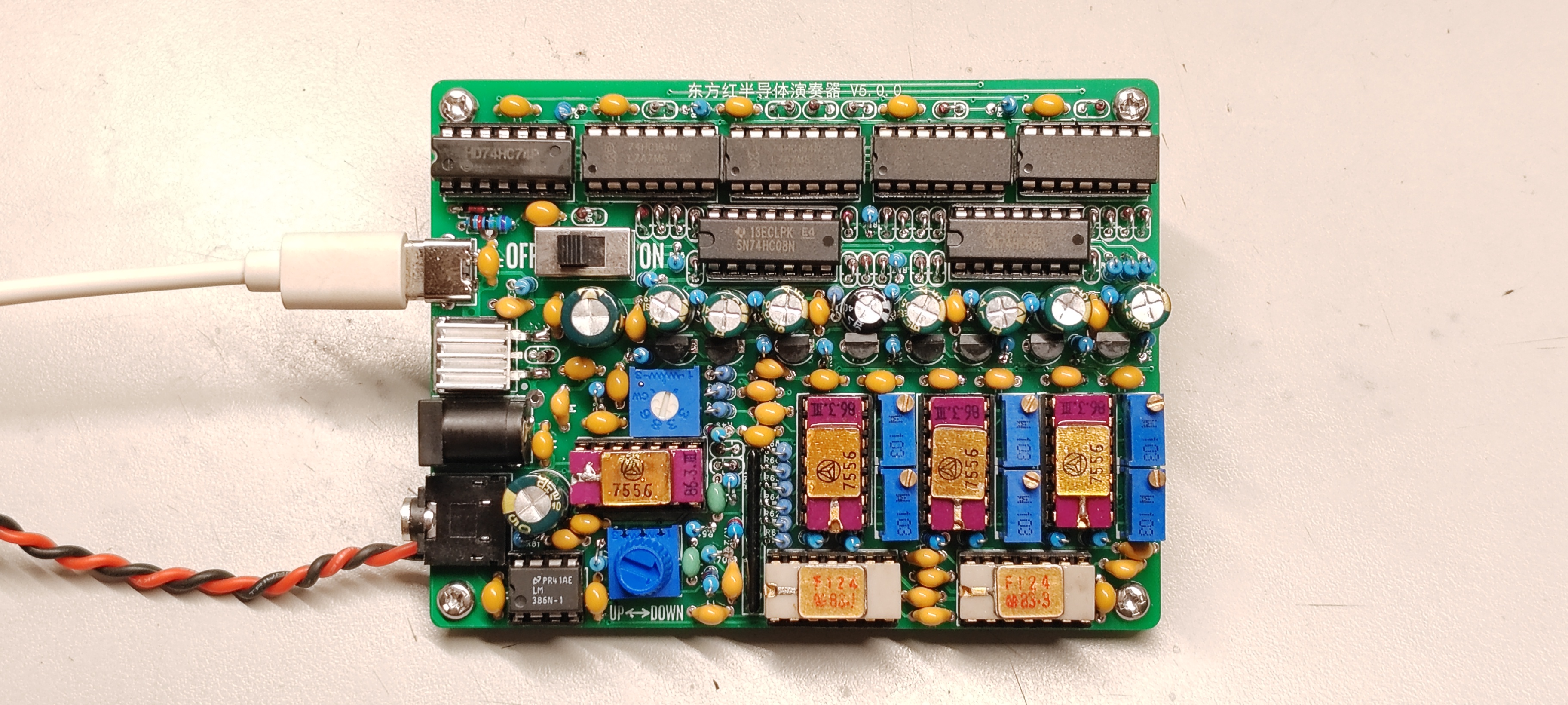

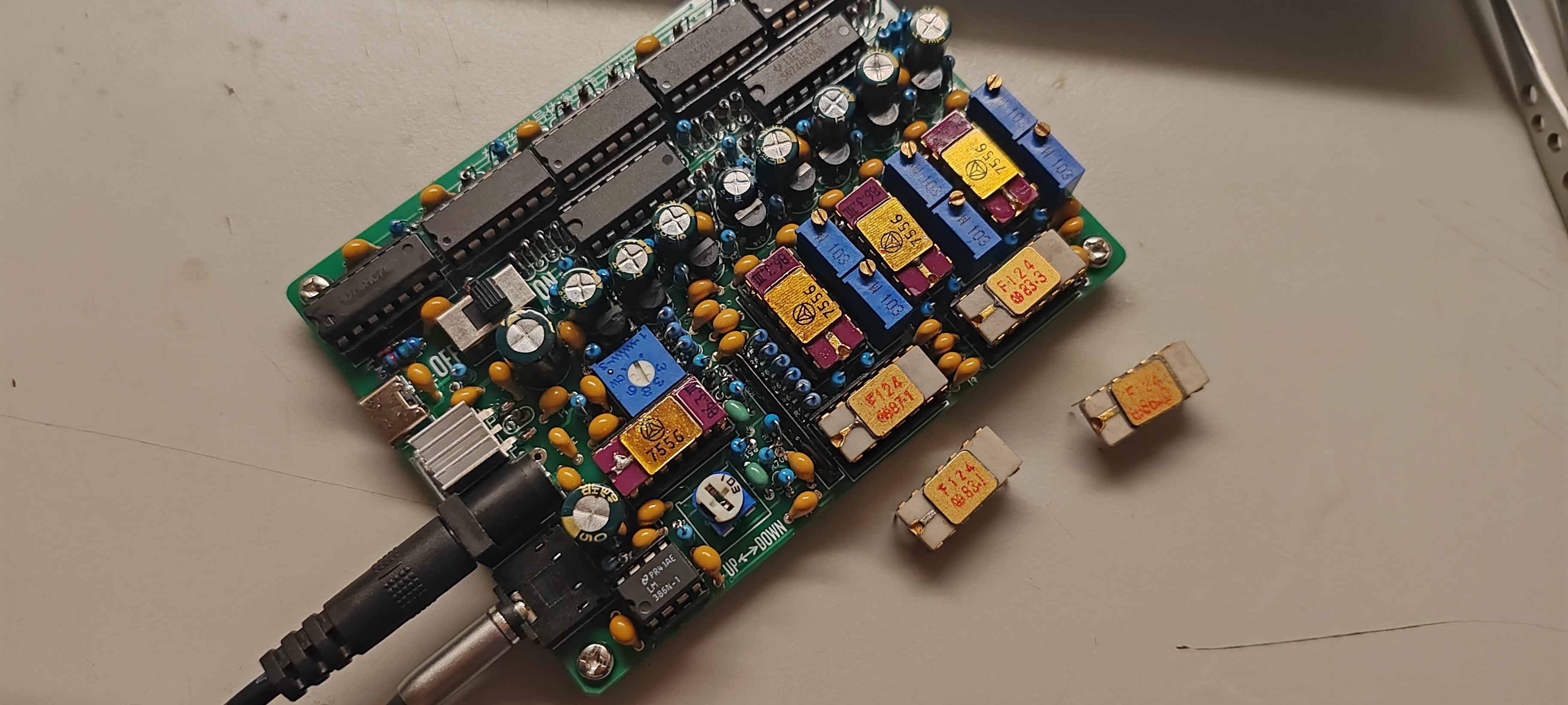

Dongfanghong Semiconductor Music Player V5.0
PCB Size: 7.5 * 10 CM, double-sided standard process (minimum via 0.305mm, mesh spacing 0.152mm)
Power Supply: Type-C 5V 100mA (or DC-05 interface 7-12V, positive inside, negative outside)
Classic Average Operating Current: 35-38mA (without speaker or headphone load)
LFO Oscillation Frequency: 3-4Hz
Playback Track: First half of "The East Is Red", F major, 3/4 time
Playback Speed: 20 seconds/pass
The entire unit has only one power switch; the machine automatically resets and starts working after powering on. A separate volume control knob is also included.
After initial assembly, simply remove IC18 and IC17, then adjust R13-R18 to make the output frequency of the corresponding calibration point equal to the frequency marked on the back of the circuit board. Then reinsert IC18 and IC17, adjust RP2, and calibrate the 3.2Hz square wave calibration point. No further operation is required after calibration.
The most common LM324 (a quad op-amp version of the LM358) is used as the voltage driver for filtering, synthesizing, and tremolo control. The circuit was specifically optimized for the LM324's effective dynamic range (0.8-3.6V) at 5V. This op-amp basically meets the design requirements, with low power consumption and low cost.
The basic principles for generating tremolo (FM modulation) and attenuation tone (AM) modulation are the same as in the third version.
The basic principle of using the NE555 to implement FM modulation: Pin 5 of the NE555/CMOS 555 is generally the bypass capacitor ground terminal, but if an external voltage is input to this port (a small-amplitude AC signal with a DC bias of 2/3 VCC), it will affect the upper and lower trigger thresholds of the 555's internal comparator, thus slightly changing the oscillation frequency without changing the timing resistor and capacitor. The smaller the control signal amplitude, the better the linearity within the adjustment range. When the control signal is generated by the LFO, a synthesizer-like FM tremolo effect can be achieved at the output.
The basic principle of AM modulation using NE555: Pin 7 of the NE555/CMOS 555 is generally used to discharge the oscillation section, but it is also a natural open-drain output. By simply changing the power supply voltage of the external pull-up resistor, square wave multiplication can be achieved. If the power supply voltage decays exponentially, a reduced output can be obtained at the discharge terminal. In this case, the discharge terminal no longer participates in oscillation, and the original output terminal (pin 3) participates in astable oscillation.
Device selection recommendations:
74 chips: Due to circuit simplification, such as simplified designs in power-on reset, diode encoders, and AND gate drivers, logic chips require low input current and high output pull-up current. Therefore, CMOS devices such as 74HC, 74AC, 74ACT, and 74AHC should be selected.
555 timer chips: The circuit uses four dual 555 chips, i.e., 556. CMOS versions should also be selected: ICM7556, TLC556, 5G7556, HA17556, etc. The CMOS version of the 555/556 has low input current, symmetrical output, and minimal power supply pollution when the output level flips (refer to the ICM7556 datasheet for details).
Op-amps and audio amplifiers: LM324, RRO version of LMV324, or RRIO version of SGM324, etc., are all acceptable. Since the actual median voltage of FM modulation is 3.33V, it is only necessary to ensure that the highest output swing of the op-amp operating in the effective dynamic range of the current power supply is greater than 3.33V + 0.2V. LM386 can be any type, with suffixes of -1, -3, or -4.

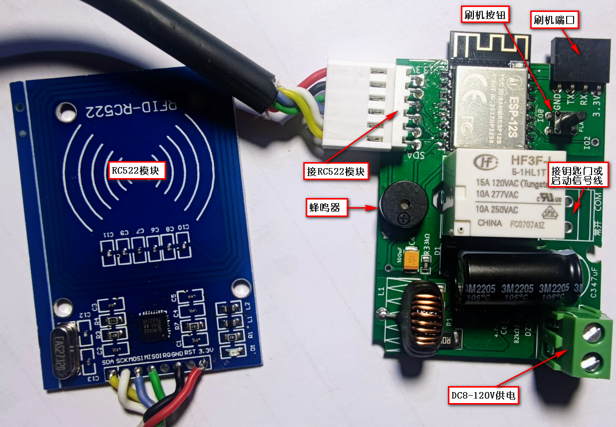

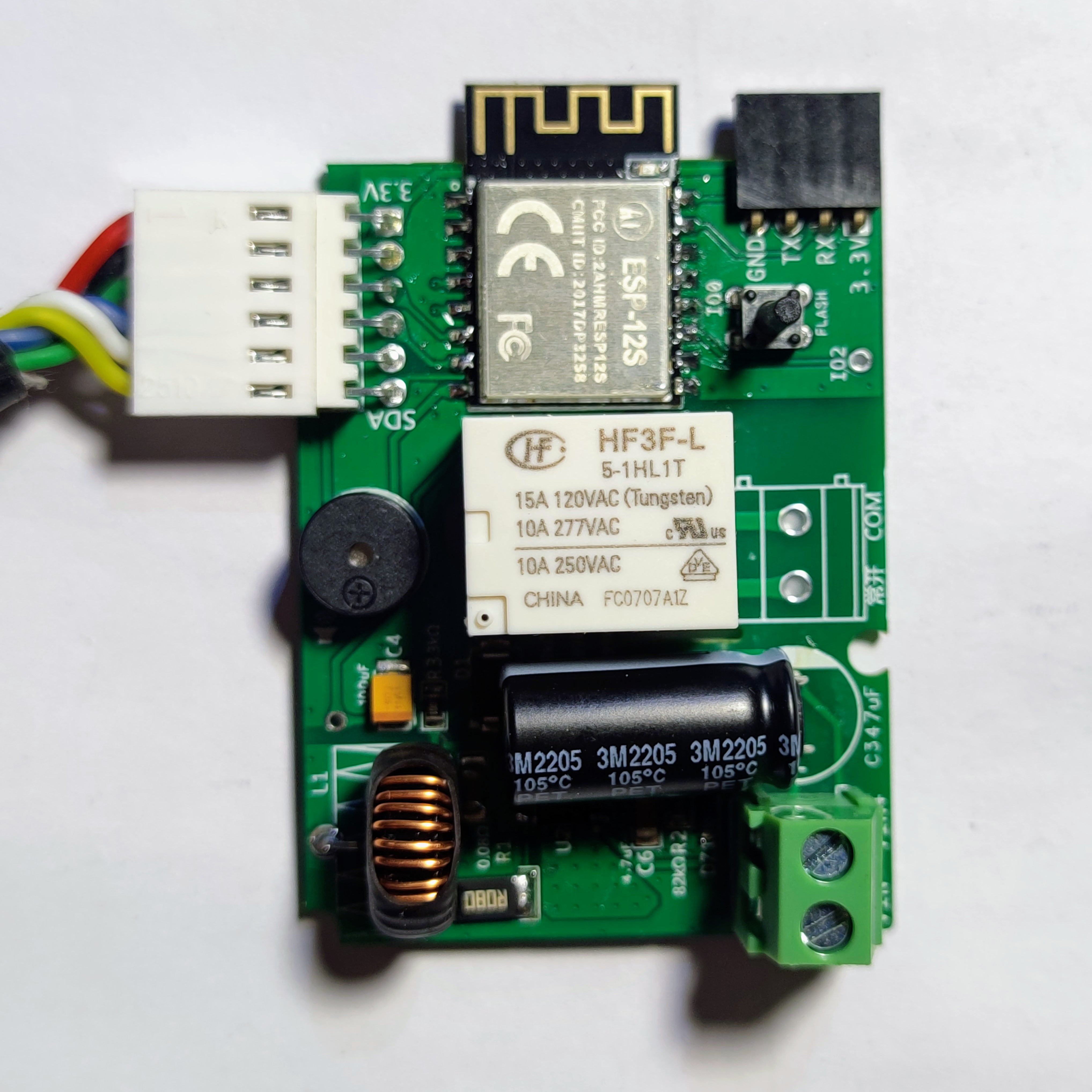

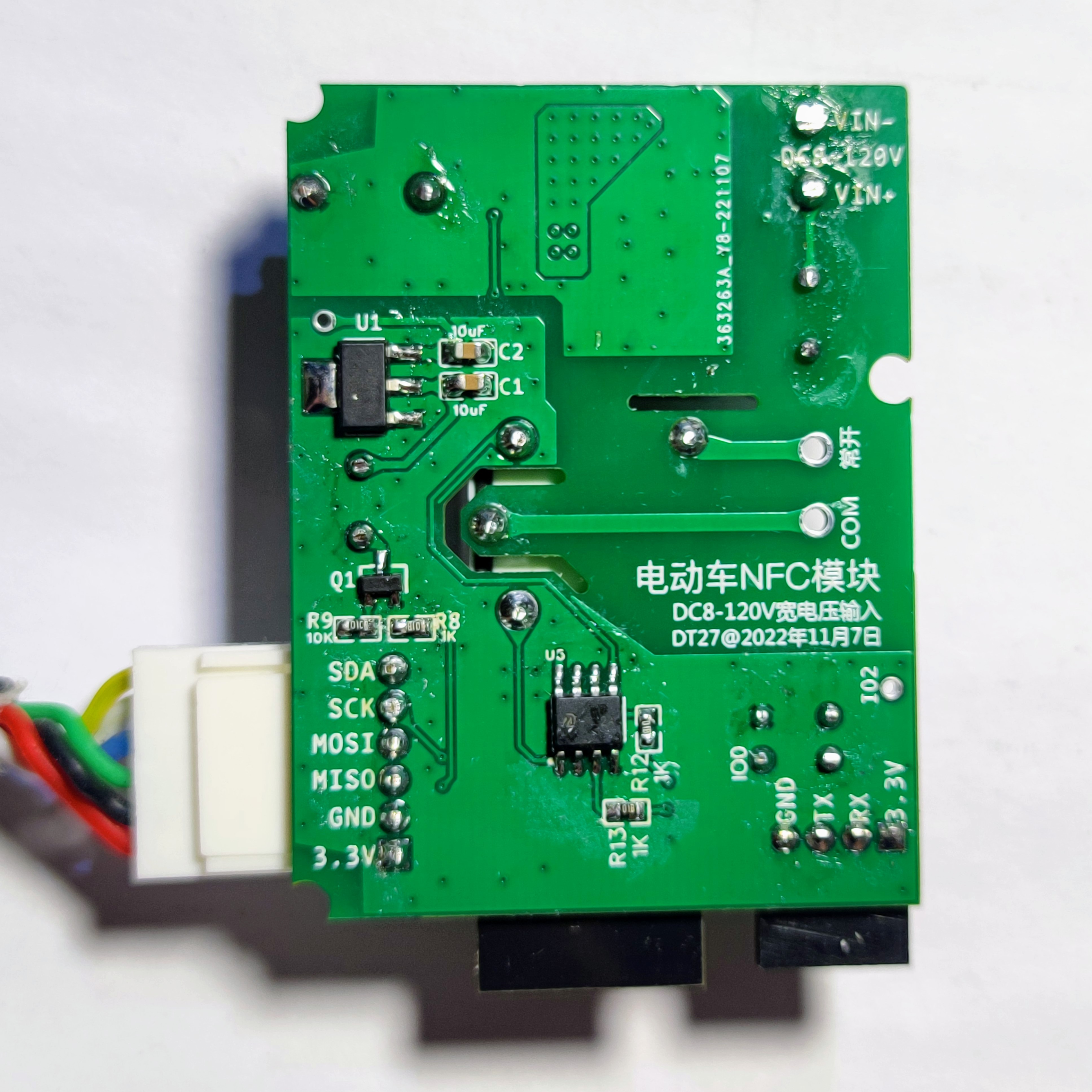

The electric vehicle NFC control module supports DC8-120V input.
Electric vehicle NFC controller, supports DC 8V~120V input.
Previously, it used a standard relay with 3.3V power supply: https://oshwhub.com/dt27/wifi-switch_copy.
This is an improved version, integrating a DC-DC wide voltage step-down converter, supporting DC 8~120V input.
The relay has been changed to a magnetic latching relay, providing instantaneous power during switching with no additional power consumption, preventing accidental activation, and ensuring the current status is unaffected by unexpected power outages.
The control center is an ESP-12S, not an ESP-12F!
The relay can control a maximum current of 10A.
An integrated buzzer is used to provide feedback on the card swipe result.
The NFC module is an RC522; this board only has an interface, so the RC522 module must be purchased separately.
RC522 module (7.8 RMB including shipping): https://dwz.ee/2fj.
Detailed information and firmware setup tutorial: https://www.domoticz.cn/forum/viewtopic.php?t=468

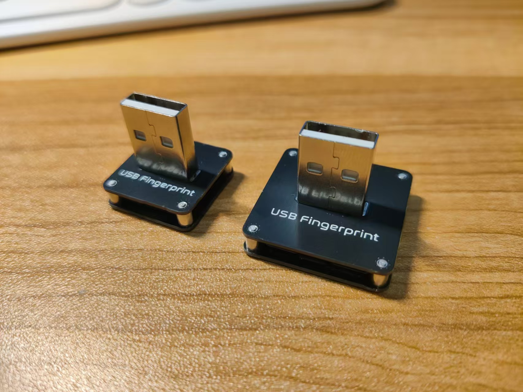

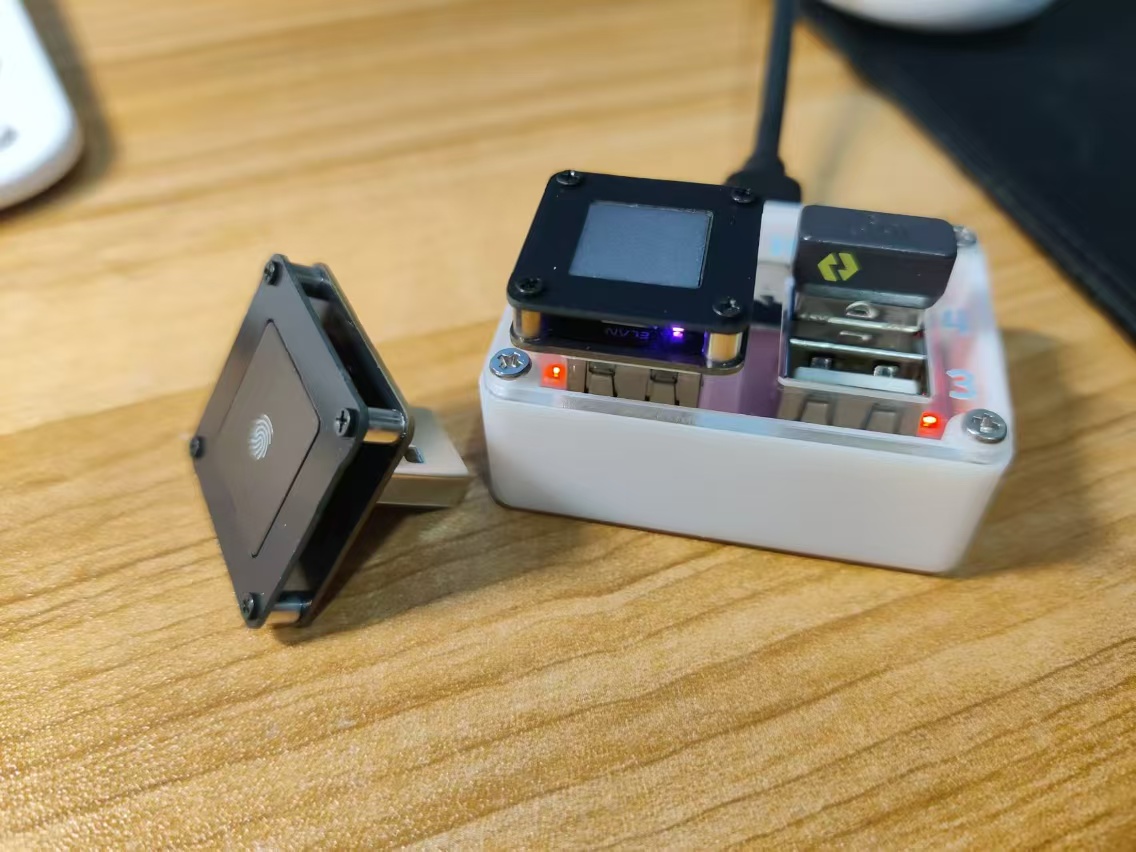

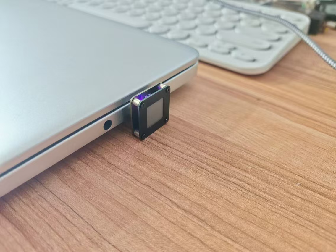

USB fingerprint unlocker
USB Windows Hello fingerprint unlocker
USB Windows Hello Fingerprint Unlocker
Precautions

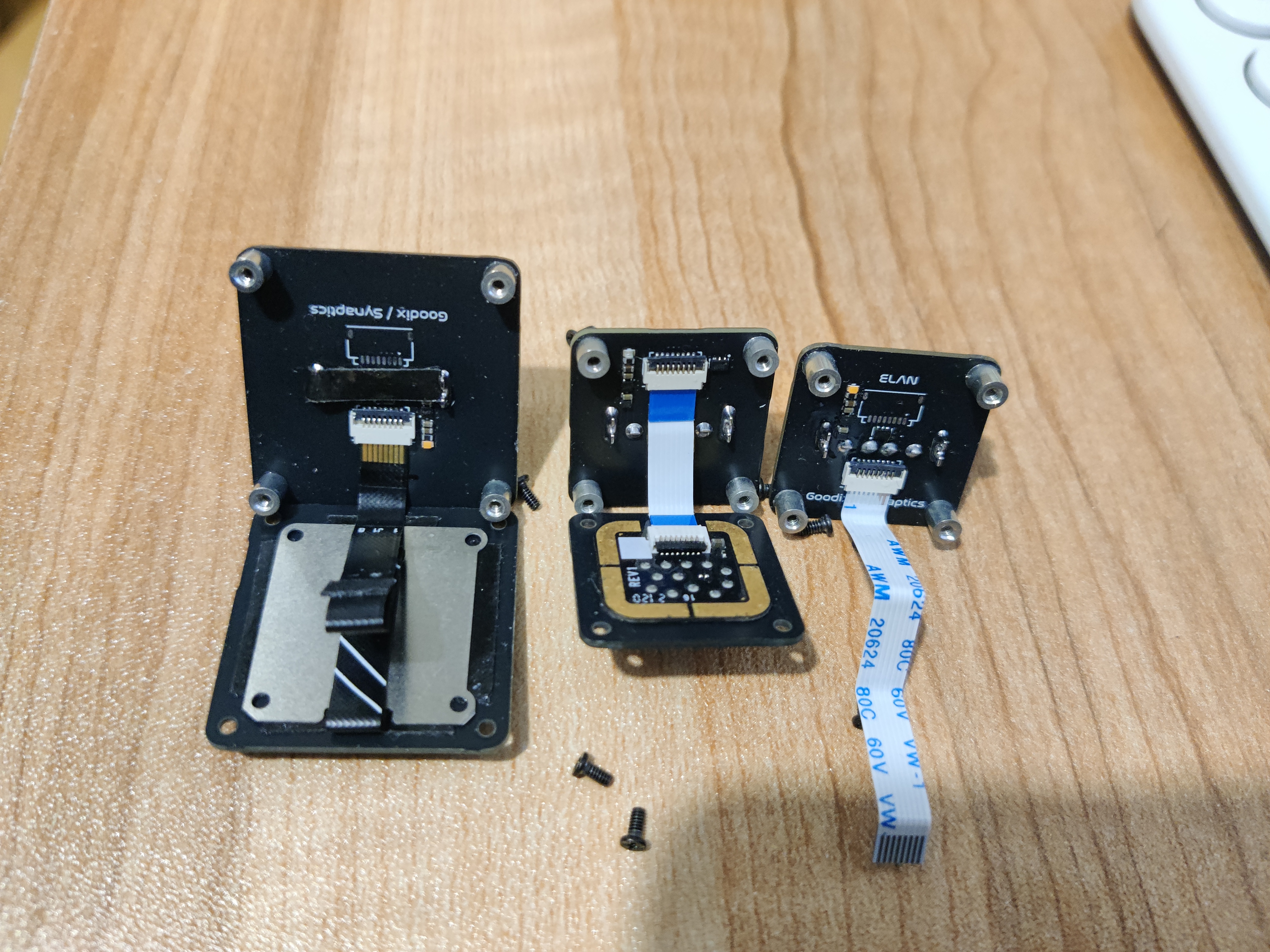

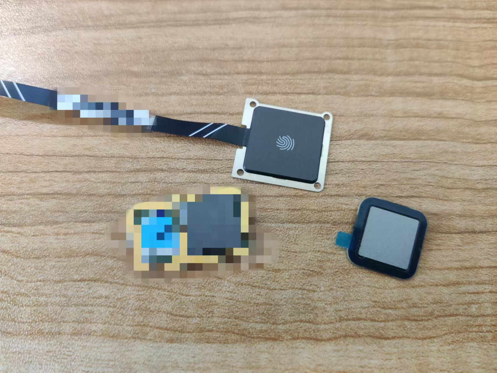

: Surface Mount Screw Types: M1.4x3.5x3 (compatible with both large and small fingerprint modules) M1.4x2.5x3 (compatible only with small fingerprint modules) http://e.tb.cn/h.gFORRMfQvepkzQJ?tk=o3pY3PS569c
Screw Types: Black M1.4x3x2.5
USB Straight-in Male Connector (select white color) http://e.tb.cn/h.gFWbdQ4tPswioQ7?tk=guqj3PSVJeb
Supports the two fingerprint modules shown below. Purchase channels can be found in the following two items. Always check the wiring sequence before powering on!
https://oshwhub.com/pomin/integrated-desktop-tool-windowsh
https://oshwhub.com/willew/ji-cheng-windows-hello-zhi-wen-dial-hub-de-zhuo-mian-gong-ju (
Assembly)

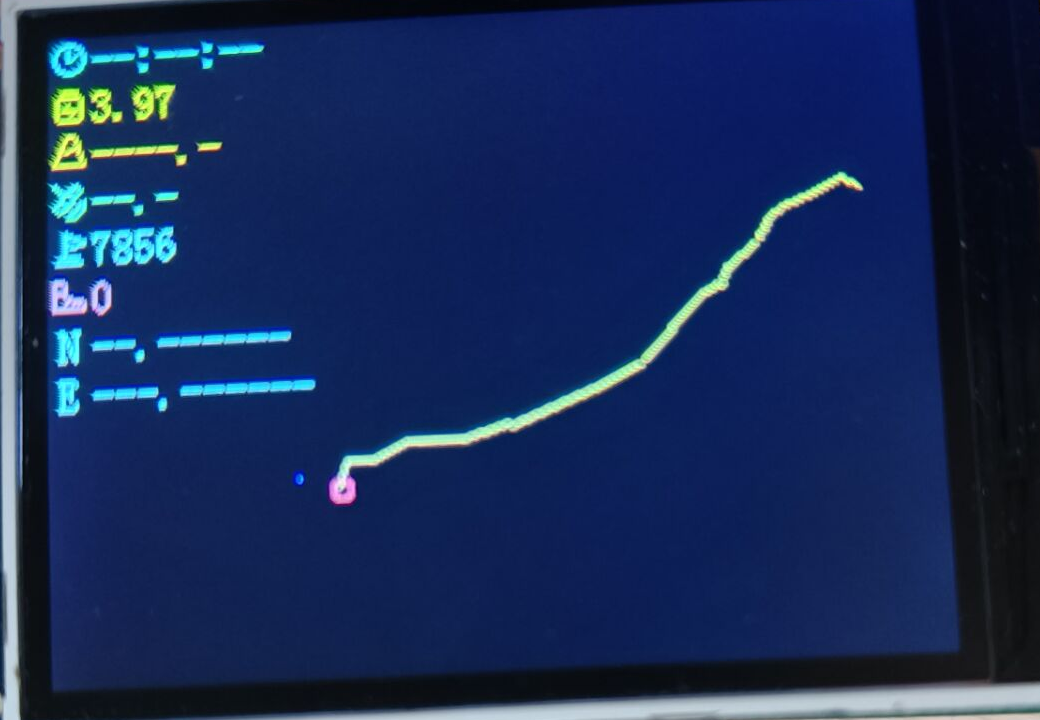

This device uses STM32F103RCT6 as the main controller. Users can set the navigation destination by inputting Chinese characters via buttons. The system can convert the destination into latitude and longitude coordinates, and simultaneously obtain the starting coordinates by reading the GPS module to generate a cycling navigation route based on the Gaode Map API.
This device does not require a mobile app, but the mobile phone still needs to enable its hotspot function to provide Wi-Fi. For
font download steps, refer to "Software Design -> Chinese Input Method -> Font Download".
When the device starts up, the GPS will search for satellites; during this time, the LED corresponding to "GPS" on the front will not light up. During the satellite search, the device must remain stationary and free from obstructions from buildings above (trees will not affect the GPS module's hot start). Before

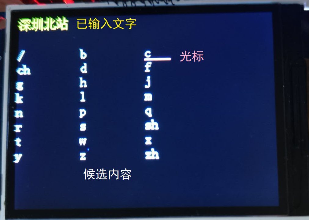

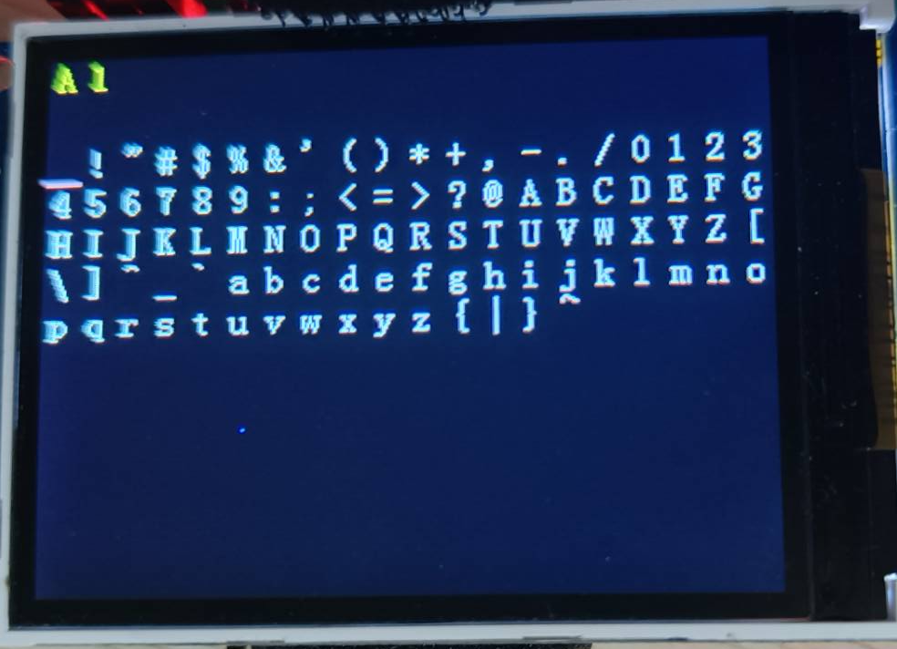

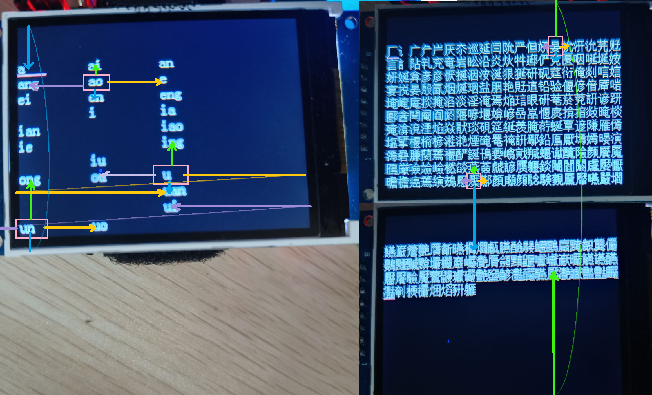

Upon startup, the device enters the input method (foreground application `inputmethod_app`).
The entered text is displayed at the top of the screen, and candidates are shown below.
When inputting Pinyin, there are 3 items per line; when inputting Chinese, there are 20 items per line. The cursor can be moved to select the text to be entered.
ASCII character input mode.
Key bindings:
Delete last entered text/Delete previous option | Move cursor up | / | Search destination
Move cursor left | Select current option | Move cursor right | /
Clear current content | Move cursor down | / | Switch location/city.
The cursor movement definition is shown in the image below.
Left/Right: Select the previous/next feasible option.
Up/Down: Search for a feasible option up/down. If only one feasible option is available in this column, the cursor remains stationary.
The city is preset to Guangdong (this parameter can be a province/city or empty), and can be modified using the input method or by modifying the preset content in the code.

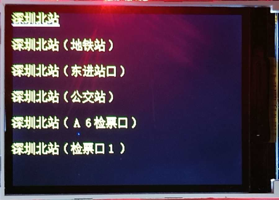

After completing the input, if the Wi-Fi indicator light is on, you can start searching for the destination (if not connected to Wi-Fi, information is sent to the ESP32; once connected to Wi-Fi, the route may be planned normally, or the message may be overwritten).

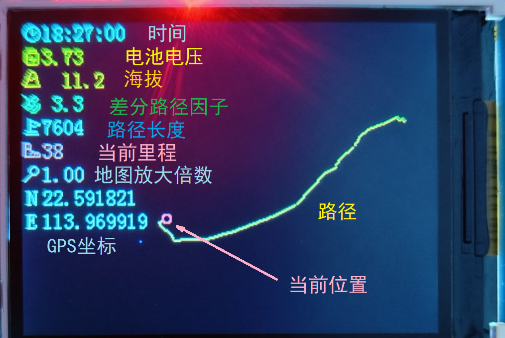

After a successful search, the interface will display up to 6 candidate options (foreground application search_app). Users can select the final destination from the following addresses.
After successful route planning, the interface switches to route display (foreground application route_app).
The following is for GPS offline status.
The following shows the GPS online status.

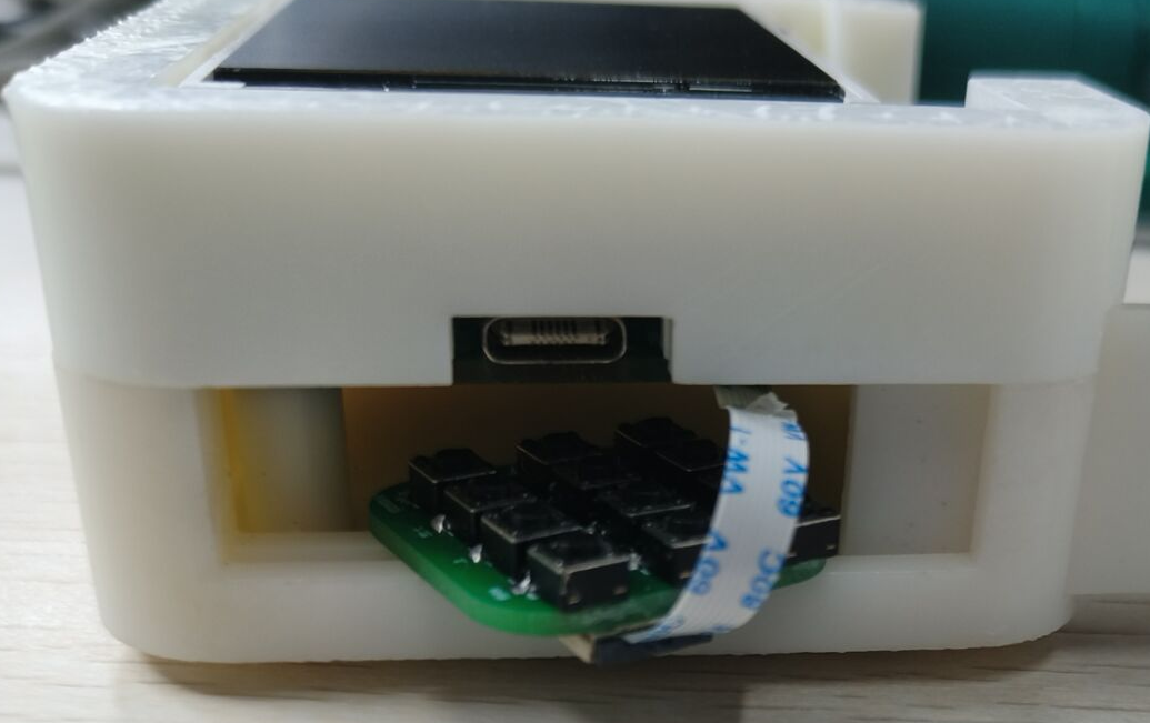

When placing the keyboard, it is recommended that the FFC cable face outwards for easy removal of the keyboard PCB next time.

the lower half of the casing, the keyboard PCB may be difficult to remove due to the abrupt change in height.
It's possible to transition the edges and bottom with a bevel, or to make the edges and bottom the same height, and then cut grooves on top of that.
The TFT screen currently uses an 8-pin connector; this could be replaced with a design without a base plate, where pads are directly drawn on the PCB for connection, reducing the overall thickness of the device.

A smaller package could be considered for the STM32 crystal oscillator.
A buzzer could be used to indicate the need for a turn or low battery.
Caution! Be
careful of cold solder joints on STM32 pins. Also, pin 1 of the chip is not located in the upper left corner of the printed text; the pin 1 position is indicated by the smaller circle.
When soldering the ESP32 (QFN package), the GND pad should not have too much solder, otherwise the entire chip will be lifted, and pins 1-48 will not make contact with the pad.
When using this chip, the hardware serial port U2 corresponds to pins IO16/17 (Pin 25/27), but the chip datasheet clearly states that these two pins are used to connect the chip's Flash memory and cannot be used (Pins IO16, IO17, CMD, CLK, SD0 and SD1 are used for connecting the embedded flash and are not recommended for other uses. For details, please see Section 6 Schematics.). Otherwise, the program will repeatedly reset.
Therefore, serial port U1 (U0 is used for debugging) or a software serial port should be used for communication.
When using software serial communication, a baud rate of 9600 is recommended. When the baud rate is higher (presumably due to the software serial port or the PCB layout affecting the signal), using idle interrupts for reception may result in incomplete information received by the host (this phenomenon was observed at a baud rate of 57600, with the longest received data being around 40).
When using ESP32's timer interrupts, the interrupt handler function cannot perform blocking operations (including Serial.print, etc.), and excessive code execution time may also lead to errors. Therefore, when an interrupt is triggered, a flag can be used to record this state, and the interrupt can be handled in the loop() function.

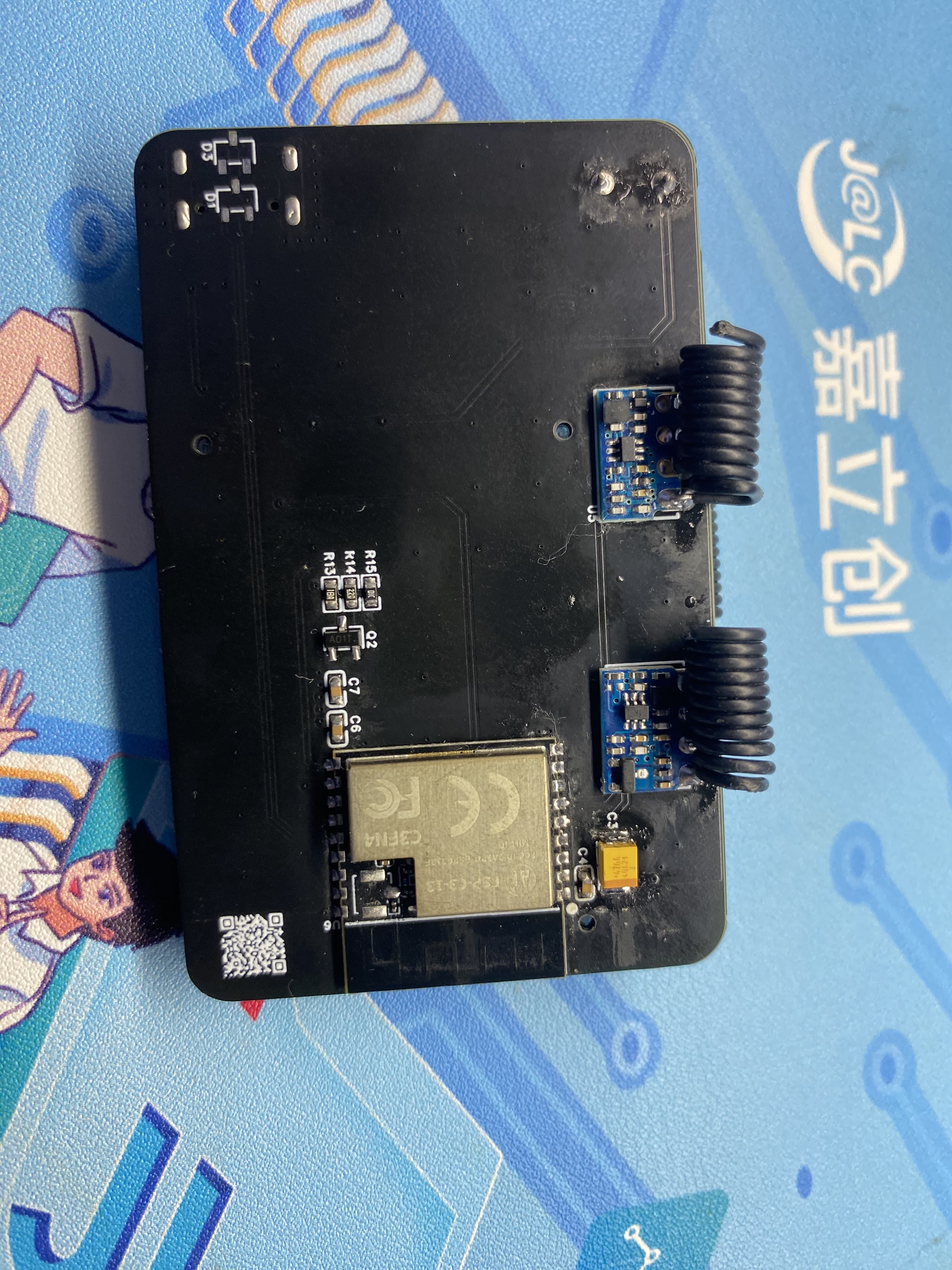

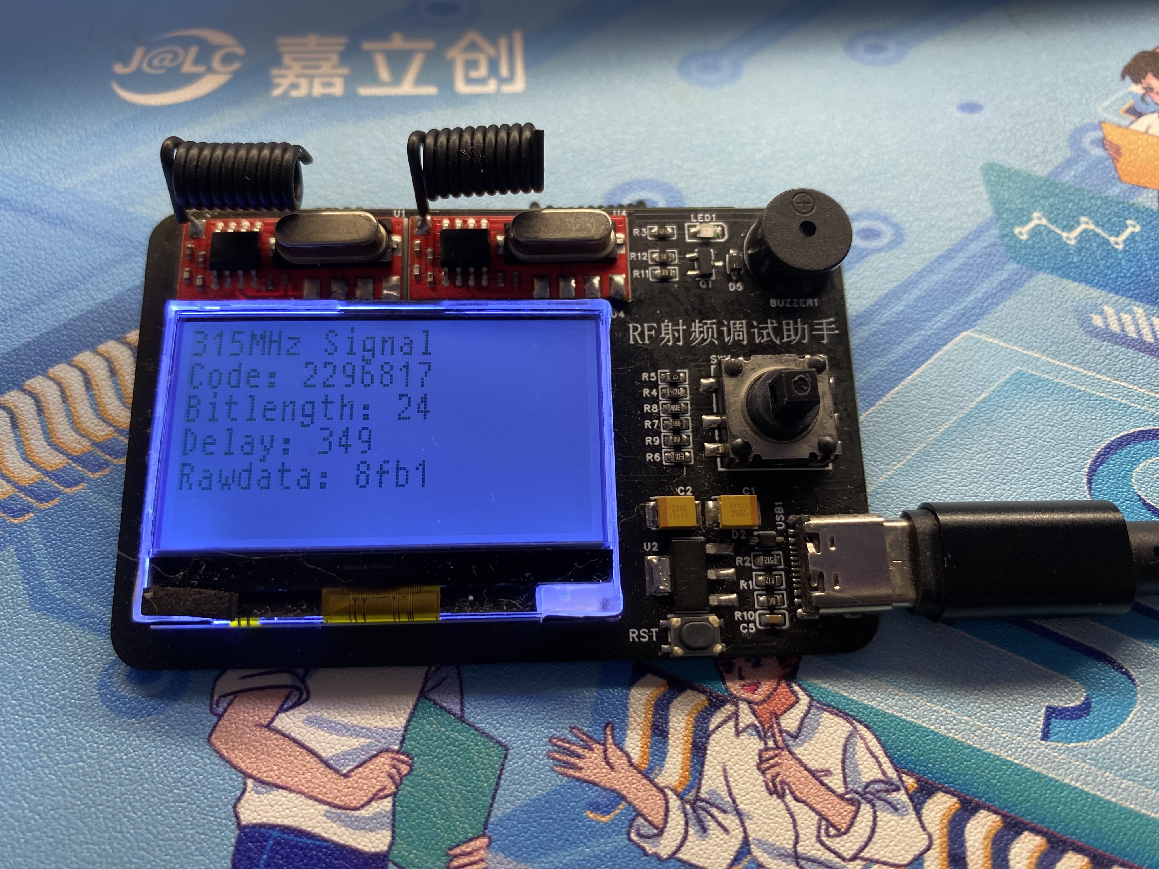

RF Debugging Assistant
This RF assistant, based on the ESP32-C3 design, supports reception and transmission in the 433MHz and 315MHz frequency bands.
This open-source project is for learning and reference only. Please do not use it for commercial or illegal purposes. If you do not agree to these terms, please close this page.
Current version 1.0V
: 1. Buzzer changed to passive version
. 2. Added transmit/receive indicator lights.
3. Download method changed to USB to reduce component costs.
Project Introduction:
1. This open-source RF debugging assistant uses the ESP32-C3 as the main controller, acquiring 433MHz and 315MHz RF signals. It has onboard transmit and receive functions and is equipped with a low-power LCD screen and buzzer for debugging and verifying RF products. It is compact and portable.
Features:
USB download method for one-click download and debugging.
Low-power LCD screen for greater durability.
Dual-band transmit and receive, strong compatibility.
Five-way button supports menu and parameter settings and saving.
Instructions for Use:
1. After plugging in the power, the RF assistant will display a startup screen. After startup, it defaults to receiving mode. When it receives any 433MHz or 315MHz frequency band signal and displays it on the LCD screen, the screen mainly displays the source of the frequency band, data values, and other common RF parameters.
2. The menu button can be accessed via a five-way switch to select functions for RF product debugging.
3. USB powered, simple and convenient, plug and play; it can be powered by a charger plug or a power bank's USB plug. A battery expansion board can be designed for use if needed.
Physical Demonstration
Precautions:
1. When soldering, please pay attention to the soldering sequence to ensure correct power supply and avoid burning out subsequent circuits! The soldering sequence should follow the principle of from shortest to smallest, and from inside to outside.
2. The circuit has been verified. Solder according to the component parameters in the schematic diagram. It is recommended to solder the main controller first, as it is more difficult to solder; a heated soldering station is recommended
. 3. When using board cleaning fluid, be careful not to touch the buttons, as corrosion will make them difficult to use.
4. It is recommended to use the schematic diagram parameters; the BOM contains errors.
