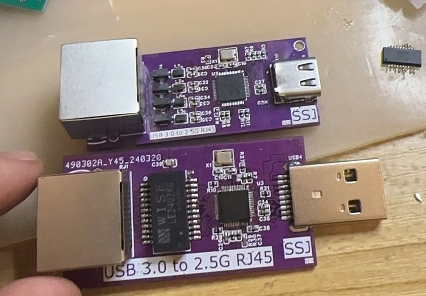

The SOC module
references a 2.5G network card based on the RTL8156B chip using the USB 3.0 protocol – JLCPCB EDA open-source hardware platform (oshwhub.com), with the main chip design based on RTL8156+VL822+FE2.1 (fully verified) – JLCPCB EDA open-source hardware platform (oshwhub.com), and modifications have been made.
The USB interface module
uses a USB 3.0-A interface, requiring no external components. RX and TX can be directly connected to the SOC's TX and RX. (The SOC has a series capacitor.)
The network interface module
uses an independent transformer and an RJ45 port. Using an independent transformer is cheaper, although it increases the board design complexity compared to an integrated RJ45 and transformer design. (A separate transformer will be available later, with even lower costs).
The network port impedance is 90Ω differential, with a trace width of 9.3mil, a trace spacing of 5mil, and a ground plane spacing of 5mil. (The trace width may be slightly narrower depending on the actual routing.)
The PCB design
uses a two-layer board design, employing coplanar impedance ground planes for impedance control. (Actual measurements have not been taken; impedance cannot be controlled using free prototyping.)
The magnitude of the coplanar impedance is highly dependent on the trace width and ground plane spacing. The smaller the ground plane spacing and the wider the trace, the smaller the distributed capacitance and the higher the impedance.
The power supply design
uses one DC-DC converter and one LDO to provide the power required by the SOC.
The DC-DC converter uses an RT8096 with a 0.9V output. The output voltage calculation is 0.9 = 0.6(1 + 5/10). A 3.3uH inductor is used, but a 1uH inductor would be more suitable for 0.9V. A 10uH output capacitor is used according to the datasheet.
The LDO uses an RT9080-33GJ5 with a fixed output voltage of 3.3V; no other external components are required.
The exterior design
is currently unavailable; the casing is still under design. (Hoping to complete this with expert help, as I am not skilled in modeling). More data will be added
