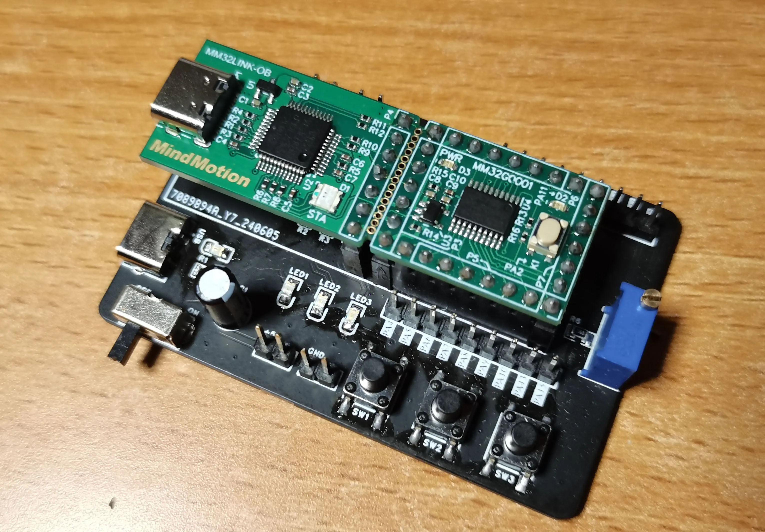

This development board supports two download methods: download by clicking the download button in KEIL; or, after connecting to a computer, a USB external hard drive will appear on the computer. Simply copy the hex file generated by the program directly to the external hard drive space to complete the download.
The expansion board has all pins brought out and adds button input, tri-color LED, and ADC input functions. The silkscreen printing on both sides of the pin headers is unclear due to phase inversion. If needed, please disable the phase inversion or increase the font size.
This expansion board has a reserved download section. If the download module is disassembled, please modify the position of the pin headers and their wiring.
There is a problem in the official HAL library example code; the pin settings in the baud rate settings of platform.c are incorrect. PA10 multiplexing function 4 must be changed to PA12 multiplexing function 1. If not modified, the program will download normally, but serial communication will fail, as shown in
the error code (official code) in the image below:
Correct code:
