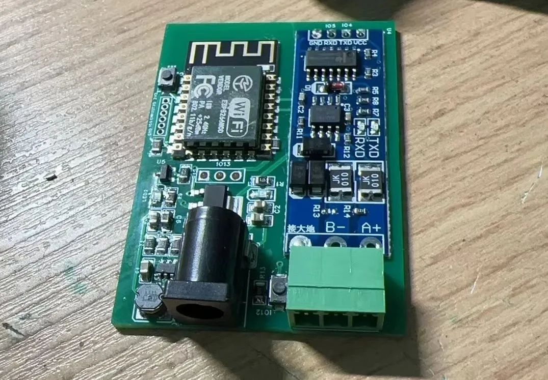

This ESP8266 to 485 converter facilitates the connection of 485 devices to ESPHome. It supports a maximum power input of 16V. The PCB has been slightly modified, but the schematic remains unchanged. The reason
for using a 485 module instead of a 485 chip is that the 485 module is cheaper and more cost-effective
. It includes one button, one I/O, and one LED, which can be programmed according to your needs. A download interface is provided for easy program burning.
The attached YAML configuration file is for an air quality sensor; you can modify the device address and register address to suit your requirements.
