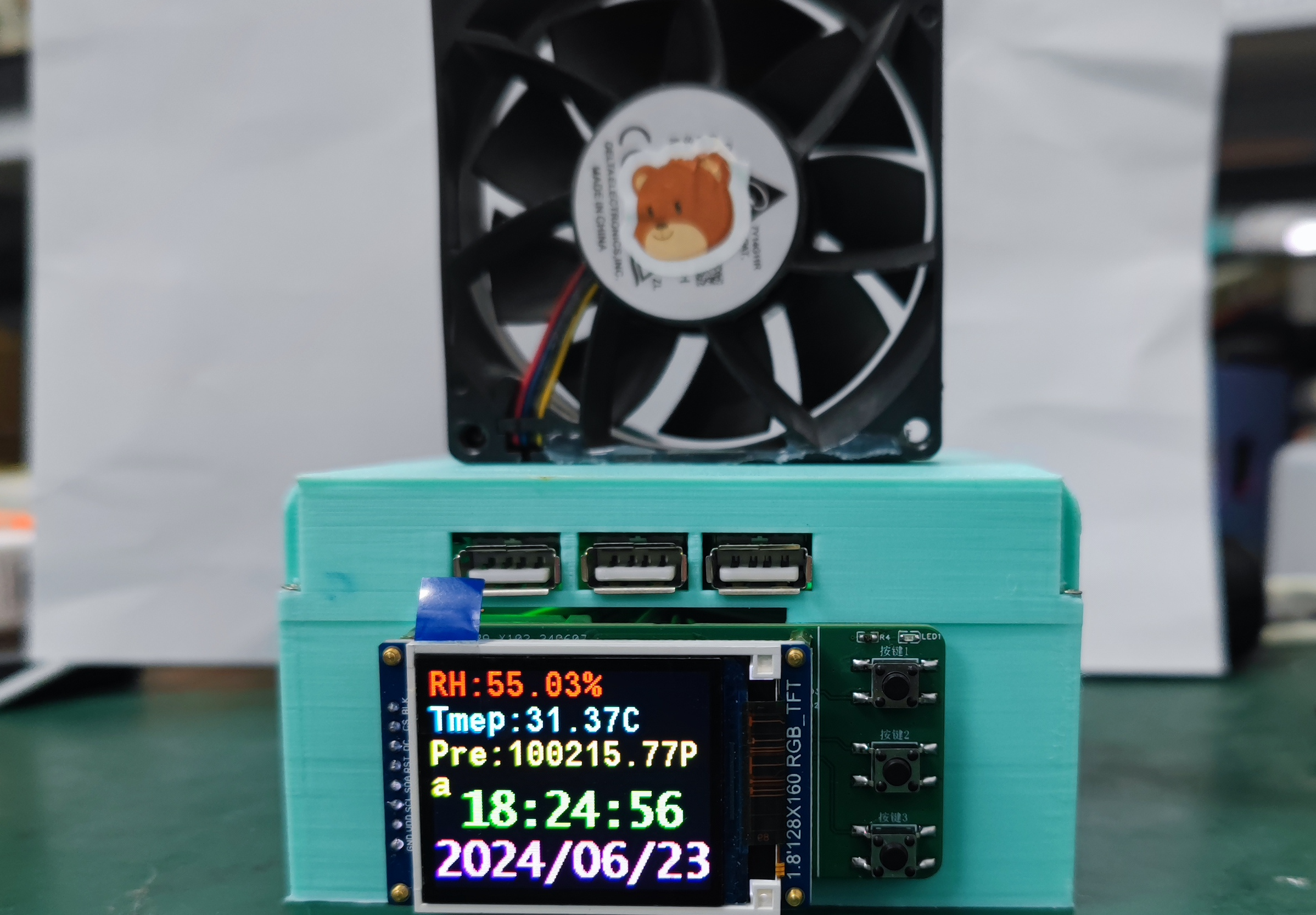

One tiring afternoon, my phone battery was low, and the air was so stifling it felt like it was evaporating all my rationality. Desperate for a little relief, I decided to look for a fan on Taobao. But a glance at the price tags instantly dampened my spirits. The few meager bills in my wallet seemed to be silently accusing me: "Hey buddy, take it easy!"
Just as I was agonizing over whether to stay cool or go broke, those forgotten little parts in the component box under my desk suddenly whispered in my ear: "We can help you!" My inherent arrogance as an electronics student surged: "What's money? Can you eat it? I'll build this fan myself!" Just then,
OSHWhub pushed a notification for an event, as if it were destiny, and the opportunity presented itself. You see, sometimes fate is just that coincidental; when you decide not to give in to fate, it sends you a lucky card instead. So, I immediately got to work, DIYing a cool and budget-friendly super fan, giving both my wallet and my rationality a sigh of relief.
With this fan, even the hottest days have become a source of joy. I no longer need to worry about my phone running out of battery or the sweltering heat, because I'm my own boss—I can cool off whenever I want!

In this design, the hardware system includes an STM32F103C8T6 microcontroller minimum system, an SW3526 charging chip minimum system, a flyback switching power supply module, an ST7735 color screen for displaying relevant data, and an ASRPRO offline voice module.
