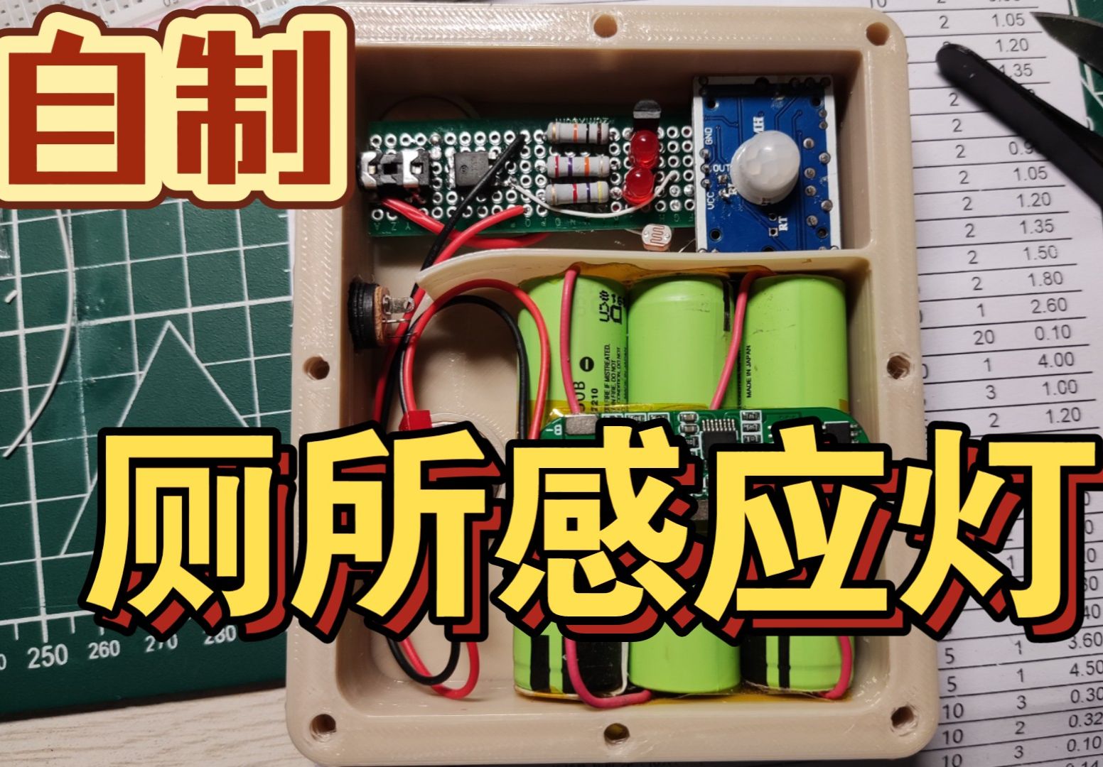

Human Body Induction Light - Open Source Sharing V1.0
This innovative design uses an audio cable as the LED strip connection, making it convenient for the elderly and children to plug in without problems. The connector can rotate 360 ​​degrees without issue. A voltage comparator is used as a power indicator, providing convenience for nighttime use in dry toilets.
(Click here to watch my homemade smart sensor light on Bilibili.)
