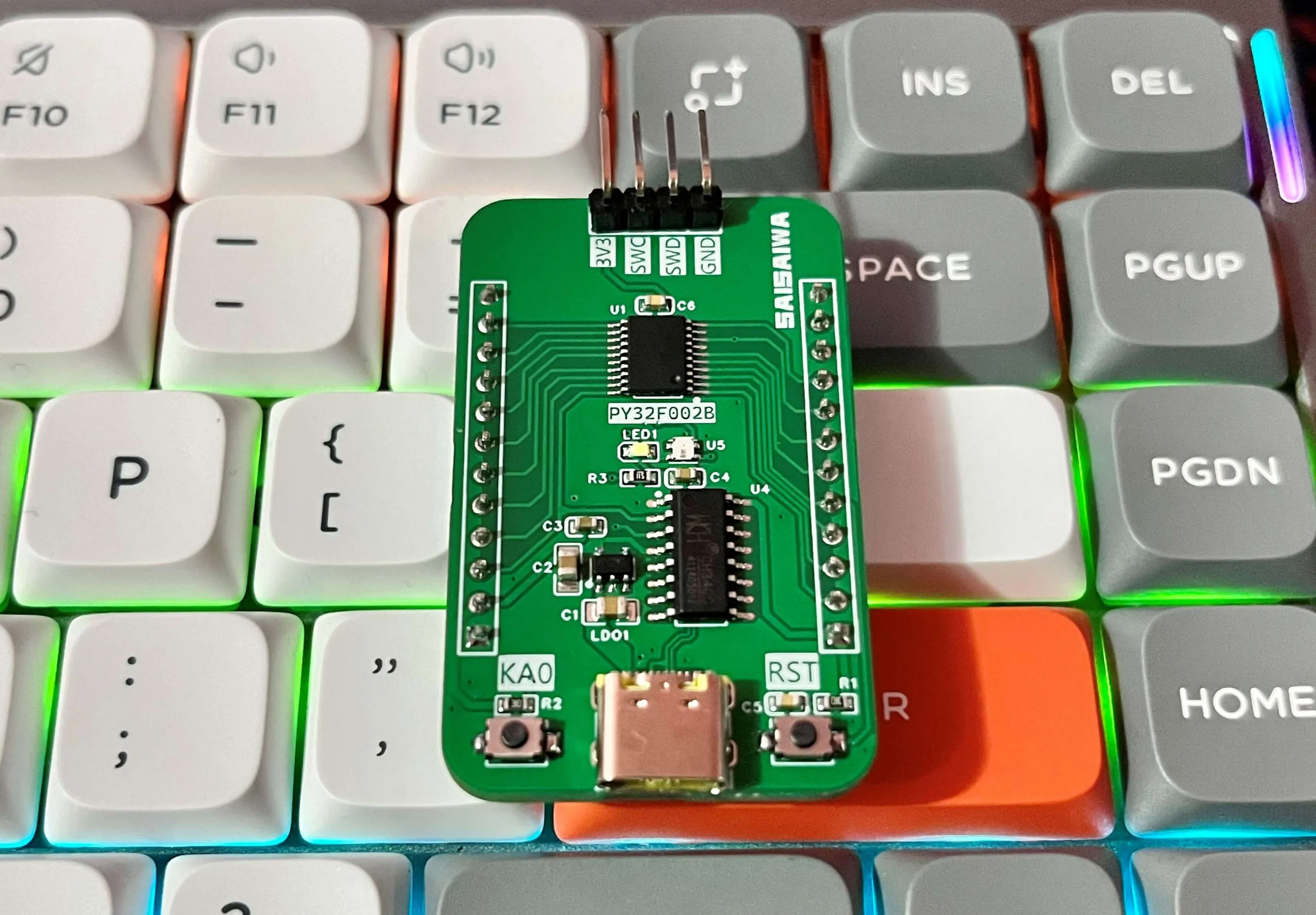

PY32F002BF15P Development Board
The PY32F002BF15P development board

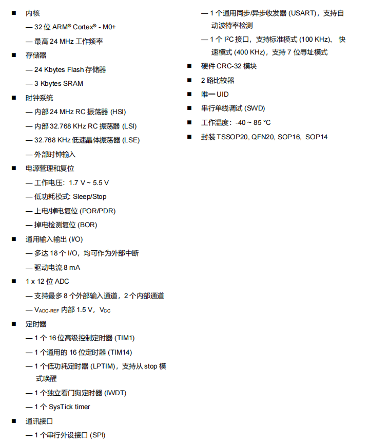

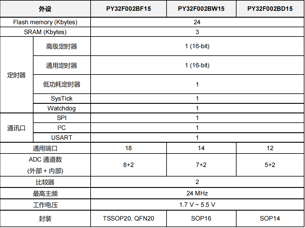

features a PY32F002B series microcontroller that utilizes a high-performance 32-bit ARM® Cortex®-M0+ core and a wide voltage operating range. It incorporates 24 Kbytes of Flash and 3 Kbytes of SRAM memory, with a maximum operating frequency of 24 MHz. Various package types are available. The chip integrates I2C, SPI, and USART communication peripherals, one 12-bit ADC, two 16-bit timers, and two comparators. The PY32F002B series microcontroller operates within a temperature range of -40°C to 85°C and a voltage range of 1.7 V to 5.5 V. The chip provides a sleep/stop low-power mode to meet the needs of various low-power applications.
Advantages: Inexpensive price (5 cents per piece), abundant resources
Development board peripherals include
LED
WS2812B RGB beads, which can be driven by SPI or ordinary IO.
A user-defined
RESET button is included.
The CH340C serial port integrates
a Type-C interface.
SWD debugging and downloading of pin header
testing project code is available here: https://github.com/ccy-studio/CCY-PY32-Example.
