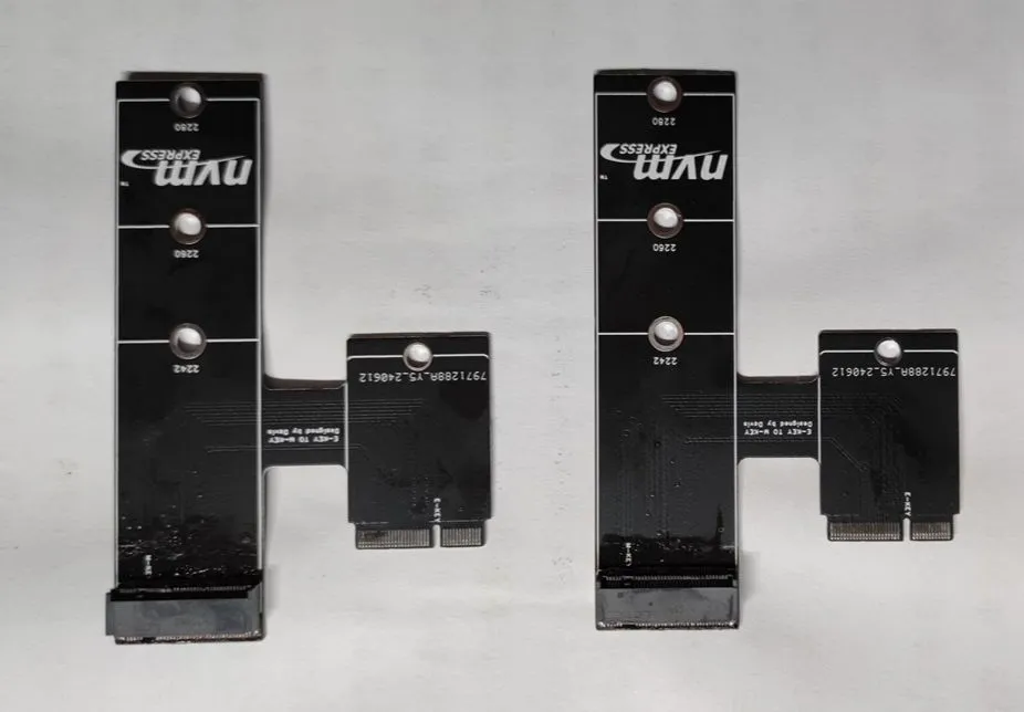

N5105 adapter board e-KEY to m-KEY
front of board,
back of board
