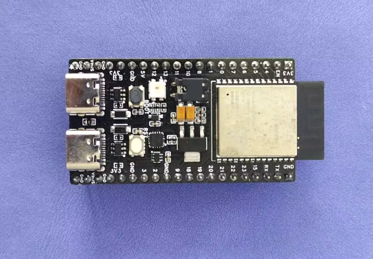

ESP32-C6-WROOM Development Board
1. Project Description:
This development board is only for testing program download; all other aspects are for testing.
Referencing the official development board, it has more power pins than the official board; it uses the CH343P to reduce layout area; it includes an RTC pin; the left Type-C port is for the chip's USB, and the right port is for UART, whereas the official board is the opposite.
2. Physical Sample Image
and Silkscreen Marking: PDSU: Pingdingshan College, 010424: Design completed on January 4th, 2024.
