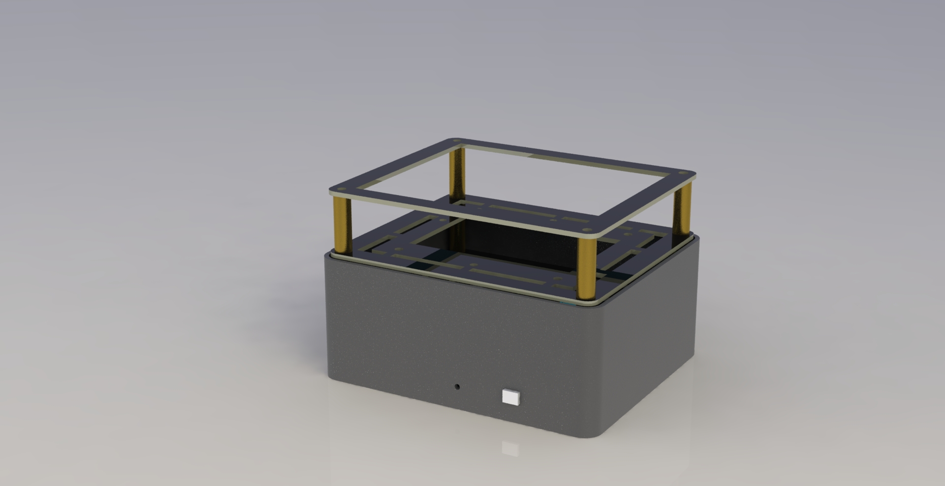

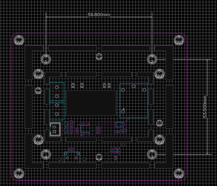

Urgent Reminder: The size of the Deer Fairy 300W heating plate I bought was 75*63mm, with a hole spacing of 60*53.5. The new model seems to have been redesigned, with a hole spacing of 66*53.5. The attached file shows the version with a hole spacing of 66; please check the hole spacing of your purchased PTC.

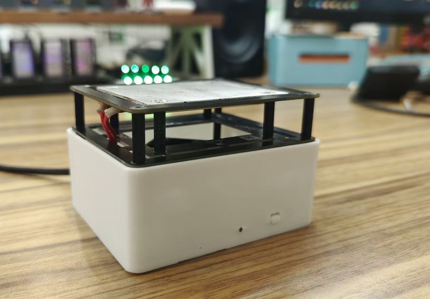

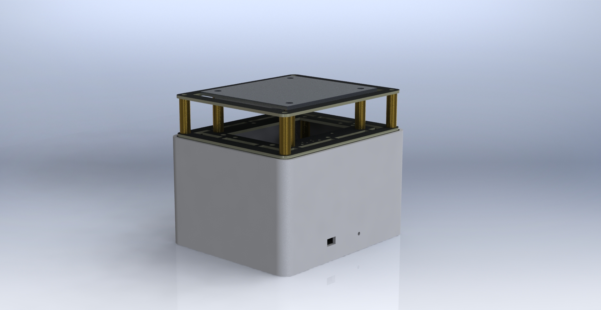

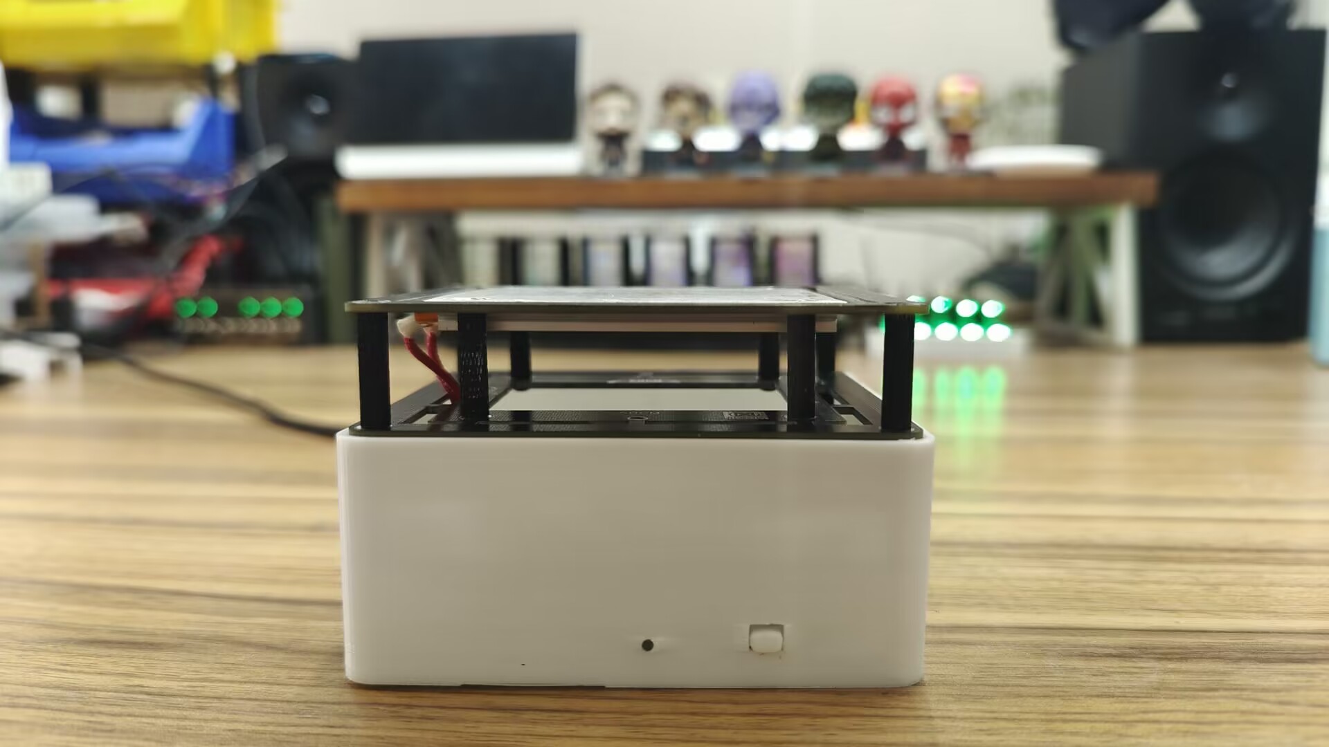

A super low-cost desoldering heating table is released, with an estimated cost exceeding 25 yuan (excluding printed parts). As we all know, beauty comes at a price... Ultimate Lite version.
Functions:
1. Blue light when powered on, no heating.
2. Press the button to start heating; automatically shuts off after 10 minutes of heating to avoid accidents caused by forgetting to turn it off (a lesson learned the hard way).
3. Press the button to turn off heating and turn on the fan for rapid cooling.

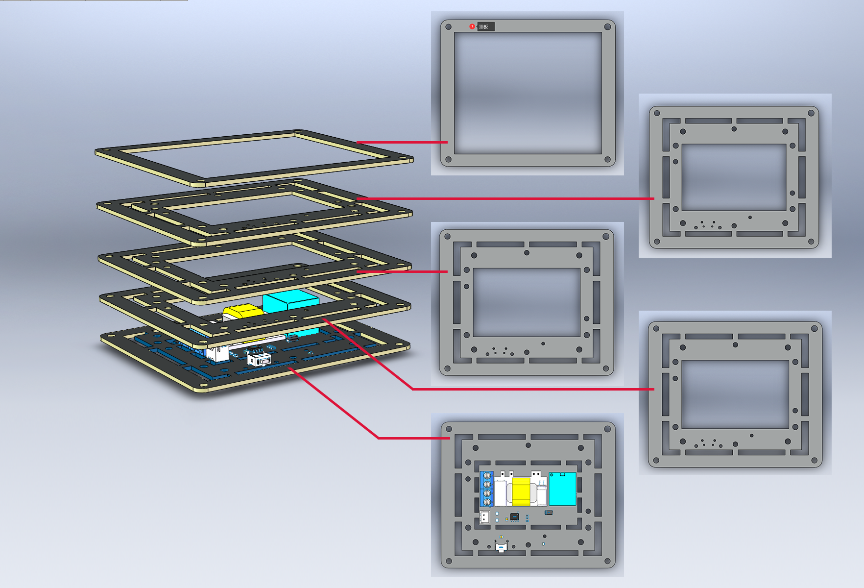

4. All supports and circuit boards can be obtained in one pass, saving JLCPCB money (most other systems currently require four passes).

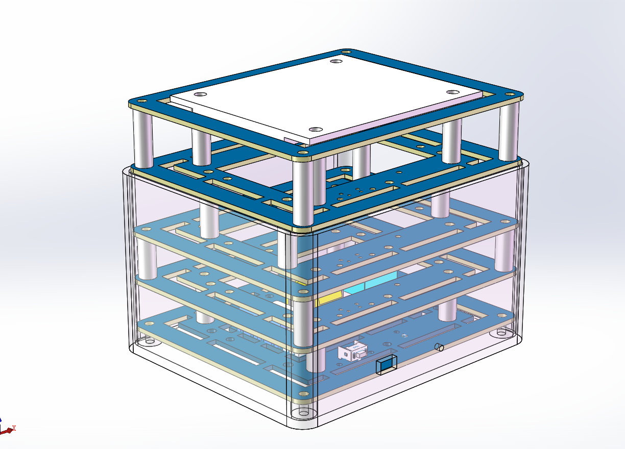

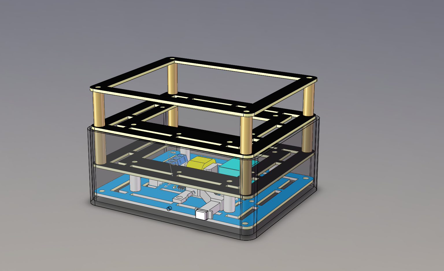

5. The heating plate is surrounded by a PCB to prevent burns when adjusting components (a lesson learned the hard way).
Bilibili Video: Open Source 25 Yuan Ultra-Low Cost Solder Paste Heating Station

May 27, 2024: Added 66*53.5 hole spacing file, fixed the error of three added LEDs not being correctly connected to GND.
