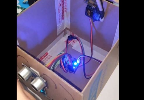

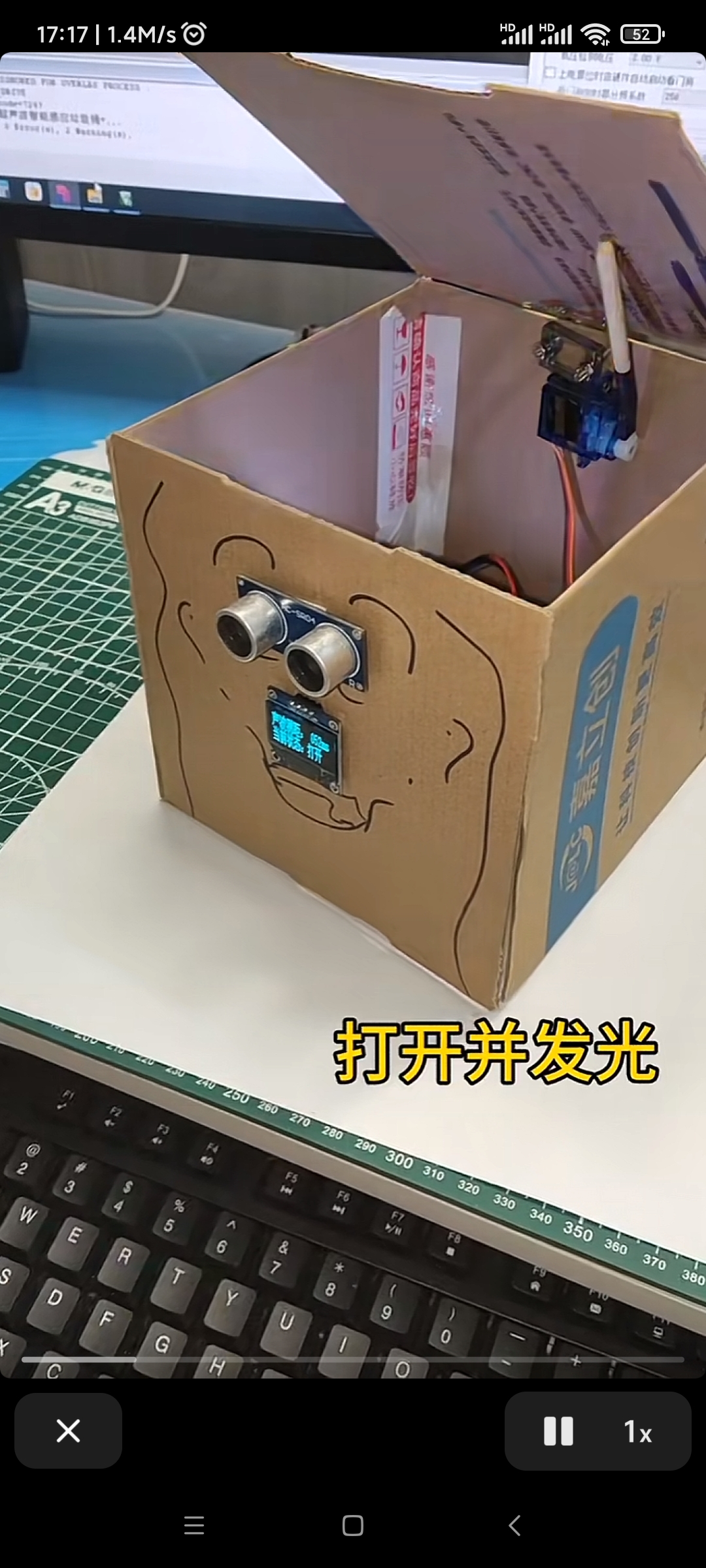

Ultrasonic smart sensor trash can
Fun and interesting microcontroller projects, including an ultrasonic smart trash can
. // The source code and PCB layout for the above projects are publicly available. Search "Qiqi Loves Microcontrollers" on the "LCSC Open Source Hardware Platform".
// Microcontroller model: STC8G1K08 1. When programming, be sure to select built-in IRC=30MHz. 2. Set the reset pin to the I/O port. 3. Uncheck the option to erase the user EEPROM area when downloading the user program.
