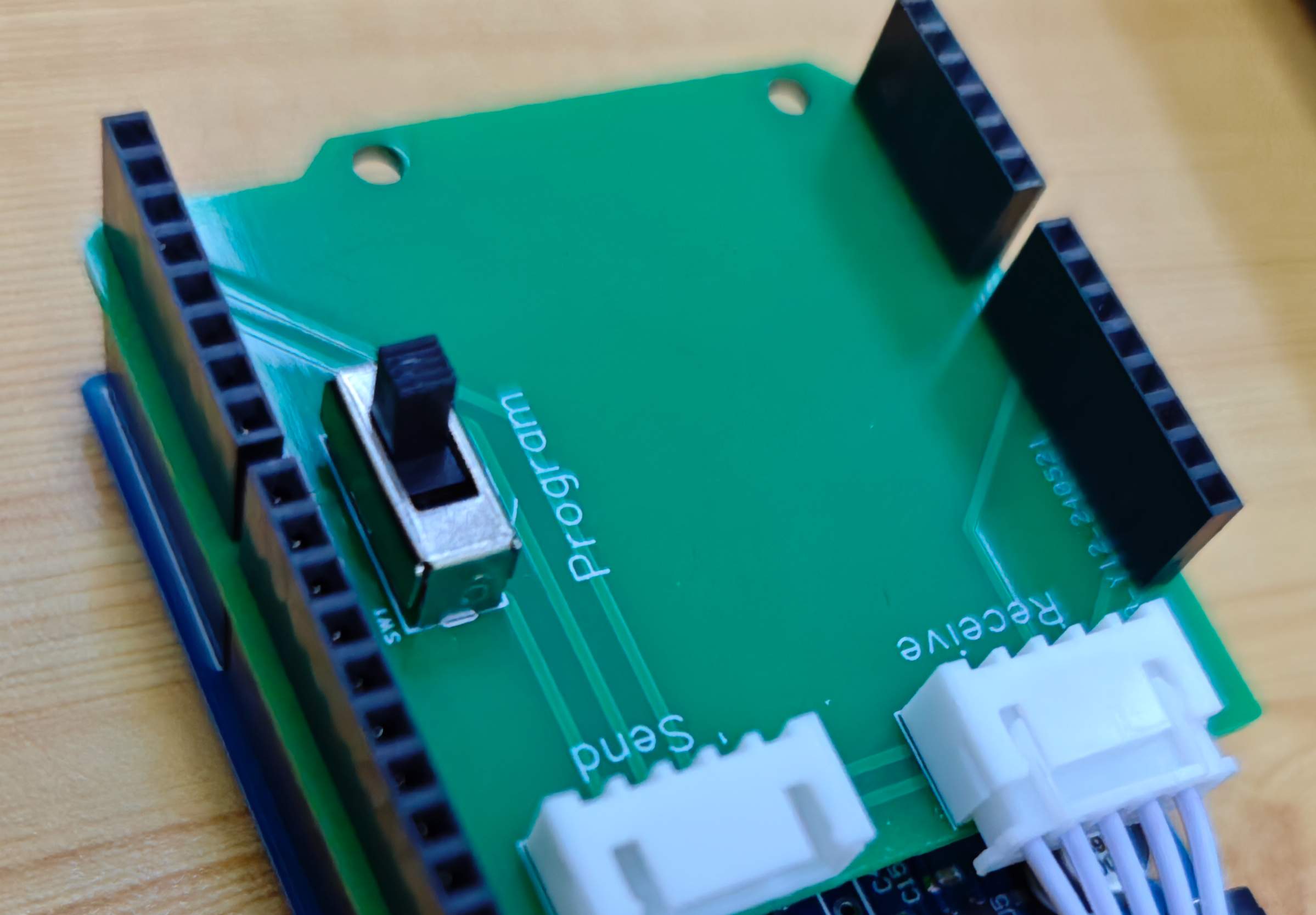

Based on the "Bootdrive" program (Baldwisdom/BootDrive at master · osbock/Baldwisdom · GitHub), this program is read from the chip and burned onto another Arduino UNO development board via serial port using the stk500 protocol.
Pins used:
Pins 0 and 1 (serial port),
Pin 4 (output reset signal)
, Pin 7 (connected to a switch to determine if the program copying mode has been entered).
Reset pin

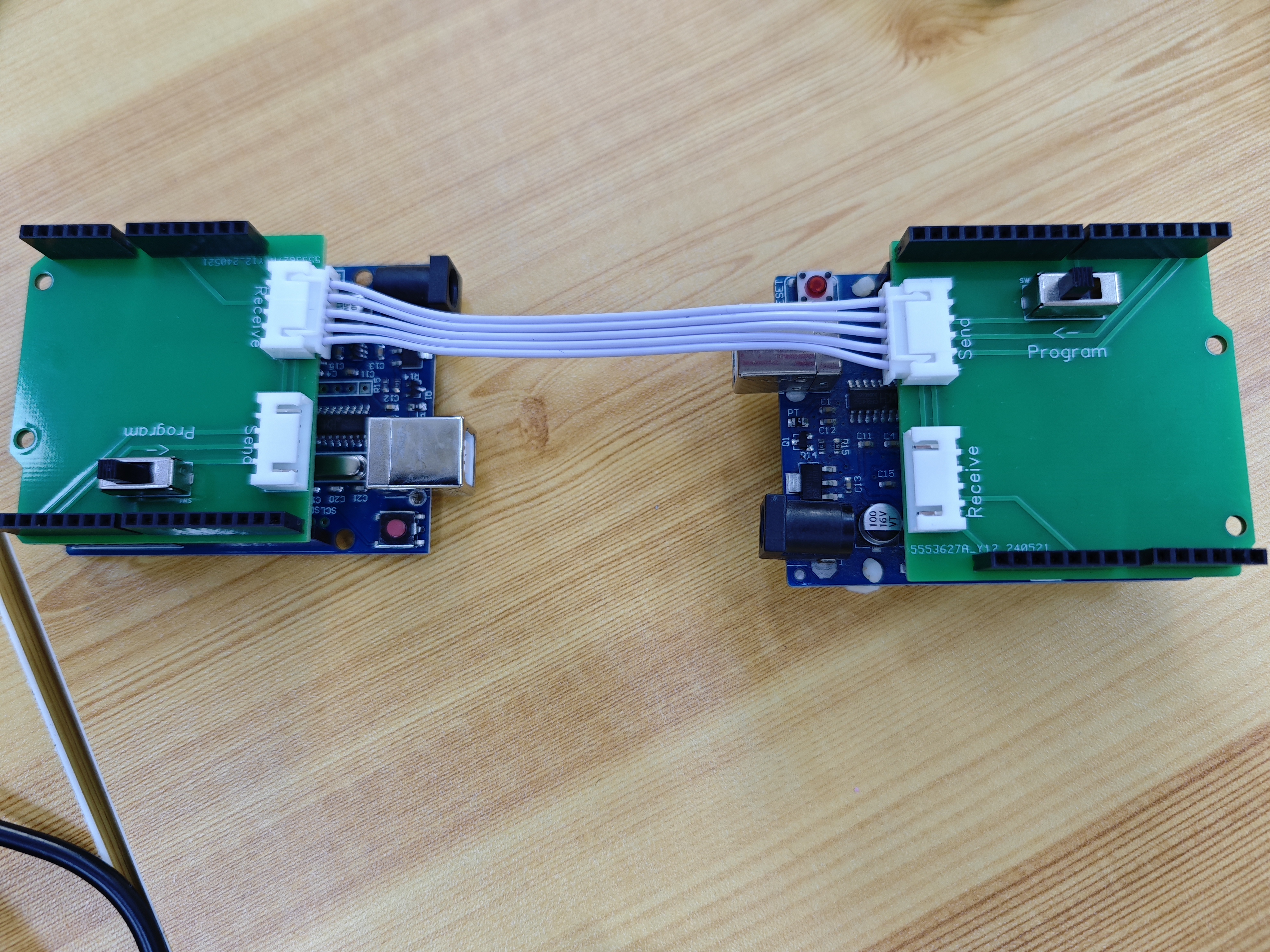

usage:
Connect the expansion boards to both Arduino UNO boards, then download the program copying signal to one of them (using it as a programmer). Connect the two boards with an XH2.54 5P cable with the same interface direction (connecting the programmer's send interface to the target board's receive interface). Turn on the programming switch on the programmer board as indicated by the arrow, and turn off the switch on the target board. Upon power-up, the program can be copied to the target board. The development board on the right in the diagram is used as the programmer, and the target board is on the left.

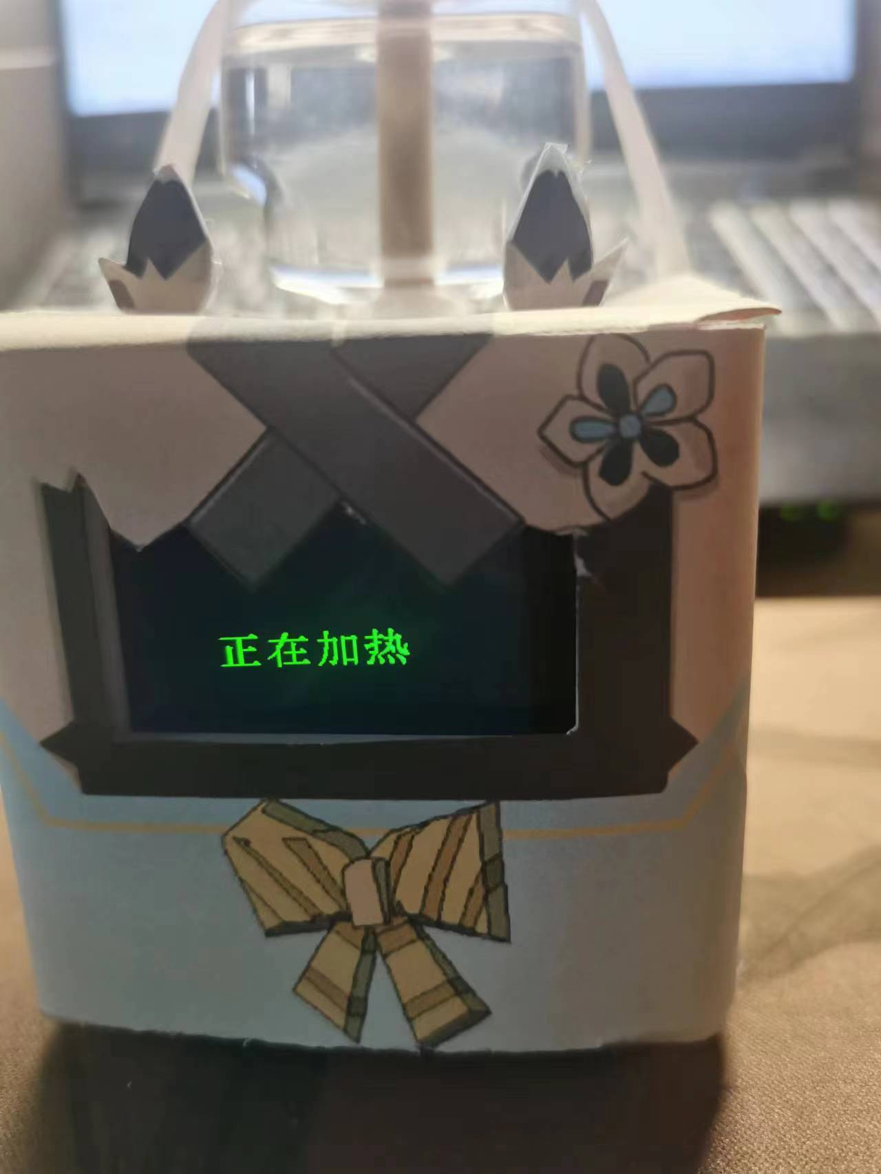

The electric mosquito repellent liquid is heated by RTP resistance heating, and the outer shell is designed as a cat box, displaying the cat's expression and heating status on a 2.0-inch LCD screen.
Summer brings a multitude of mosquitoes, making electric mosquito repellents indispensable. This design uses RTP resistors to heat the liquid mosquito repellent, and the casing is shaped like a cat's box. A 2.0-inch LCD screen displays the cat's expression and heating status.

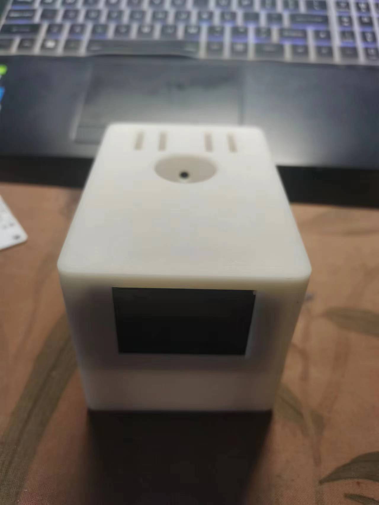

3D casing:
Care must be taken to consider the screen size and the placement of the mosquito repellent liquid.

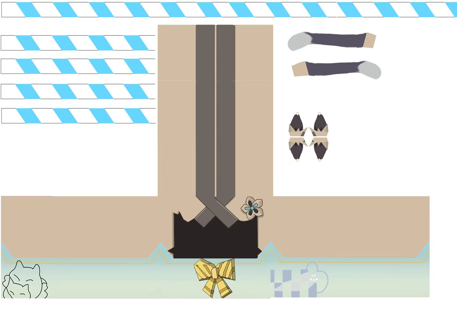

Decoration:
To enhance the heater's appearance, some decorations were added, inspired by Kira's cat box from Genshin Impact.

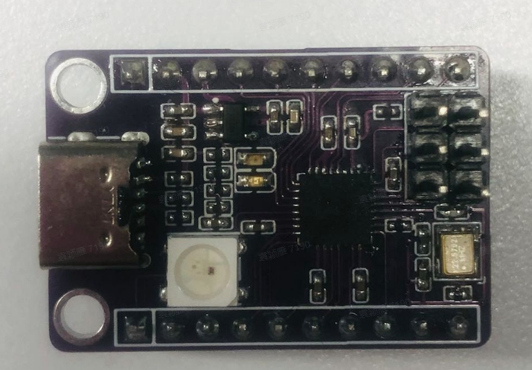

The GD32F230 minimum system verification is genuine. The original version, produced by the LCSC team, is a color version. Due to my limited capabilities, the verification version is in monochrome. The verification result is shown in the image—perfect!
This verification version replaced the 16-pin Type-C port with a micro connector based on the difficulty of soldering, changed the reset button from a two-pin to a four-pin one, and repositioned several other ribbon cables. Everything else follows the original routing from the LCSC team. Through several verifications of open-source files from teams and individuals, we found that the team's approach is generally more classic, and with minor adjustments, it can maintain board accuracy and has a higher fault tolerance. Some individual designs (including my previous ones, which are currently being checked and re-released one by one) have particularly poor logic, especially in terms of routing.
