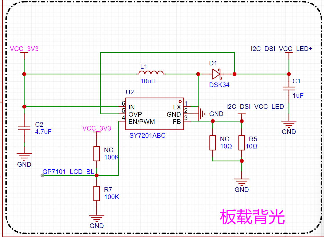

I highly recommend carefully checking the schematic diagram first to ensure it's correct!

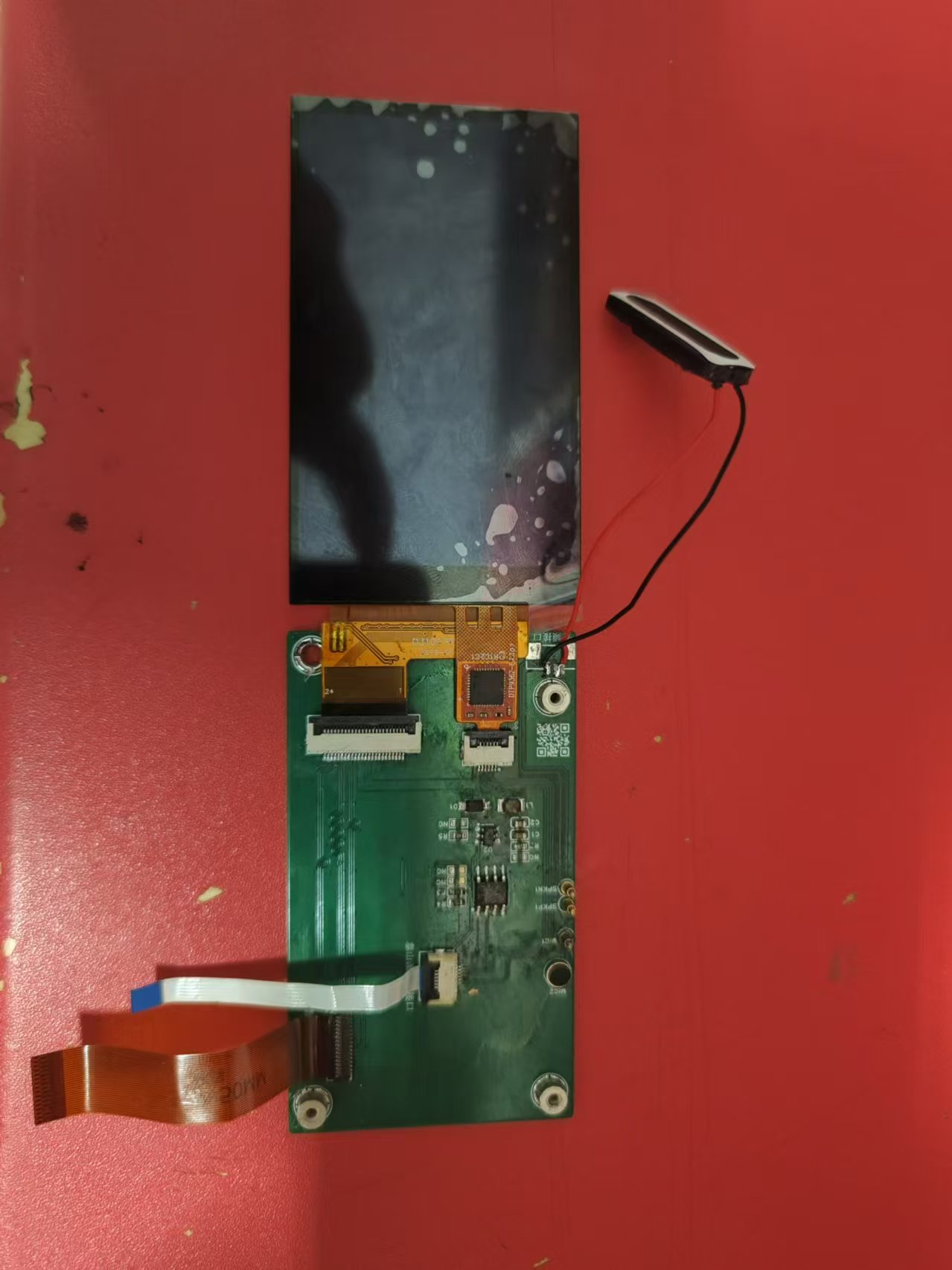

        Because after I finished setting it up, there was no display, not even a backlight. After troubleshooting almost everything, I finally checked the schematic and found that both of my backlight power supply selection circuits were set to MIPI_DSI_VCC_LED. This caused my screen to be directly powered by the high current from the LED. It should have burned out, so why wasn't it even lighting up? Was the screen originally broken? Obviously, this possibility is relatively small. So, I went back to checking the schematic diagram, and finally I discovered!!

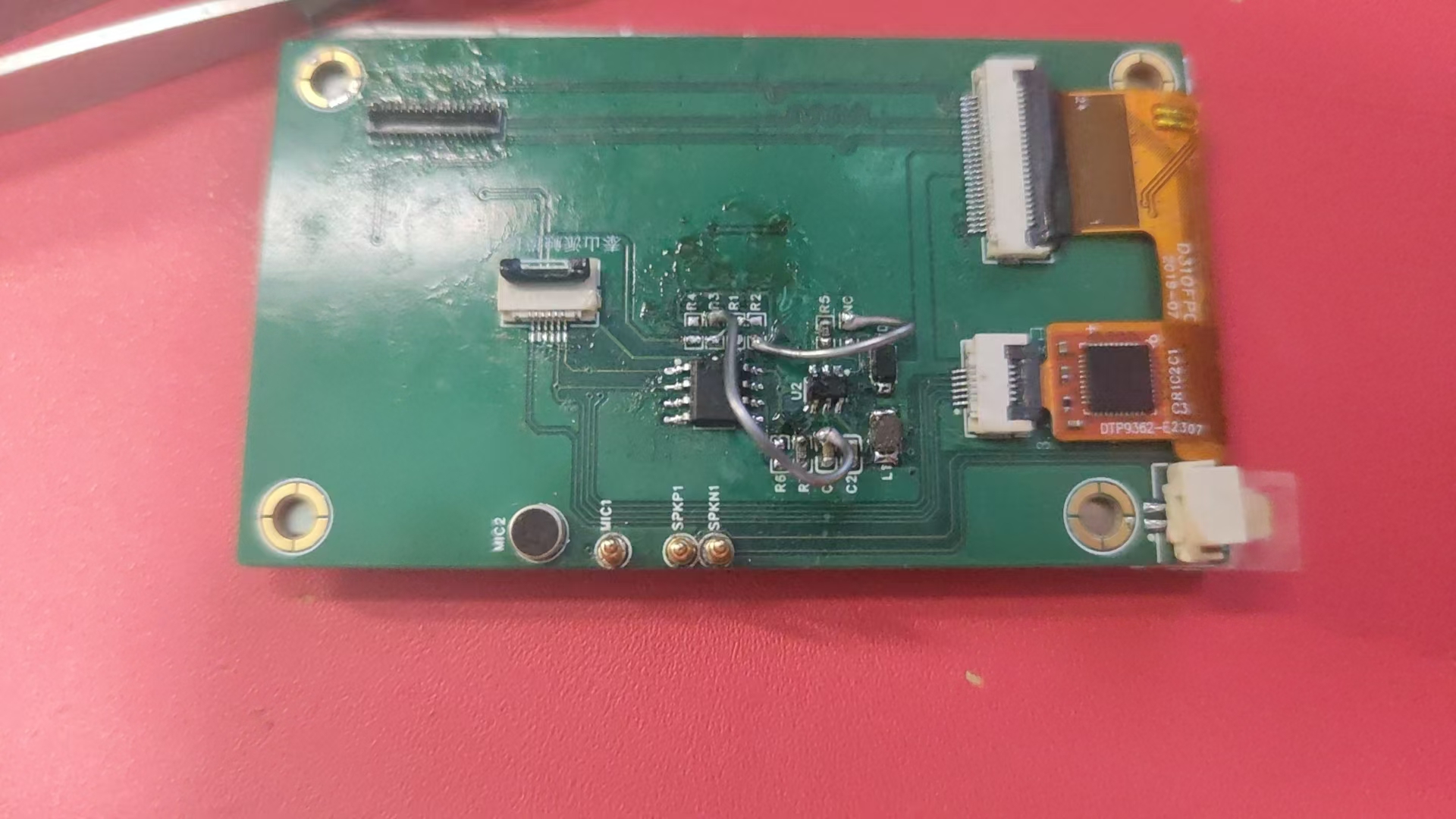

        One of the resistors here should be N/A (I remember there were also two N/A resistors on the backlight selection circuit). Pulling it down allowed the backlight to receive power properly. By doing this, I inadvertently protected my screen. The above issues rendered this PCB essentially unusable. I tried replacing the 0Ω resistor with a current-limiting resistor in the original backlight selection circuit and directly using a Taishanpai power supply. However, the backlight didn't light up. At this point, I was almost at a dead end; remaking the board was uncertain and would take a long time... So, I had to take a desperate gamble and use the flying wire method! The finished product is shown below:
    Finally, some suggestions: 1. After soldering the adapter board, it's recommended to flash the official firmware to test for problems. If problems occur this way, it's 95% certain the issue is hardware-related. However, if possible, check for short circuits between VCC and GND first. If this is fine, even if there are cold solder joints elsewhere, it's not a major problem.
    2. If there's backlight but no image, it's basically a problem with the MIPI connector, usually caused by a cold solder joint. Don't blindly trust your soldering skills. Sometimes it's not necessarily a cold solder joint. If you're using a hot air gun, you might have melted the inside of the connector, preventing the FPC cable from connecting properly. So, if you can't do that, use a hot plate to heat it.

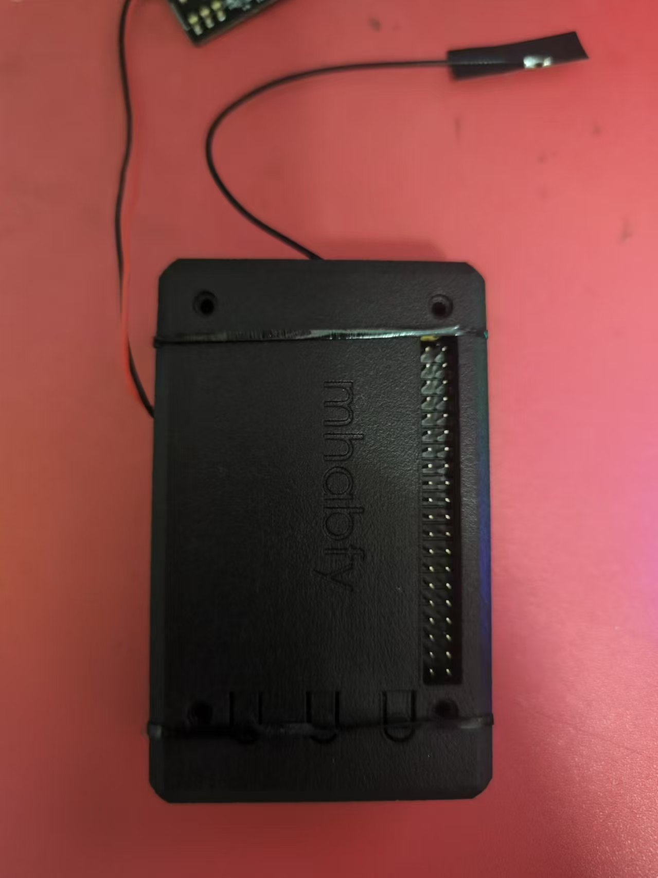

    4. For the 3D printed casing, I recommend using 20% ​​nylon material, as it's more heat-resistant. In my actual use, it got quite hot when browsing Bilibili. Although the official specifications state a maximum temperature of around 79 degrees Celsius, it might get even higher if your casing doesn't dissipate heat well.

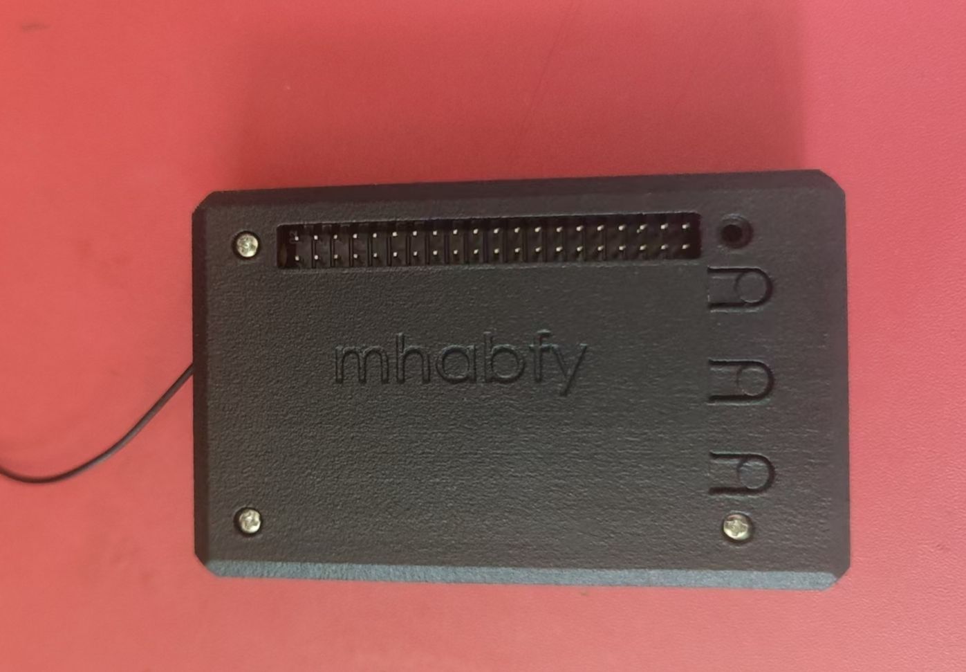

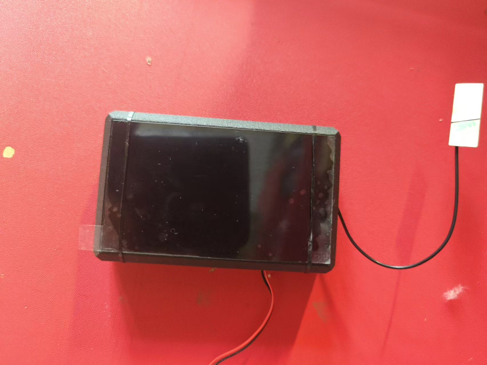

     Finished product as follows:
Functionality demonstration: Taishanpai Mini Phone_Bilibili_bilibili
