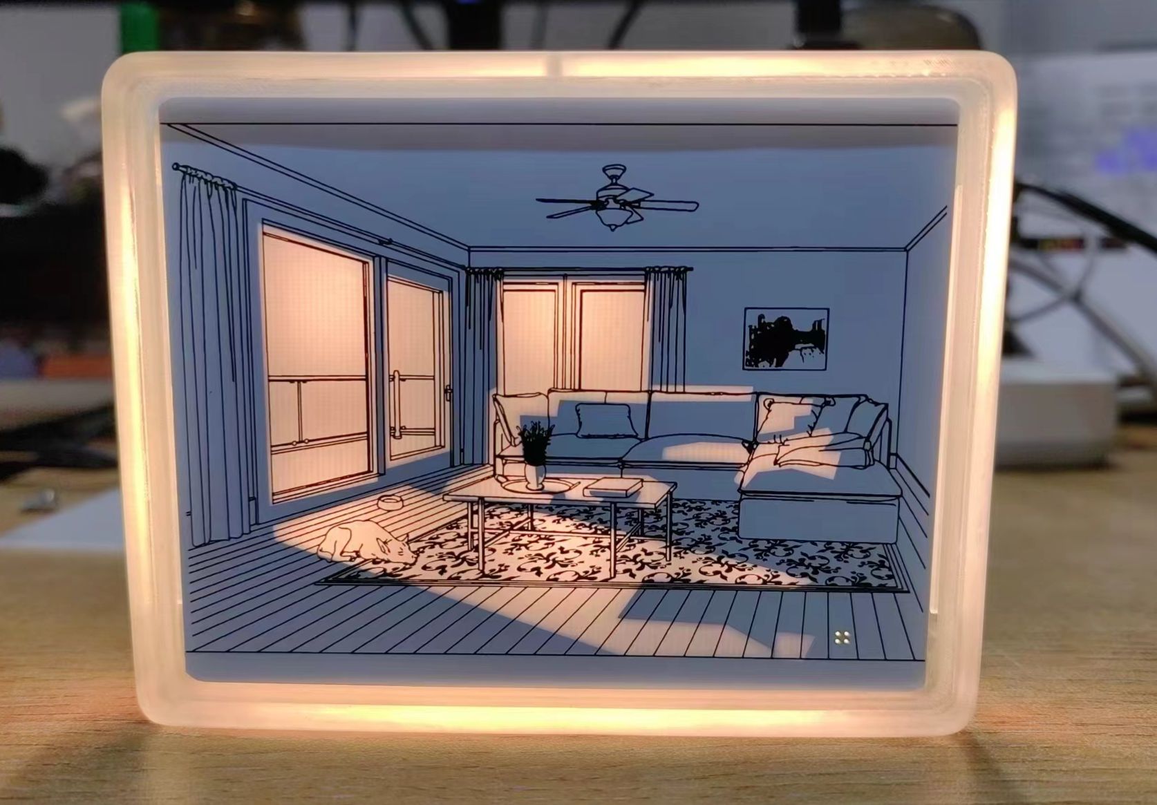

Thanks to the open source project author for providing the model. The following improvements have been made to this version:
1. Corrected the PCB orientation error of the TP4056 charging indicator light in the original project (the silkscreen of the red LED indicator light on the original PCB was reversed).
2. Added a sampling capacitor pad position for easier touch sensitivity tuning.
3. Changed the current-limiting resistor value of the LED, so the total current will be less than 600mA (the limit of the BOOST boost chip).
4. Reset the resistance value of R25 so that the charging current can reach 400mA.

Casing Description:
Because I increased the current-limiting resistor for the LED, the brightness decreased slightly. Adding a diffuser didn't seem to work well, so I just shoved the PCB in. Don't ask how I did it; just use brute force!
Then I glued the battery to the back.
The casing is a bit thick, but once the switch is on, it basically doesn't need to be turned off. It's 4000mA, what more could you ask for ?

Order the casing; you can choose between LEDO6060 or 8001 (I chose the 8001 semi-transparent one on the right; it's a bit sharp on the hand, but sandpaper is included so you can sand it yourself).
Finished Product Showcase (White, Warm, Warm White)
