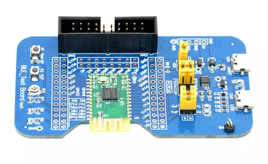

Hardware resources:
This solution is tested and verified based on the MM32 BLE_Test Board . The Bluetooth selfie stick application only requires one function button on the hardware. The Bluetooth part uses the smallest system controlled by Bluetooth. We connect this button to the PA0 pin of the MCU , which can be used as The wake-up pin is used, and it can also be used as a self-timer function pin.
Figure Test development board

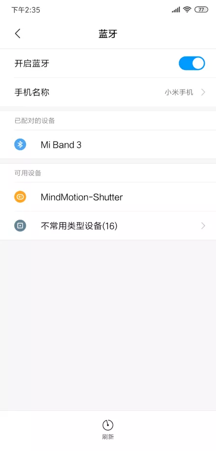

We directly use the Bluetooth function that comes with the mobile phone for testing. The operation process is as follows:
1.      Turn on the Bluetooth of your phone and enter the Bluetooth control interface, search for the selfie stick Bluetooth device.
2.      Select the Bluetooth device with the corresponding name ( MindMotion-Shutter ) and pair it.
3. After successful pairing, open the camera interface of the mobile phone. At this time, click button K1 to take pictures.
Figure Mobile phone interface
