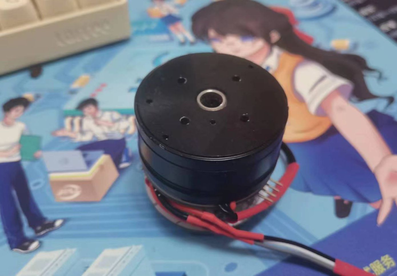

Arduino-based 4008/4010 motor FOC driver
Three-phase interface:
         PD3->A phase
         PD5->B phase
         PD6->C phase
EN pin:
         PD4
I2C:
        PC5->SCL
        PC4->SDA
INA199:
        PC1->A phase current
        PC2->B phase current
        PC3->C phase current
DIP switch:
        PB1->SET1
        PB2->SET2
CAN transceiver interface:
        PD7->TX_CAN
        PB0->RX_CAN
//CAN chip & AS5600 not yet verified
参考设计图片
