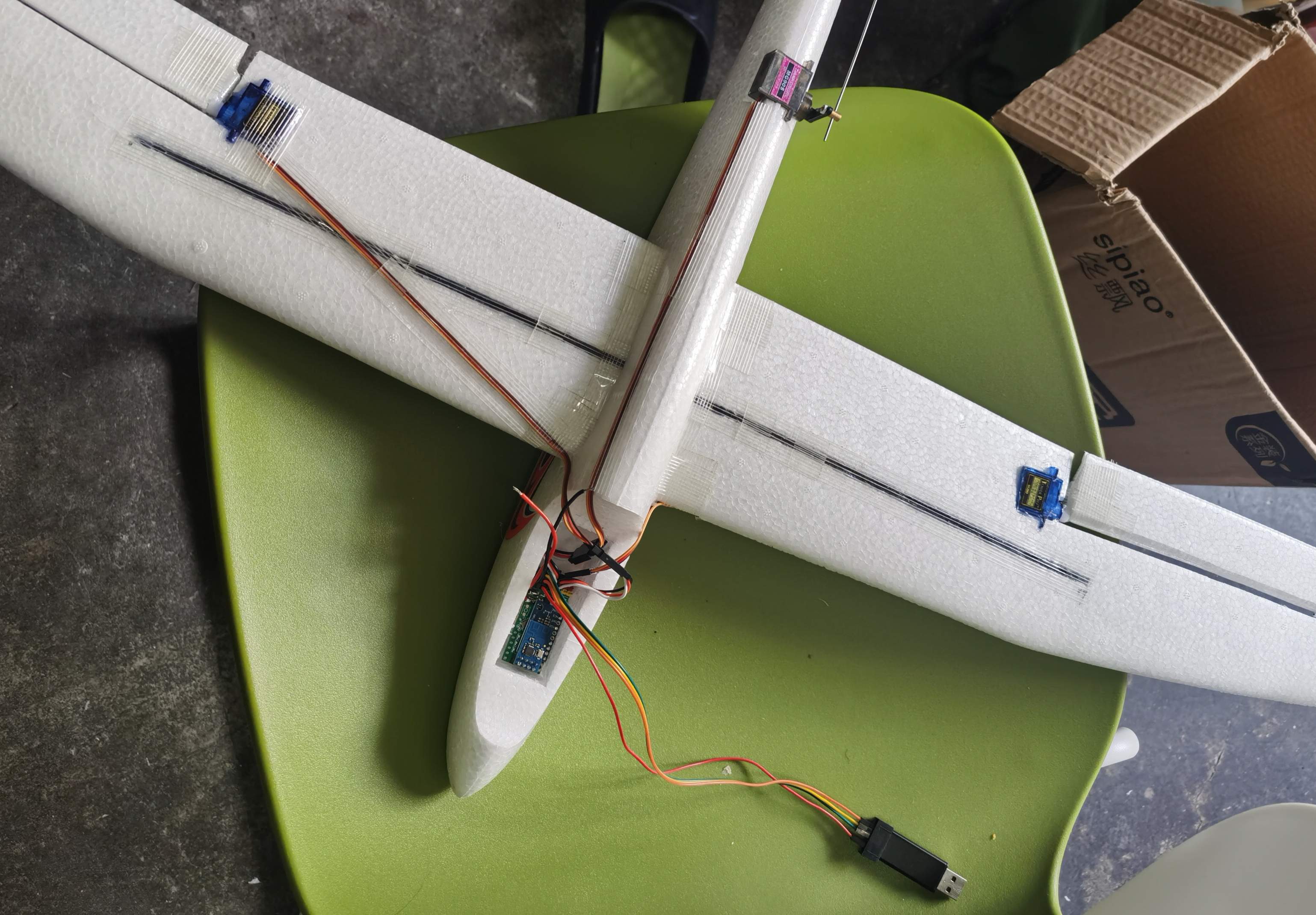

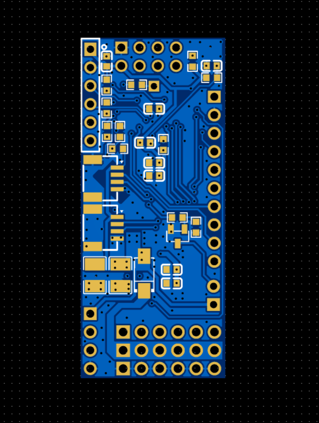

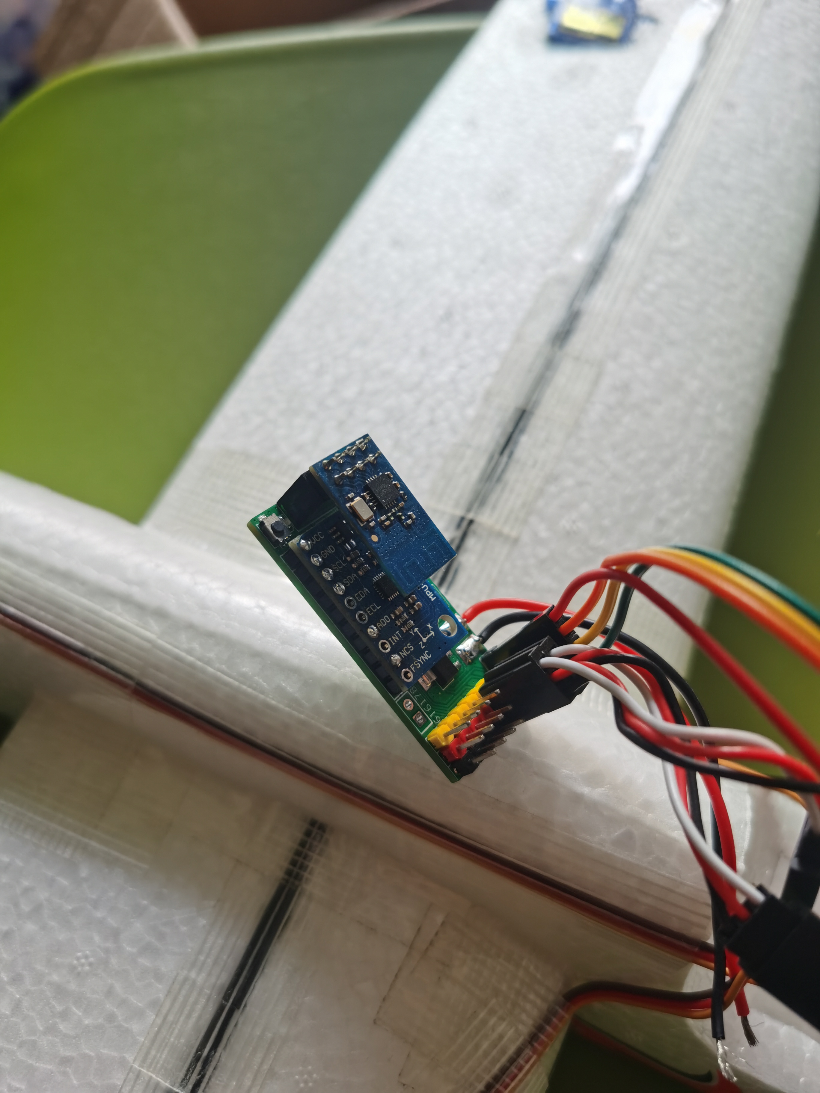

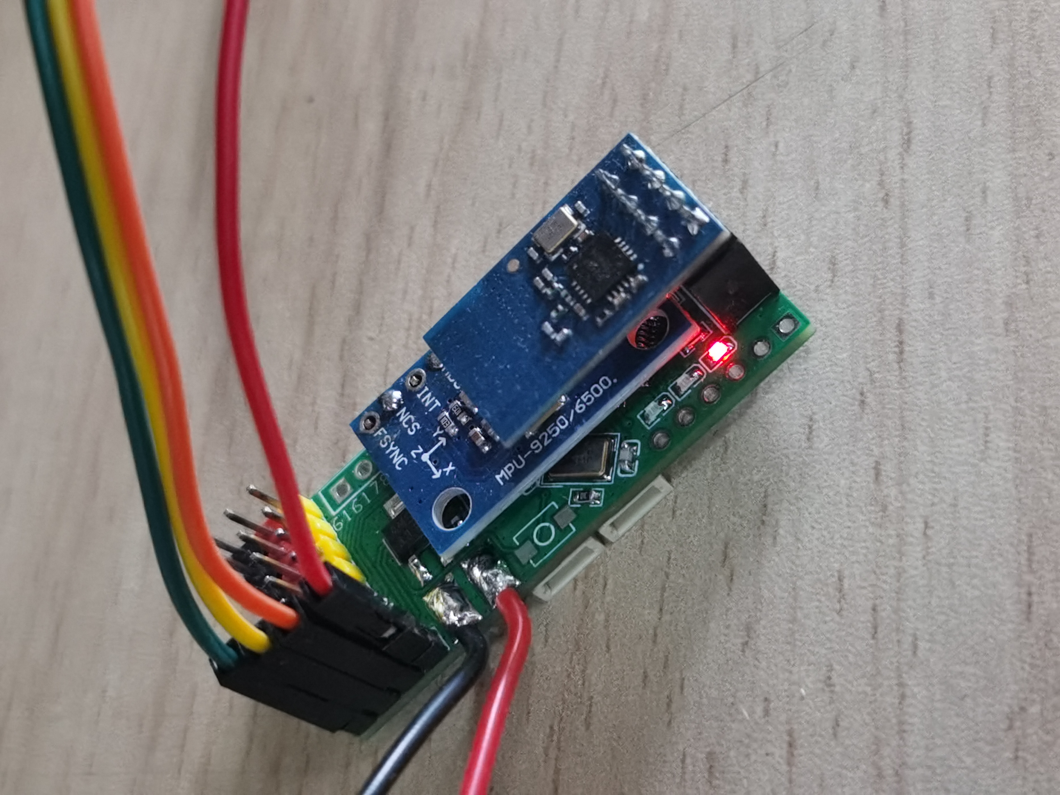

The N32G430C8L7 is used as the main control board, with an onboard SI24R1 wireless module, MPU6500 as the IMU, and BMP280 as the barometer. It includes some user-defined LEDs and a customizable button for various functions. A
5V power supply is used for input/
output, and 6-channel PWM can drive 6 servos.
Basic remote control and PID self-stabilization functions can be implemented through programming.
Equipped with a G01-DP5 module, it can achieve remote control up to 2000 meters.
This project primarily uses pre-made modules for easier soldering
, and their small size and light weight make them suitable for use as flight controllers for modified hand-launched aircraft.
