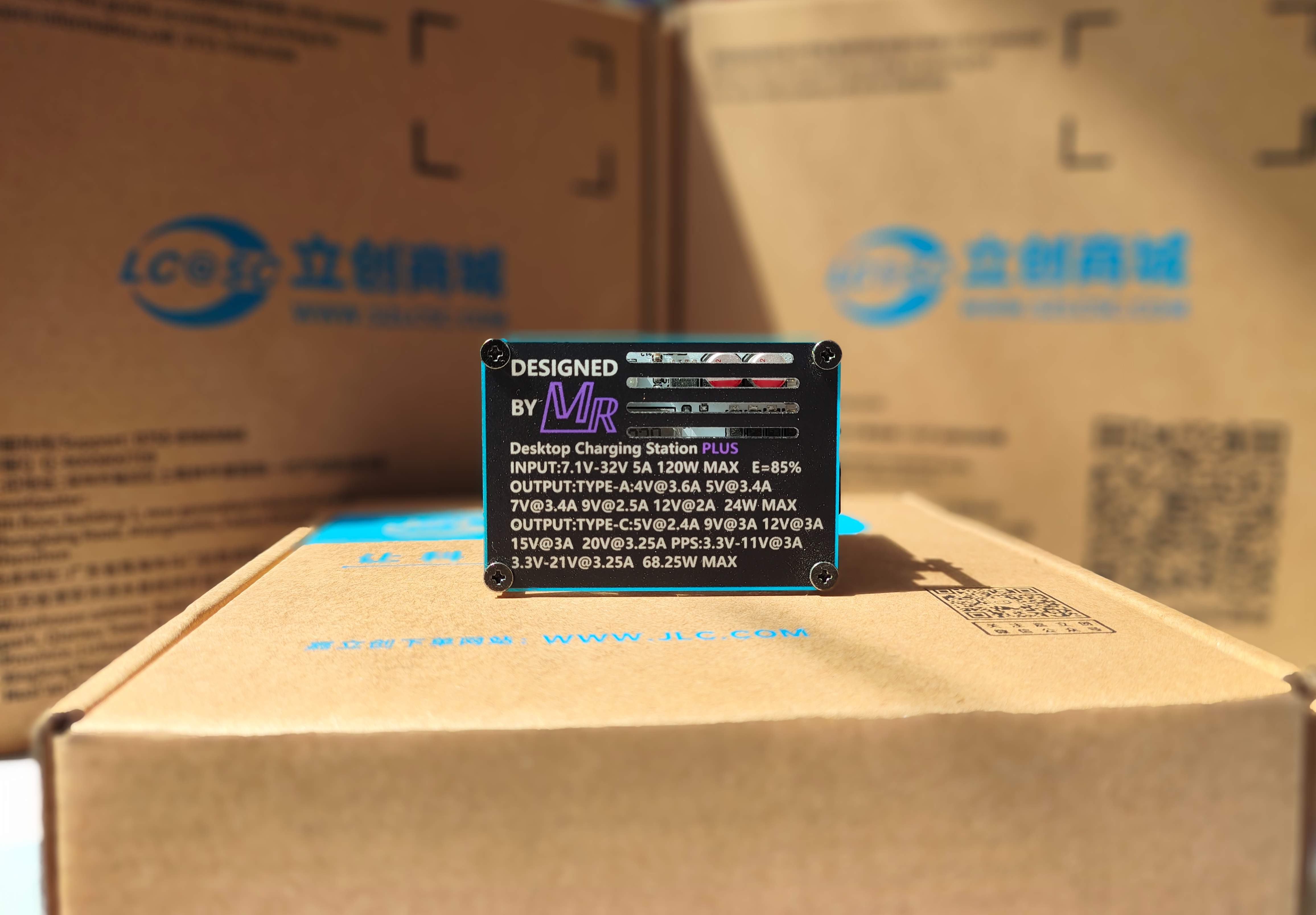

New 1C1A desktop charger based on IP6520 and IP6505 standards
This project is an upgrade of the old desktop charger!

For this project
, PCB1 should be made of FR-4 material, and PCB2 (empty board) should be made of aluminum substrate. A frosted acrylic panel is recommended.
Required components include 4 M2 screws (5mm long), 4 M2 double-ended knurled screw posts (11mm long), 8 M2 single-ended knurled screw posts (3mm thread, 3mm body), and one 3.5mm thick thermal pad.
Installation instructions are omitted here.
For the IP6520 model, the IP6520-C-65W20V option is available (this model supports 20V; pay attention to capacitor voltage rating).
This project is an upgrade of the old desktop charger.
