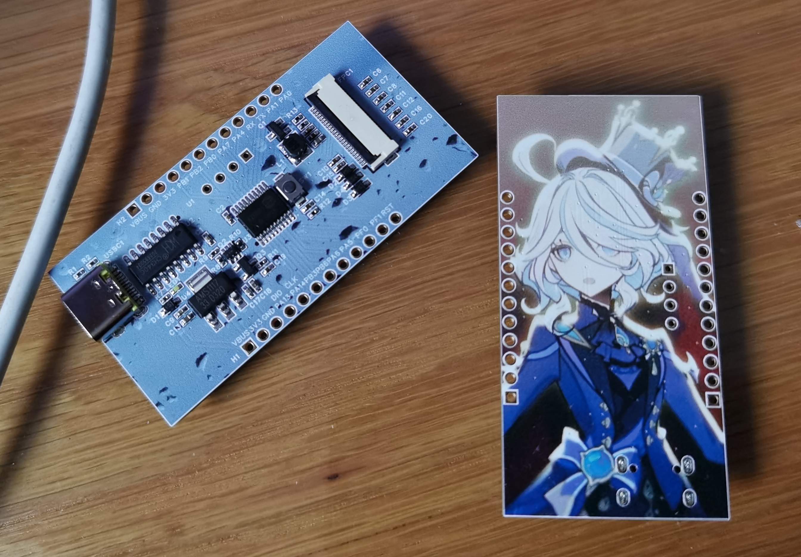

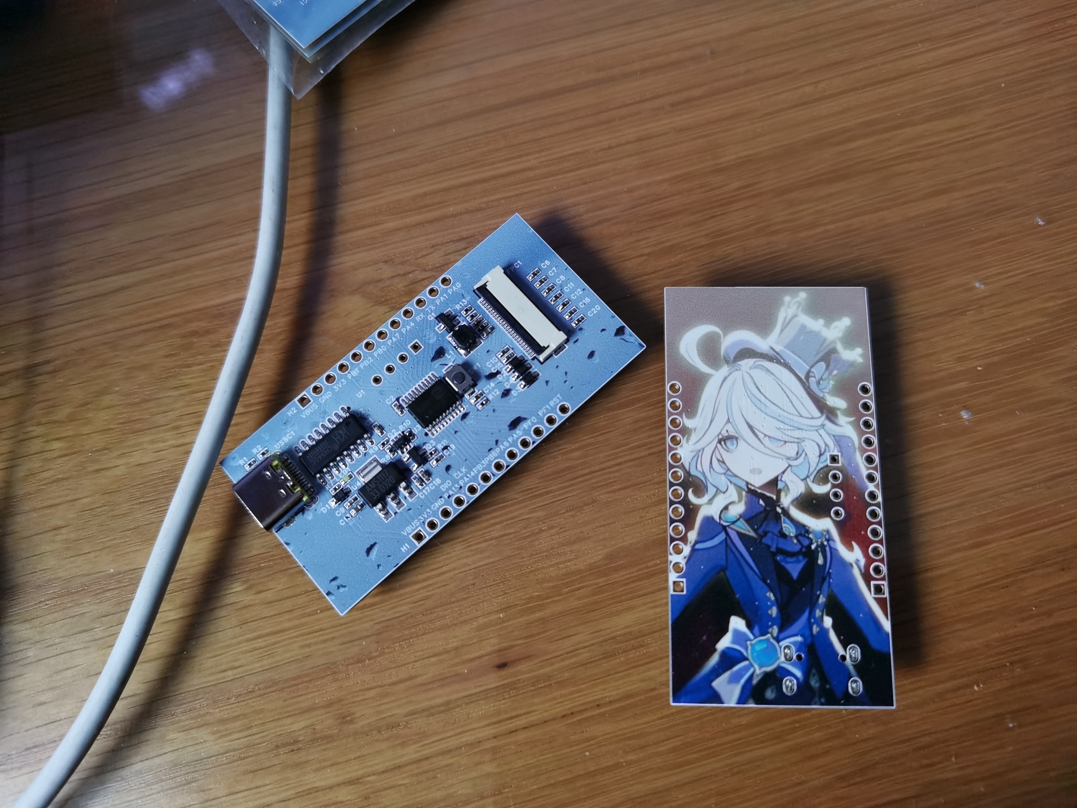

Universal e-ink screen driver board based on AIR001
The worn-out price tag screen, along with the ten AIR001s I bought before, actually look quite nice with the case on.
