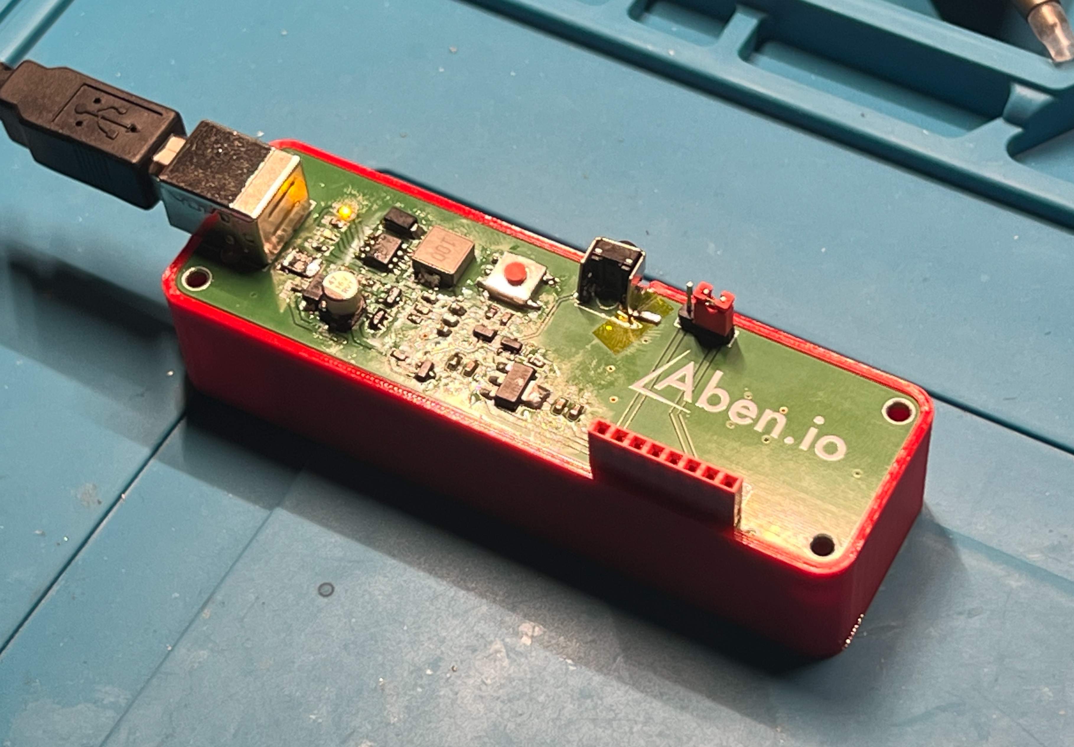

TP5400 Lithium Battery Charging/Discharging + MCU One-Button Power On/Off Module
Function Introduction:
The TP5400 lithium battery charging and discharging module can charge 18650 batteries to a full charge at 4.2V.
Battery power is cut off when USB is plugged in; switching to USB power allows charging to continue.
Battery over-discharge protection cuts off power when the battery voltage is too low, triggering the TP5400 low-voltage protection.
MCU one-button power on/off function. Jumper mode switching: Normally open mode: Pressing the power button starts the circuit; flashing the MCU will not restart it, only the Reset button can shut it down. Power on/off mode: After startup, a high-level output from the MCU control pin can shut down the circuit.
Physical Reset button can force the circuit to shut down, preventing MCU crashes.
MCU sample code (ESP32 S3):
#define OFFP_IN 47
#define BUILDINLED_PIN 48
#define ACTION_PIN 13
void setup() {
pinMode(ACTION_PIN, INPUT);
pinMode(OFFP_IN, OUTPUT);
pinMode(BUILDINLED_PIN, OUTPUT);
digitalWrite(OFFP_IN, HIGH);
digitalWrite(BUILDINLED_PIN, HIGH);
void loop() {
static unsigned long timer = millis();
if (digitalRead(ACTION_PIN) == LOW) {
if (millis() - timer >= 4000)
digitalWrite(OFFP_IN, LOW);
} else {
digitalWrite(BUILDINLED_PIN, LOW);
} else {
timer = millis();
