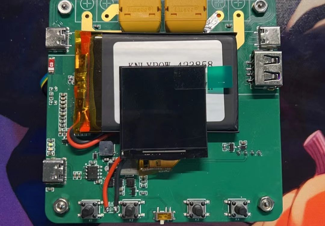

ESP32 Multifunctional Electronic Load
The layout of the buttons and power interface has been optimized, and the 4-pin header power interface has been removed for easier wiring.
It can use the entire ESP32S3 series of chips; some require external flash, therefore the GPIO33-37 pins need code modification. See the circuit diagram for details.
The heatsink hole spacing has been adjusted to 75*75.
0402 surface mount components have been changed to 0603 for easier surface mount. The cover
plate hasn't been drawn yet; the PCB from the expert is included.
Note that it's currently a 6-layer board design; prototyping with a 4-layer board will require modification.
