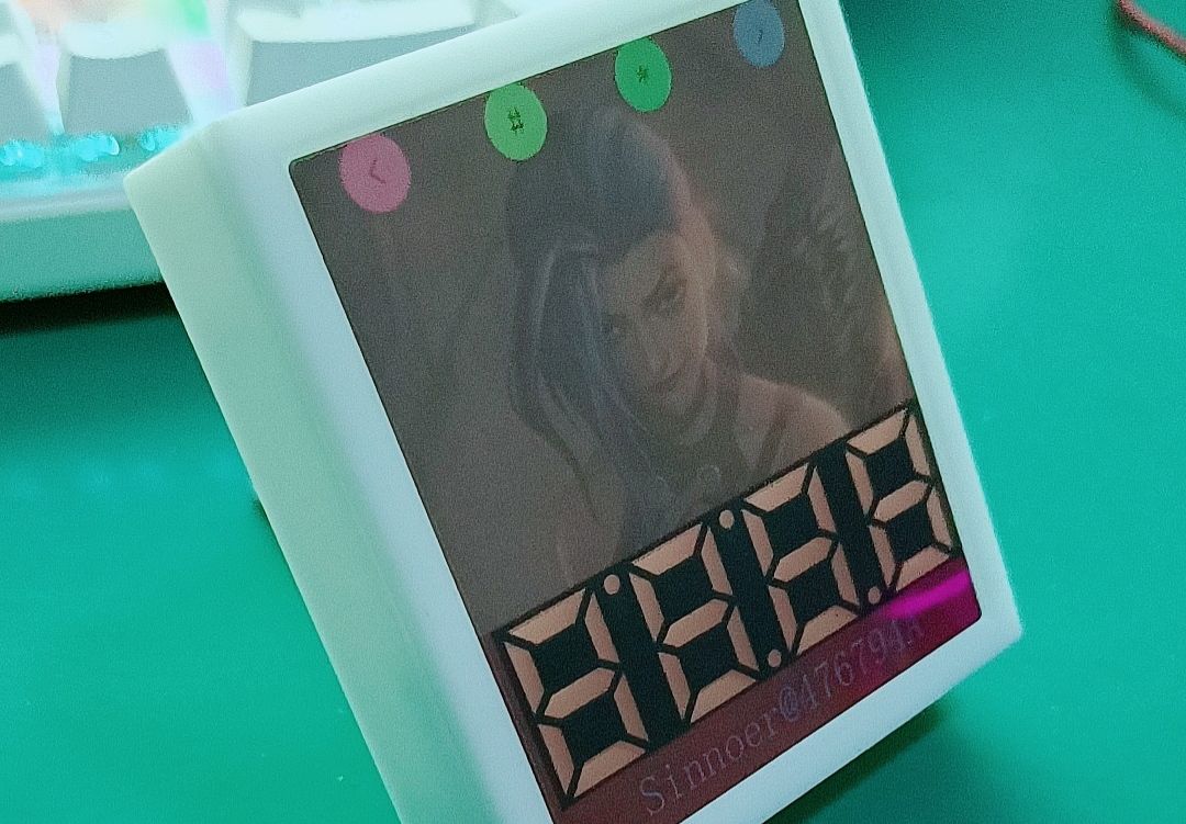

In the new year, Lichuang has started holding activities again, based on the development and design of Renesas RA-MCU.
The effect is shown in the picture, including USB power supply, serial port download, J-LINK debugging interface, touch button, touch button and LED driver.
The MCU used this time is R7FA2E1A72DFL.
After reading the chip manual, I found that it comes with RTC function, so I simply made a 4-digit time alarm clock.
Figure 1: Overall renderings

  a) The light shielding of the surface sticker is not ideal, and the printing shell is severely light-transmitted.
I hope that friends will pay more attention to these problems when they want to try it. At the same time, you are also welcome to discuss solutions with me.
