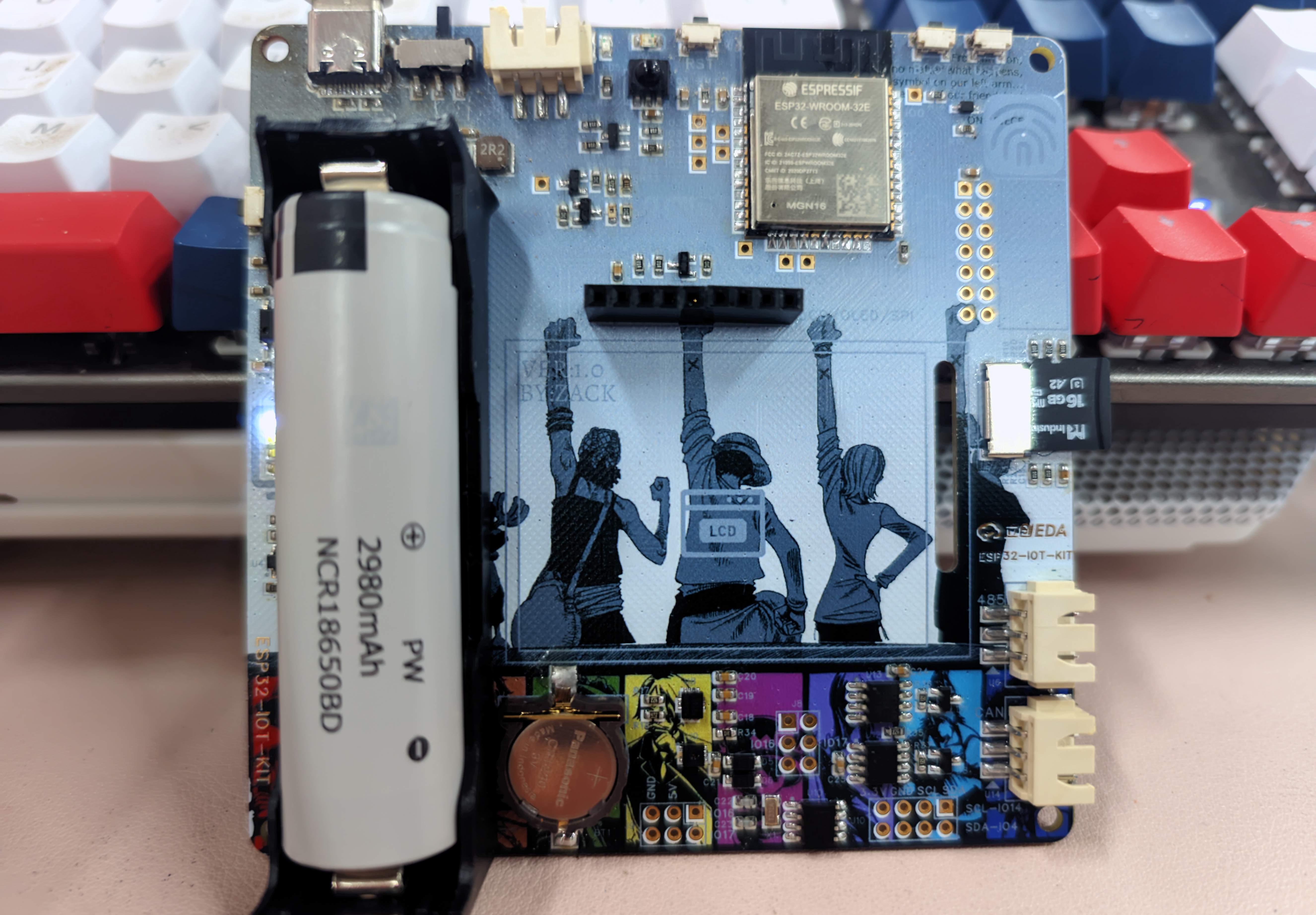

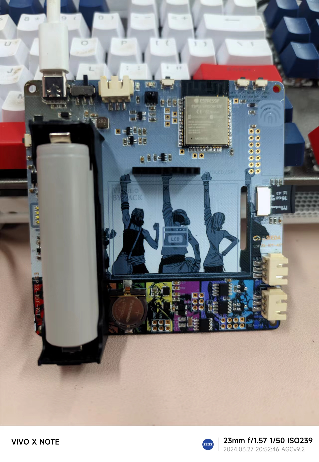

To Youth – Dream Drawing ESP32 Learning Board

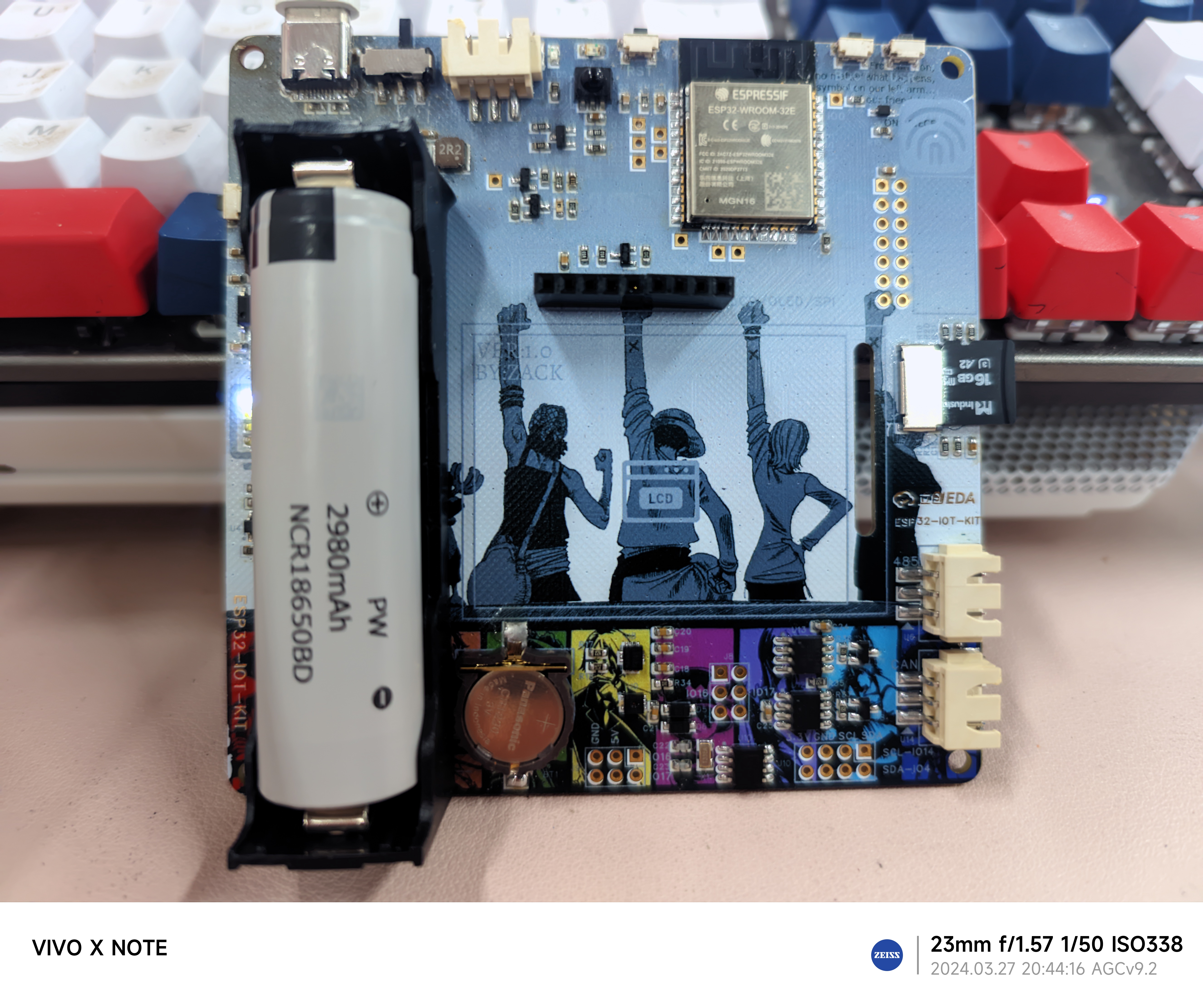

This "To Youth – Dream-Building ESP32 Learning Board"
is a replica of @mazhiliang's "ESP32-IOT-KIT Fully Open Source IoT Development Learning Board" project (project verification completed). The development board uses the ESP32-WROOM-E module as the main controller and supports communication methods such as WIFI, Bluetooth, Ethernet, RS485, and CAN. I personally plan to learn IoT development using MicroPython on the Thonny IDE. This differs slightly from the original developer's open-source learning plan.
Since I am still in the learning stage, I strongly recommend that those who want to systematically learn and replicate this project refer to the original developer's open-source project. The original developer provides a supporting Easyio driver library and CSDN blog tutorials, guiding everyone from ESP-IDF to IoT learning and development. The hardware and software introductions and guidance are very comprehensive and detailed. Original developer's open-source link: ESP32-IOT-KIT Fully Open Source IoT Development Learning Board.
The detailed introduction below is mainly taken from the original developer's article, with modifications and innovations noted.
The hardware peripherals have been upgraded.

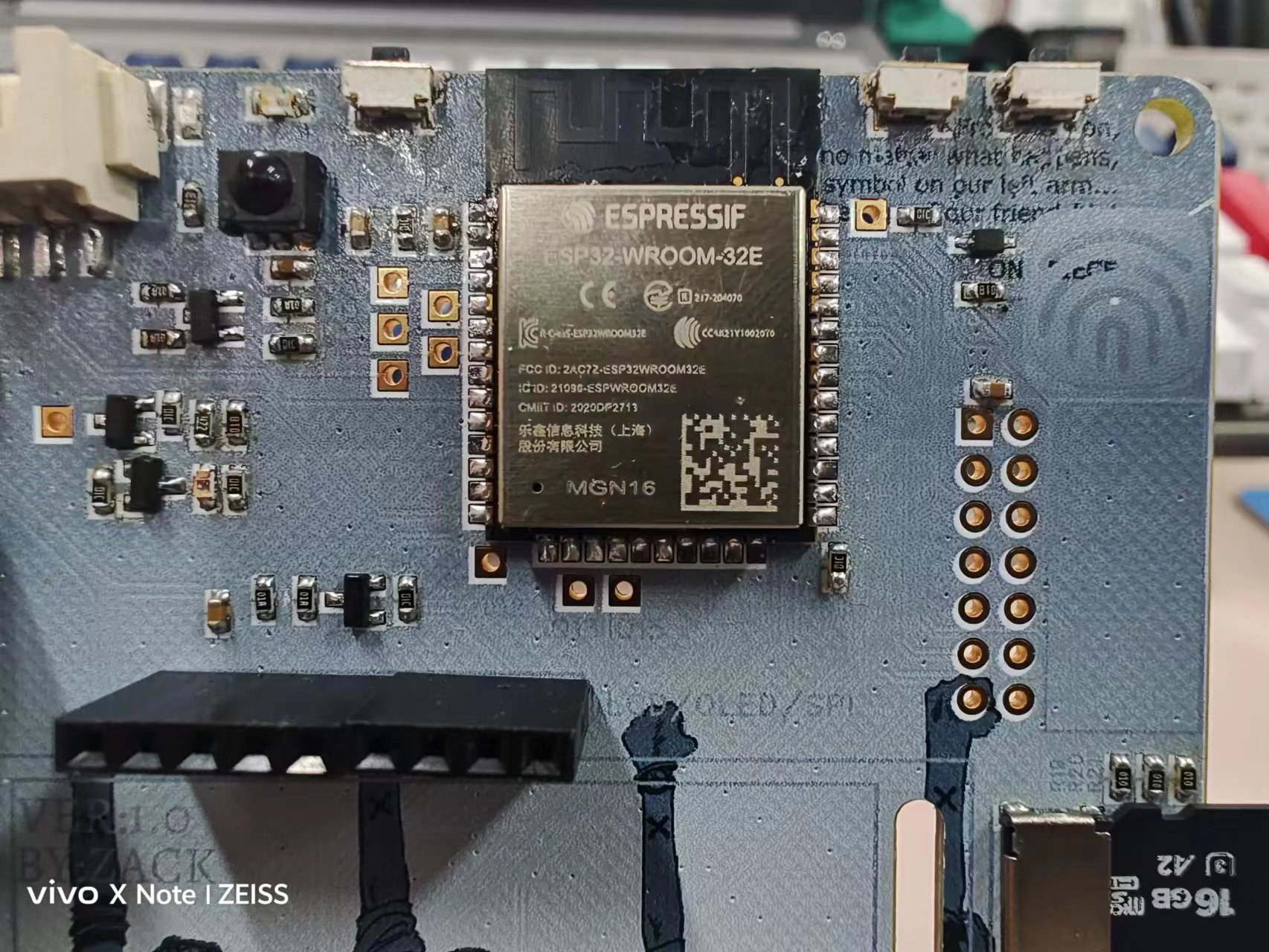

The ESP32 module has been changed from WORWER-E to WROOM-32E, removing PSRAM and adding two IOs:
ADC * 2 (battery, light; power is programmable),
4 buttons (BOOT, user buttons, and two more for reset and battery level indication)
, 1 touch button, and
1 user LED (same as the IO expansion WS2812B LED strip)
. It also includes 38kHz infrared receiver and transmitter,
RS485, and CAN (multiplexed with the IO, can also be multiplexed for UART, etc.). The circuitry has been upgraded, with the 2-pin terminal becoming a 3-pin terminal and the addition of GND. ESD protection has been added. The RS485 chip MAX3485 has been replaced with MAX13487.
4 I2C peripherals (ICM-20600 six-axis inertial measurement unit, SHT30 temperature and humidity sensor, PCF8563 - RTC, and a capacitive touchscreen FPC socket on the back)
2.0-inch single-point capacitive touchscreen (320*240 resolution. LCD screen uses SPI and capacitive touch I2C)
LCD/OLED/SPI expansion interface. I2C expansion interface. 3.3/5V power expansion interface.
TF card interface. (MicroSD)
Ethernet expansion interface. (Can connect to LAN8720 Ethernet module)
Type-C power, download, and debug interface.
Onboard CH343P automatic download circuit. Upgraded from the original CH340 USB to TTL circuit, smaller, faster, and more stable.
Onboard 18650 battery holder, lithium battery protection IC, and charge/discharge power management chip, providing 2A power output of 3.3V and 5V using only the onboard battery. The 3.3V voltage rail is a UPS, ensuring uninterrupted operation of the onboard hardware.
Hardware Features:
The board features an onboard ESP32-WROOM-32E dual-core 240MHz microcontroller, enabling development and application of Wi-Fi, Bluetooth, and Ethernet.
All onboard ESP32 I/O pins are exposed for easy debugging and expansion.
The PCB measures only 9.8 * 9.8cm, compact yet fully functional.
It supports expandable LAN8720 100Mbps Ethernet, conveniently located in the upper right corner header for wired Ethernet expansion. The
2.0-inch capacitive touchscreen is a combination of ST7789V and FT6236U, featuring IPS full-viewing angle and single-point capacitive touch, offering significantly better feel and lifespan than resistive touchscreens.
For those on a budget who prefer not to use a capacitive touchscreen, a row of SPI expansion interfaces is provided on the front for connecting LCD/OLED displays, compatible with many display modules available online.
An onboard 18650 battery holder provides lithium battery protection and charge/discharge management. When the power switch is on, the 3.3V supply is uninterrupted, preventing the ESP32 from restarting due to USB plugging or unplugging.
It features a Type-C interface for charging and downloading/debugging, with an onboard CH343 fully automatic download circuit. Connecting to a computer only requires a Type-C cable; no additional downloader is needed.
It integrates a six-axis IMU accelerometer/gyroscope (ICM-20600), an SHT30 temperature and humidity sensor, a PCF8563 independent RTC, infrared transceiver, and a light sensor, enabling comprehensive smart home solutions.
Currently, serial port connections are verified to be normal, and program downloading and burning are quite stable. Simple I/O port control applications function normally.
Power circuits such as lithium battery charging and automatic battery-to-power switching have also been tested and found to be stable.

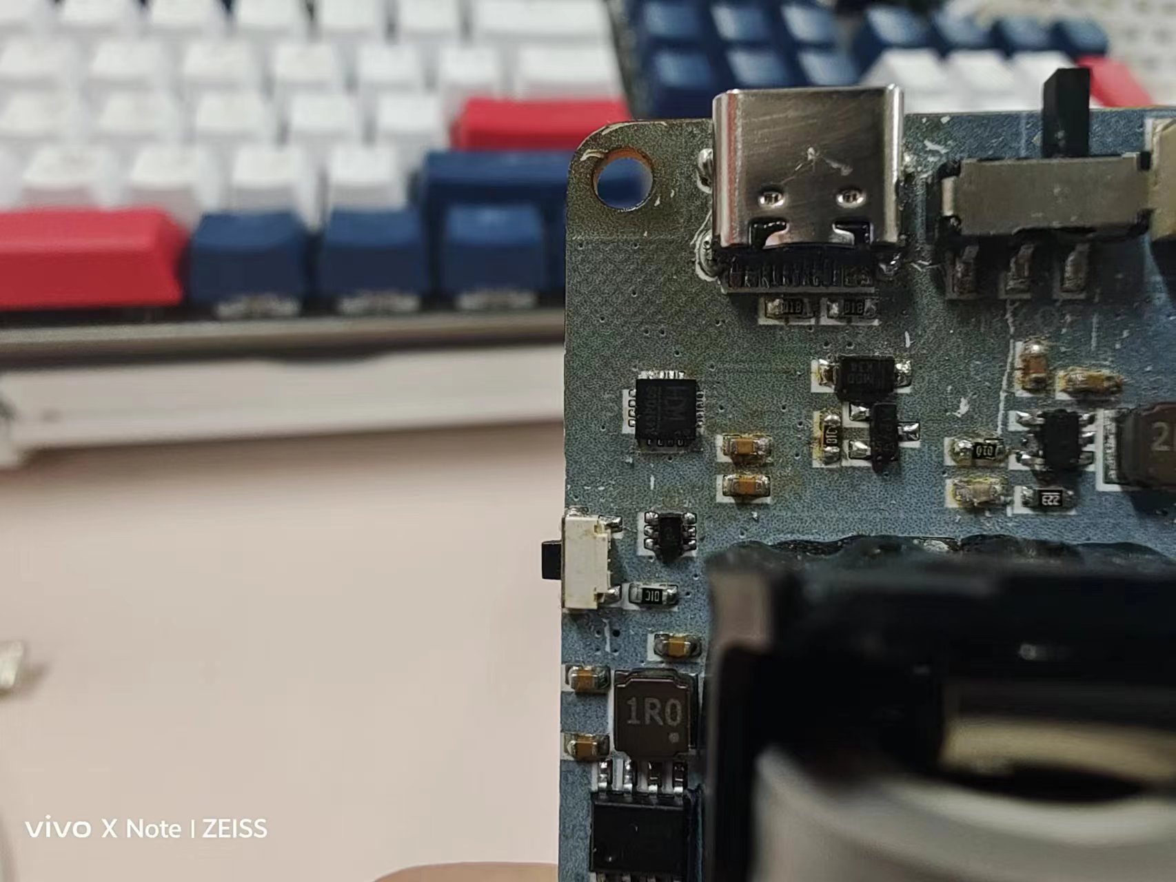

Figure 3 Forgotten capacitor
The power switching section is implemented using two PMOS and two NMOS. The LED lights up on whichever side has power. It is recommended to use LEDs of different colors for differentiation.

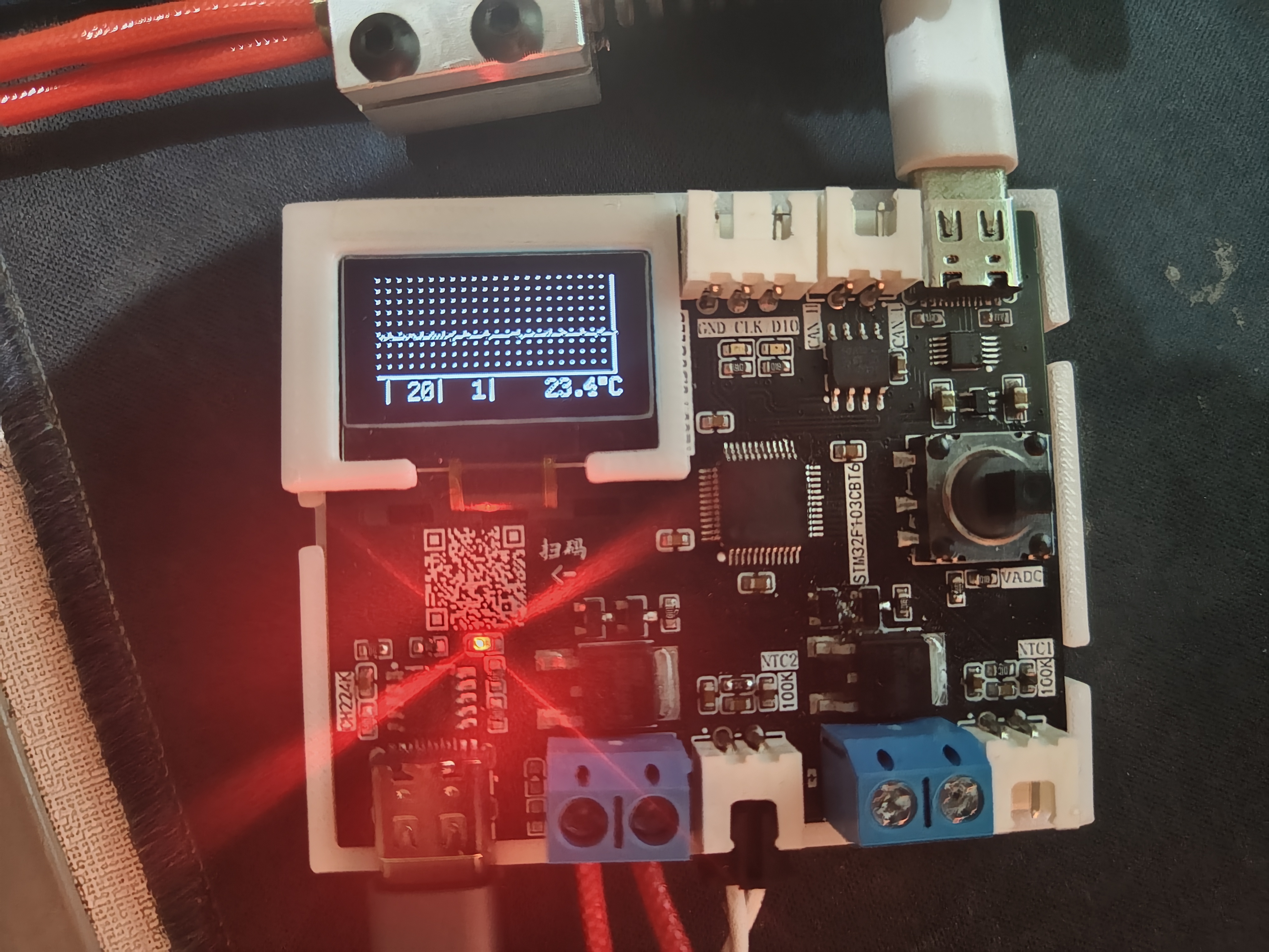

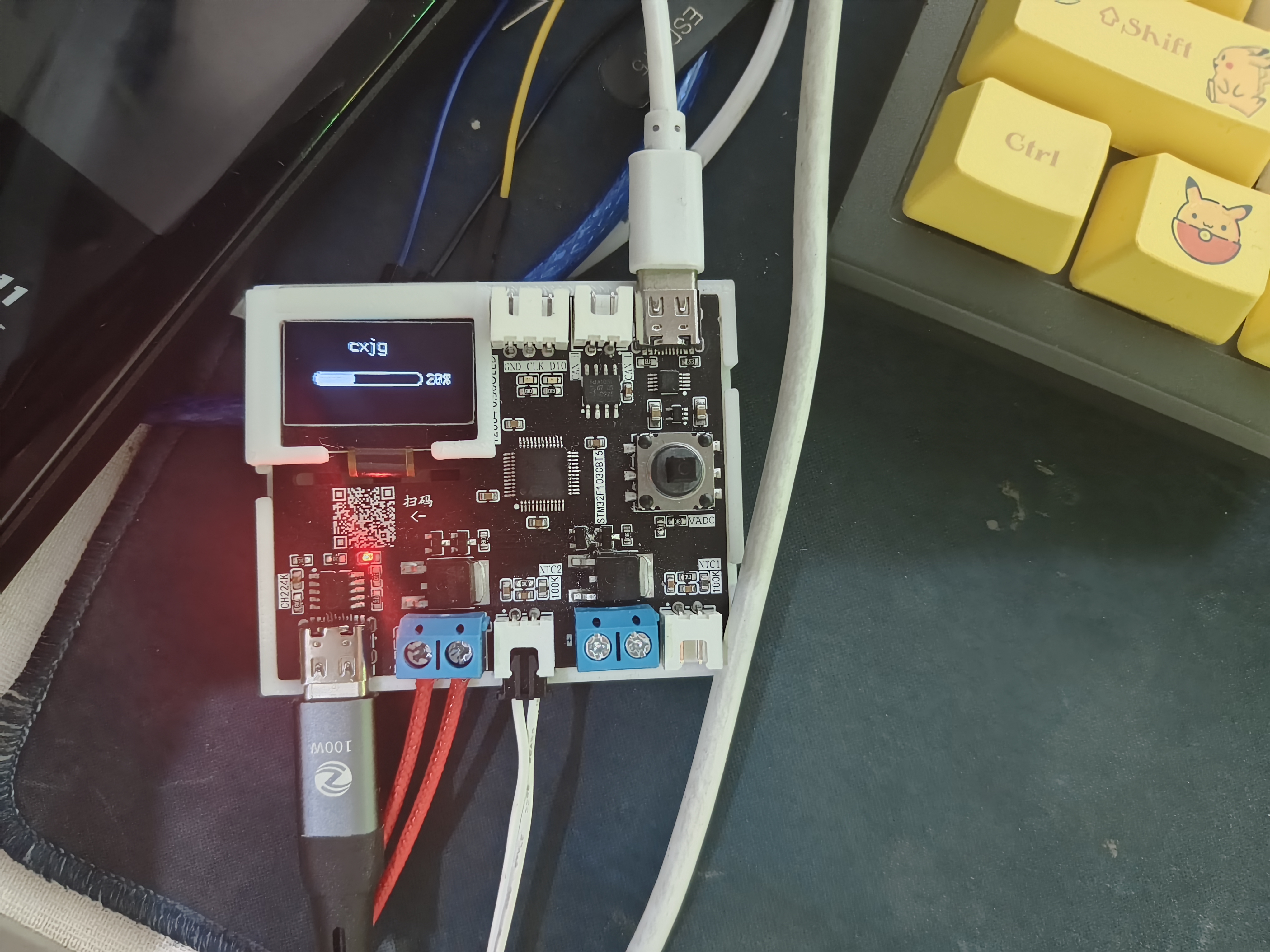

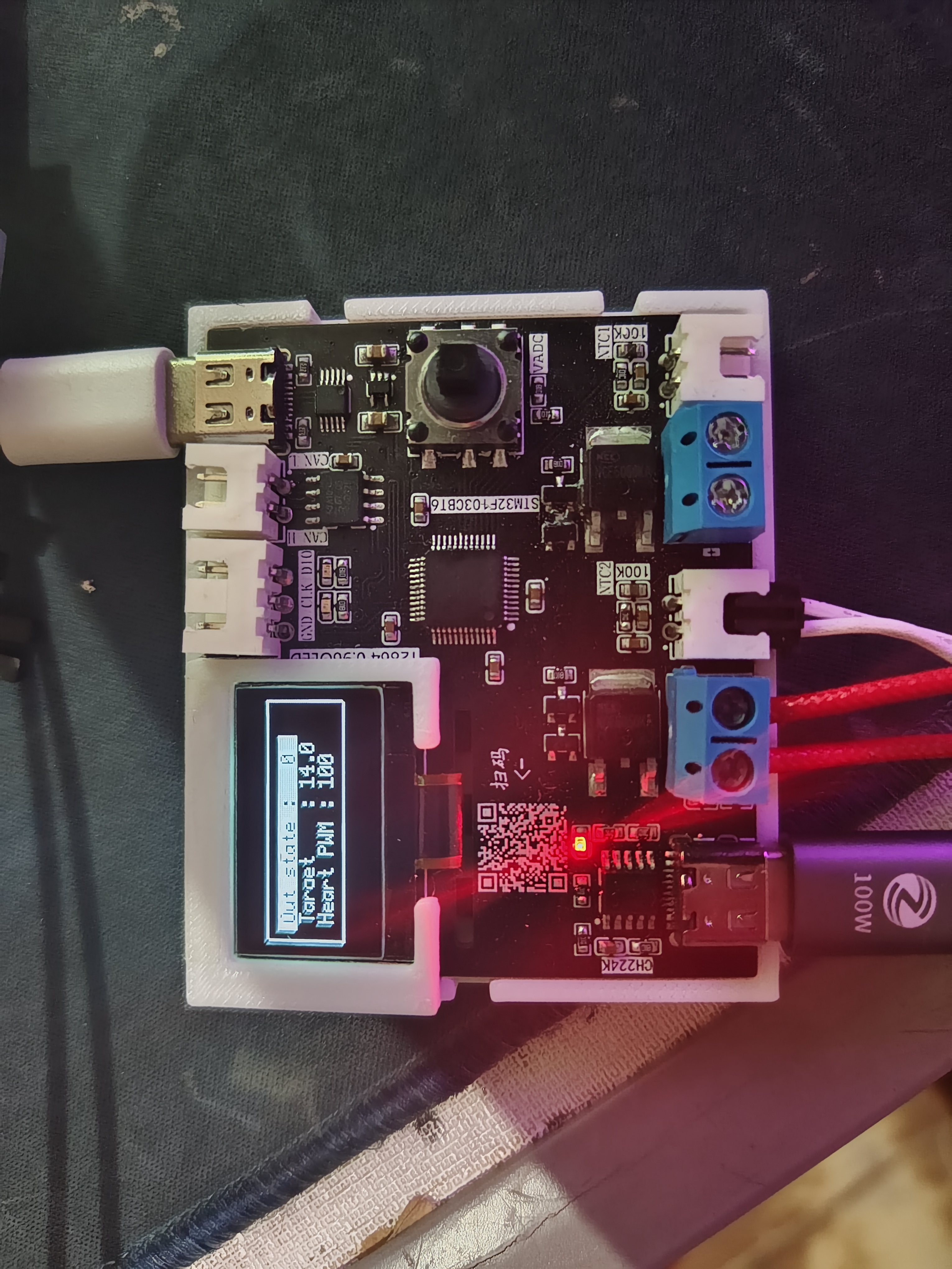

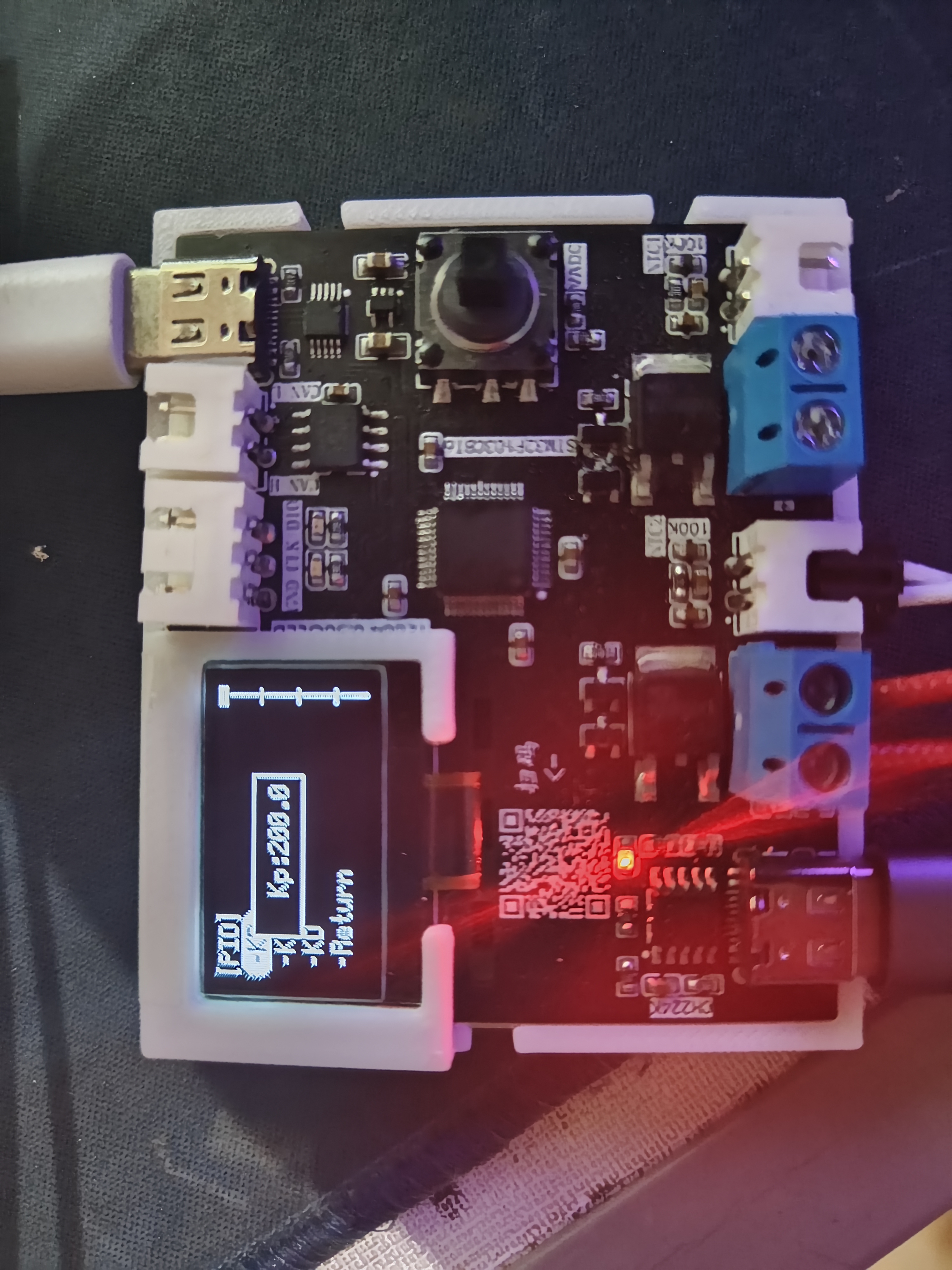

Temperature control equipment 1.0
STM32-based temperature control device with OLED, A24C64 memory, CH340E serial port, TJA1050 CAN communication, PD12V decoy, etc.
For educational purposes only, not for commercial use.

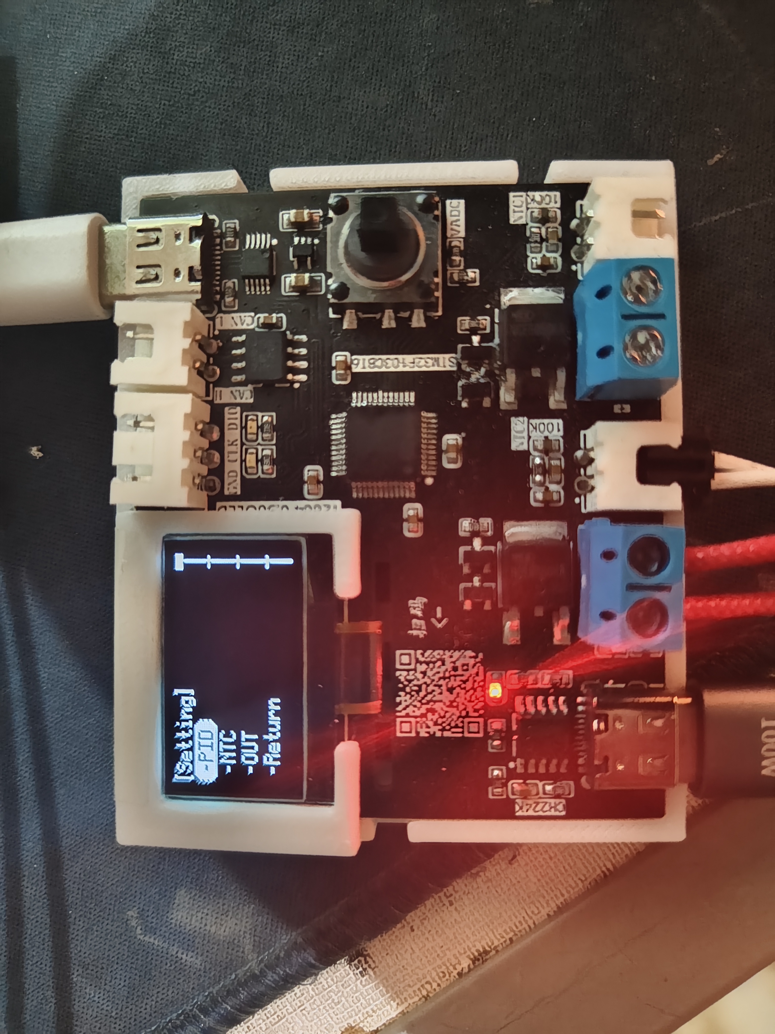

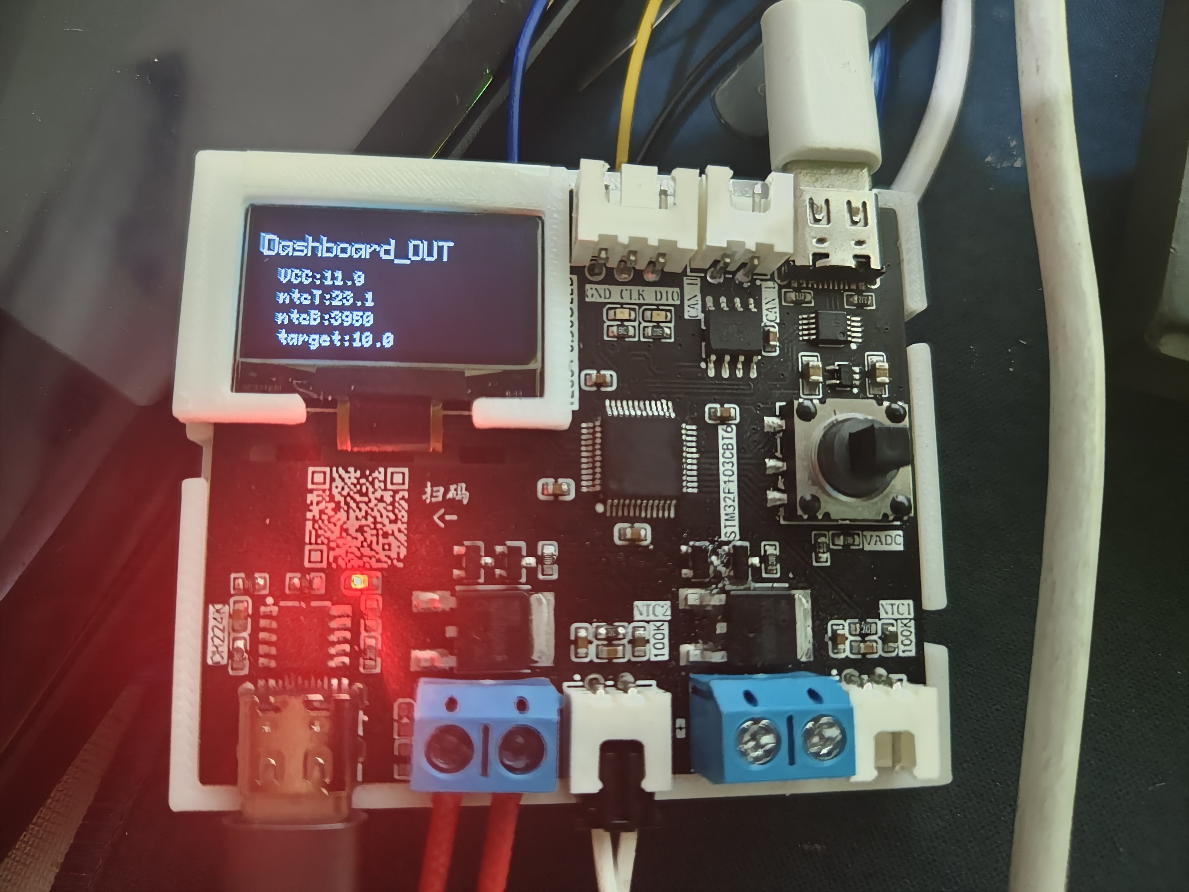

This project is a temperature control device based on the STM32F103CBT6 and FreeRTOS system. Peripherals and functions used include an SPI OLED screen, TJA1050 CAN communication, CH340E serial communication, a five-way button, ADC, PID control of PWM output, IIC AT24C64 storage, CH224K PD12V decoy, and step-down.
A 3D-printed extruder head is used as a load to demonstrate the functionality. The main purpose of this project is to practice using FreeRTOS, IIC, SPI, and CAN protocols.
Code link:
https://github.com/cnxft/Temperature_Control_Equipment/tree/main

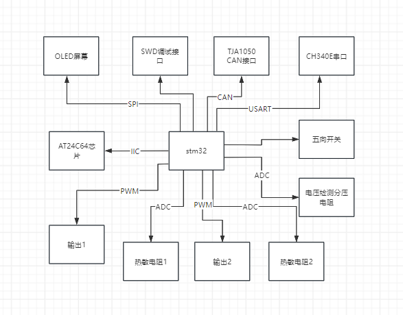

I. Overall Design Block Diagram
Power Supply:
Others:
II. Hardware Circuit Composition

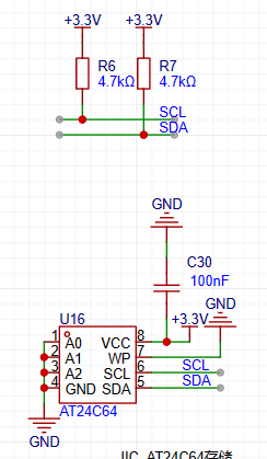

1. AT24C64 memory section, chip and its IIC pull-up

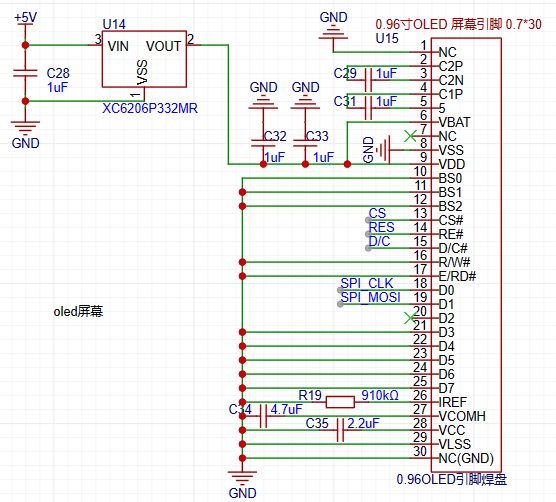

2. 12864 OLED screen SPI wiring

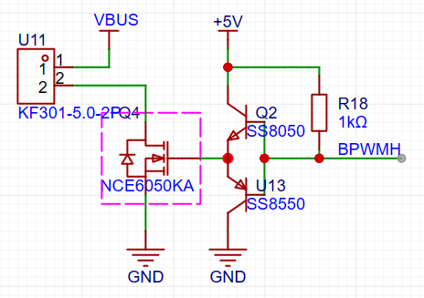

3. PWM control output size circuit

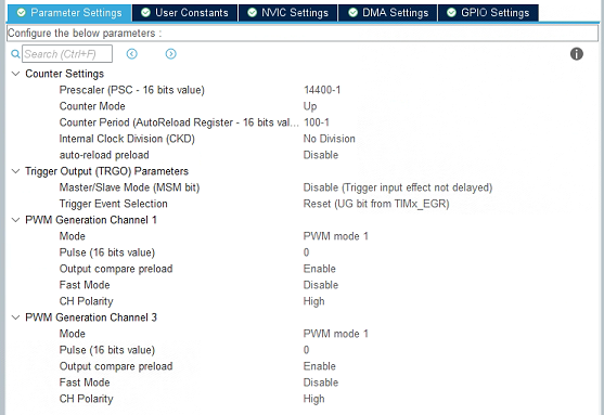

  HAL_TIM_PWM_Start_IT(&htim2, TIM_CHANNEL_3);

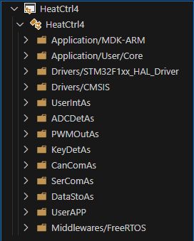

1. Task content
Each task is written in a file under UserApp, which you can check yourself

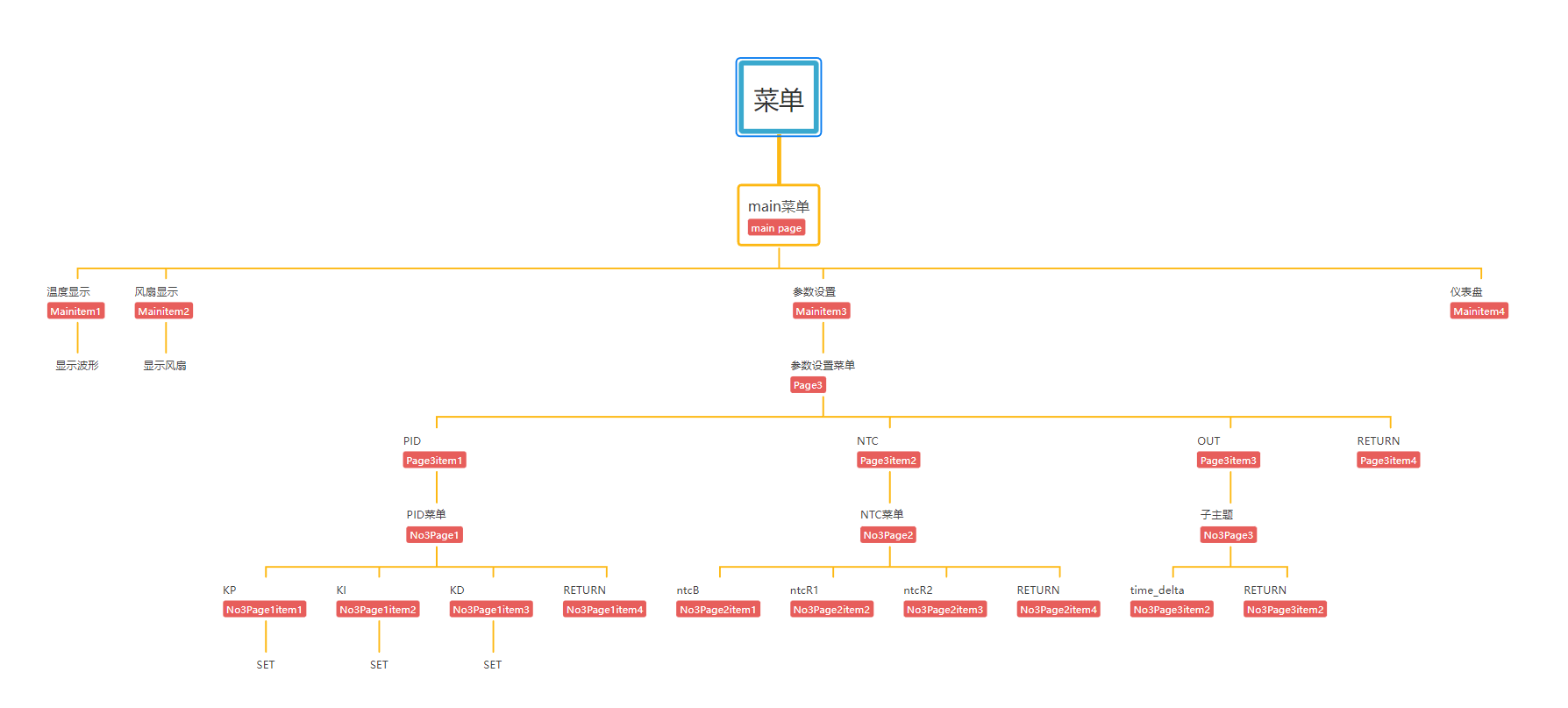

2. OLED menu division
The OLED screen uses an open-source program from a Bilibili user. The idea is to make it into a linked list, which can point to the next level menu or to the interface you want to create (function form).
A simple menu list is written
3. u8g2 initialization
The callback function for driving the OLED is written in the oled.c file. u8g2 initialization:
u8g2_Setup_ssd1306_128x64_noname_f(u8g2, U8G2_R0, u8x8_byte_4wire_hw_spi, The `u8x8_stm32_gpio_and_delay`
function indicates that 4-wire hardware SPI is used, and the SPI driver function from the HAL library is written in the corresponding position within the function.
The `u8x8_stm32_gpio_and_delay()` function is the GPIO and delay function when using software SPI/IIC. When using software, the HAL GPIO and delay functions should be written in this function, but since hardware is used here, the function directly returns 1.
Using the `setup` function built into the U8G2 library for SSD1306, there's no need to write it manually.
4. Menu switching:
When a key is pressed, the screen's running state changes, and the menu is refreshed or a specified function is opened based on the running state.

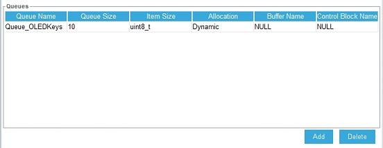

The key detection task is written in the `TaskKey` task, which generates a tick every 5ms to detect key presses. Then, the key detection results are placed in a pre-created queue.
The TaskMenu task calls the function to obtain the key status in blocking mode, with a blocking time of 200ms
(xQueueReceive(Queue_OLEDKeysHandle, &Dir, pdMS_TO_TICKS(200)) != pdTRUE)
(which can be understood as refreshing the screen every 200ms)

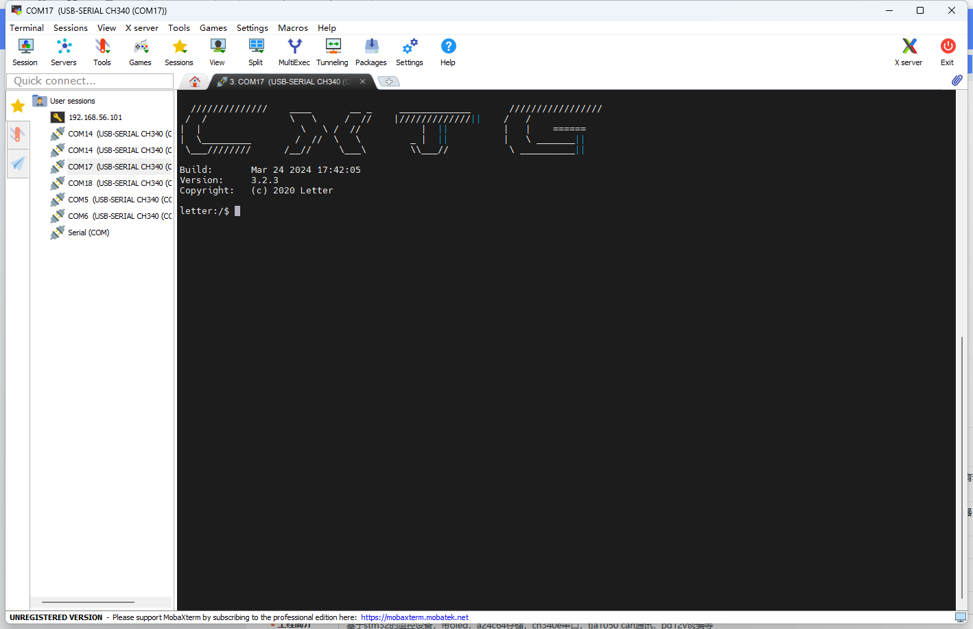

For the serial port, a letter_shell library is used, which can manipulate the device like a Linux shell.
In the shell_func..c file, several functions have been added. Commands can be used to call these functions to modify the values ​​of kp, ki, and kd for more convenient parameter tuning.
SHELL_EXPORT_CMD(SHELL_CMD_PERMISSION(0) | SHELL_CMD_TYPE(SHELL_TYPE_CMD_FUNC), out_state, Shell_OUT, Enable output 1 or 0);
SHELL_EXPORT_CMD(SHELL_CMD_PERMISSION(0) | SHELL_CMD_TYPE(SHELL_TYPE_CMD_FUNC), out_target, Shell_Target, Set target temp double);
SHELL_EXPORT_CMD(SHELL_CMD_PERMISSION(0) | SHELL_CMD_TYPE(SHELL_TYPE_CMD_FUNC), parameter_show, Shell_Parameter_Show, show pid wushen);
SHELL_EXPORT_CMD(SHELL_CMD_PERMISSION(0) | SHELL_CMD_TYPE(SHELL_TYPE_CMD_FUNC), pid_reset, Shell_PID_Reset, pid reset wushen);
SHELL_EXPORT_CMD(SHELL_CMD_PERMISSION(0) | SHELL_CMD_TYPE(SHELL_TYPE_CMD_FUNC), kp_set, Shell_Kp, Set Kp float);
SHELL_EXPORT_CMD(SHELL_CMD_PERMISSION(0) | SHELL_CMD_TYPE(SHELL_TYPE_CMD_FUNC), ki_set, Shell_Ki, Set Ki float);
SHELL_EXPORT_CMD(SHELL_CMD_PERMISSION(0) | SHELL_CMD_TYPE(SHELL_TYPE_CMD_FUNC), kd_set, Shell_Kd, Set Kd float);
Although the parameters kp, etc., are of type double when defined, the library parameter of letter_shell is double, which will cause an error (0), while float is normal.

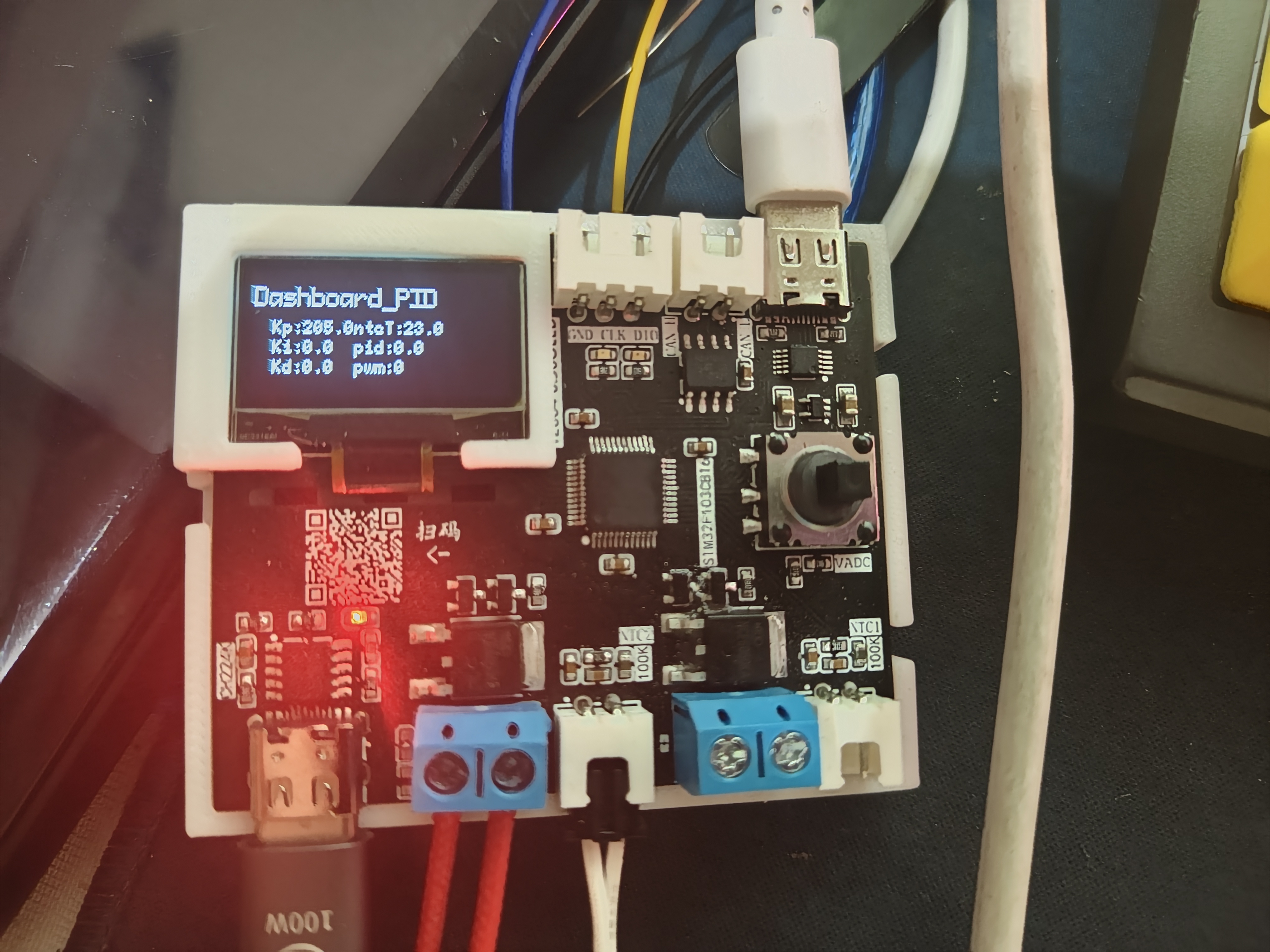

After connecting the serial port, you can press the Tab key or type help+enter to view the available commands. It's worth noting that when the function type is floating-point, the decimal point should not be omitted.
The logo can also be modified in the shell.c file.
See how beautifully I modified it?

8. Output
: The heating device is driven by a PWM-controlled transistor-controlled MOSFET. The PWM duty cycle is calculated by the PID algorithm. Here, the output on the left is used in conjunction with the temperature sensing resistor. The right side can use PWM to control fans, etc. The frequency division value and counting value settings are as follows. You can modify them according to your needs. When modifying the counting value, remember to modify the function that maps the PID calculation result to the PWM duty cycle part.

10. The progress bar
reads data before the for (;;) loop in AppTask_App, loading some necessary parameters into the program.
Initially, a synchronization function between programs in the FreeRTOS system was used, using notifications to simulate binary semaphores to synchronize AppTask_App and AppTask_Menu. The progress bar in the AppTask_Menu task will lengthen if it does not acquire a binary semaphore; otherwise, it enters a blocked state until the progress bar finishes and enters the menu interface.

Part Four: Physical Display
My soldering sequence: First, solder the back side using a soldering station. Second, solder the chip and two Type-C connectors, ensuring correct soldering. Third, solder the rest using a hot air gun, but pay attention to the Type-C connector placement. Alternatively, you can solder the PD12V decoy section first to test the effect; a successful decoy will light up the LED. Then solder the 5V to 3.3V converter. Finally, solder the screen and plug-in components.
Temperature curve
output settings (switch, target temperature, fan PWM duty cycle)
and PID KP
parameter display are included
. The demonstration
video, located in the appendix, shows the usage of letter_shell and demonstrates parameter modification and automatic saving to the AT24C64.

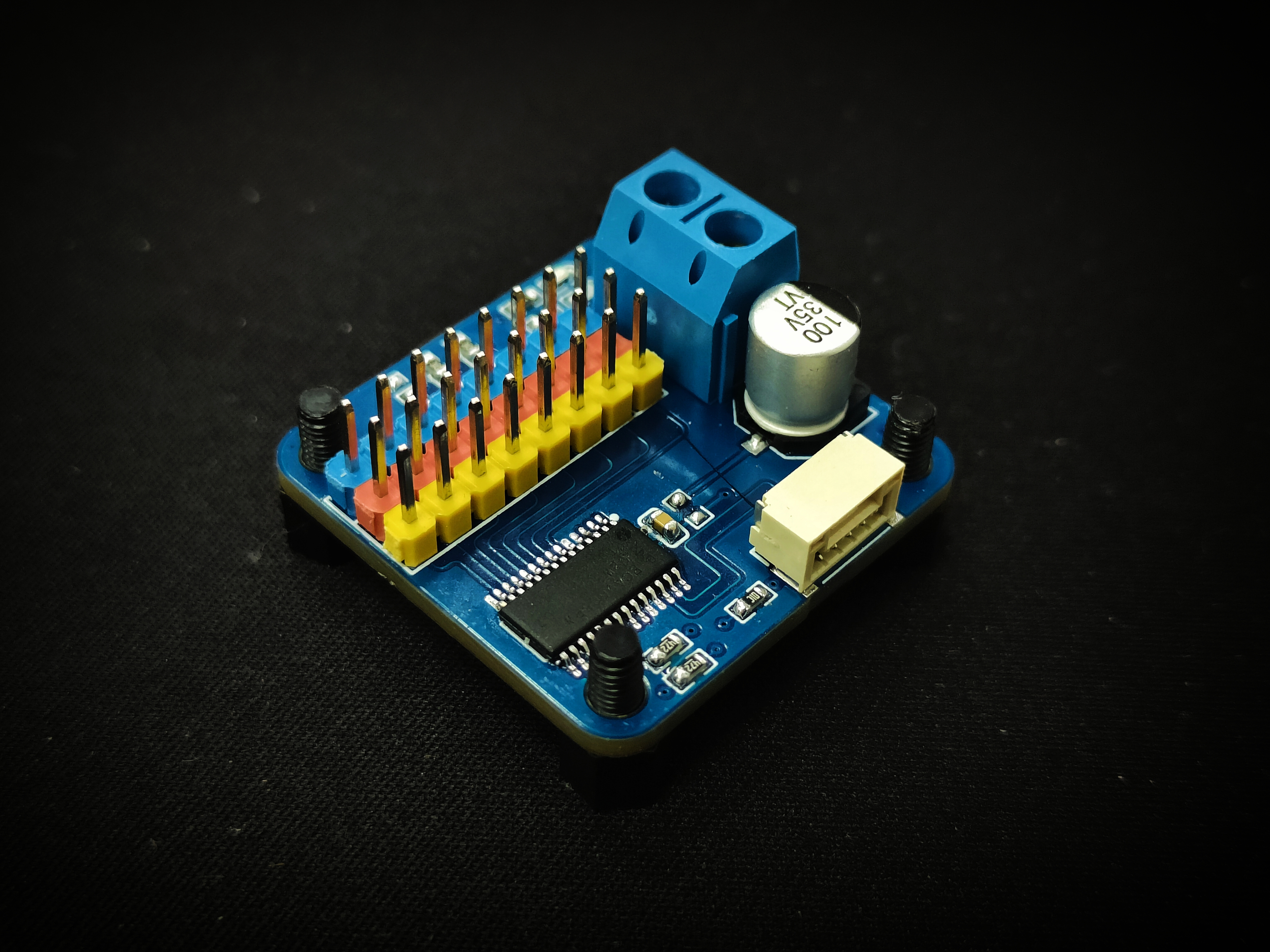

PCA9685 IIC-PWM controller module 30mm small board
The PCA9685 IIC-PWM controller module is a 30mm small board.
The PCA9685 features 5 address configuration pins and 16 PWM outputs.
This project, considering practical needs, only uses three address configuration pins and eight PWM outputs.
