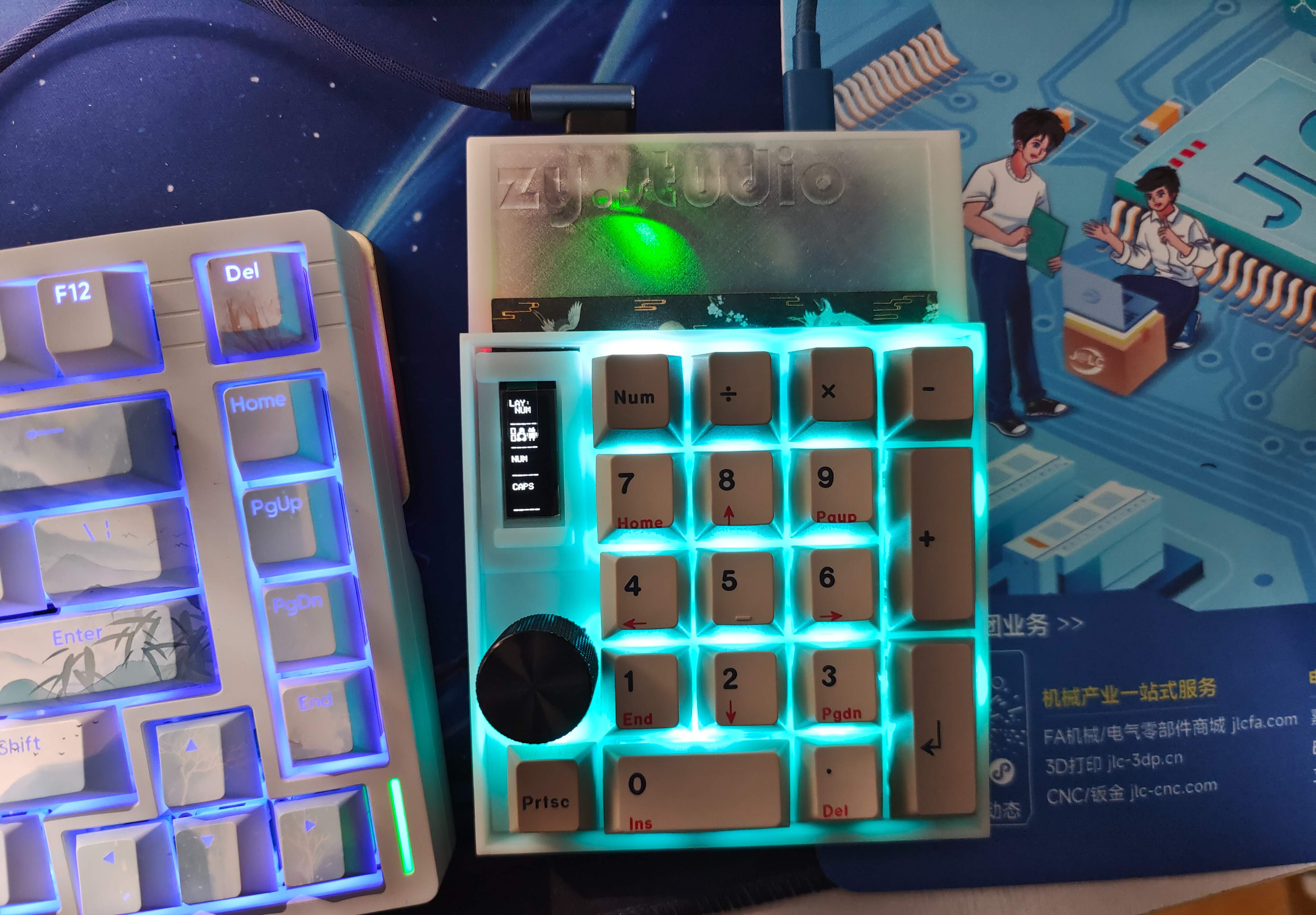

Numeric keypad (RP2040, screen, knob)
The project uses the Raspberry Pi pico development board, compatible with development boards from YD and Wuming Technology. It adopts the QMK solution.

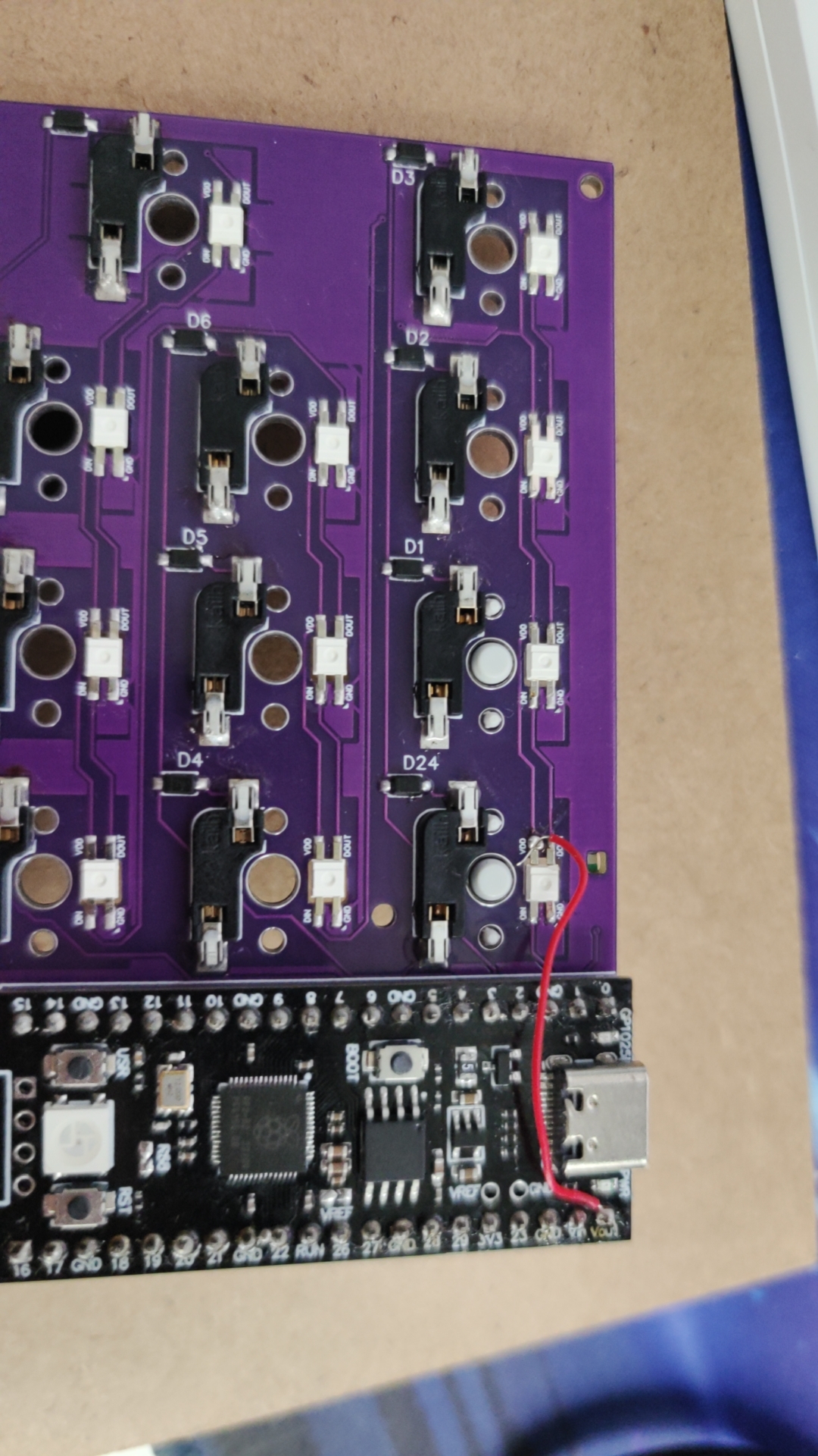

There's a problem with the PCB: a fly-wire needs to be connected from the development board's 5V to an RGB LED's VDD for the LED to light up.
The attached .uf2 file is the firmware; simply drag and drop it into the Raspberry Pi's disk to burn it. This is the simplest burning method, which is why I chose the Raspberry Pi.
The other two components are the casing and the positioning board.

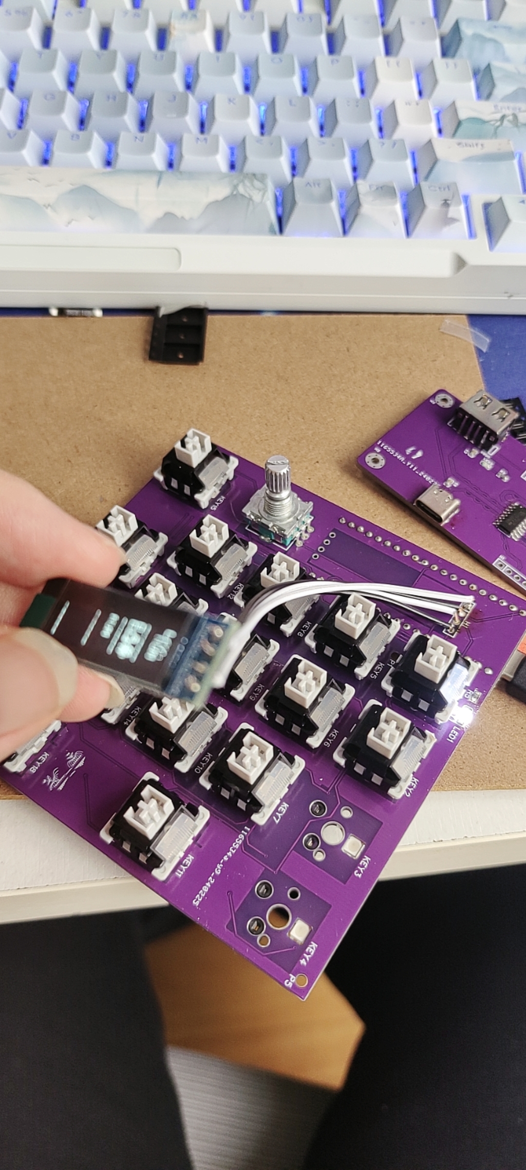

The screen requires a 0.91mm IIC screen, costing approximately 8 yuan. The screen needs to be separated from the board using alcohol or board cleaner before it can be inserted. (A modeling error occurred.) The screen board is placed under the positioning board and connected to the IIC interface with a fly-wire.
