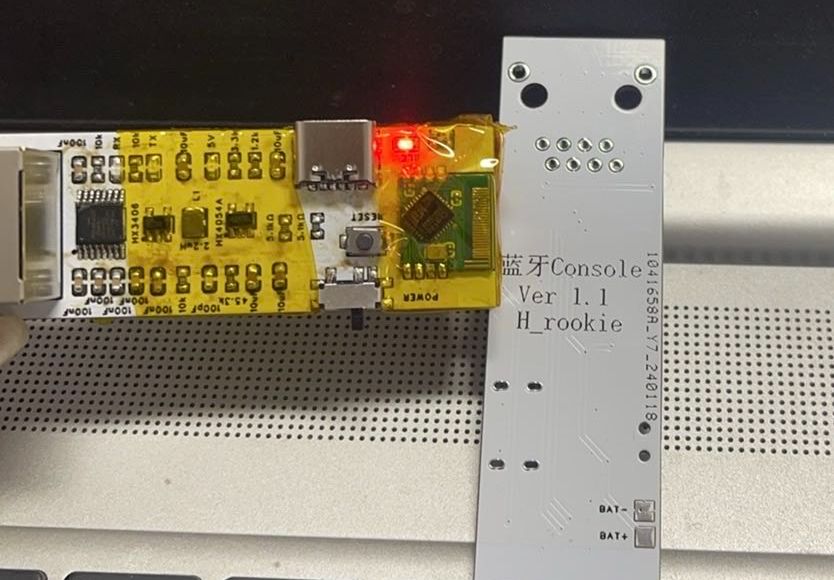

Bluetooth console - ch9140 version
This project was modified based on the work of the expert Yiruhua and the schematic provided by swtbh in the comments section. Since the switch's console port lacks serial flow control, the CTS and RTS interfaces were deleted and left empty. After soldering the initial solution, the CRT tool was found to be unresponsive. Reversing the 3rd and 6th pin wiring of the network cable resolved the issue. Therefore, in this version, the SP3232 RX and TX labels were swapped, and testing confirmed it worked correctly.
