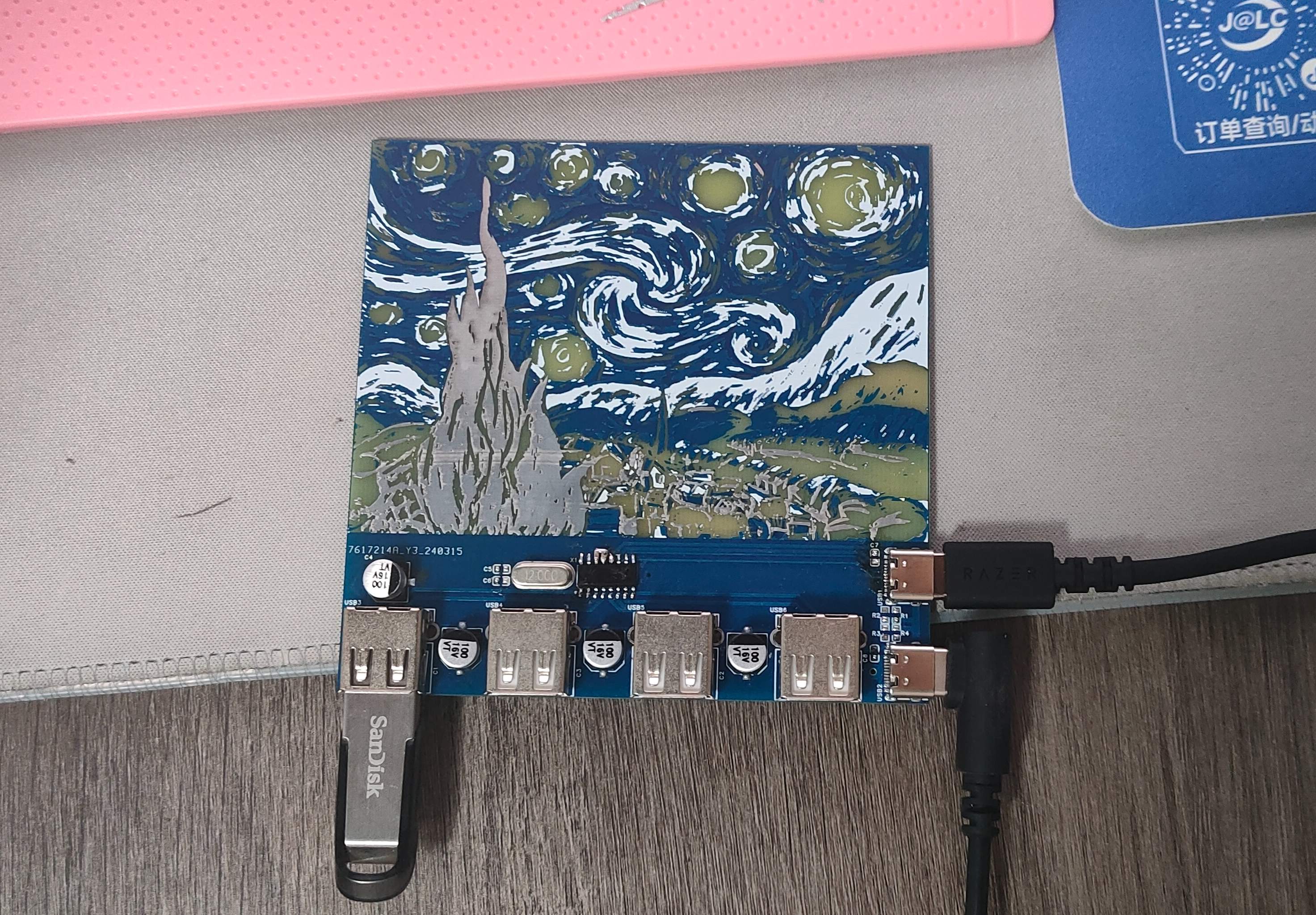

USBHUB version 2 based on SL2.1A
The speed is around 35mb/s. R3 and R4 don't need soldering; they're redundant. If it's just an A to C connection, then R2 and R1 don't need soldering either. In the most basic case, you can just solder X1, U1, C9, C10, C1-C4, and USB1-USB6. The VBUs for the two Type-C interfaces are independent. If you only want to use one interface, please modify the PCB yourself; just right-click and clone. The starry sky layer is from the Bilibili user "I'm Not Surnamed Cui". [Starry Sky, PCB Replica] https://www.bilibili.com/video/BV18H4y1L7UY/?share_source=copy_web&vd_source=837b8b59718fac945ba3558f01c951c4
