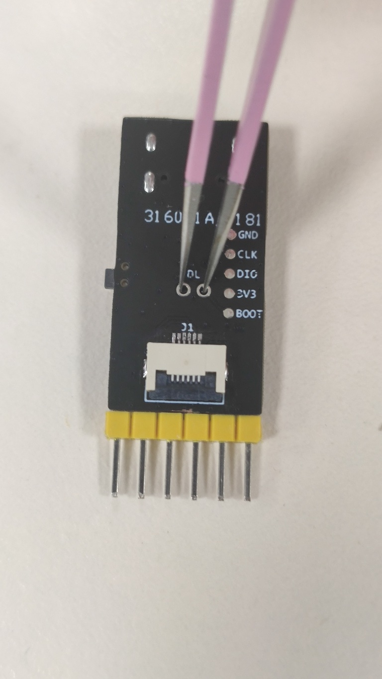

A pre-installed FPC connector is located on the back, allowing connection to the target device via an FPC cable. If this function is not needed, this connector can be left unsoldered; all other components are on the front of the PCB.
Pressing the button on the side cuts off the 3.3V power output, enabling a one-click power-off reset.

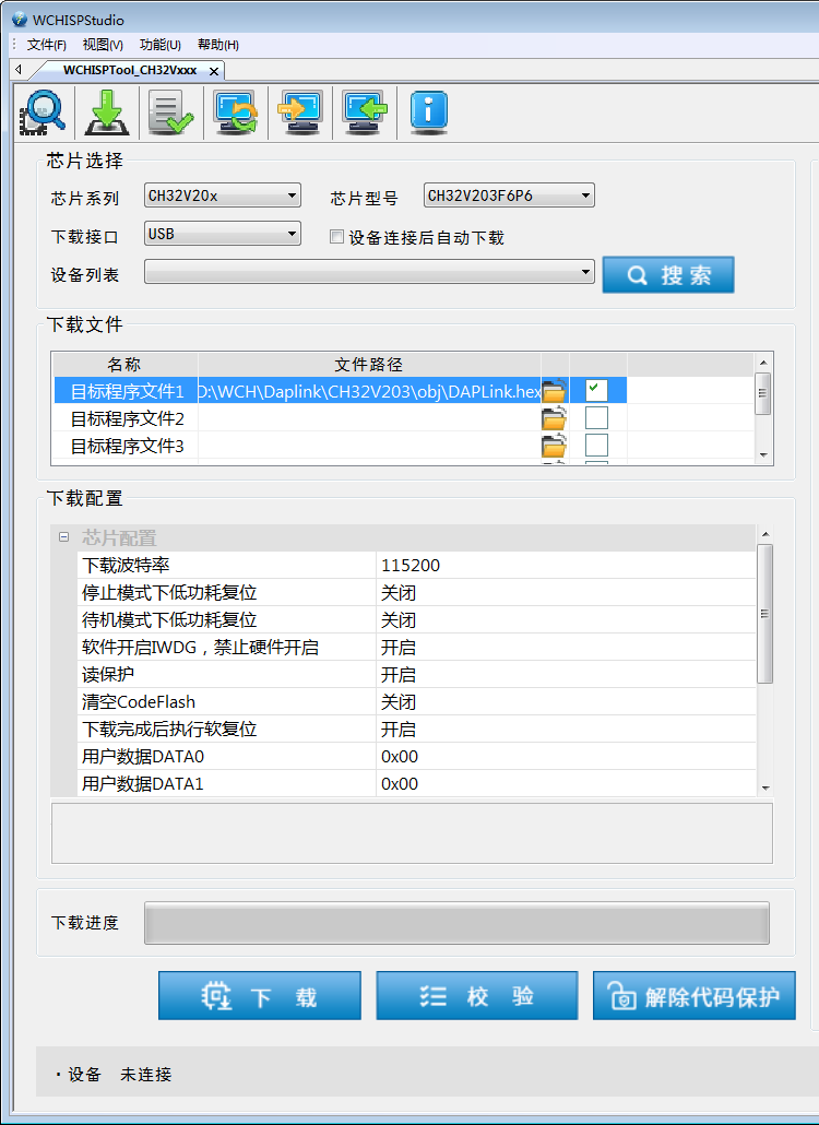

flash the firmware, select CH32Vxxx in WCHISPTool and add the target program file 1.
Short-circuit the DL test point on the back with tweezers, then connect to the computer via USB.
Once the device appears in the device list, click download.

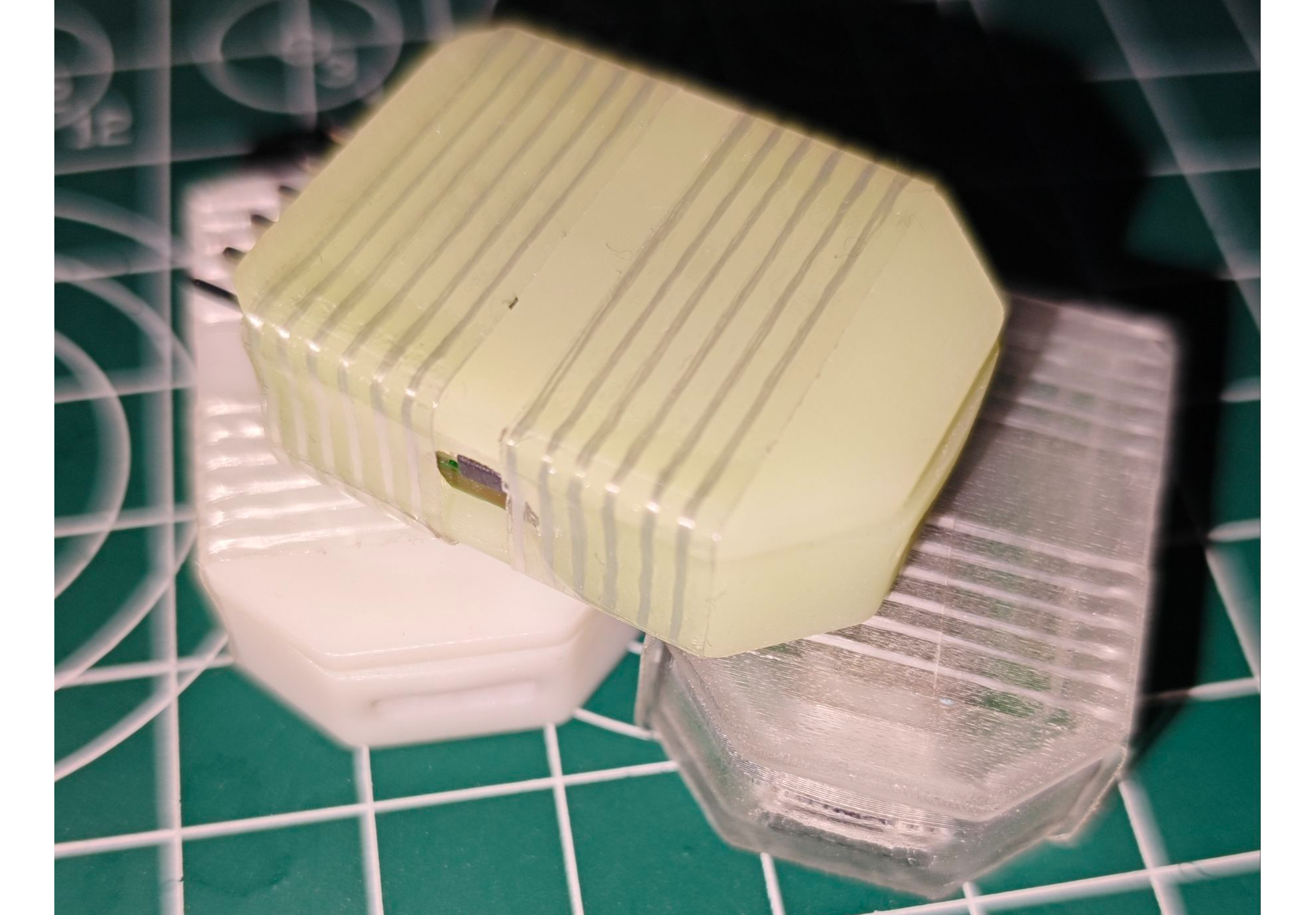

Weird little lamp
A desktop ornament resembling a hand grenade
A desktop ornament designed to resemble a hand grenade:
Shell Shape: Mimicking the classic shape of a hand grenade, it features a round base and a raised handle at the top, resulting in a compact and three-dimensional design.
Material and Color: The shell is printed with white environmentally friendly PLA material, offering a smooth surface, excellent texture, and a simple yet elegant look.
Size: The shell is of moderate size, making it easy to place on a desktop or bookshelf as a decorative piece.
Features:
RGB LEDs: Built-in multi-color RGB LEDs provide rich and varied lighting effects, supporting multiple colors and flashing modes to enhance visual appeal.
Lighting Control: Users can adjust the light color and brightness as needed.
USB Power Supply: USB powered, allowing for easy connection to a computer, power bank, or USB adapter.
Application Scenarios:
Home Decor: Can be used as a desktop ornament or bookshelf decoration to create a warm and inviting atmosphere.
Office: Placed on an office desk or in a meeting room, it adds fun and vibrancy to the work environment.
Business Gift: A creative gift for friends, colleagues, or business partners, showcasing personality and taste.
Precautions:
Safe Use: Do not confuse this with an actual hand grenade. Use it as a decoration only. Do not throw or disassemble.
Avoid Prolonged Continuous Use: To extend the life of the LEDs, avoid prolonged continuous use and allow for appropriate breaks to prevent overheating.
This desktop ornament not only boasts a unique design but also incorporates lighting effects, adding fun and vibrancy to your living space. It is a creative product worthy of collection and display.
